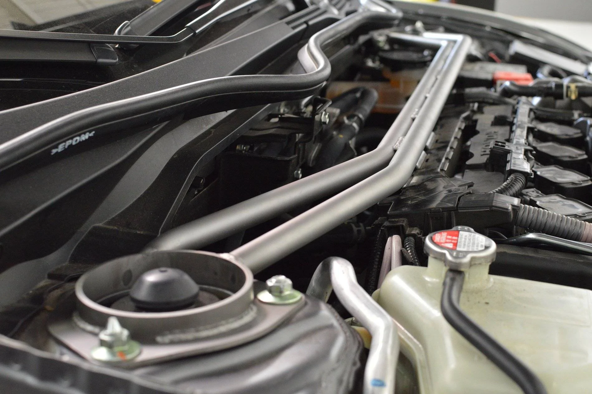

So how are you guys going to overcome the factory camber adjustment ?Using a slotted mounting hole?

Not sure I understand what you are asking. Are you talking about the locating stud in the tower?

Not sure exactly what it’s called but I think he’s referring to the 4th factory stud/pin that allows for a tiny bit of camber adjustment when removed

That's what I was thinking. That stud is an alignment pin from the factory to quickly allow the struts to be installed. Our FSTB will have a hole in the plate for the stud to pass through or you can do as most do and simply remove it. The bar is slotted to allow some movement.

To adjust camber (the factory Adjustment )with slotted holes in the chassis ,your bar also needs to have slotted holes.But you already answered that.
