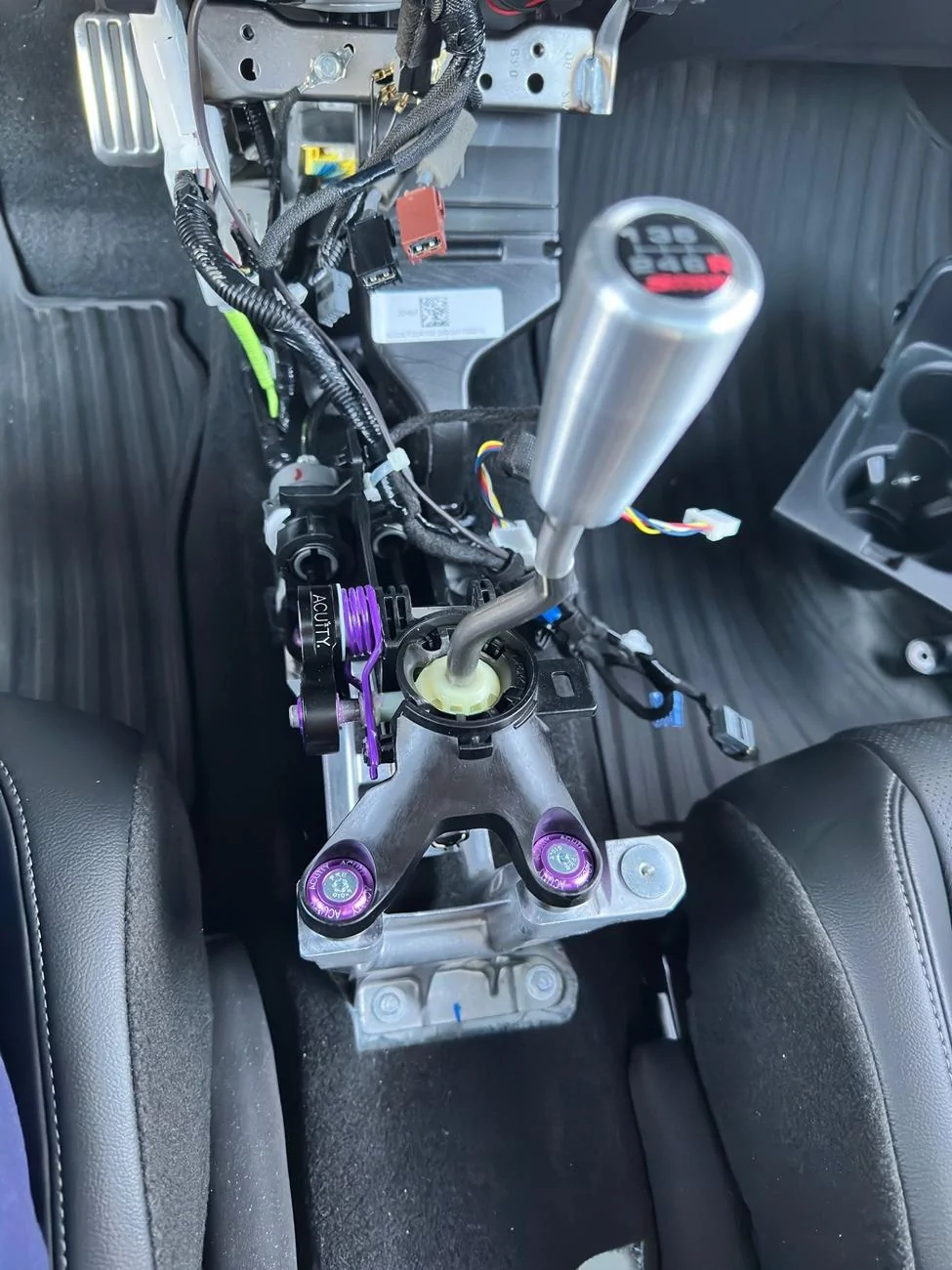

I installed the stage 2 kit with hybrid racing detent springs and derlin chicane shift knob. It's a world of difference. It felt great before the detent springs but after it is very stiff and returns to center with force. I love it. Buti came from a Shelby GT350 and the shifter in that was amazing. I like the notchiness. It'll probably too much for most with both the stage 2 and the detent springs, buti love it.

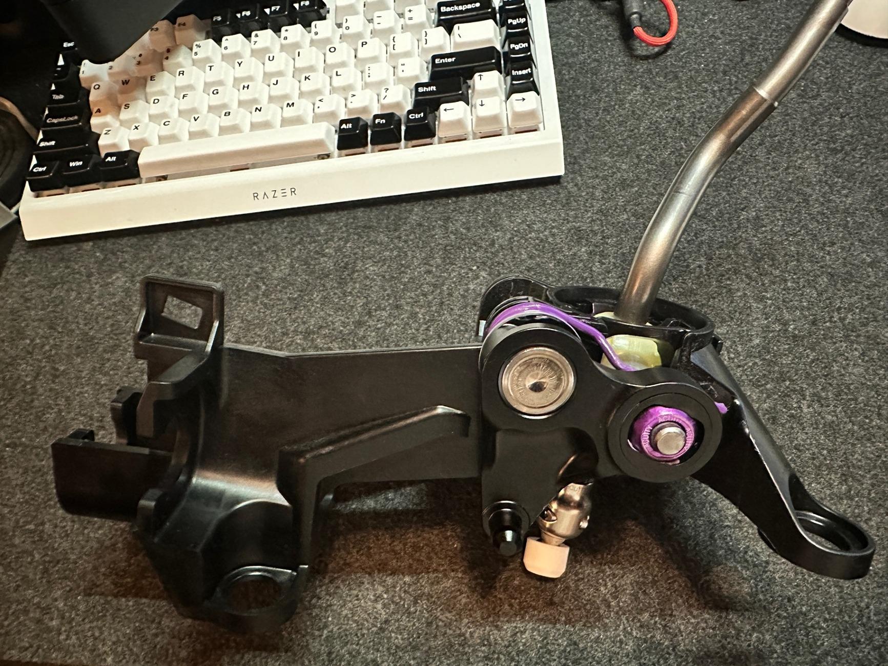

Its actually easy to do, just a little tedious. Taking apart the trim is easy, its just trying to remember plugging everything in after that can be an issue sometimes. I recommend having a retractable magnet for the bolts under the cup holder and to be careful with the spacers and retaining washers that come with the short throw adapter, they dont hold together all too well.
I also made it a little easier on myself by buying a 2nd OEM lever assembly, installing the upgrade parts on that and just swapping it out for the existing one in the car.
Surprisingly I used Hybrid Racings short shifter install video as a reference to uninstall and reinstall the shifter.
