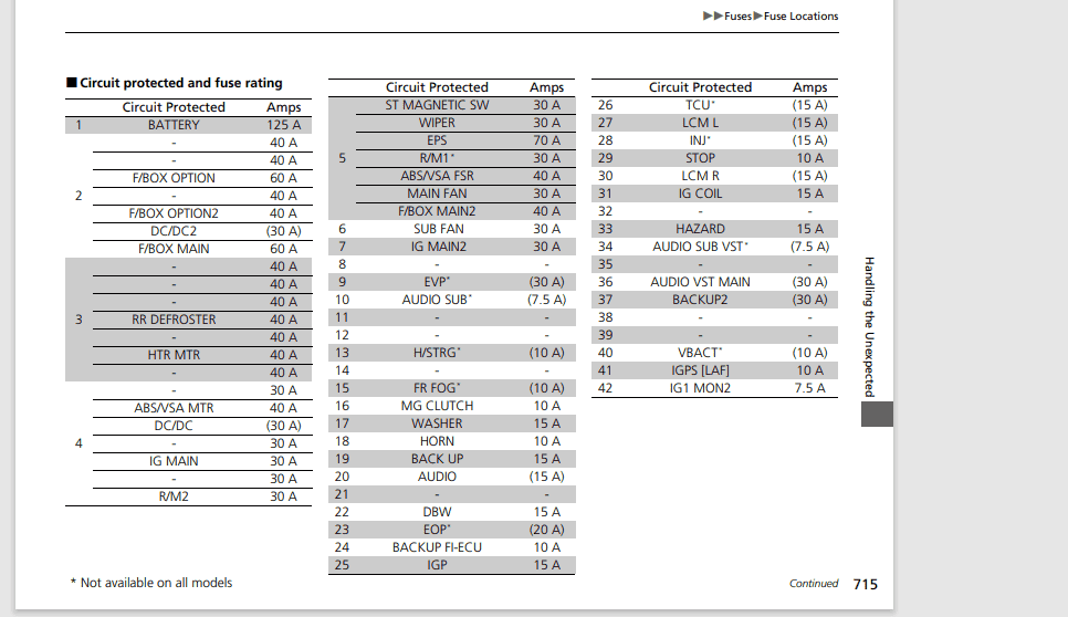

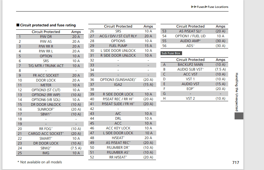

9k miles. 6 speed car. Driving to get lunch during work and suddenly all assist warnings came up, can't even use normal cruise. Tried resetting the car by pulling the battery and that didn't work either. Anybody know what fuse controls the front camera? Also note my windshield is not dirty nor are any of the sensors.
11th Gen Honda Civic All assists shut off/brake system light on. fuse box 2.PNG
11th Gen Honda Civic All assists shut off/brake system light on. fuse box 1.PNG
