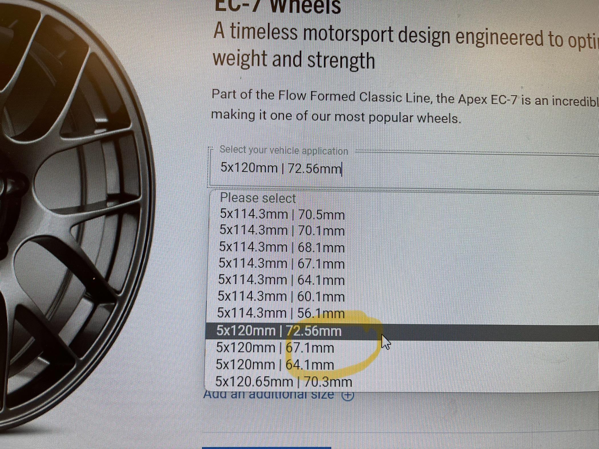

Wheel Center bore, you want 64.1mm
Yep, 64.1 is a direct fit. I think some of their wheels don't come in this bore but they should be able to outfit you with the proper ring to adjust. Looks like you're good with that wheel in 5x120 64.1 but I would definitely sync up with someone at Apex to walk you through it if you look at a wheel with different center bore. They are extremely helpful so don't hesitate to contact them directly with any questions.

awesome! thanks
