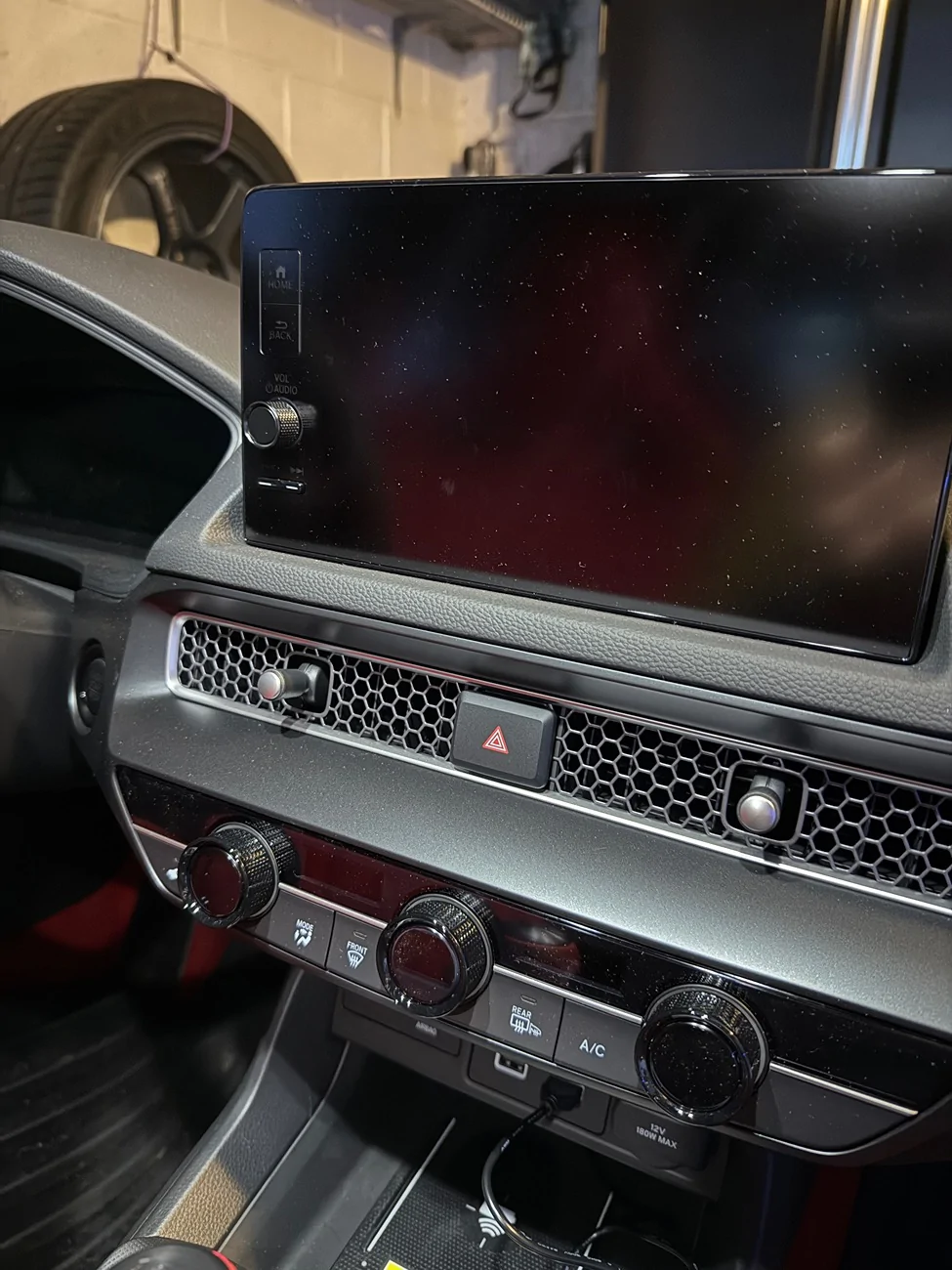

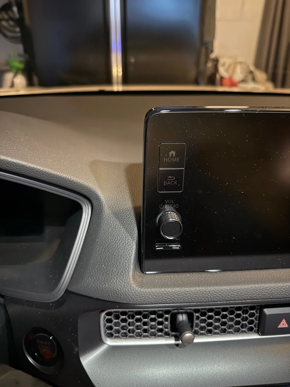

Hey all.
so I posted a little while ago that I did the black climate control knobs, it goes great with the black push button start.
I was a bit bummed that they did not make a radio knob so after a few weeks of not thinking about it, I decided to fix it.
I pulled it off, cleaned it with some prep solution, scuffed it lightly with a scotch Brite, hit it with some adhesion promoter and sprayed it with some satin black.
I let it hang overnight and dry, and it literally matches the climate control knobs perfectly. And once I really don’t touch it I’m not too concerned about it wearing off over time. But it really finishes everything off nicely. It was just bugging me lol
