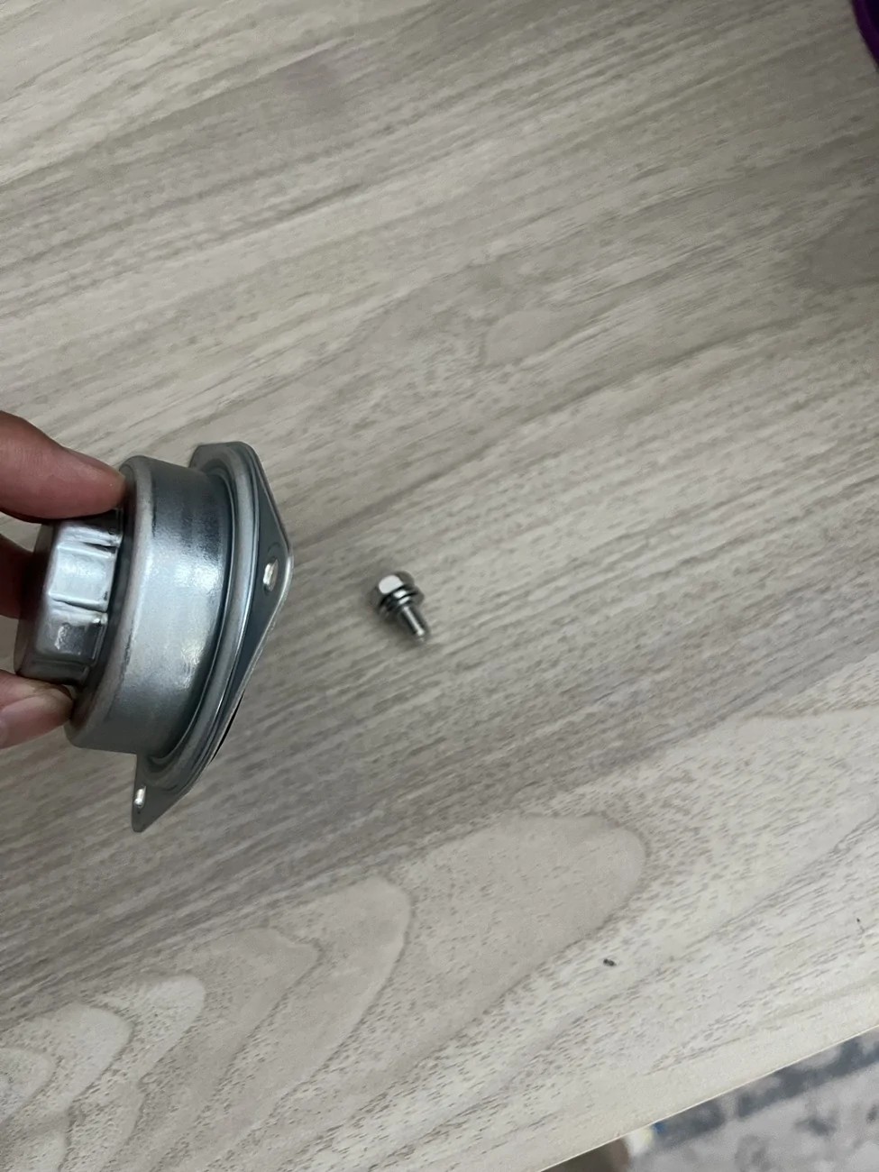

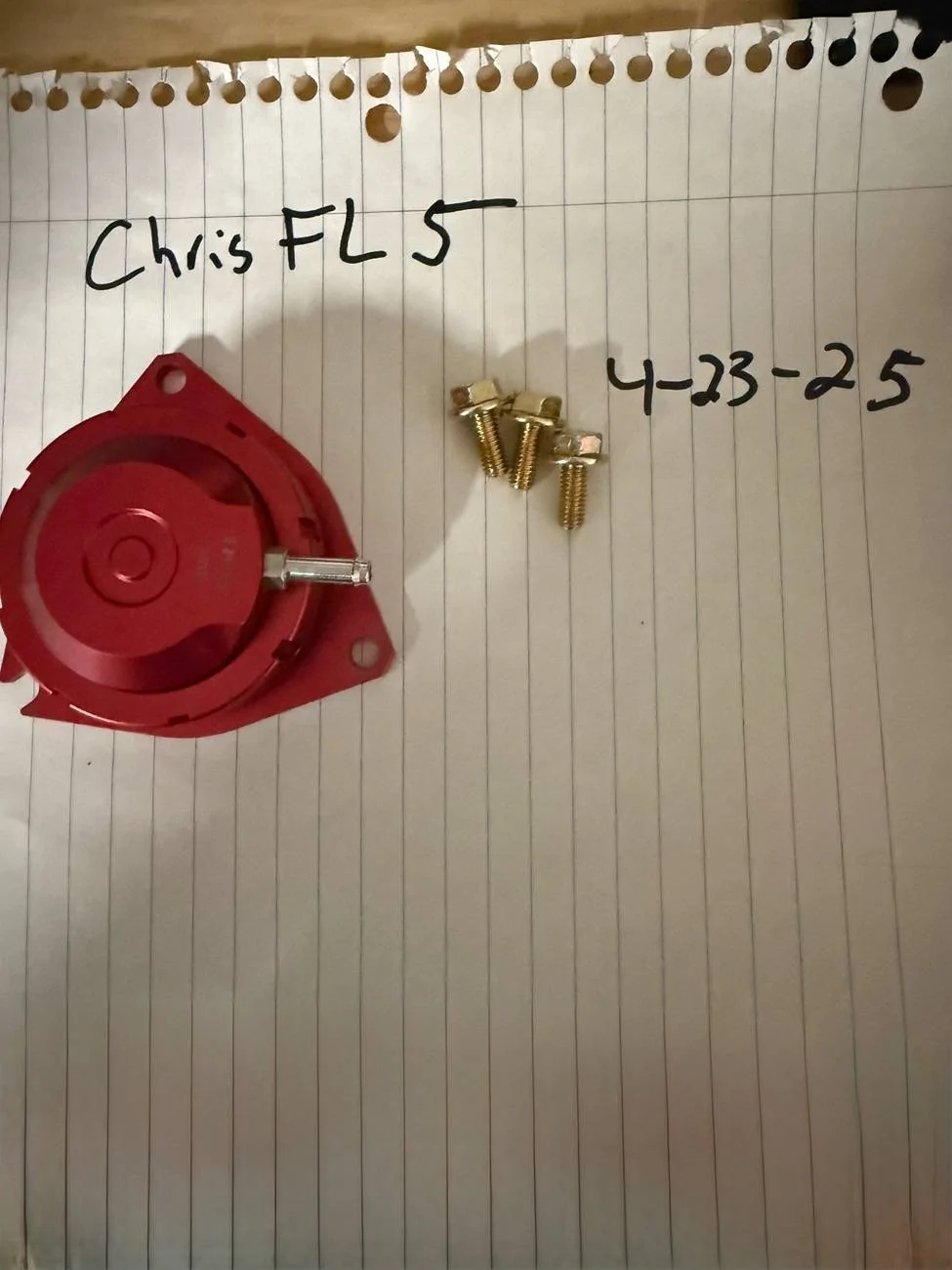

The RV6 BPV looks thicker than the OEM, so the OEM bolts may be too short. Best bet is to see if RV6 will sell you new hardware only.

here's the oem BPV side profile and bolt (12mm like iforgottopee said) and rv6 bpv with hardware for reference
