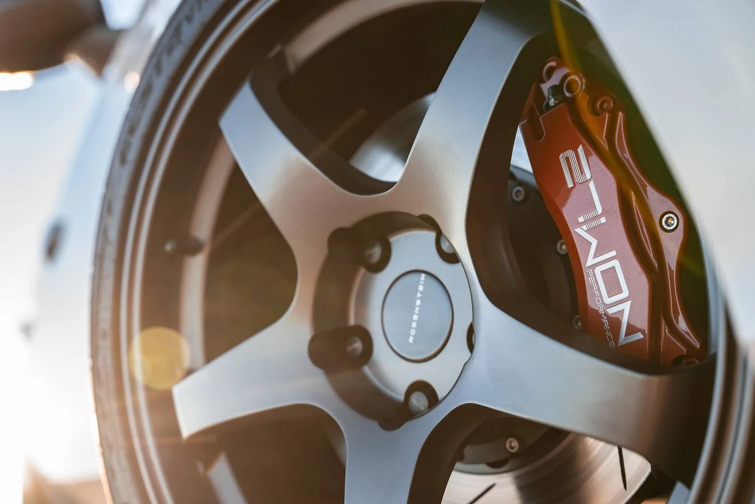

Went the BBK route here and have no regrets. Car feels great. LIke said above though I personally still do a front pad swap for track days. But with the BBK it is much faster and only takes a couple of minutes.
