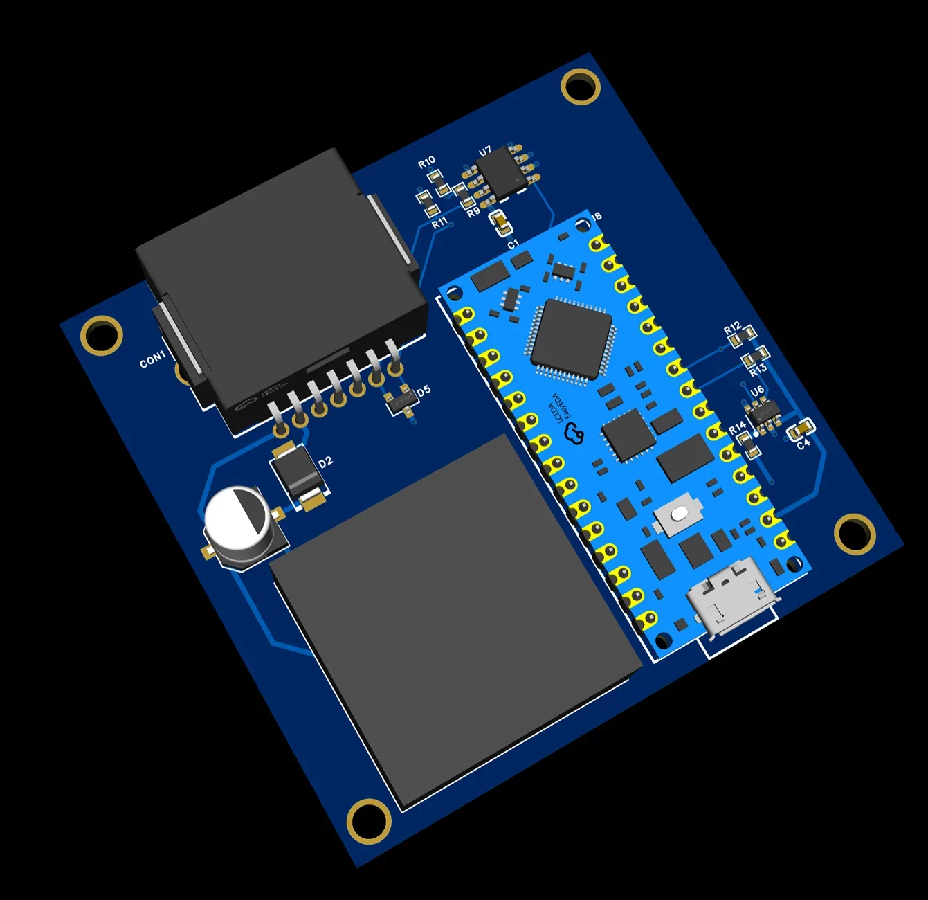

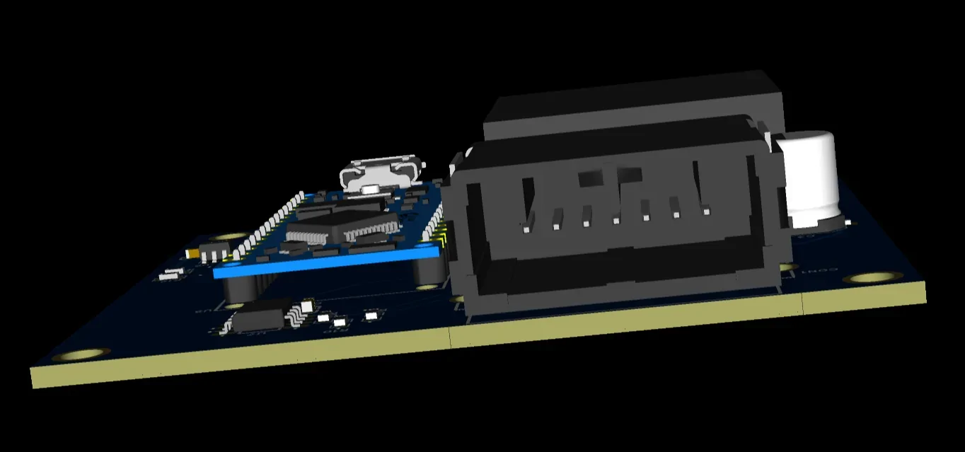

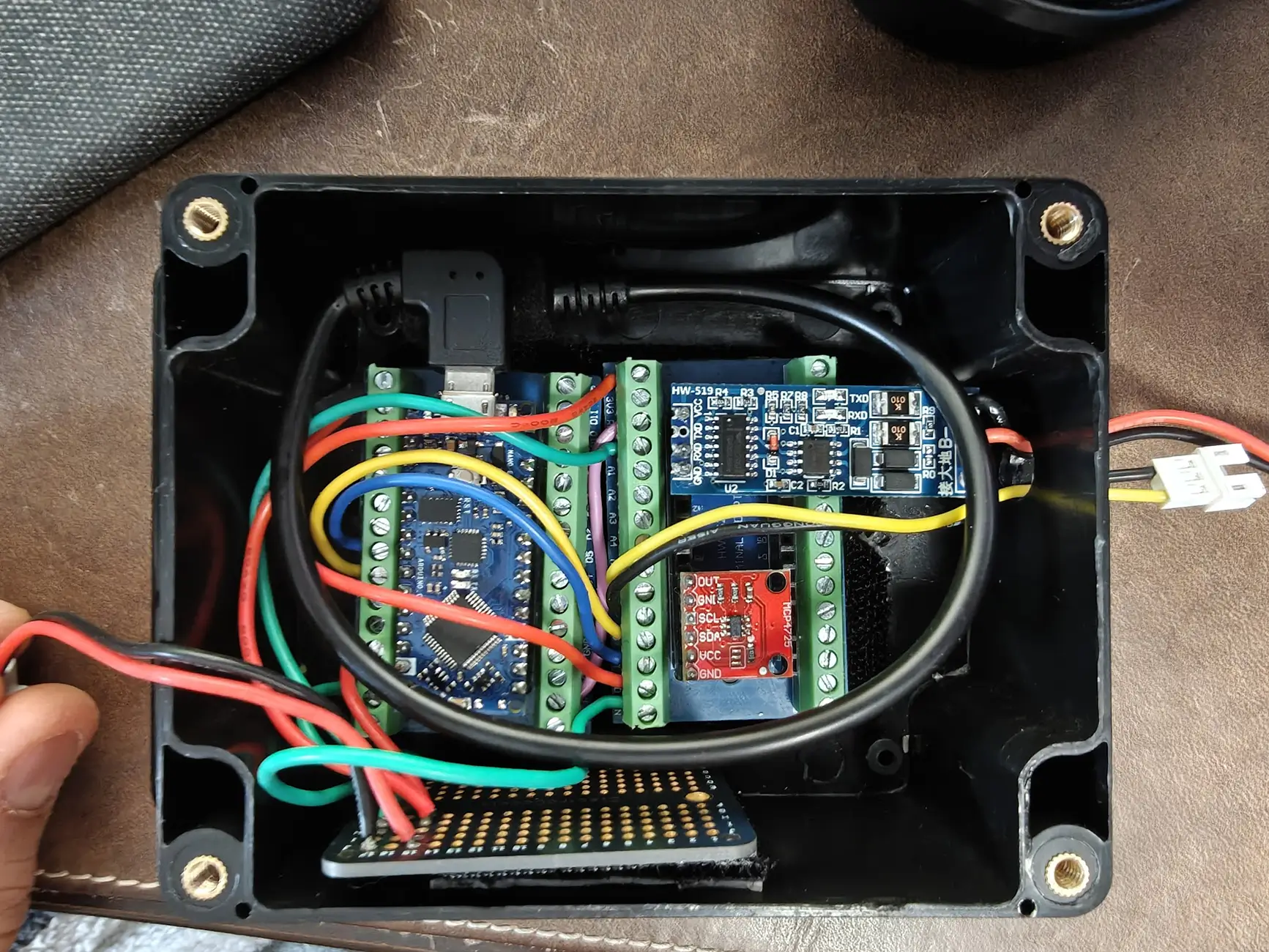

I've been quiet for a few days because I ran into a problem with the volume control device that required a redesign. TL;DR, All is well now.
The longer story: the strategy of replicating a manual volume knob aka potentiometer with a digital potentiometer was not the right strategy, at least not for my DSP. The Arc Audio ecosystem uses relatively low impedance volume controls (500 ohms in this case) which is an intentional design choice for reasons I won't get into here, suffice it to say they know what they are doing. The problem arises from the fact that there are no 500 ohm digipots (the closest is 1 kohm) because they will be susceptible to ripple and noise.
I was mistakenly under the impression that the ratio of the impedances would suffice, but electrically the power input for the digipot from the DSP just can't overcome the much higher impedance.
So, back to the drawing board. I ended up switching the strategy completely from applying a resistive load to the static voltage supplied by the DSP, to simply using a DAC as an analog variable voltage source, bypassing the DSP's potentiometer power source completely. This is a much better design and will be compatible with more aftermarket DSPs (so long as they use analog voltage as the remote control strategy). The only thing that would need to be figured out for each DSP is whether the amp is sending 5V or 3.3V into the remote control as the VCC power source (the two industry standards). I could feasibly make this a product with two models - one for 3.3V amp remotes and the other for 5V remotes.
The new device is the little red PCB on the lower right corner. I'm also planning to design a PCB to micro-size this whole device, and I found a board-mount isolated power supply that I can use for even further shrinkage.
