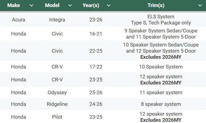

The following Honda and Acura models/years/trims are compatible with my digital integration device.
11th Gen Honda Civic "PURE" Digital Factory Infotainment Integration Honda Civic Bose / Acura Integra ELS 1777948707569-oq
11th Gen Honda Civic "PURE" Digital Factory Infotainment Integration Honda Civic Bose / Acura Integra ELS 1777948713735-mk
