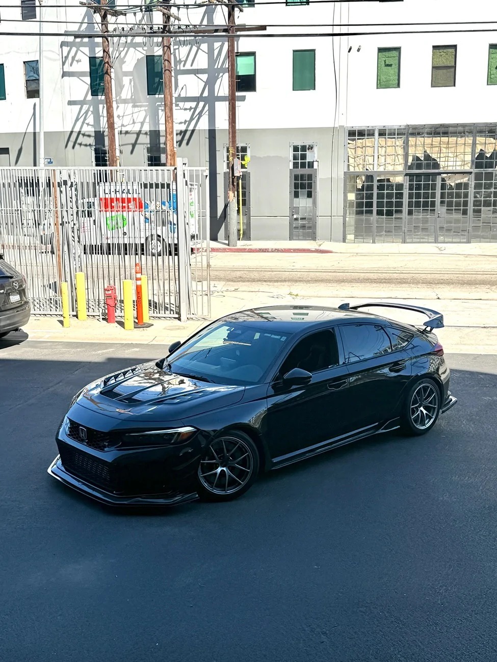

11th Gen Honda Civic CBP Build Review IMG_2750
25’ CBP build review video here
Video was shot a few months ago, so not all the mods are listed in the description, and some things have changed, but I’ll have a detailed mods list coming soon!
Power
Tune:Tuned by @d_butl3r Hondata Canflex e70
Tune Revision:Retuned by @JSRengines Hondata Canflex e50
Intake and Inlet:PRL
Turbo:27won Kuro+
Chargepipe:PRL
Intercoler:MDR bar and plate
HPFP:Full Race
Injectors:Hondata 1530cc
Downpipe:TSP Catted
Exhaust:Remark Dual Stainless
Motor Mounts:Wanderladen Street 75A
Oil:Amsoil Signature 0W-20
Headstuds4P 625
Suspension:
Coilovers:Nitron R3 3 Way
Sway Bar:RV6
End Links:RV6
Strut Tower Bar:R1 Titan
Stabilizer LinksSpoon
Bump Steer KitSpoon
Stiff PlateSpoon
Anti-roll BarSpoon
Rigid CollarsSpoon
Power Brace Front & RearCusco
Front Lower Ball JointWhiteline
Rear Arms:Wunderladen Racing Lower Control Arms
RV6 Lower B Arms
Alignment/Camber:-3 all around, 0 toe
Transmission MountWunderladen Racing
Passenger MountWunderladen Racing
Rear MountWunderladen Racing
Transmission:
Clutch:OS Giken HTR Twin Disc
Fluid:Motul
Wheels:
BBSBBS - MK001 (RI-A) 18x10 +40 5/120
Studs:ARP extended Studs
Cooling:
Radiator:WOT/PWR Triple Pass w/ Transmission Cooler
Oil Cooler:WOT Dual OC Kit
Cooling Plate:WOT/HPT
Bonnet:Varis Arising-I Evo Carbon
Overflow Tank:PRL
Oil Temp Sensor:P3 Gauge w/ Sensor in Oil Pan
Heat Shields:TSP x PTP Turbo Blanket
Brakes:
Front:AP Racing Calipers 9668 370mm J Hook Rotors
Rear:Paragon J Hook Large Rotor Kit
Pads:F: Ferrodo 25mm DS2500
R: Endless MX72+
Lines:HEL Stainless Steel
Brake Fluid:Castrol SRF
Engine Bay:
Hood Strut Kit:WOT
Interior:
Seats:Recaro RSS Large
Steering Wheel:Wrapped in Alcantara +15% thickness by @Sweidit
Mirrors:Spoon side view mirrors
Shifter:Acuity Stage 3 Shift Kit
Shift Knob:ALPlus Formula Shift Knob
Center Console:Wrapped in Alcantara by @Sweidit
Exterior:
Front Splitter:Varis
Front Splitter Extension:Varis
Front Canards:Varis
Fender:F: Varis
R: Varis
Rear Splitter:Varis
Rear SpoilerVaris
Paint Protection:Full Body PPF by @_21_ctr
Shout out to all the people below:
Pit Garage
JSR Engines
Jason @ WOT Performance
Humza @ Unity Performance
Emann @ NA Performance
Johnny @ MDR Industries
James @ Bulletproof Automotive
Josh @ Meraki Auto Works
Luigi @ Lmtls auto
Mike @ Goodnight Tire Service
Wunderladen Racing
Garage Immi
D_Butl3r
xpystchrisx
