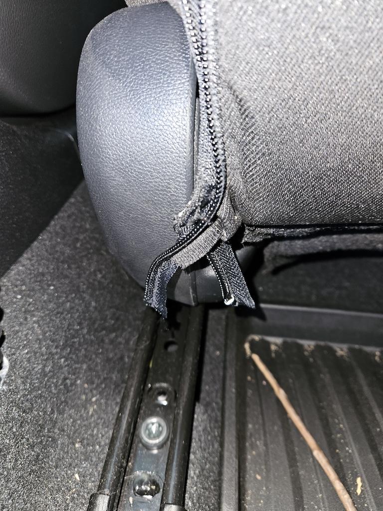

2. Unzip the side zippers on the back of the seat. I had to dig around for the ends of the zippers with my finger.

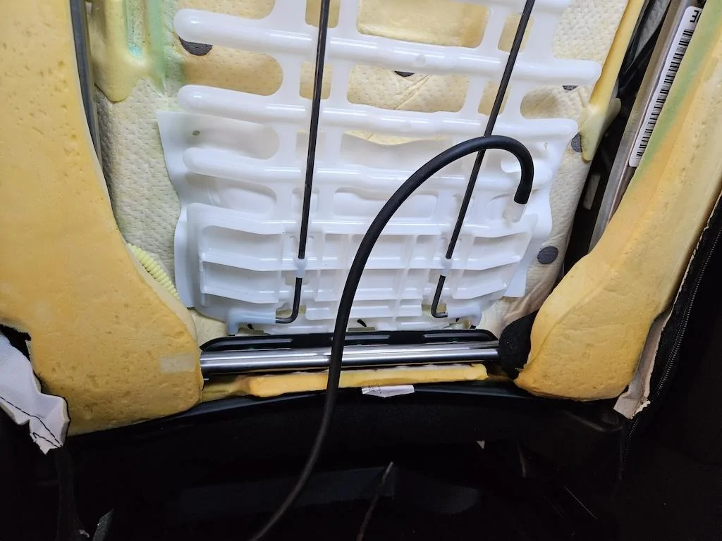

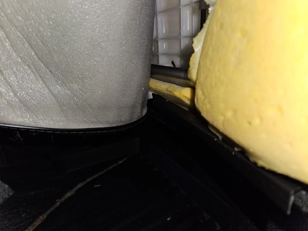

4. Insert the lumbar support between the plastic frame and the foam cushion. It's a bit of a tight fit, but didn't require any tools. I made sure to have the hose exit from between two of the frame's ribs, both to protect the hose and to help hold the whole thing in place.

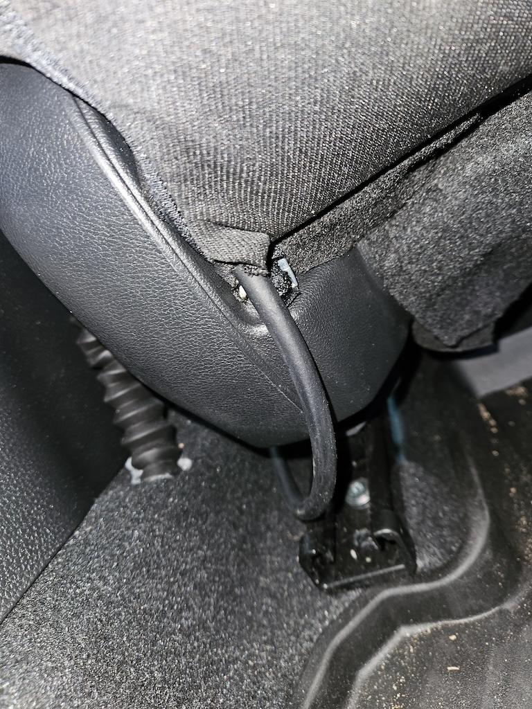

6. Tuck the fabric back in on the bottom, making sure the hose is exiting where you want it (I have it to my left)

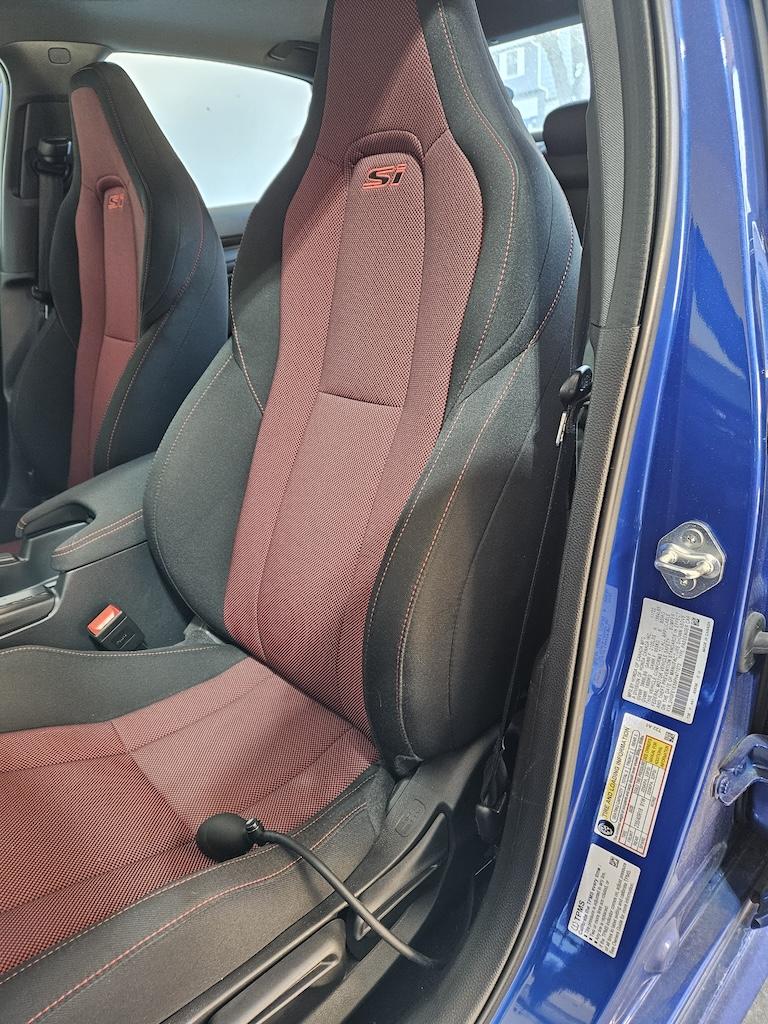

I haven't put a lot of miles on it yet, but so far the comfort in a more elevated seat position is definitely better.
