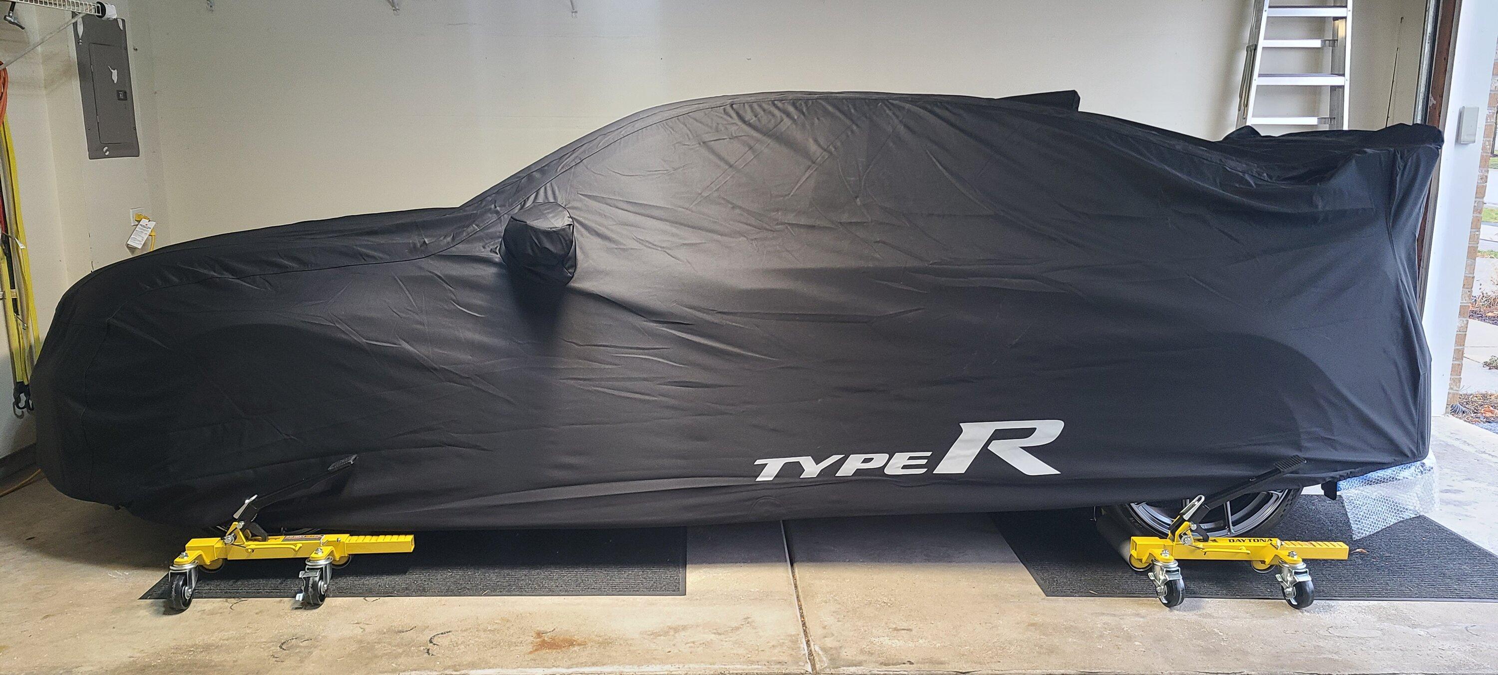

Southwest suburbs.. and she up on dollys now...I have another Honda for my daily 22 Accord ,have you done any local shows yet? Maybe I'll see you around I have the BB.
