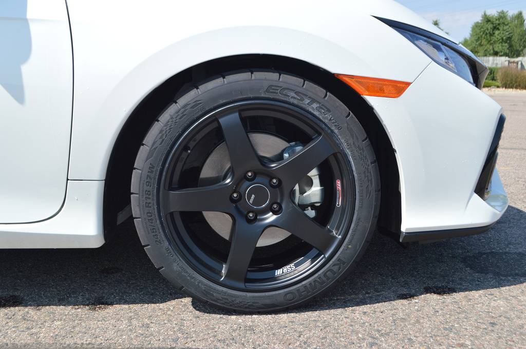

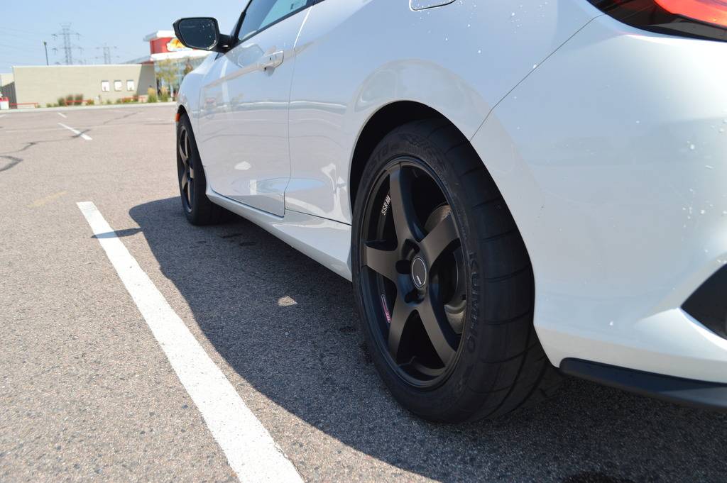

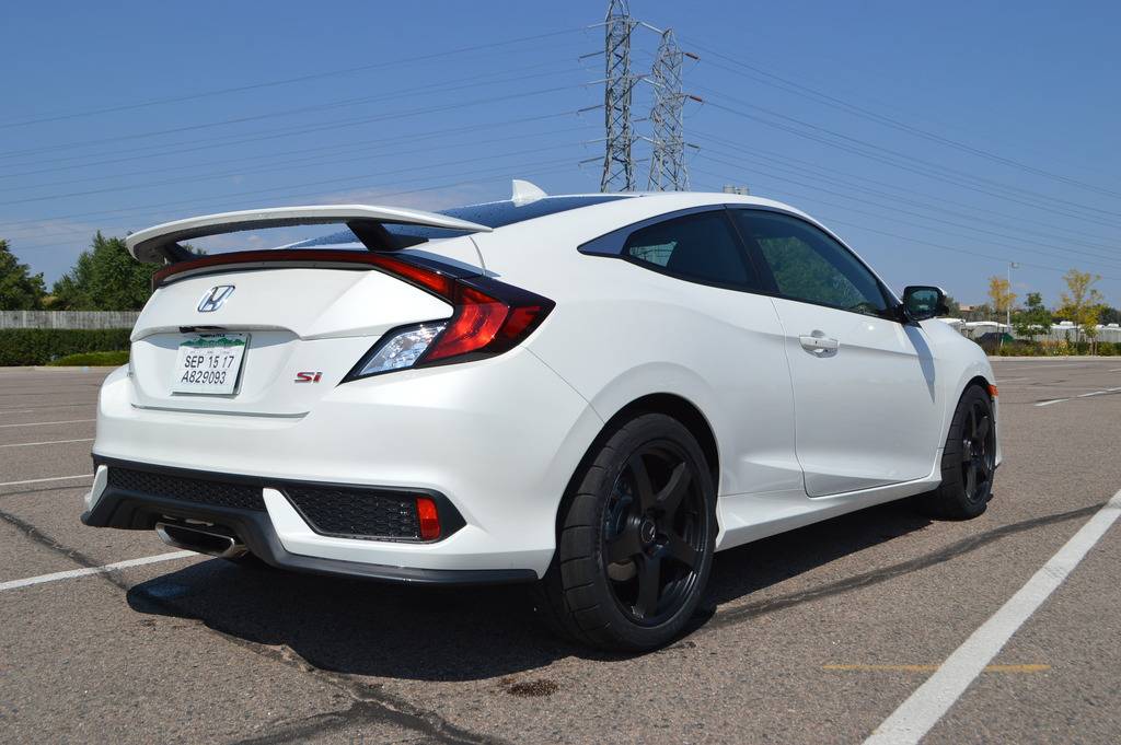

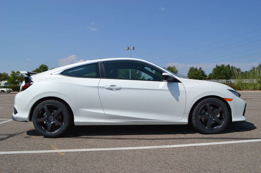

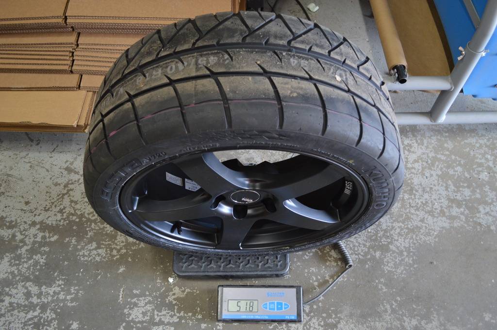

Wheels are on! Here are the specs of the wheels and tires for those interested in this size.
SSR GTV01 in Flat Black
18 x 8.5 +40mm Offset
Kumho Ecsta V720 Tires
245/40R18
Overall weight is only 0.4 more lbs for the entire wheel and tire together. Not bad for going plus one size on both the wheel and tire.

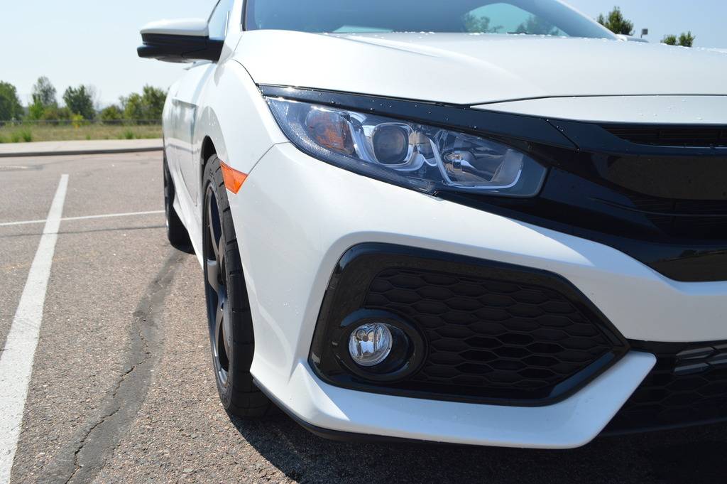

I know this is a super old post, but I stumbled across this and loved where your wheels sit in relation to the fender. However, I've fallen in love with a particular wheel that doesn't come in a 8.5 width. What offset would I need to push it back out to make up for that?

What's the wheel width?

Lol that would be an important detail. Oops! It's an 18x8.
10mm is close to 1/2 inch. 18x8 +30 would give similar fitment as 18x8.5 +40. That would also be the fitment of running 20mm spacers on stock wheels (which gives a flush look).

Here’s a pic of 20mm spacers on stock wheels, so 18x8 +30 equivalent.
Thanks! That helps a ton! And the offset wouldn't affect the tire fitment right? As in, I could place my current tires from the stock wheels on a new 18x8 wheel. Just wanna use them til they need replaced.

Stock wheels are 18x8 and offset would not impact tire width. Yes, you can use the tires you have.
