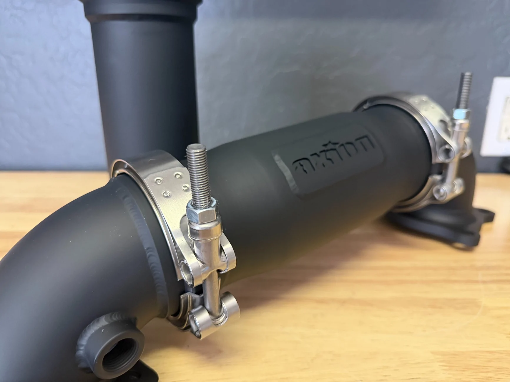

Ours will make the most HP gains, really should look into the design we did unlike anything on the market.
And its 100% USA made
11th Gen Honda Civic Fe1 best downpipe IMG_0245
