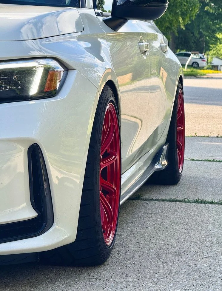

275s can help but youll also want a 5mm spacer if you are focused on flush fitment. The best offset to get a flush fitment on a 9.5 is +38
This is +38 on a 265.
