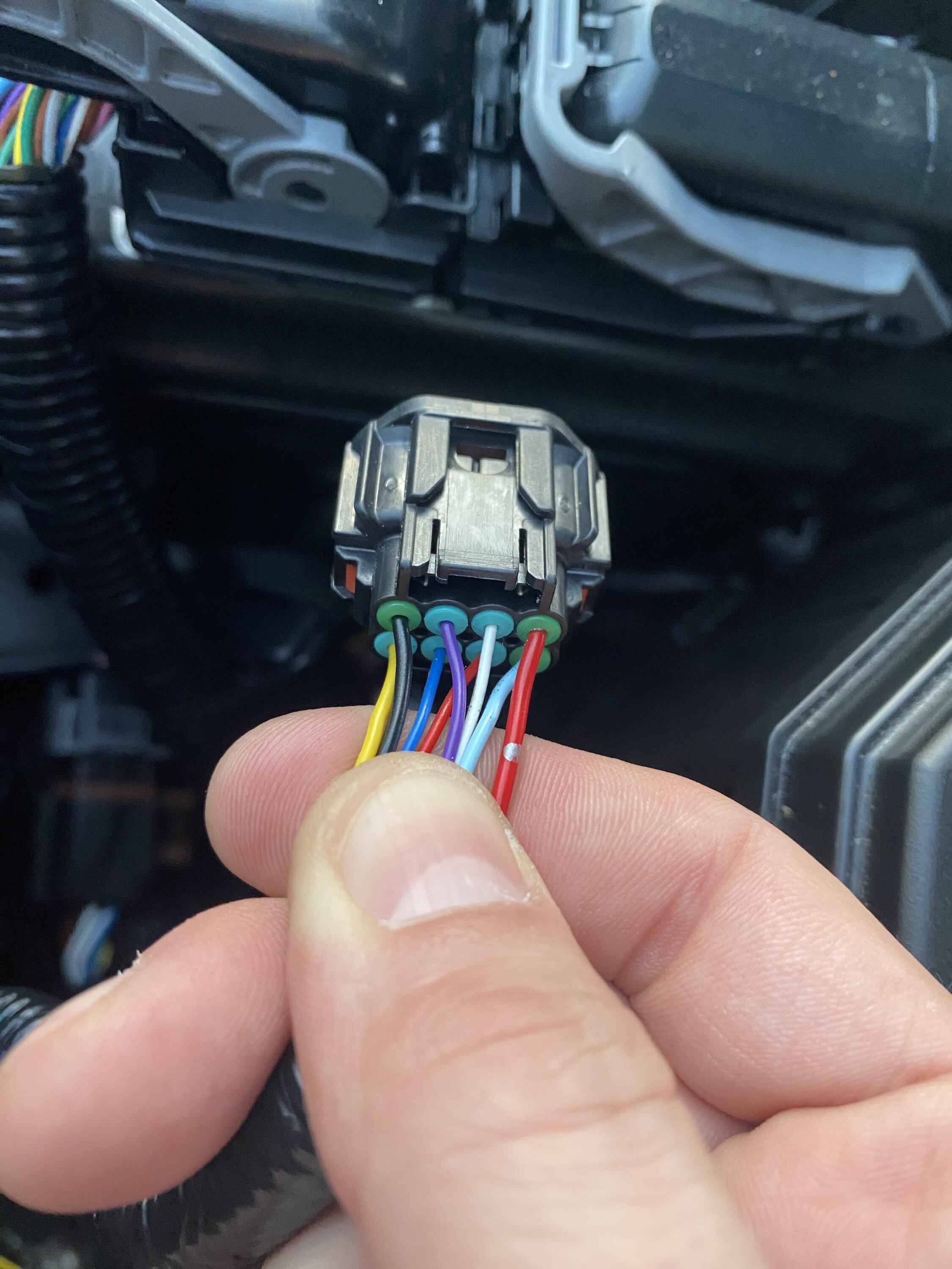

Hey All,
Here is a picture of the Left Light Wiring Harness. Picture from 2023 Honda Civic Sport
11th Gen Honda Civic Headlight schematics? IMG_4326

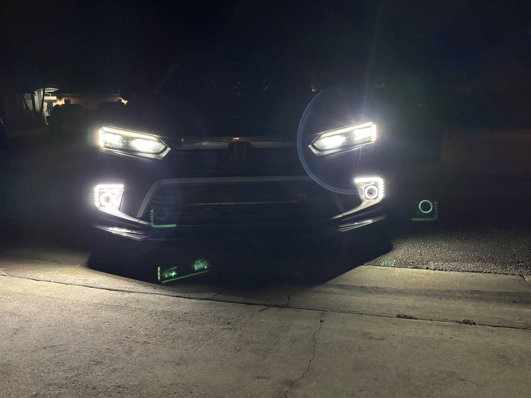

I personally have installed these and just need to finish up the wiring. It is a fog light with halo ring and also signal.
11th Gen Honda Civic Headlight schematics? Img Light

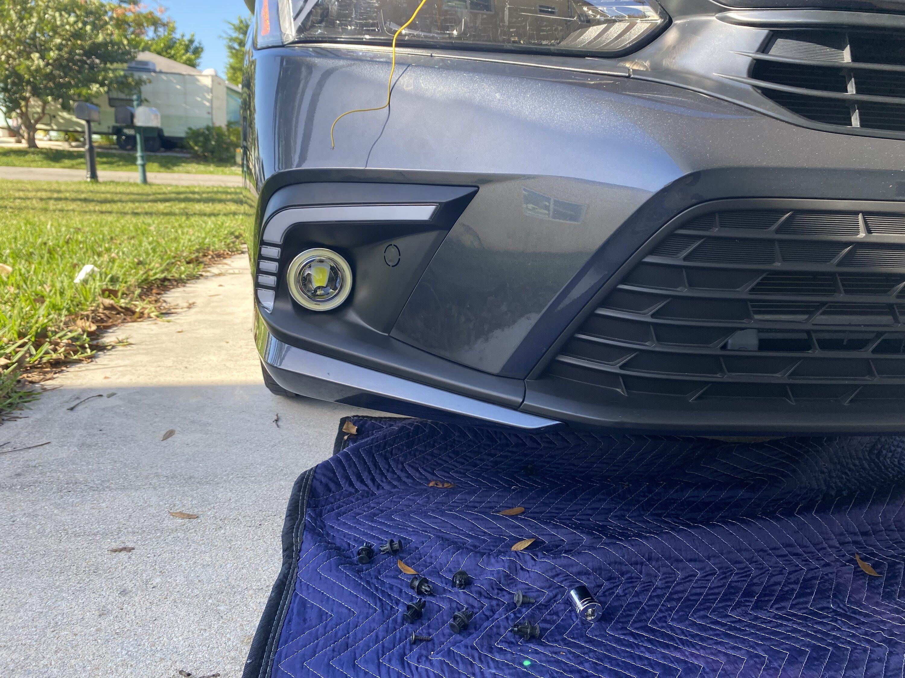

I was hoping someone could provide some advice in tapping into the existing wiring harness. I would prefer to reduce the amount of cutting and splicing into wires as possible. Does anyone recommend these Posi Taps over T-taps to reduce damage to existing harness? Or any other suggestions?
Thanks in Advance

Hey All,
Thanks in Advance
I'm trying to hook up this exact same set of fog lights to my 22 Honda Civic did you ever figure out the correct wires to connect these things to?
Hey, sorry for the late reply. I did end up getting it hooked up how I wanted it. I didn’t want to use the wire that changed the lights to blue. But I got them to work with the daytime running lights the signals and ran the wire for the fog lights. As of recently, one of the halo lights has dimmed significantly. I thought it may have been the wiring, but I’m pretty sure the halo ring is dying out. I think I can replace it. I just haven’t looked into it.
11th Gen Honda Civic Headlight schematics? IMG_7835
