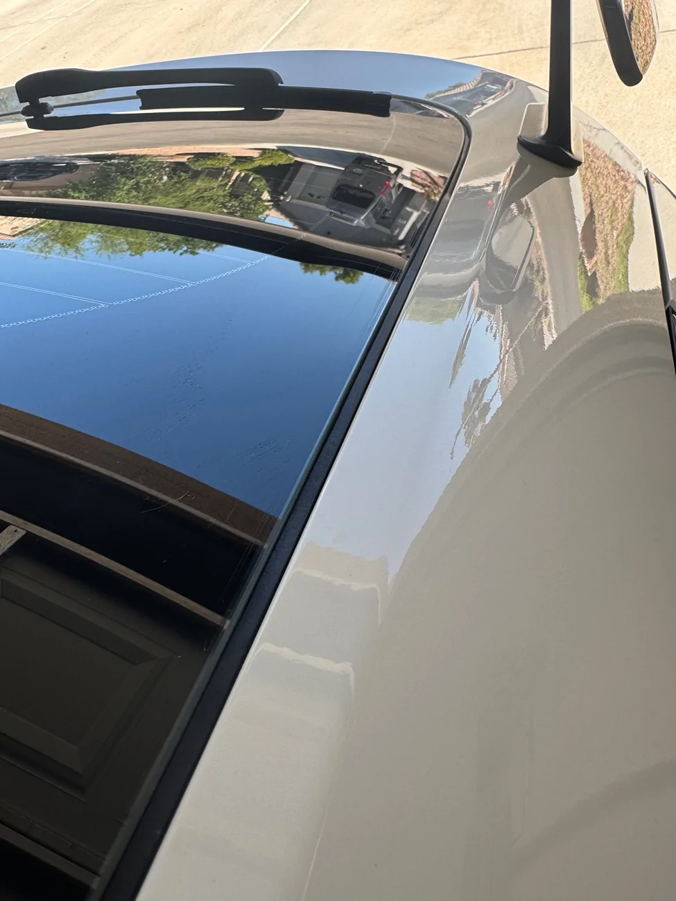

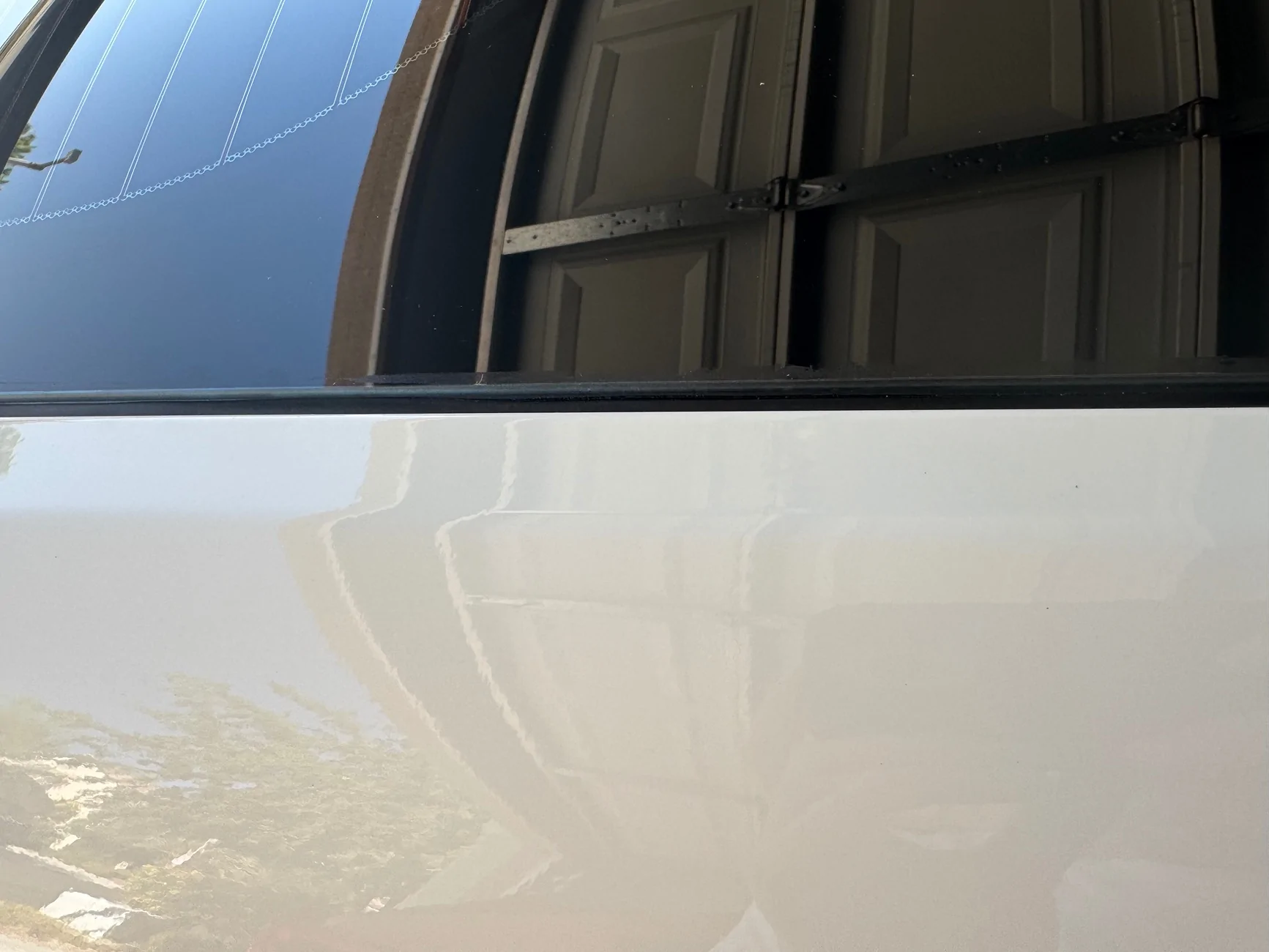

Anyways one thing I noticed was the weather stripping around the hatch glass looking off. Seems like it was installed incorrectly to me and is sitting beneath the edge of the glass rather than on top to create a good seal. Water is going through the seal but not getting inside which is a plus I guess.
Can anyone confirm check out these pics and lmk if this looks right to you?

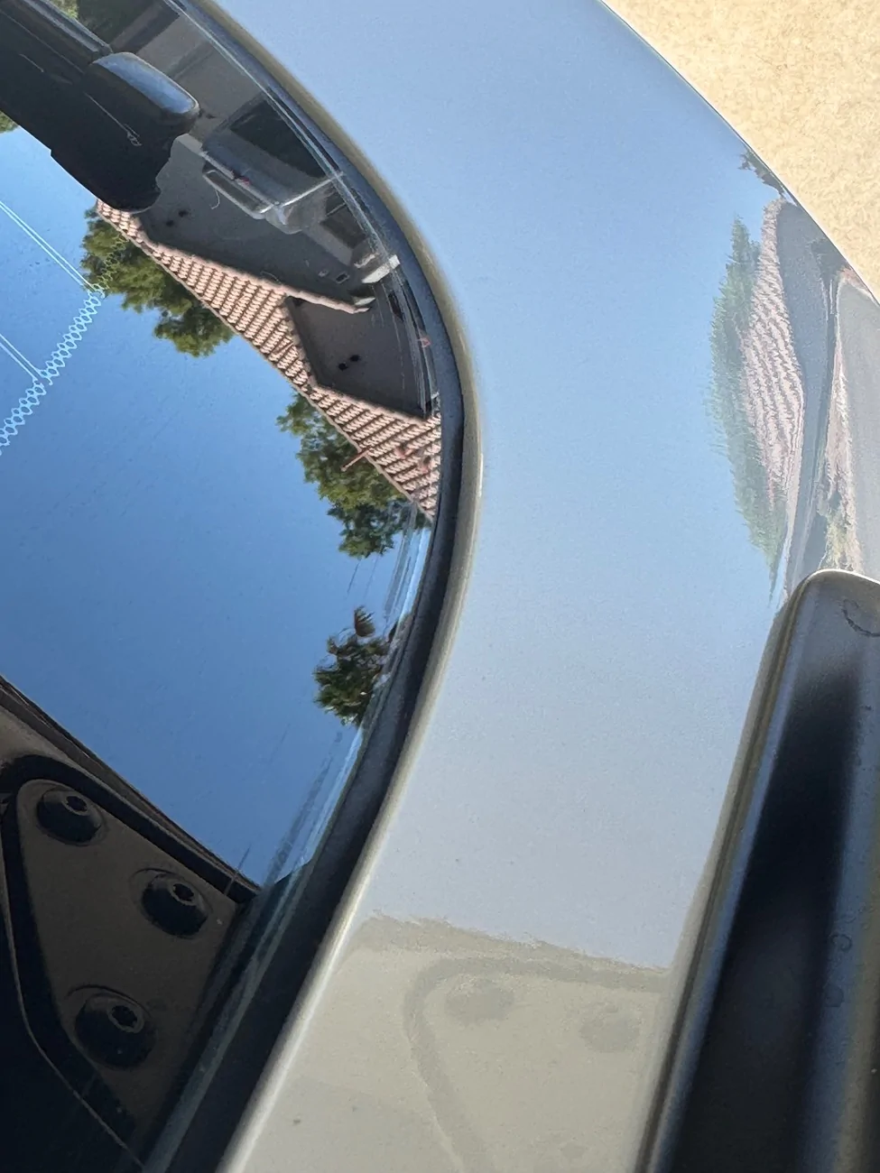

It’s kinda hard to get good pics but just snapped a few more. Not sure how well it’s captured in the images but to me the strip looks very sunken and can’t recall if this is how it’s supposed to fit. Also noticed a few gaps here and there.

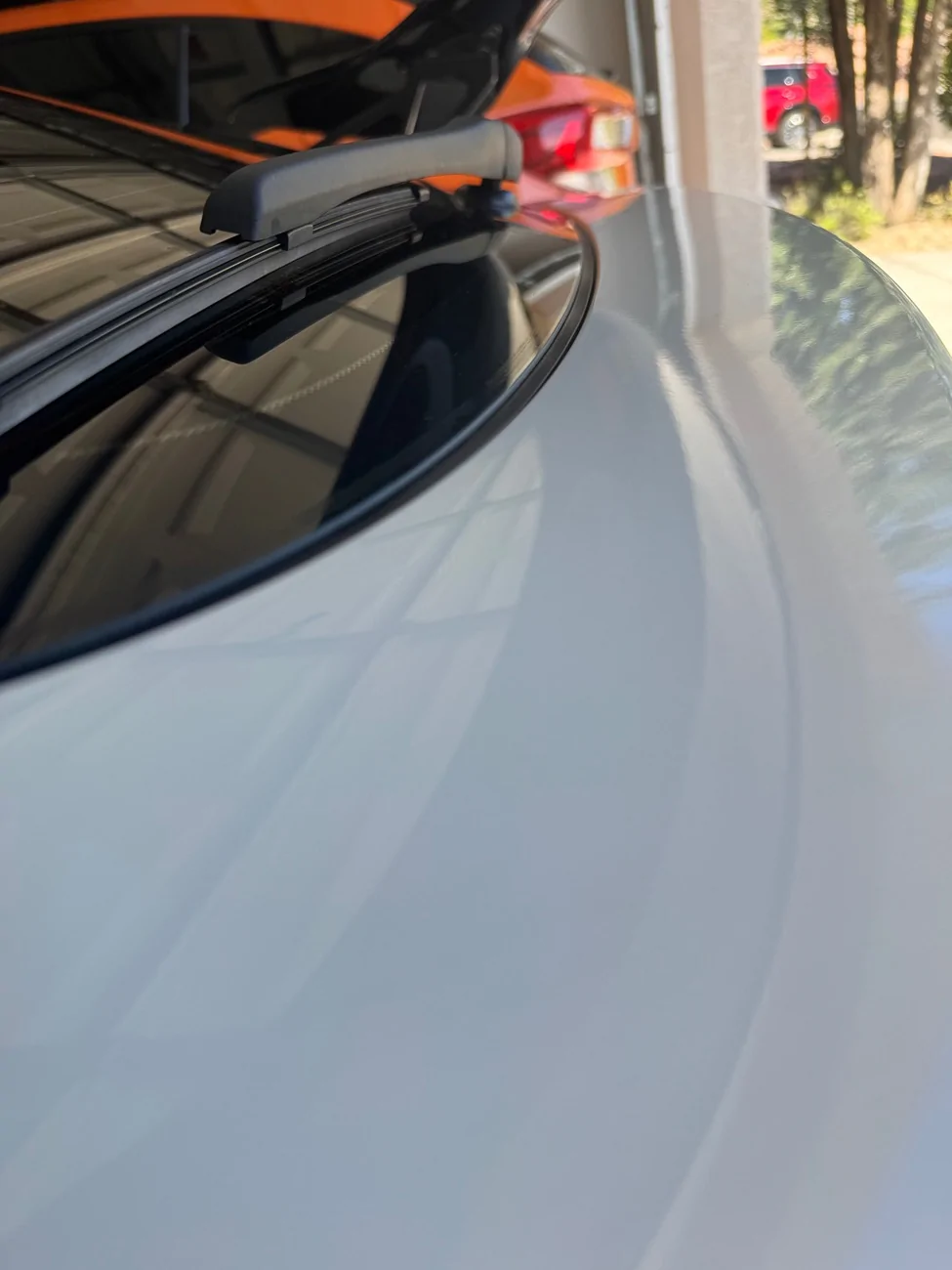

The rear window is bonded to the hatch, like a windshield. The rubber is just a trim strip, however my trim strip is very even from the factory.
You can probably scoot the trim strip around with a plastic pry tool, otherwise return to the body shop.
