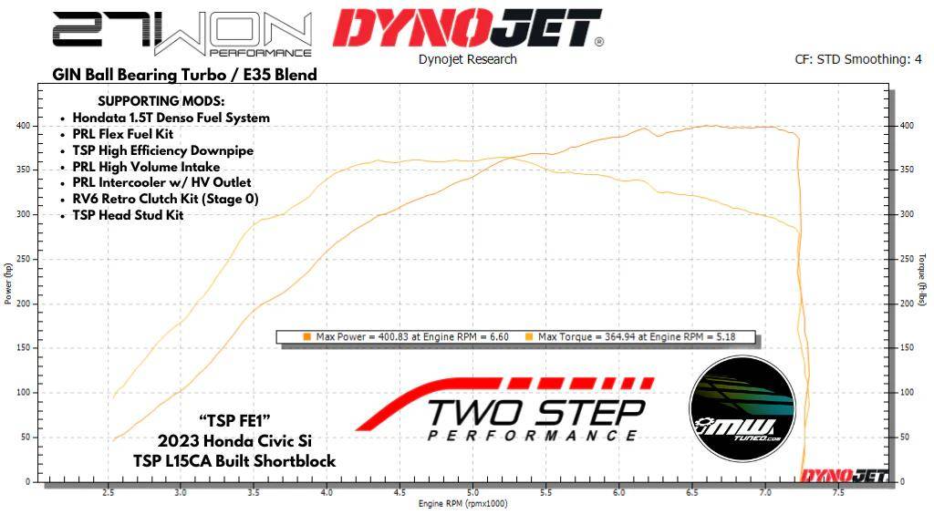

One of our passions at TSP is taking a stock, turbocharged car and adding a little...✨spice✨.
We've applied this to many of our builds, and are applying it to our 2023 Civic Si as well.
Fun fact: our Si was the tester car during Stage One+ and Stage 2's development. It’s also playing a large role into upcoming tunes. ;)
Check out the progress so far!
11th Gen Honda Civic TSP FE1: a spicy Si - 400WHP and counting 1748031775972-ou

Built L15CA Longblock
TSP L15 Head Stud Kit
Boundary Oil Pump Gears
Wunderladen x TSP Oil Pan Baffle
Wunderladen Rear Camshaft Plate
Hondata Denso Fuel System Upgrade
Spoon Magnetic Oil Drain Bolt
Skunk2 Ultra Valve Springs, Base, and Retainer Kit
JE Pistons 73.5 / 10.3:1
Saenz Performance S-Series Rods
Wunderladen Timing Cover Plate
Wunderladen 75A Rear Motor Mount
Wunderladen Passenger Motor Mount
Wunderladen Transmission Mount
Bolt Ons
PRL High Volume Intake (Standard Bore)
PRL HVI Cold Air Intake Duct
27WON Air Intake Snorkel
PRL Turbo Inlet Pipe
PRL Front Mount Intercooler
PRL Charge Pipe Upgrade
PRL High Volume Intercooler Outlet
27WON Gin BB Turbo Upgrade
TSP x PTP Turbo Blanket
TSP High Efficiency Downpipe
PRL Motorsports Front Pipe
Thermal R&D Frontpipe-Back Exhaust
CSF Aluminum Radiator & 1.4b Cap
Acuity Reverse Flow Radiator Hoses
Wunderladen Racing Oil Catch Can (PCV)
Tuning
KTuner V2
Custom Flex Fuel Tune by DRob @ IMW
27WON Honda 4 Bar MAP Sensors
PRL Flex Fuel Kit

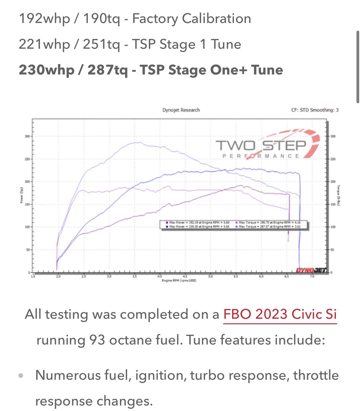

So how does tsp stage 1 claim claim 241whp / 286tq but then on tsp stage 1+ they claim stage 1 makes less at 221whp / 251tq and
230whp / 287tq on TSP Stage One+??
What am I missing here?
All Dynos and cars test different. The testing done for the Stage 1 tune was completed with a different car and Dyno than the Stage One+ tune. Due to this, they can not be compared. To remedy this, we provide a full data set with a single vehicle for the Stage One+ tune listing:
192whp / 190tq - Factory Calibration
221whp / 251tq - TSP Stage 1 Tune
230whp / 287tq - TSP Stage One+ Tune
The best way to compare the two tunes is to simply use the differences between the factory calibration and each tune.
I hope that helps clear up any confusion!
