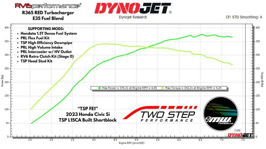

Dropped in the 27WON Gin & tuned by DRob 93/E25 blend. Below is the comparison of the R365 (black/red) and Gin in case you were curious!
11th Gen Honda Civic TSP FE1: a spicy Si - 400WHP and counting Untitled_design_-_2023-11-08T100302.639_2048x2048

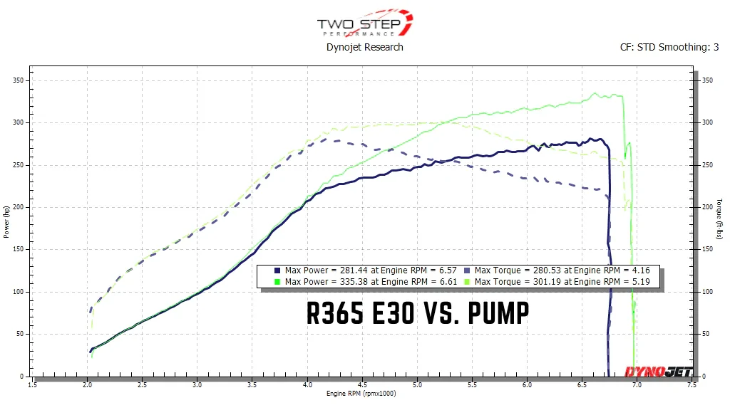

We have not gotten results yet on pump, but do expect it to make similar results to the R365 on pump (281whp/280tq). Both turbos are pretty comparable and perform fantastic. Check out our video from the Gin Install.

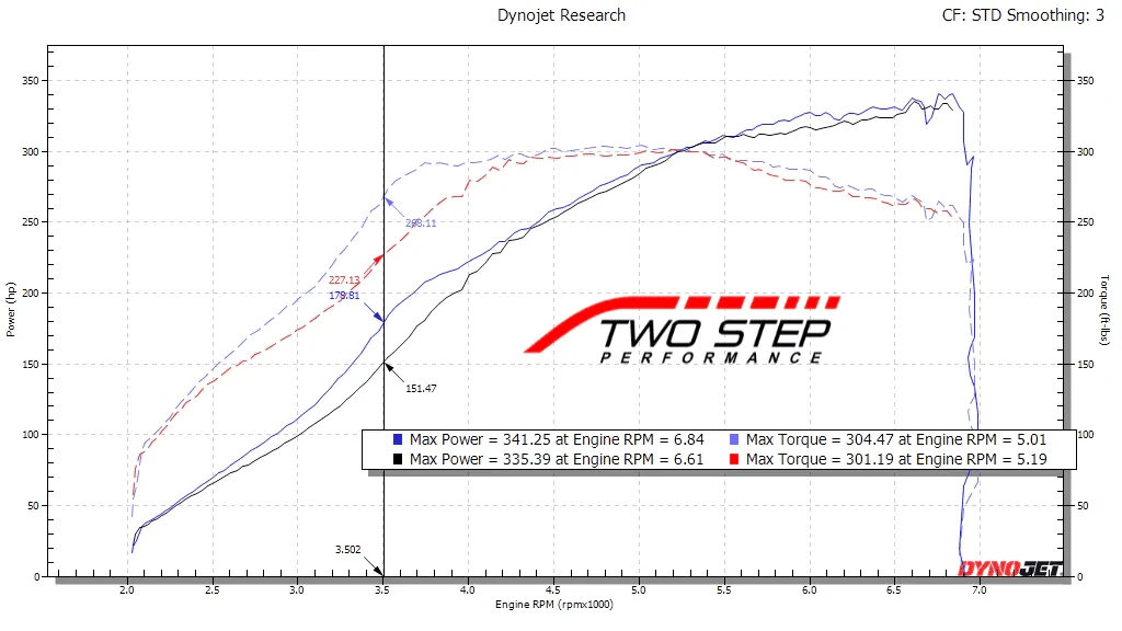

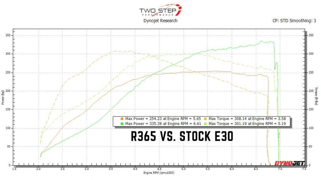

Stock turbo / TSP 2 / 93 & E30 blend vs. R365 / Custom / 93 & E30 blend
11th Gen Honda Civic TSP FE1: a spicy Si - 400WHP and counting 1700147450545
R365 / Custom / Pump 93 vs. R365 / Custom / 93 & E30 blend
11th Gen Honda Civic TSP FE1: a spicy Si - 400WHP and counting 1700147457723
R365 / Custom / 93 & E30 blend vs. GIN / Custom / 93 & E25 blend
11th Gen Honda Civic TSP FE1: a spicy Si - 400WHP and counting 1700147472517

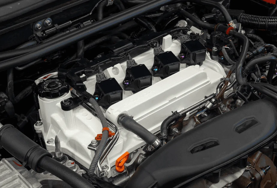

Our new Cerakoted Valve Cover for the 1.5T on the shop Si. Had to grab the white to match the wheels. :p
11th Gen Honda Civic TSP FE1: a spicy Si - 400WHP and counting 1703002622376
11th Gen Honda Civic TSP FE1: a spicy Si - 400WHP and counting 1703002649348

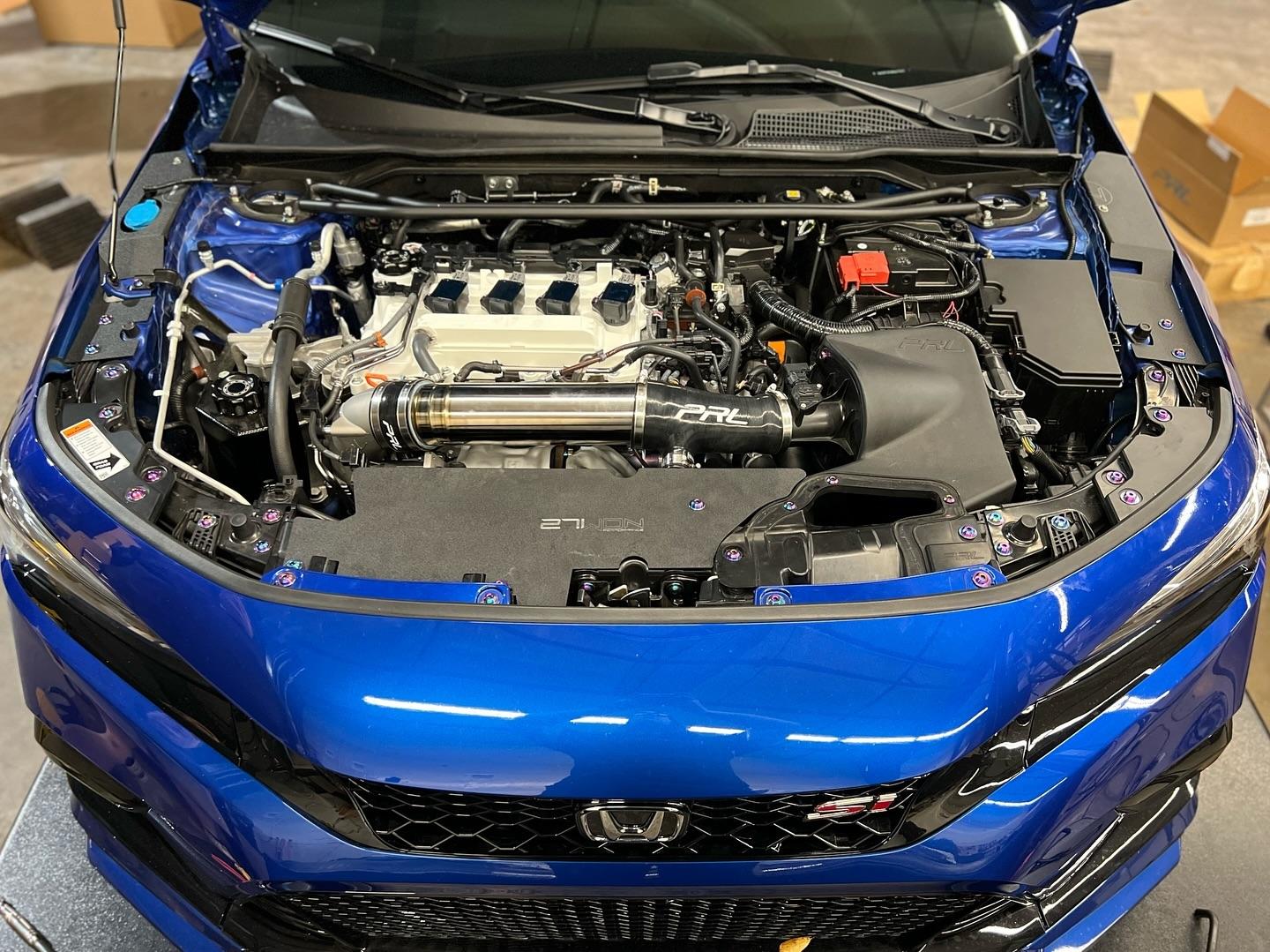

New PRL Inlet Pipe on! :D
Interestingly, this eliminates the weird "whine" that is present with upgrading the turbo. Turbo sounds are definitely increased with this setup and it sounds so good!
11th Gen Honda Civic TSP FE1: a spicy Si - 400WHP and counting 419700905_3668575410135780_8868926498806536521_n

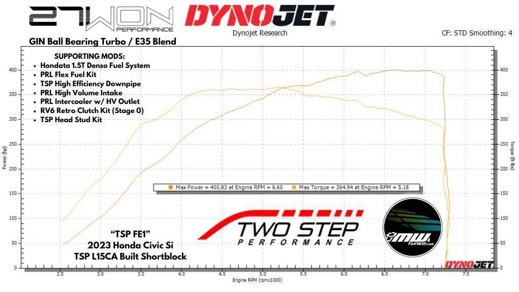

Another update. We have officially reached 400whp - this time, with the Gin at 40psi.
11th Gen Honda Civic TSP FE1: a spicy Si - 400WHP and counting 1748032194320-kd
