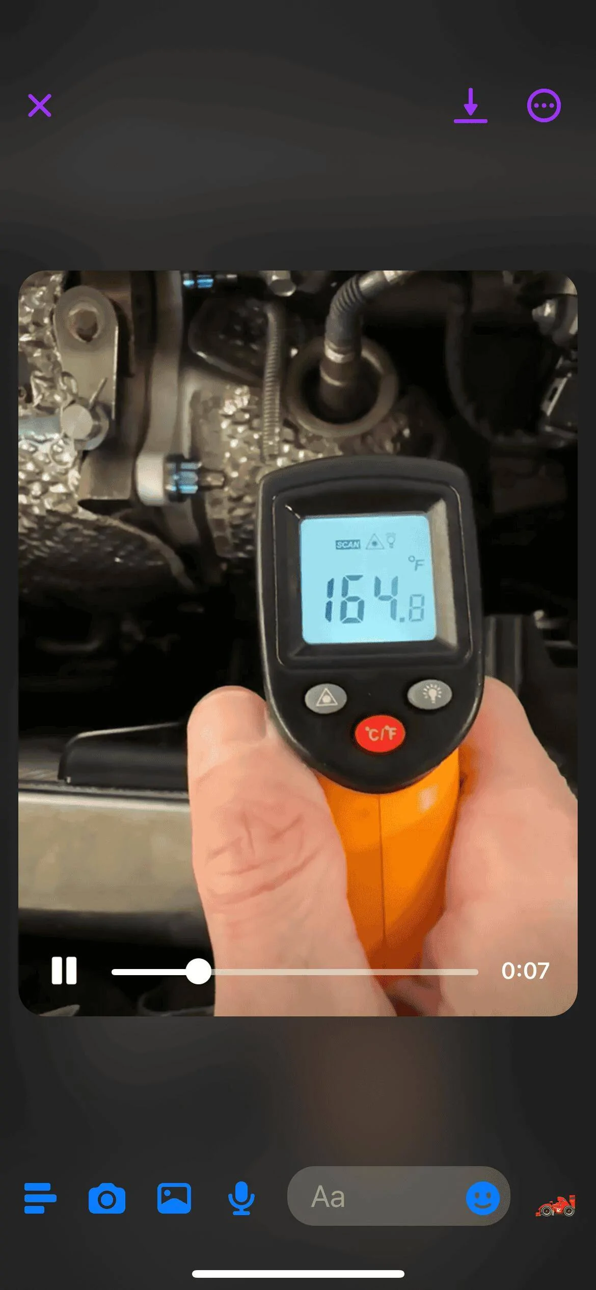

Is there any solid metrics that would indicate doing this is effective?

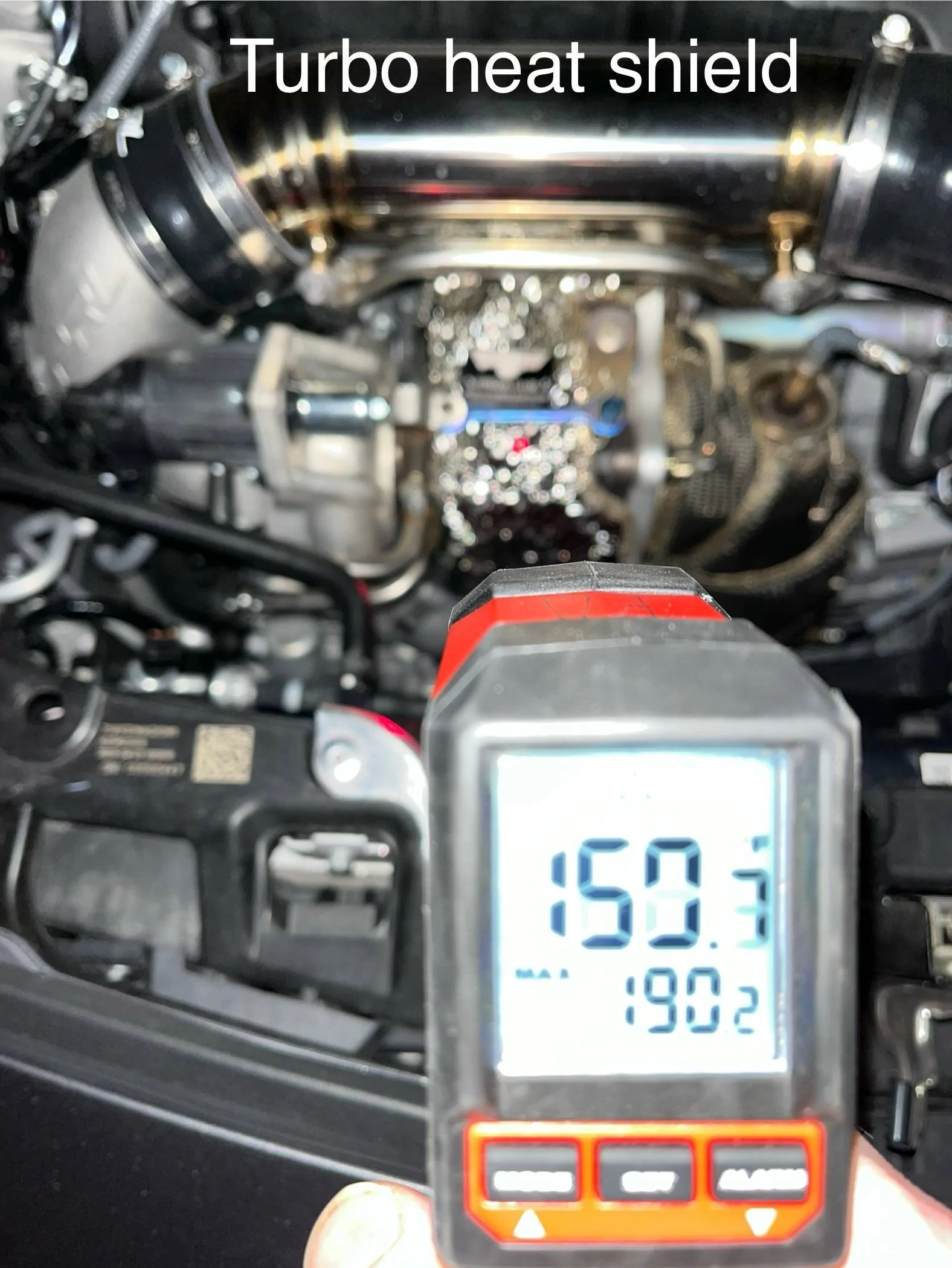

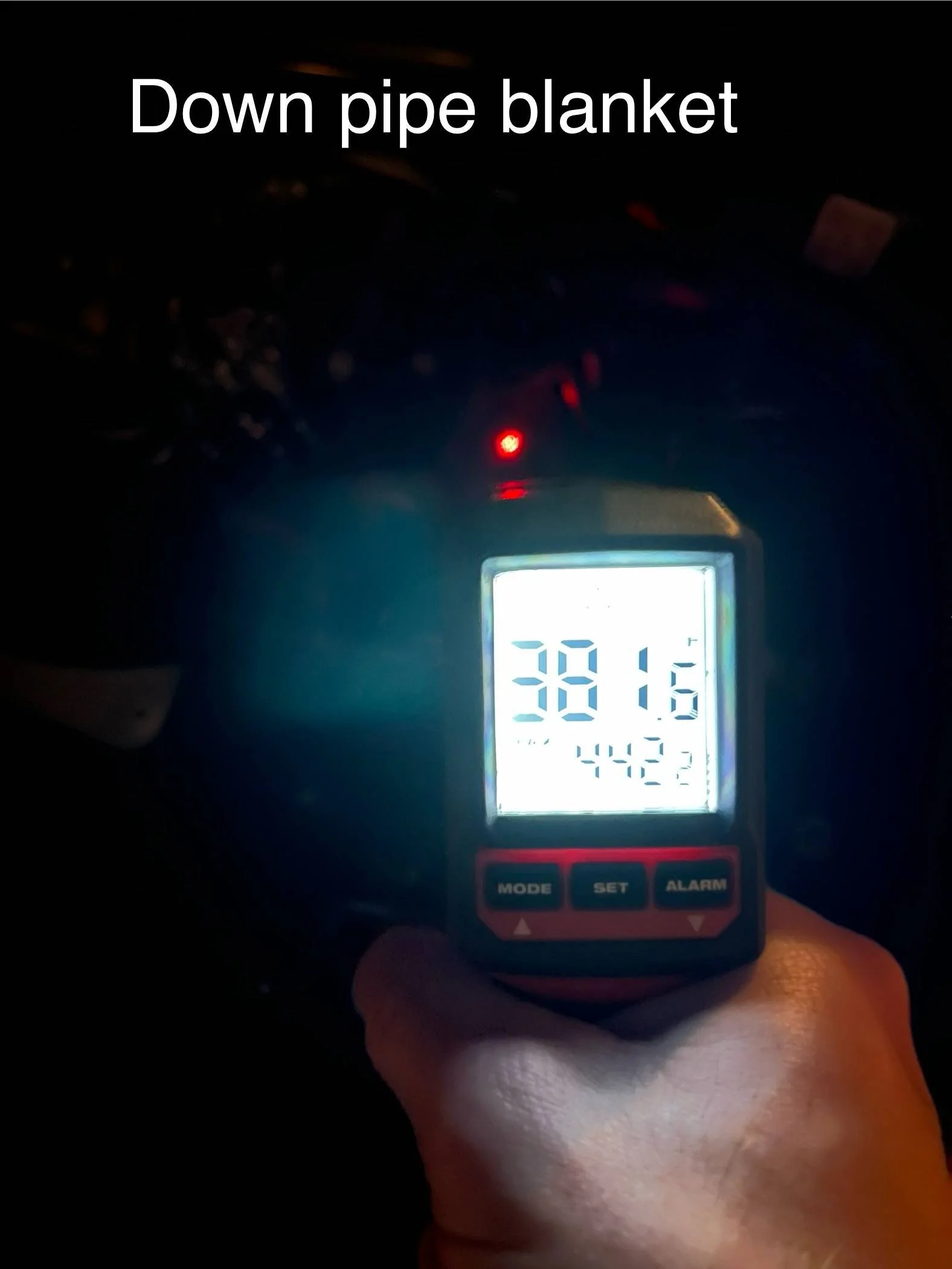

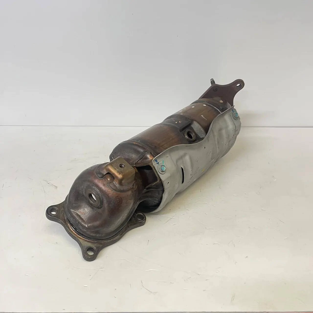

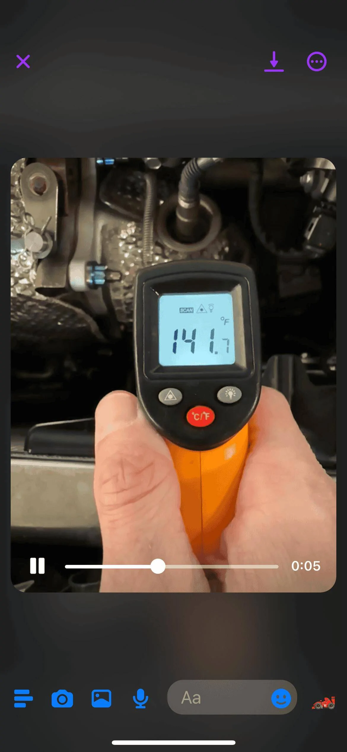

Some things to ponder/consider...The OEM downpipe as pictured weighs ~23 pounds 12.62 pounds and has shielding only on the front side so a lot of heat is stored and radiated towards the block/under hood. Here is a PIC and additional ones can be found here.
11th Gen Honda Civic Swain Tech Coated TSP Downpipe w/ Thermal Heat Insulation 1746918864144-i0

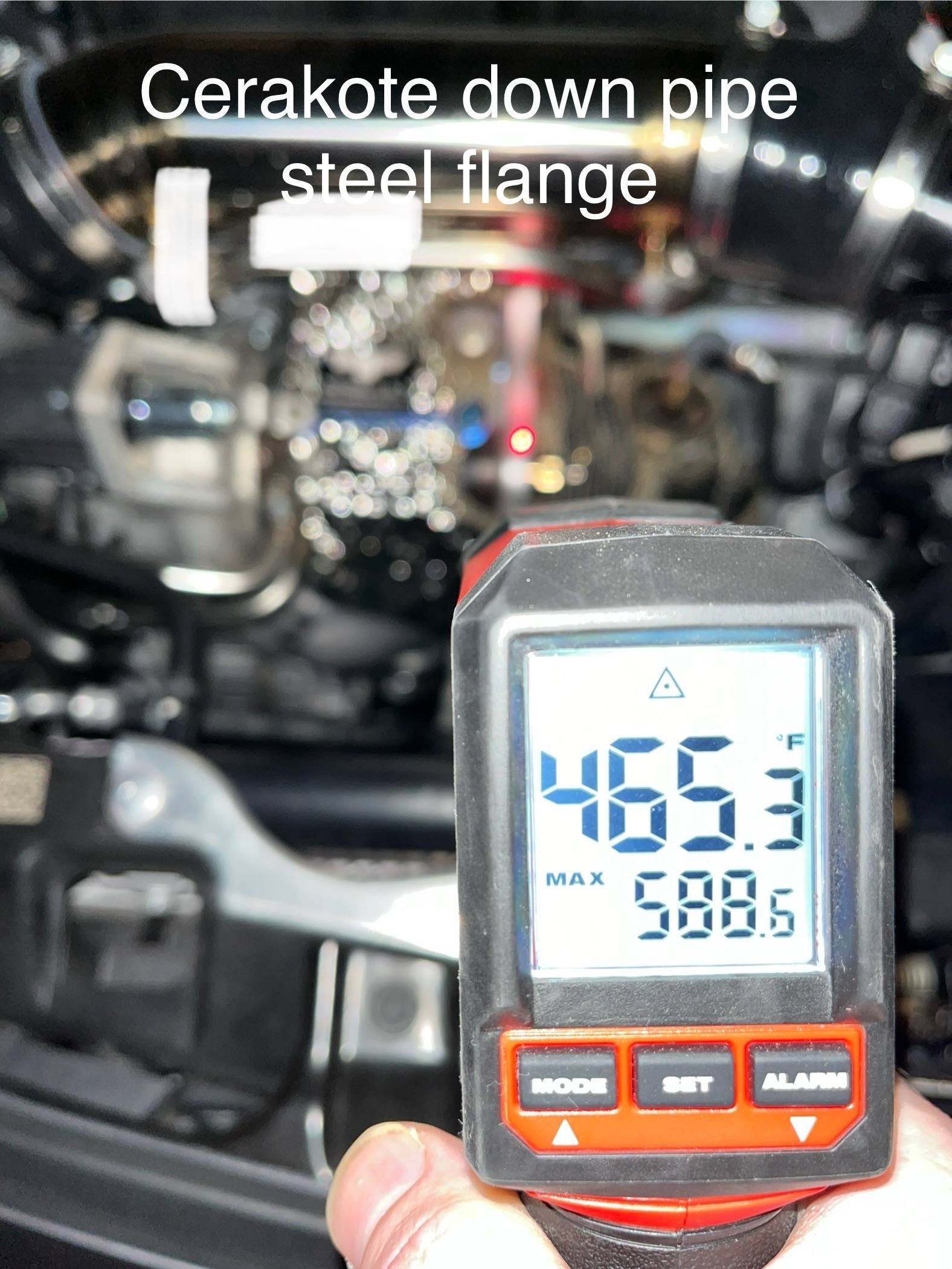

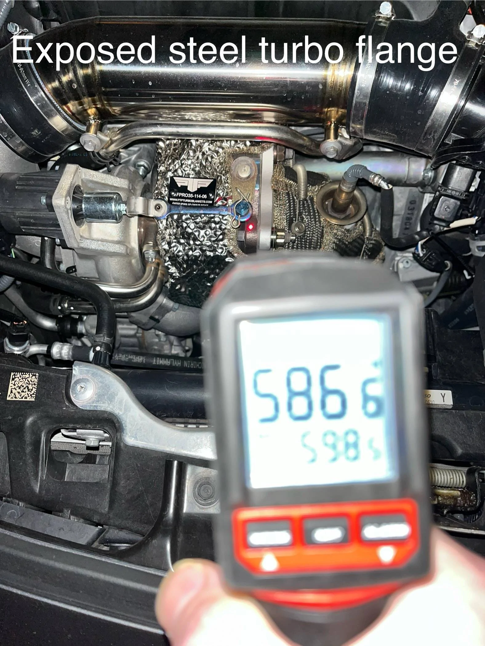

A big thank you to @Bpebler for checking various temperatures. Here are two pertinent posts that he shared on integraforums.com:
Temp measurements using PTP hybrid turbo blanket with lava downpipe blanket
Temps with PTP hybrid downpipe blanket
PICs without clicking links:
11th Gen Honda Civic Swain Tech Coated TSP Downpipe w/ Thermal Heat Insulation img_1958-jpeg
11th Gen Honda Civic Swain Tech Coated TSP Downpipe w/ Thermal Heat Insulation img_1957-jpeg
11th Gen Honda Civic Swain Tech Coated TSP Downpipe w/ Thermal Heat Insulation img_1942-jpeg
11th Gen Honda Civic Swain Tech Coated TSP Downpipe w/ Thermal Heat Insulation img_1956-jpeg

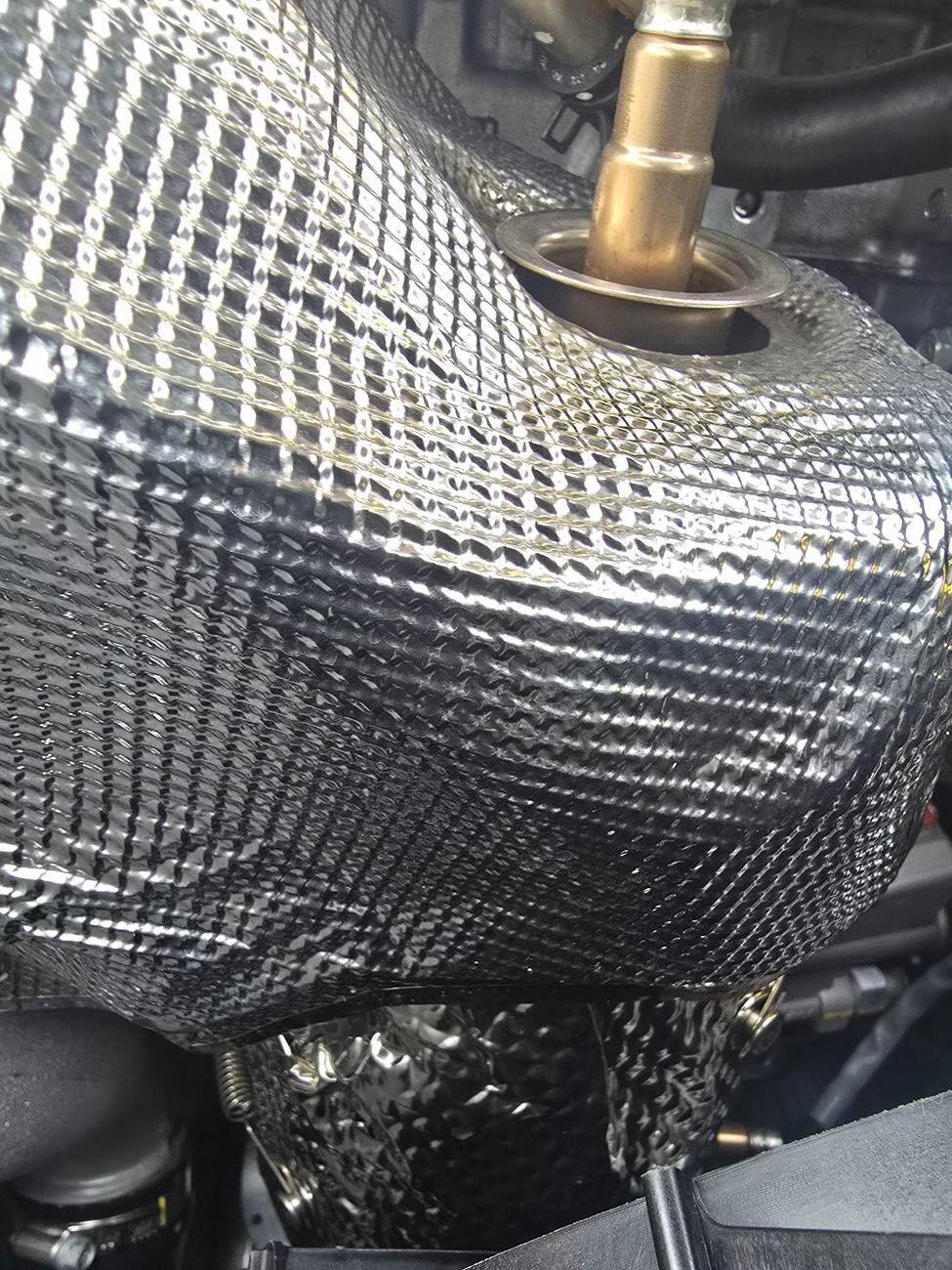

PTP hybrid downpipe blanket:
11th Gen Honda Civic Swain Tech Coated TSP Downpipe w/ Thermal Heat Insulation img_2105-png
11th Gen Honda Civic Swain Tech Coated TSP Downpipe w/ Thermal Heat Insulation img_2104-png

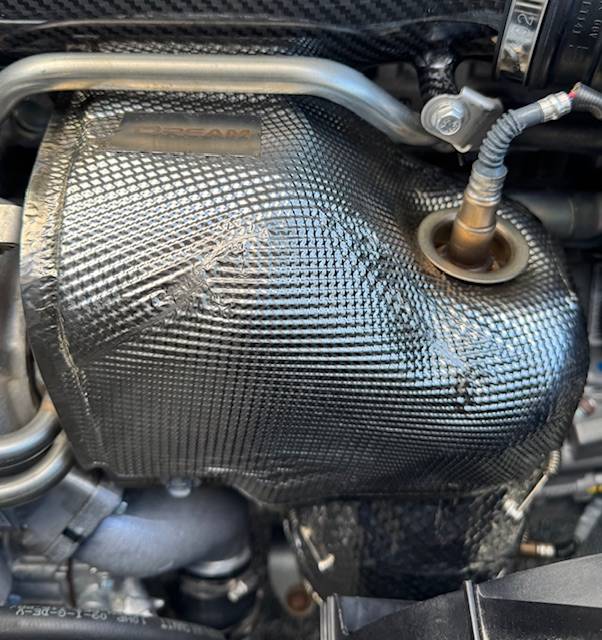

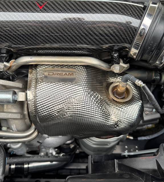

Another forum member sent me this PIC of the Dream Automotive heat shield (direct replacement for the OEM turbo heat shield) installed over the PTP hybrid downpipe blanket:
11th Gen Honda Civic Swain Tech Coated TSP Downpipe w/ Thermal Heat Insulation 1746924697584-mh

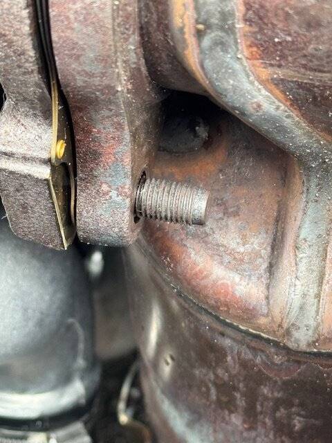

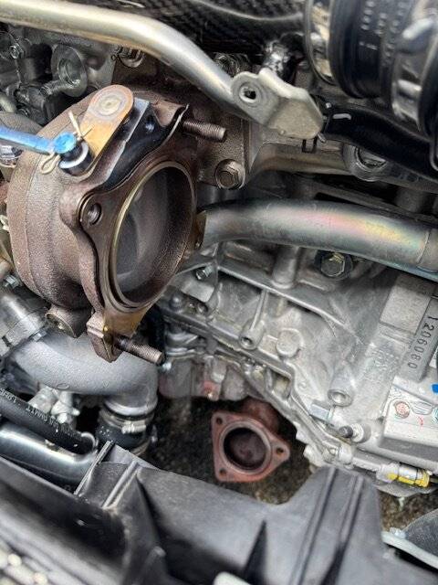

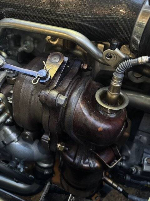

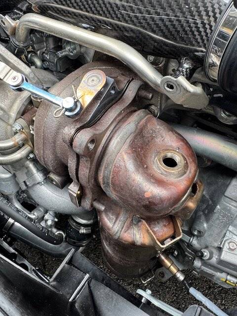

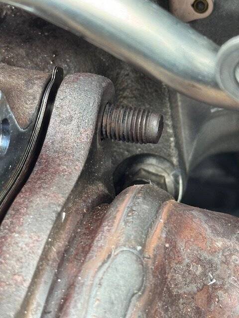

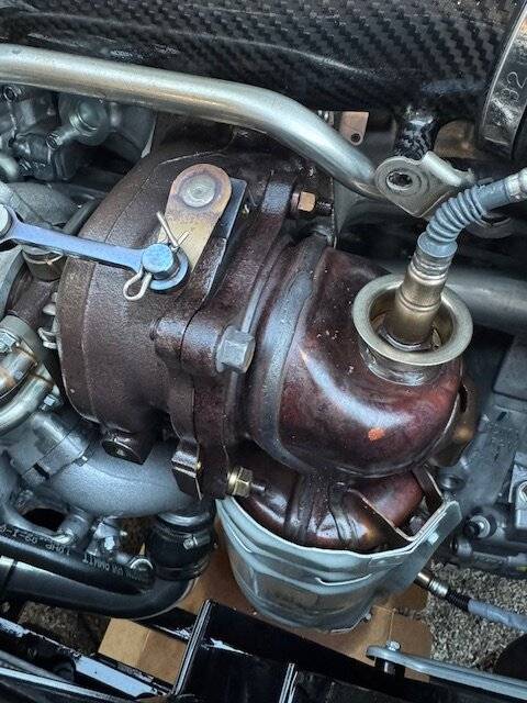

Thanks...Removal was a piece of cake. All of the nuts/bolts broke loose and were removed without causing any thread damage. Soaking overnight after being sprayed with PB Blaster and then Kroil several hours later worked out very well.
Here are PICs after degreasing (I have replacement studs for the turbine connection but will reuse the factory studs since they are in great shape):
11th Gen Honda Civic Swain Tech Coated TSP Downpipe w/ Thermal Heat Insulation IMG_1657
11th Gen Honda Civic Swain Tech Coated TSP Downpipe w/ Thermal Heat Insulation IMG_1658
11th Gen Honda Civic Swain Tech Coated TSP Downpipe w/ Thermal Heat Insulation IMG_1661

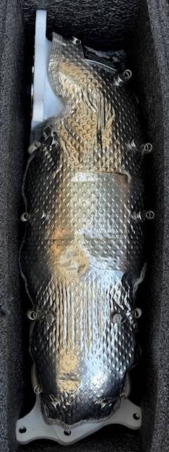

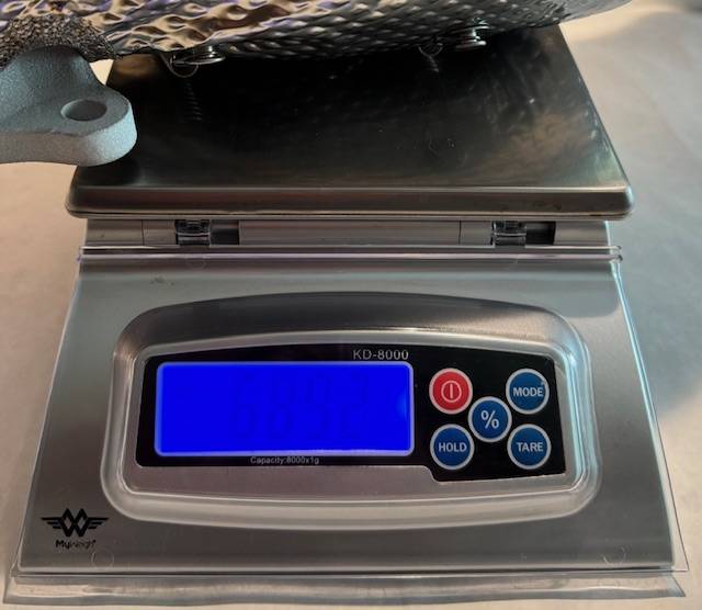

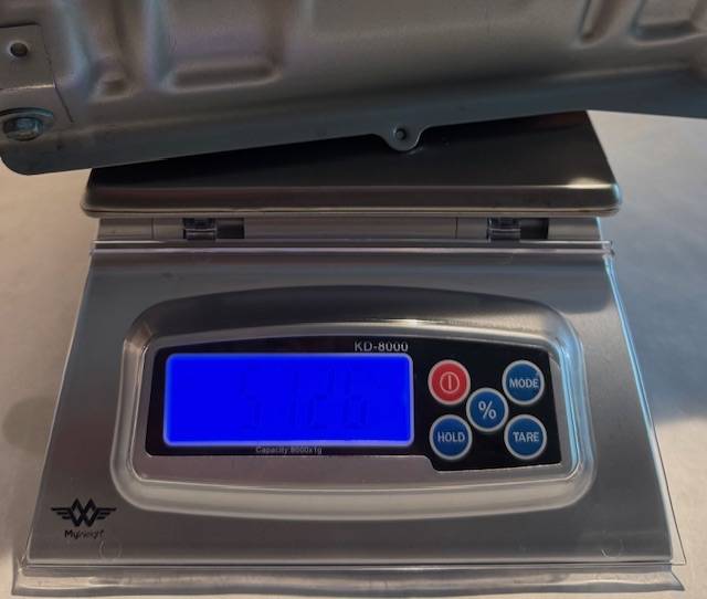

I went back and edited weight references in this thread regarding the OEM downpipe. I read somewhere previously that it weighed ~23 pounds. It actually weighs much less being 5,726 grams or 12.62 pounds with the OEM side heat shield installed. The OEM turbo heat shield weighs 602 grams or 1.33 pounds. (total of 6,328 grams or 13.95 pounds of weight removed).
Regarding weights for the TSP downpipe:
  1. Raw (uncoated): 6,041 grams
  2. Swaintech coated: 6,165 grams
  3. Swaintech coated with PTP hybrid downpipe blanket and springs: 6,892 grams
So this particular replacement adds 564 grams or 1.24 pounds of additional weight as compared to the OEM downpipe. No big deal but it is definitely not a 10+ pound weight savings as I originally thought it might be.
11th Gen Honda Civic Swain Tech Coated TSP Downpipe w/ Thermal Heat Insulation IMG_1662
11th Gen Honda Civic Swain Tech Coated TSP Downpipe w/ Thermal Heat Insulation IMG_1664
11th Gen Honda Civic Swain Tech Coated TSP Downpipe w/ Thermal Heat Insulation IMG_1663

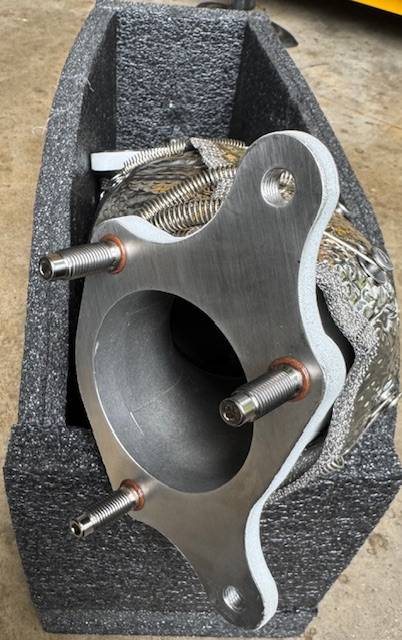

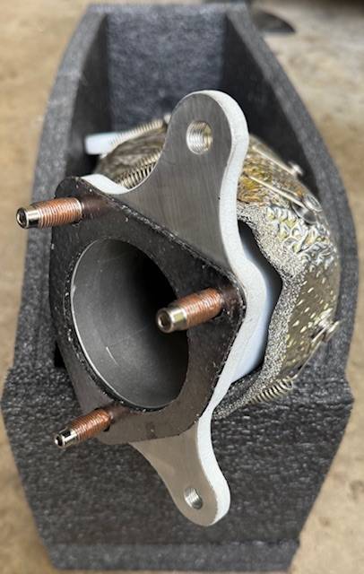

Installed titanium studs. Copper anti-seize was also applied to all threaded connections.
11th Gen Honda Civic Swain Tech Coated TSP Downpipe w/ Thermal Heat Insulation IMG_1667
11th Gen Honda Civic Swain Tech Coated TSP Downpipe w/ Thermal Heat Insulation IMG_1669
Installed the downpipe. Nuts/bolts on the downpipe to turbine are torqued to 33ft lbs. Nuts/bolts on the downpipe to front pipe are torqued to 40ft lbs.

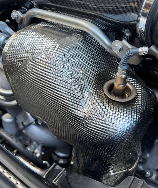

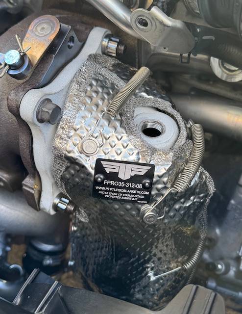

Installed the turbo heat shield over the downpipe blanket (with all springs installed). The heat shield has three holes for bolt connections. The hole on the side next to the O2 sensor is not used as it is covered by the downpipe blanket. It is not needed anyway since the O2 sensor clamps the heat shield down securely on that side. The heat shield installed right over the downpipe blanket without issue as if they were designed to be installed together. I am glad that I decided to go this route and really like the visual results and thermal coverage provided.
11th Gen Honda Civic Swain Tech Coated TSP Downpipe w/ Thermal Heat Insulation IMG_1677
11th Gen Honda Civic Swain Tech Coated TSP Downpipe w/ Thermal Heat Insulation IMG_1673

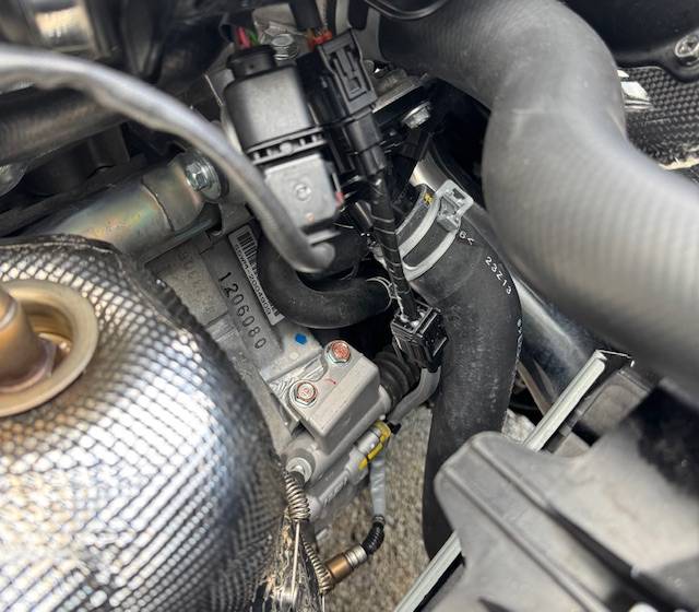

PIC of the O2 sensor harness extension where wires were wrapped with electrical tape and zip tie added on the bottom to prevent swinging around.

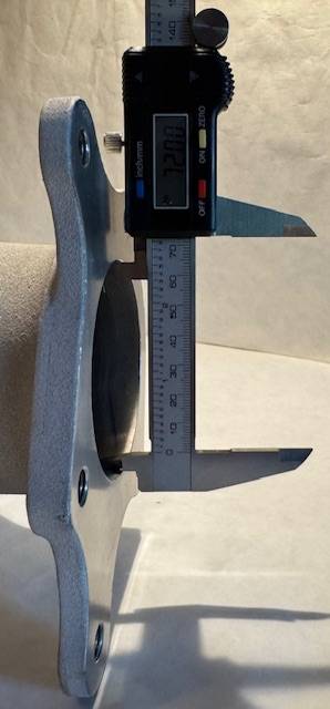

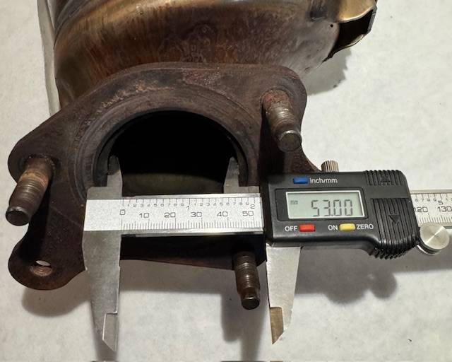

The OEM downpipe has a 53mm or 2.09" outlet.
11th Gen Honda Civic Swain Tech Coated TSP Downpipe w/ Thermal Heat Insulation IMG_1684
The TSP downpipe opens up the coffee straw restrictor with a 72mm or 2.83" outlet (35% increase).
