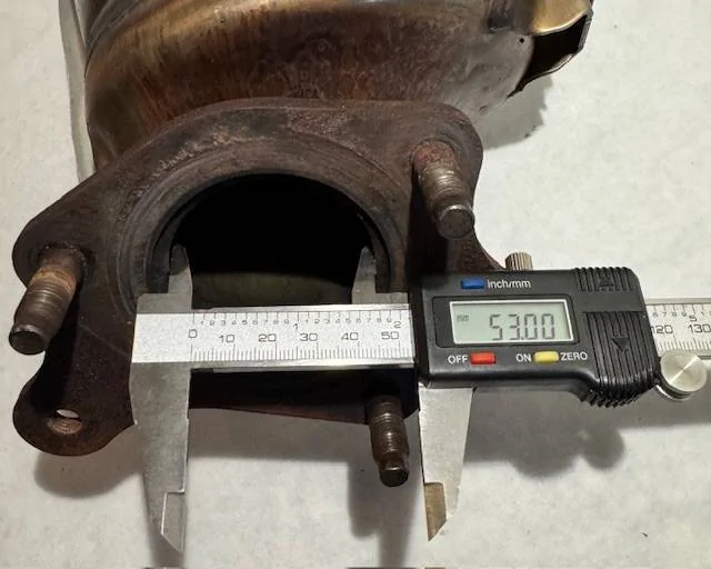

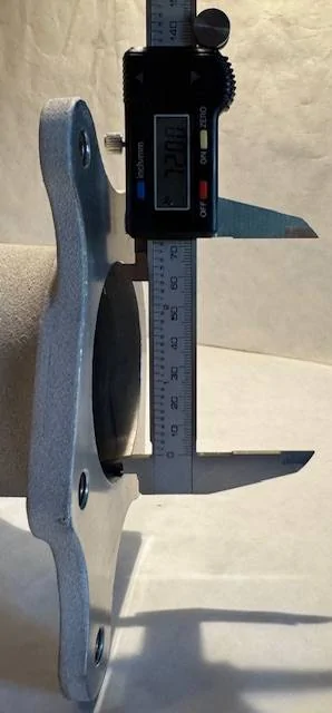

The OEM downpipe has a 53mm or 2.09" outlet.
The TSP downpipe opens up the coffee straw restrictor with a 72mm or 2.83" outlet (35% increase).
In the near future, the TSP downpipe will be mated with a Fujitsubo front pipe and exhaust (70mm or 2.76") where they should marry up very well. On the intake side, the OEM turbo compressor outlet is 50mm where I added HKS intercooler piping of 54mm going through a J's Racing intercooler.
I’m wondering what the stock
exhaust ID is after the front pipe. If that flange ID on the front pipe is smaller than the piping after, it would seem to be a significant restriction after replacing the downpipe. I would be up for upgrading the front pipe, but I’m not really wanting a louder exhaust, nor do I want to spend the money.

With the out end of the OEM downpipe being 53mm, the in end of the OEM front pipe is the same. I would imagine the out end of the front pipe to be the same size providing for a full 2" exhaust carried through to the back where the pipe splits.
Bump for me to check the ID of the out end on the OEM front pipe.

Better late than never...Inlet on the OEM front pipe is 60mm and the outlet is 56mm. Front pipe outlet also mates to a 57mm inlet used on the OEM exhaust.

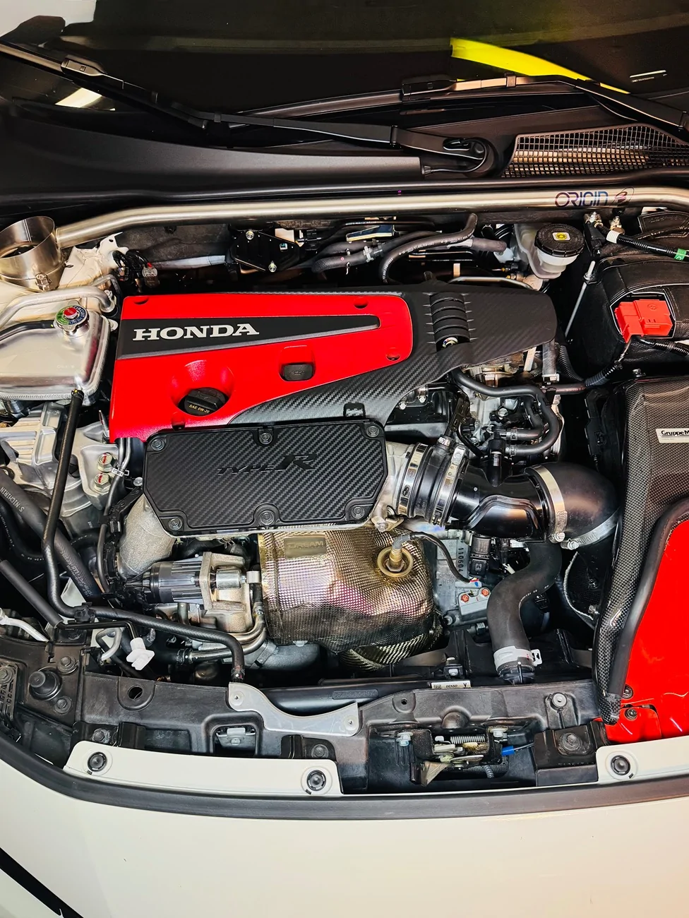

Would the hard lagged shield from Dream fit over a PTP blanket for the TSP DP as well as a Funk blanket for the turbo?
I agree with the assessment above. I am using that same setup minus the turbo blanket and it is a very tight fit. I don’t think anymore could be stuffed under the Dream cover as seen in the pic
How are you liking the Dream cover? I’m curious on if there are benefits like keeping hot air from the intake or if it just releases all the hot air a few inches over on the left side of the engine?
The OEM shield is a lot thinner and has some vents that allows hot air to vent all around it.
I have the PTP hard lagged downpipe blanket which makes sense in keeping the heat from the cat/downpipe inside and being pushed out of the exhaust Instead of radiating that heat to the engine, radiator and intake.
Wondering if I should add this Dream cover also as I track often.
But no other company has released a similar cover. Which makes me think, if it made a big difference, wouldn’t more companies make them?
Like the cooling trays that WOT started… now you have MDR, PLM, etc… copying them.
I think this is exactly what it does. On warm days (which is often in Texas) after a drive I open my hood in the garage to let it cool off that way. I have definitely noticed the radiant heat is noticeably less on the intake side. Other than that I haven’t discerned any other noticeable difference
