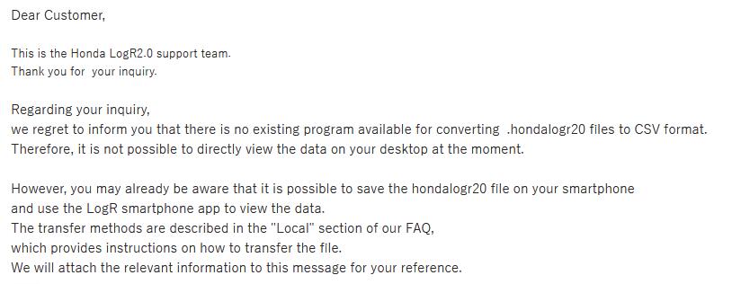

I asked if we could export the data and they were like nope. Would have been great to use something else for the timing, and integrate with the data from LogR

you mean export the data from the app (car or mobile device)?
Im traveling for work so Im not near my car but the app says you can export data to USB. Go to the FAQ inside the Log R app (im on iphone). It says "the in-vehicle app can export data to a USB memory". Plan to see if i can figure that out since the documentation...well..sucks.
you can, but it's not in a readable format to use elsewhere
