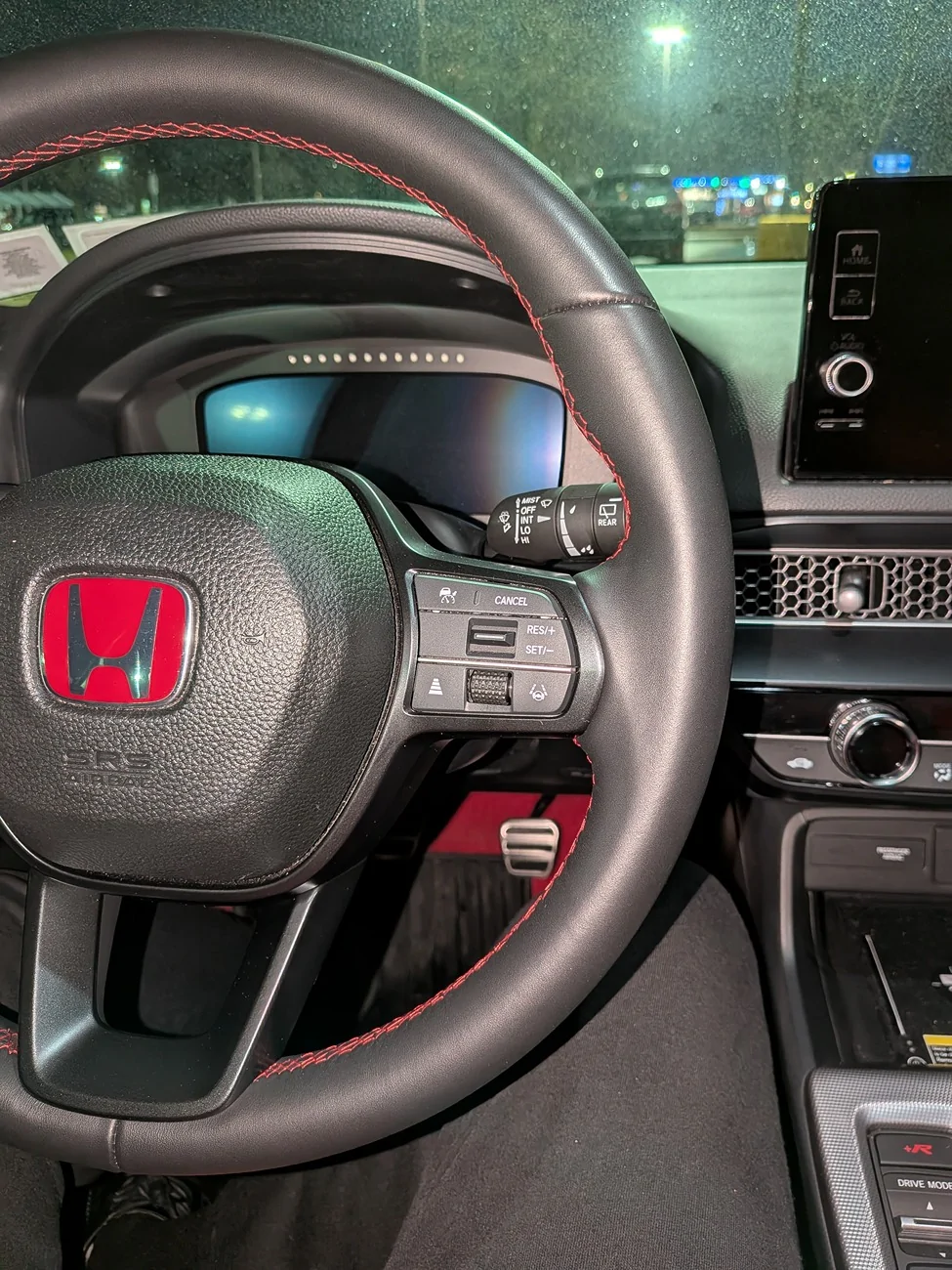

So I have an update and it's pretty mixed with the gyeon.
The actual cleaner itself might just be some rebranded sonax alcantara cleaner because it not only smells the same but, behaves the same on the steering wheel (only gyeon said to never get on upholstery).
Long story short, the cleaner worked really well (gave me a scare for a bit, since the bottle said not to use on real leather, but confirmed with gyeon that the type r wheel is fine since it's a coated/pre-treated natural leather), but the protective coat has been kinda iffy.

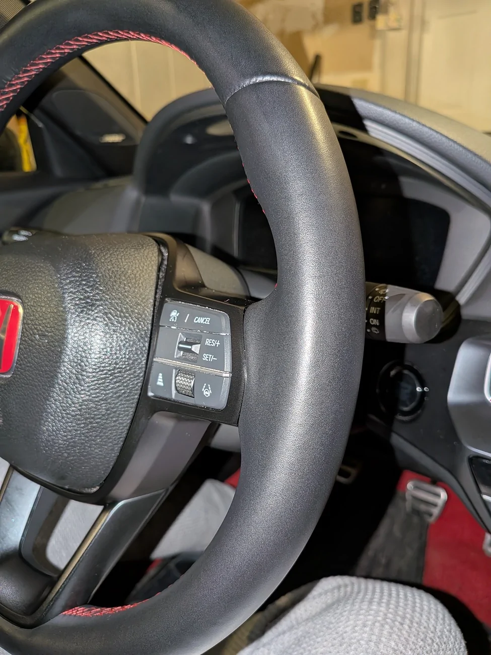

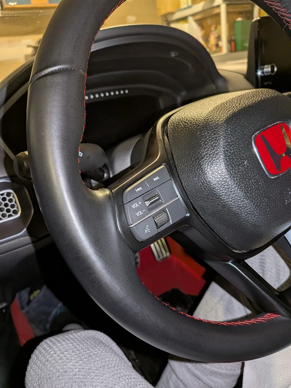

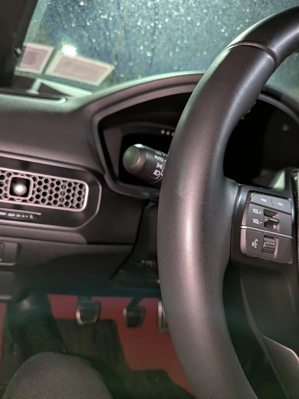

After cleaning with the leather cleaner my wheel was matte, I let it dry for a bit, then applied approximately 3 spritz of the coat lightly on the wheel using the provided pad. The finish after the first light brush felt kinda tacky once I let it dry, and I figured a another pass couldn't hurt. Here's what it looked like after the first pass.
11th Gen Honda Civic How do you clean the leather steering wheel? 6561
11th Gen Honda Civic How do you clean the leather steering wheel? 6562
11th Gen Honda Civic How do you clean the leather steering wheel? 6563

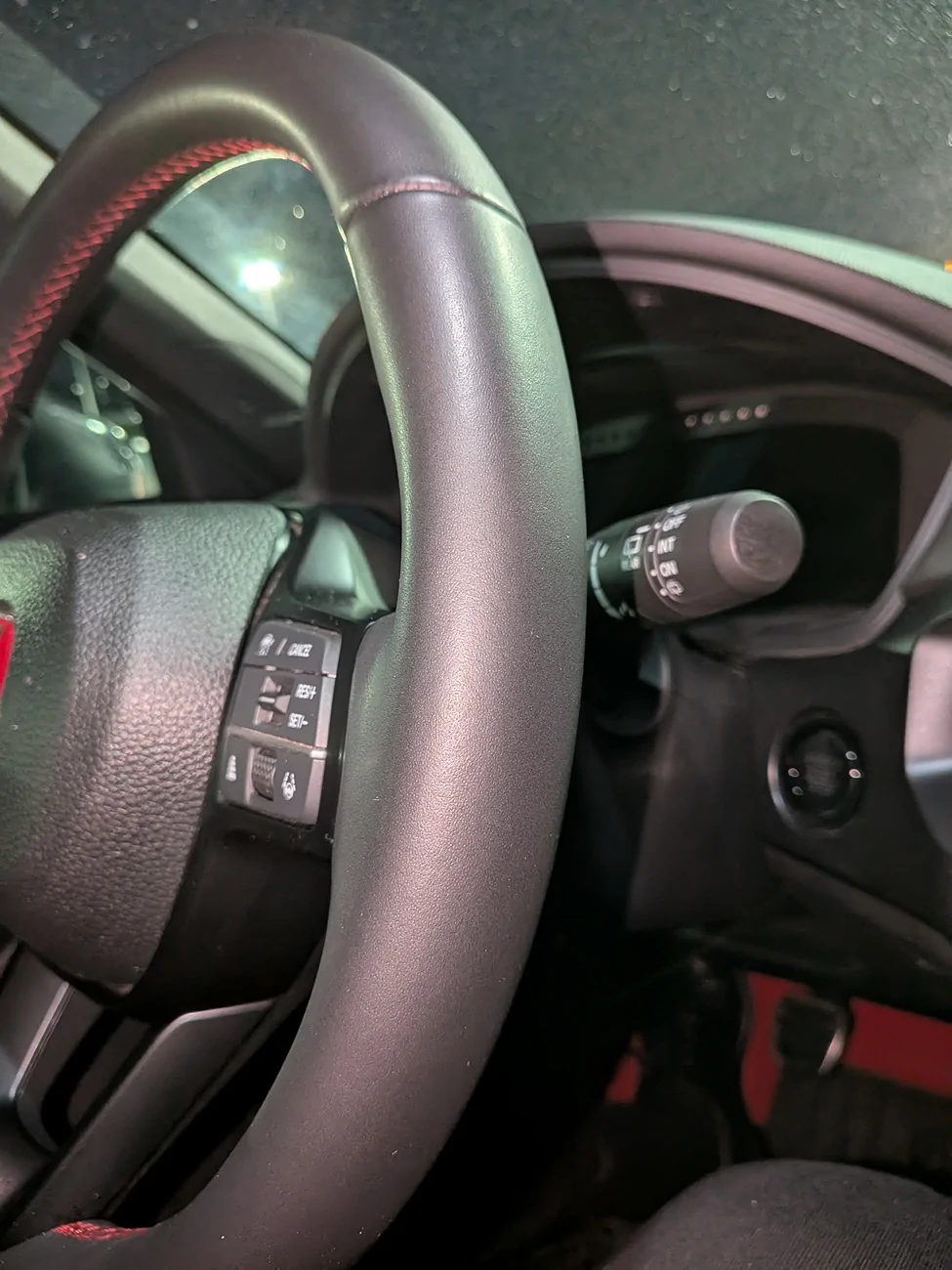

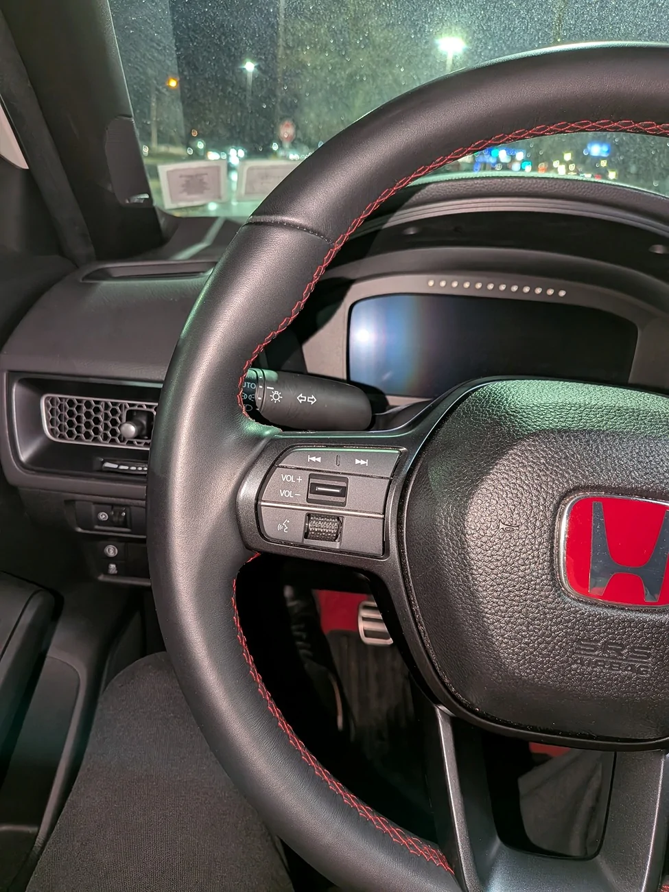

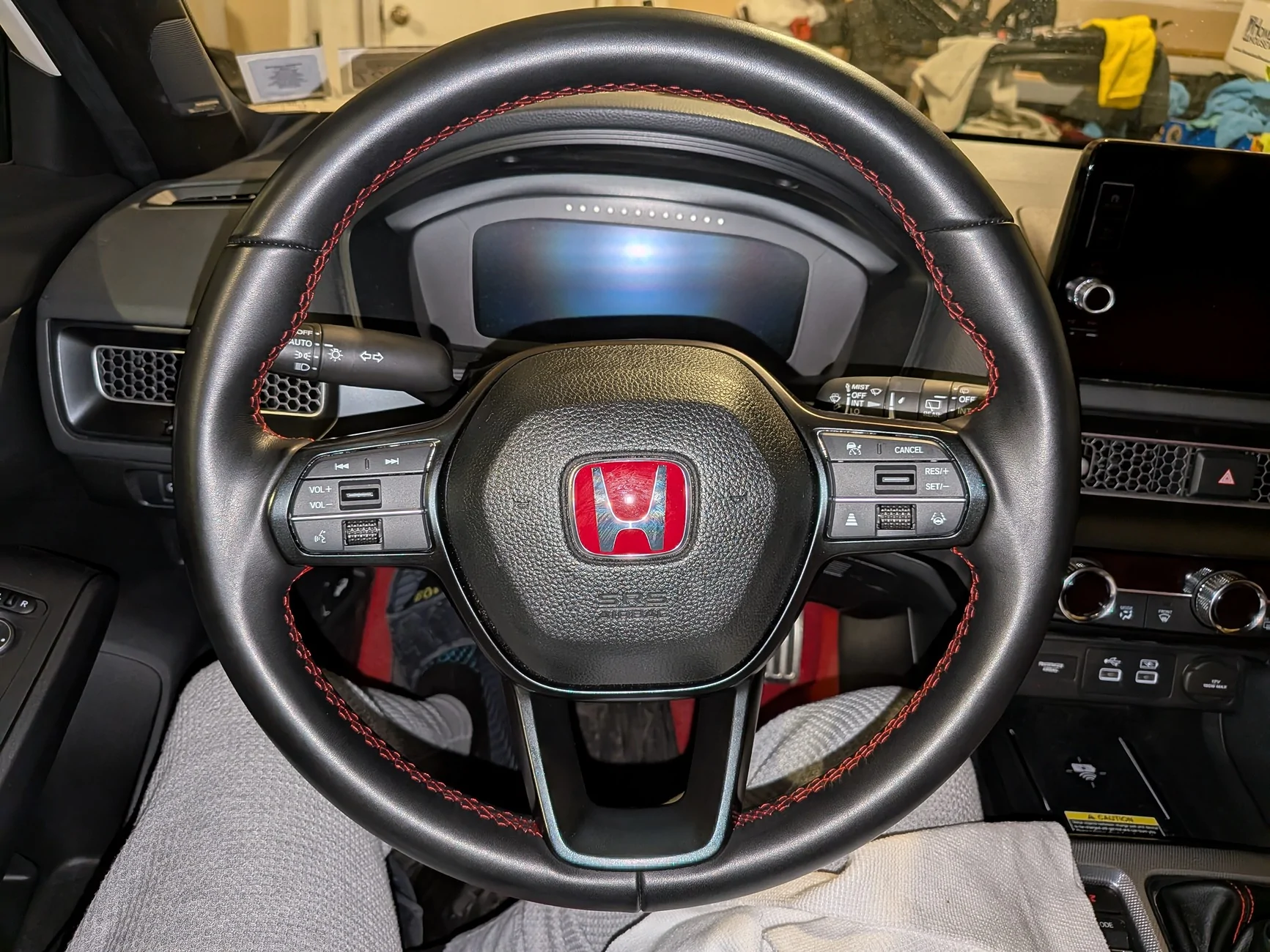

I applied another light coat. This morning when I went to go out to run errands, the wheel wasnt tacky or shiny, but definitely not matte. It's almost like a veneer on the wheel since the coating kinda shrunk as it dried overnight.
11th Gen Honda Civic How do you clean the leather steering wheel? 6570
11th Gen Honda Civic How do you clean the leather steering wheel? 6569
I think I'll let it cure more throughout the day, then I'll wipe it with some water and a microfiber cloth to see if that almost sticky sensation goes away.

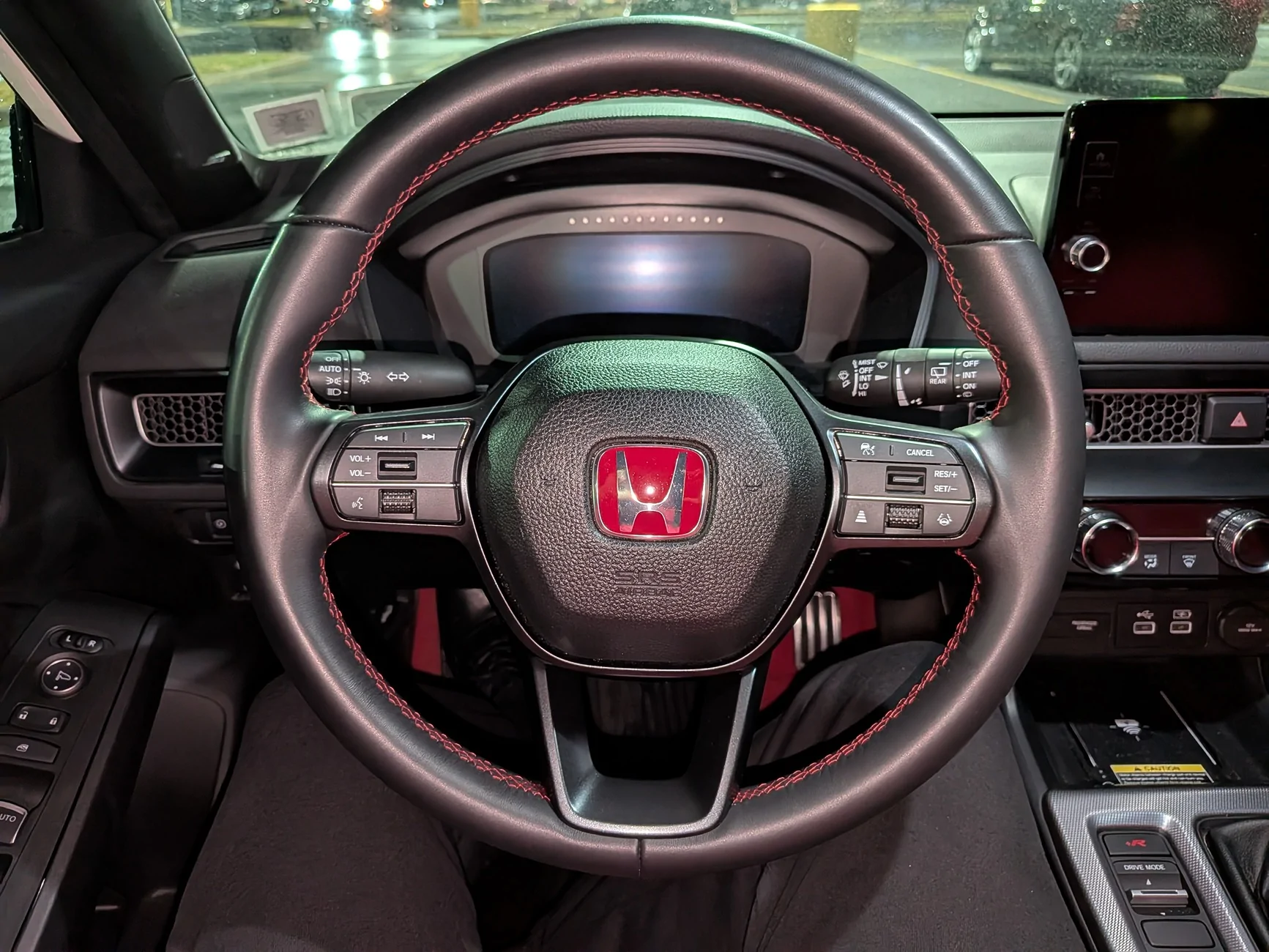

So I went out and bought some griots garage ph neutral interior cleaner and it has done wonders. I applied it 3-4 times and the wheel is getting really close to feeling like the factory finish again (only place it doesn't are the problem areas that already existed).
