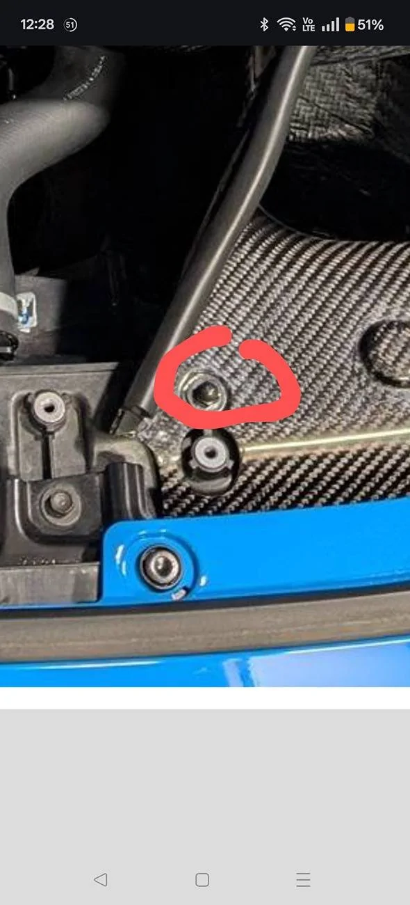

Are you planning to put some kind of rubber tube here? Looks like the bolt can scratch up the carbon. Mine has a lot of tension on that point.

I don't think it's necessary, but a slim rubber bushing could work I presume
