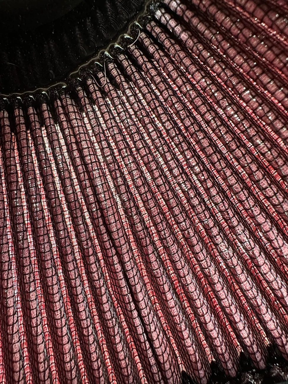

11th Gen Honda Civic K&N system cone size/dimensions? IMG_9580

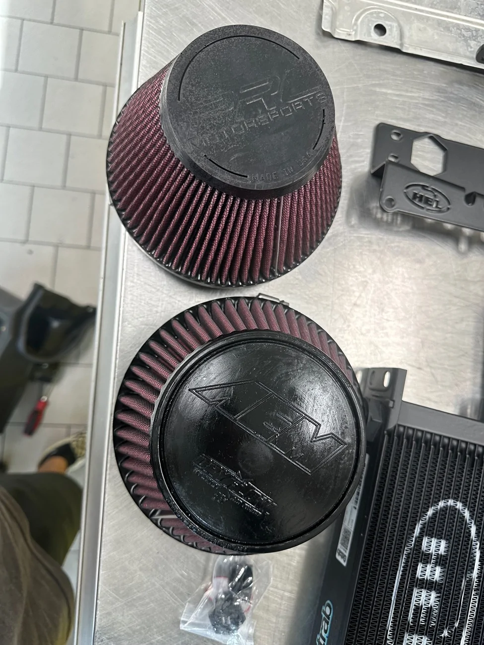

11th Gen Honda Civic K&N system cone size/dimensions? IMG_9579
11th Gen Honda Civic K&N system cone size/dimensions? IMG_9584
11th Gen Honda Civic K&N system cone size/dimensions? IMG_9582

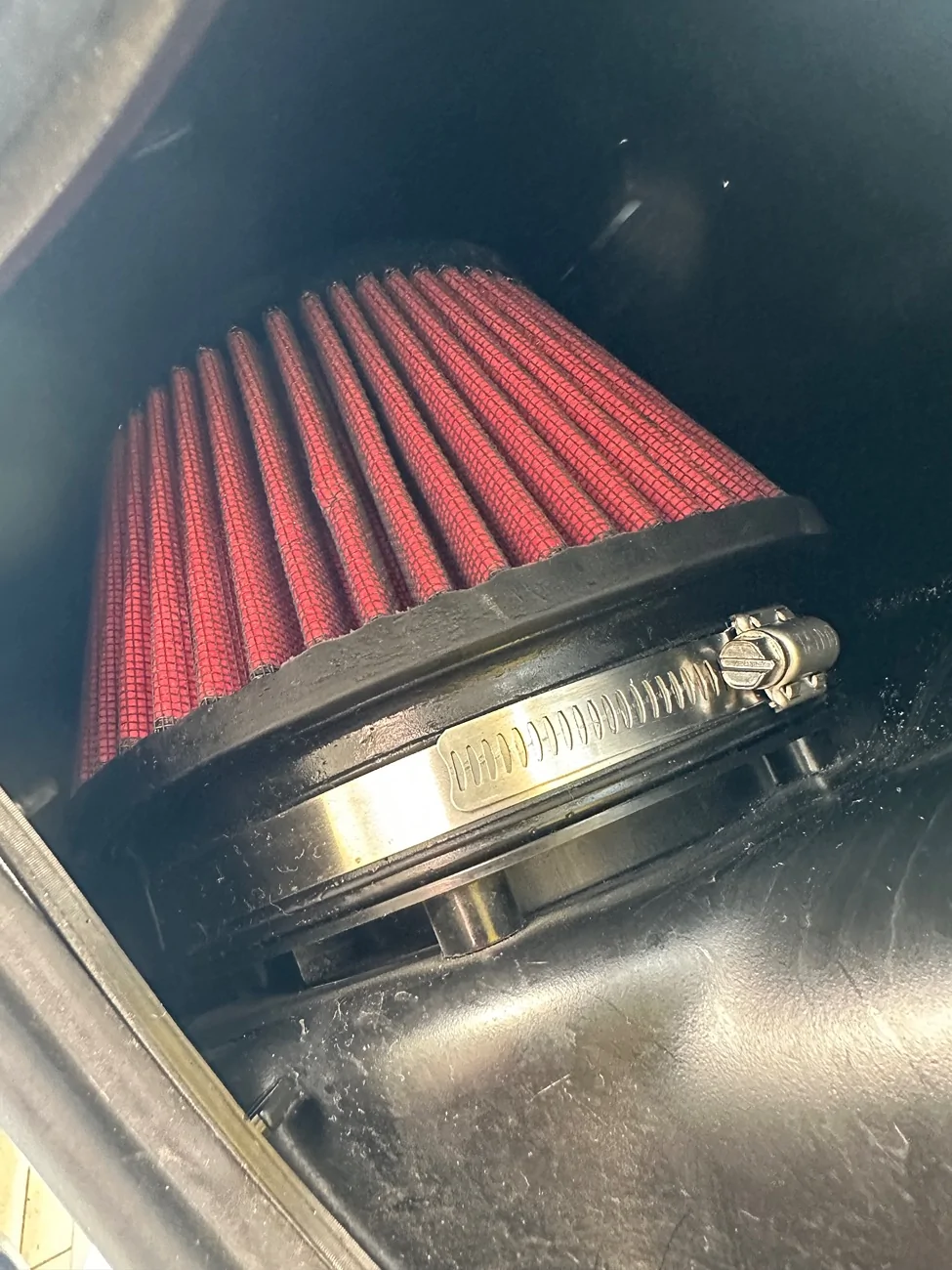

Just installed today. Fit like a glove. The AEM/K&N filter material was noticeably thicker and unable to see through. The PRL filter in the 3rd pick was very thin as you can see lol

What did you think about the flange being too big for the velocity stack? I was concerned about a potential leak at the flange.

The PRL filter is tight on the intake before you tighten down the clamp. The AEM filter just kinda drops right onto the intake with no effort. But the AEM filter tightened right up perfectly with the clamp.
I will say intake noises are slightly quieter. Like 20% quieter I would guesstimate because of the thicker filter.

Yeah I was just worried that the flange will bunch up since it's having to be compressed down so much and cause an unfiltered leak. I'll probably throw the AEM back on mine and check for any dust bypass after a few thousand miles. Holding the PRL filter up to the light doesn't inspire much confidence in it's ability to filter haha

I wouldn’t worry about any leaks. It was definitely sealed all around. I have no worries.
Yeah, the PRL is super thin…. You can see the floor is white lol and my fingers in the other picture

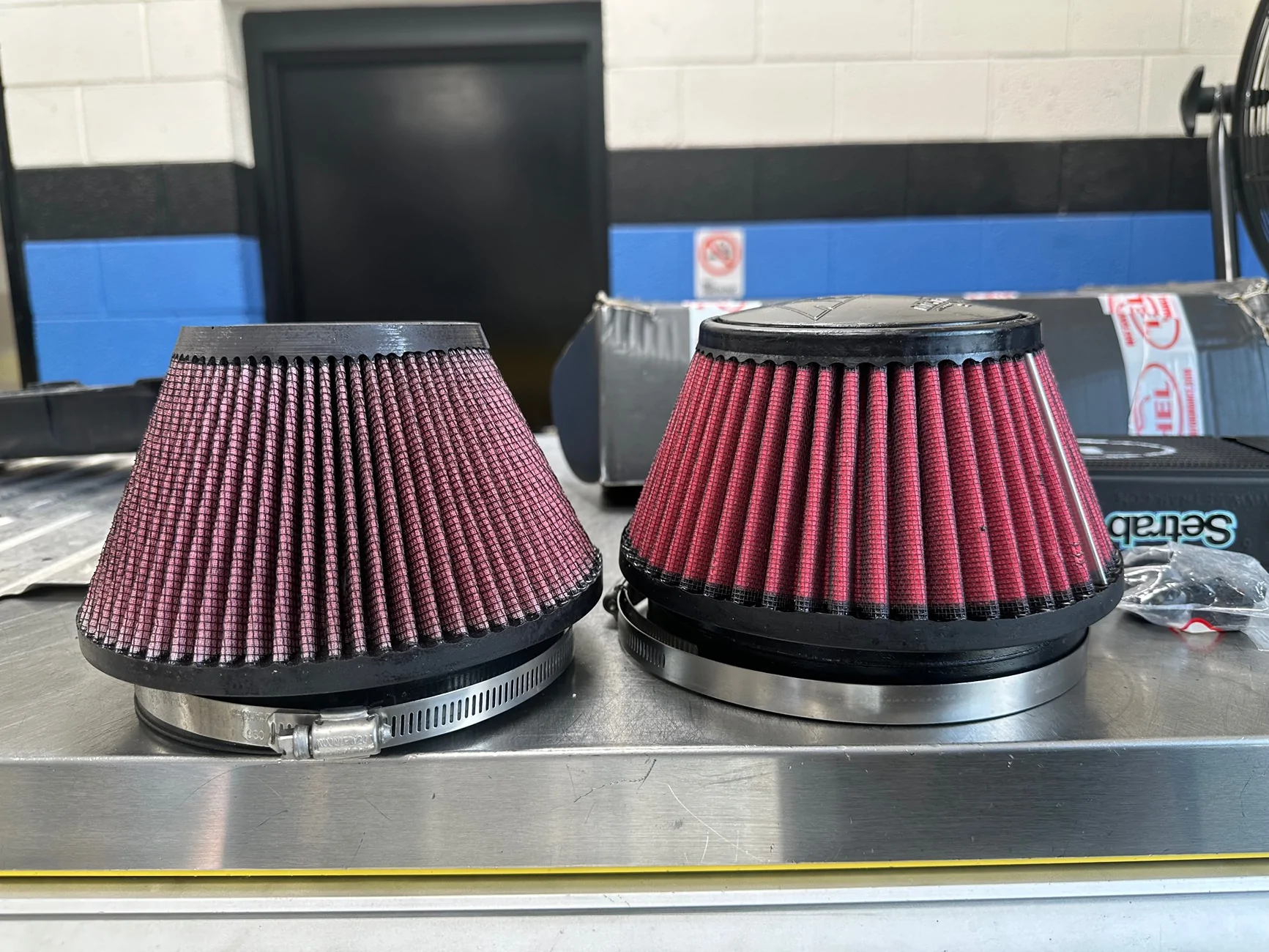

11th Gen Honda Civic K&N system cone size/dimensions? IMG_9583

I would compare the two filters as such:
PRL filter: thin as a old thin t-shirt
AEM filter: thick as a nice sweatshirt
I will daily the AEM and use the PRL on track days

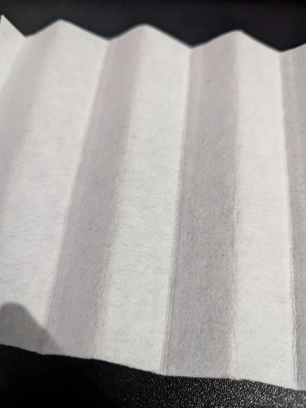

Check out what the raw material looks like. I cut one open out of curiosity haha
11th Gen Honda Civic K&N system cone size/dimensions? PXL_20250730_160613256

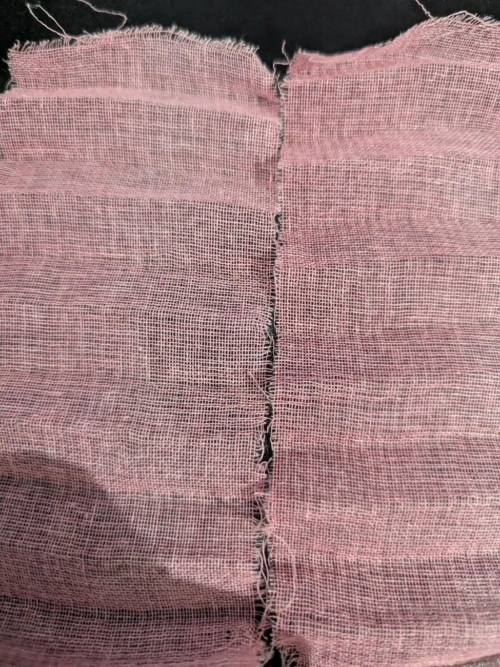

And here's the raw material of the Aem dryflow
11th Gen Honda Civic K&N system cone size/dimensions? PXL_20250730_160208495
11th Gen Honda Civic K&N system cone size/dimensions? PXL_20250730_160257061
