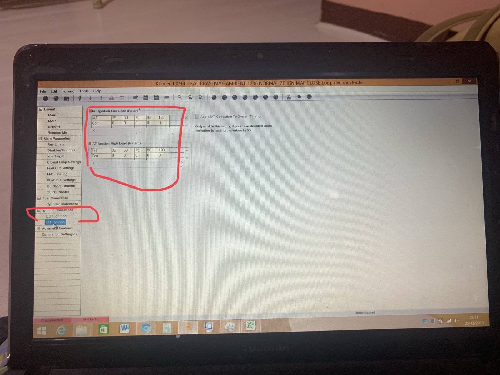

Thanksfull for KTuner, just today update version, which is availability of ignition correction IAT &ECT. That is : straight related to my first posting
about knocking. [/ PREVENTIVO]
Hello
in the online help, where I find the explanation of that setting
Virhan
Virhan
Virhan
Dec 6, 2019
Indonesia
FK4 Hatchback CVT 2017
If your IAT's go too high, these IAT ignition corrections will retard your timing so that K.Control stays more stable.
Here's the original information from Ktuner's JR:
The "Corr" is where you put in JR's numbers. Those numbers are the amount of timing retard corresponding to the IAT temp above it.
You can go to that posts (click that red “UP ARROW” sign) in the right side of author’s name.
