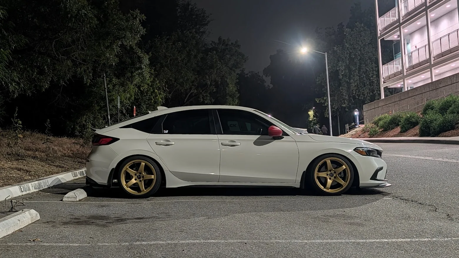

drop looks good - just put some weights in the trunk to level out the rear haha
you could also play around with a thin spring pad for the rear spring too (maybe remove it all together if you're not worried about noise)
assuming the rear spring pad is the same as the FL5 - I measured it at 60mm ID x 90mm OD
I bought a thicker "rubber o-ring" off ebay to raise the rear of my car

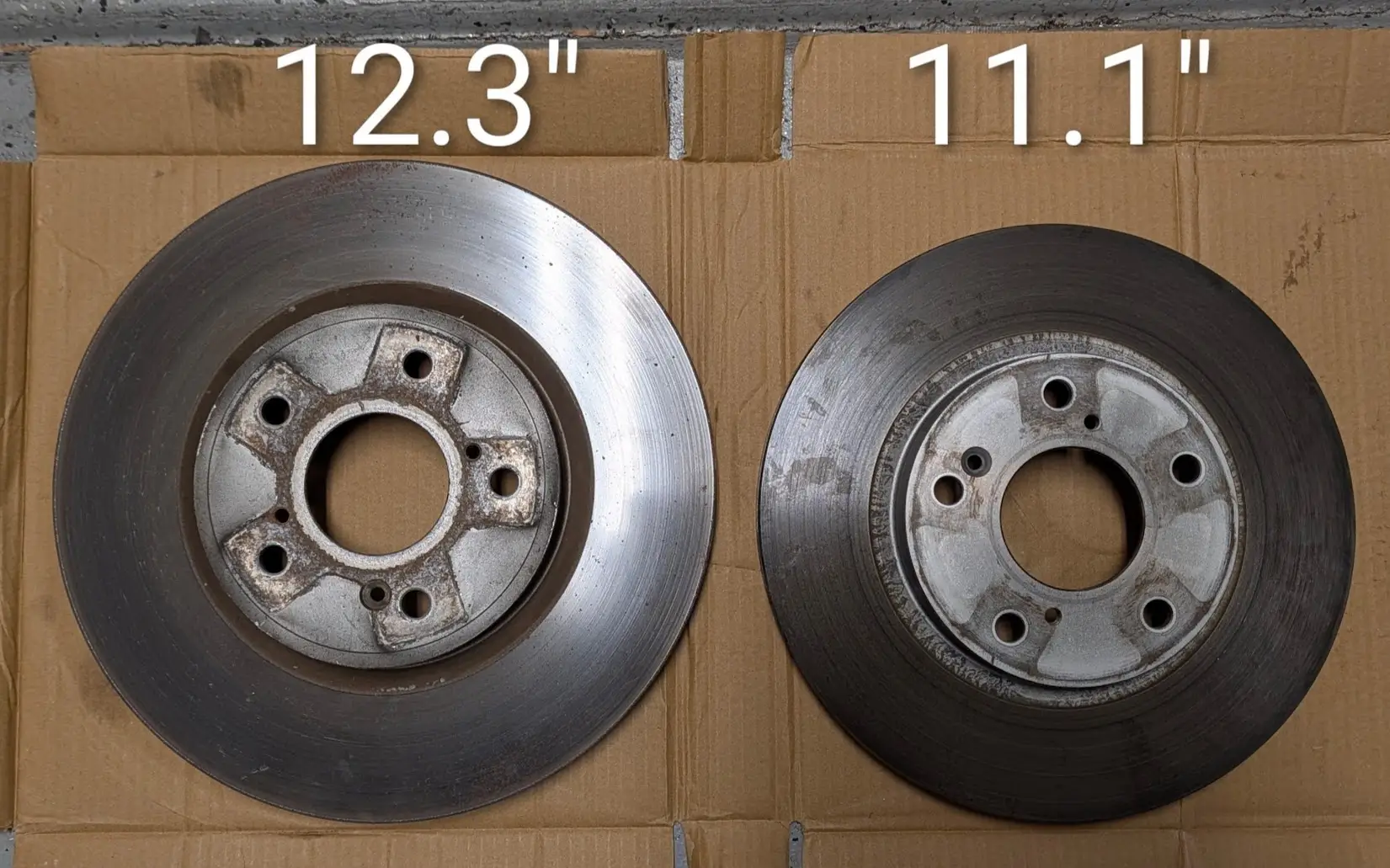

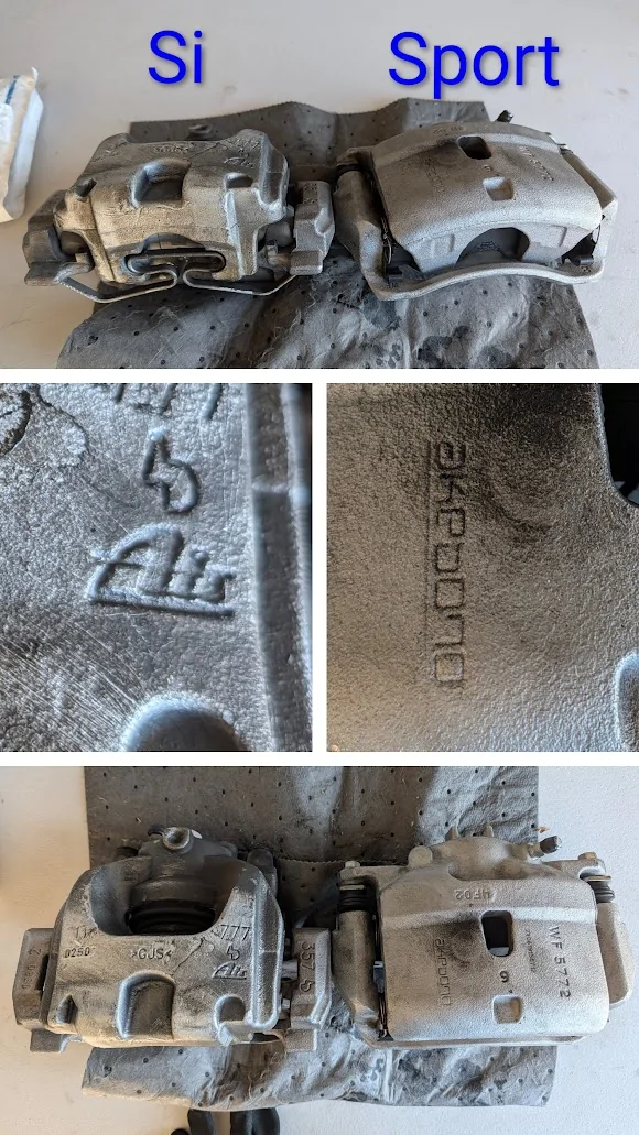

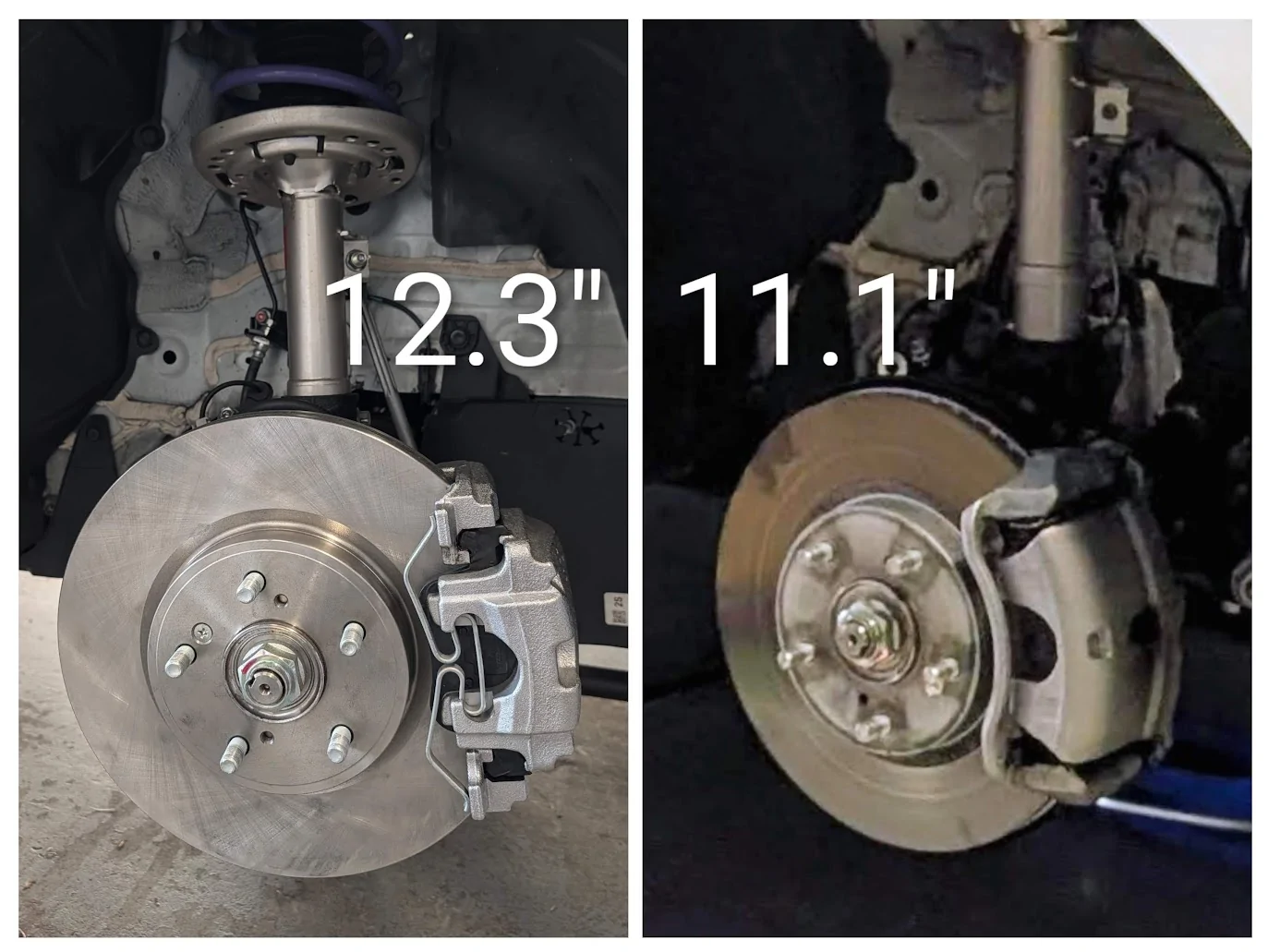

Installed Si front calipers, pads, and rotors. Si is 12.3". Non-Si is 11.1". Si pads are wider and taller. Only modification is bending back the dust shield. Reused my stock brake lines and banjo bolts. 2022+ Si front brakes are also found on 2023+ Acura Integra (not Type S) and 2018+ Accord Sport/Touring. I didn't notice an improvement after 50 miles of daily driving, which didn't surprise me. I did this mod for modding sake. 😅

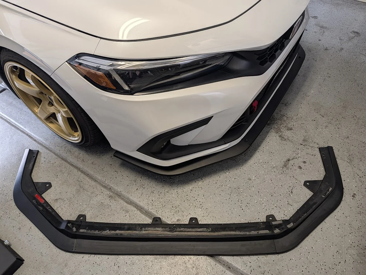

I recently replaced the faded and cracked front lip with a fresh one (same design).

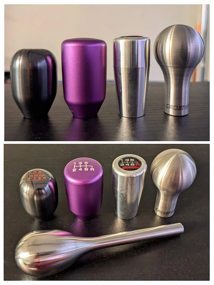

Got a Hawkdown knob, which is a copy of the Battlecraft knob.
11th Gen Honda Civic Last of the manual NA Civics ('24 FL2) 1779463358504-a3
I'm down to 4 knobs. I sold the Spoon (too thin) and Acuity (too thick).

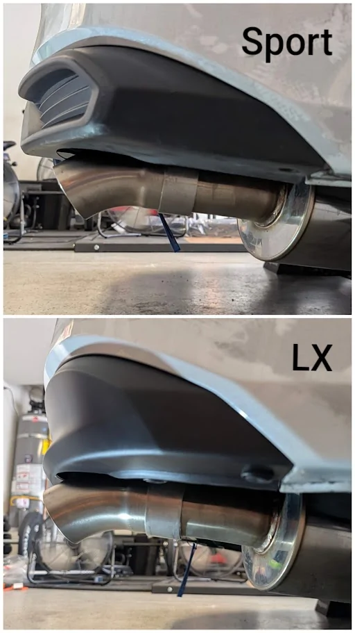

Comparison of the stock LX and Sport diffusers (Honda calls them garnishes) with the N1 muffler and downturn tip.
11th Gen Honda Civic Last of the manual NA Civics ('24 FL2) 1792085703189-j
Invidia provided a 110mm/4.3" tip, but it won't fit without cutting the diffuser. The Invidia rep said their exhausts are designed to fit without modifying the bumper.
