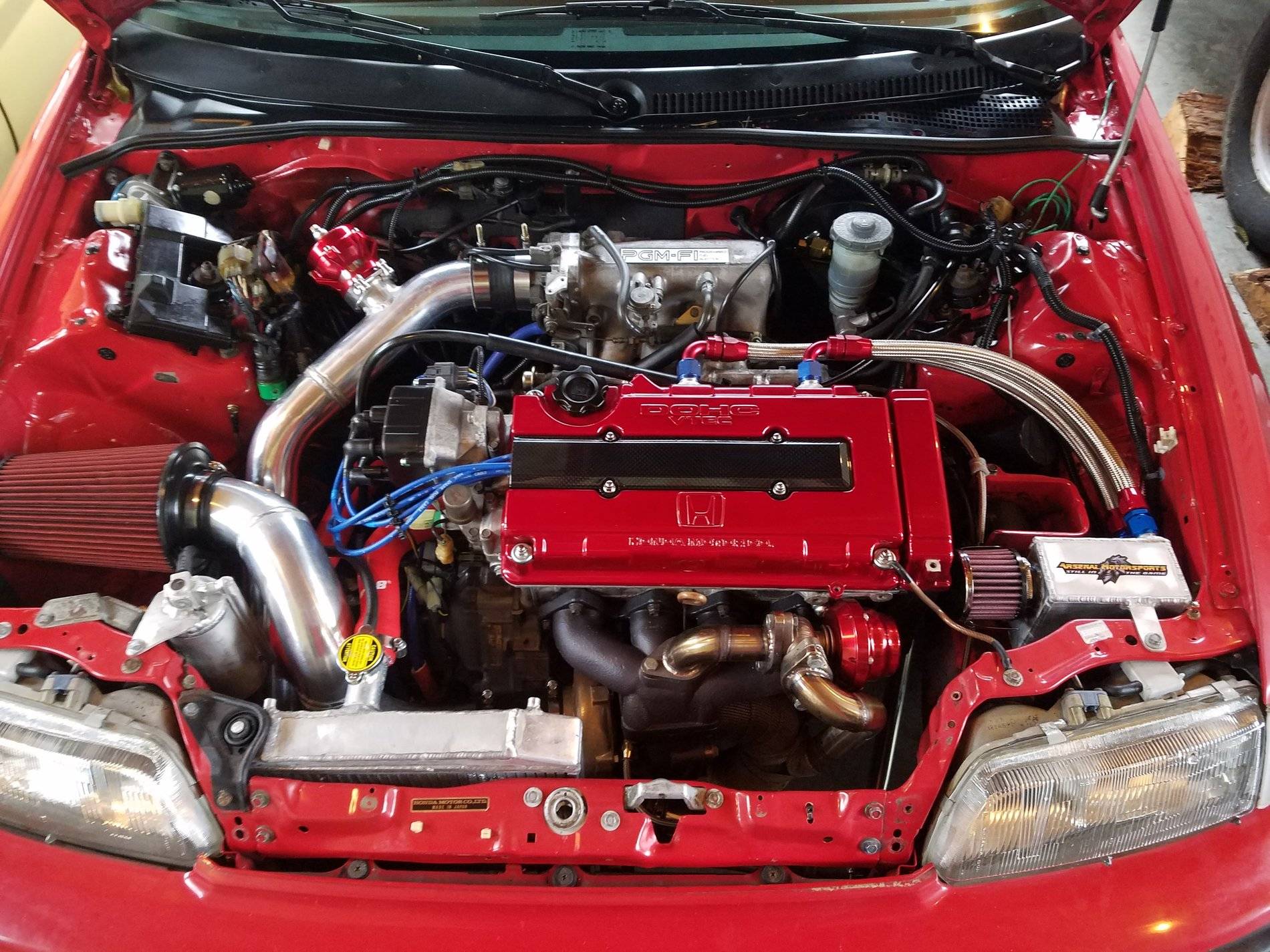

I don't really need the flex fuel kit...corn gas is nowhere around my part of the state. I will be having a custom tune done at the dyno. This isn't my first boosted car....this is my slow, commuter car that I am trying to eek out a bit more without going full race like on my other car haha. I have a full on built 91 CRX, with a boosted B16a that decimates most vehicles on the road unless they're close to 500 hp....so this isn't my first rodeo. ;) I was even daily driving it and will still do so in the summer. I have been in the boosted game for years.
11th Gen Honda Civic Need parts...HELP 20161009_164723
