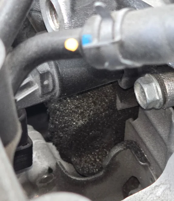

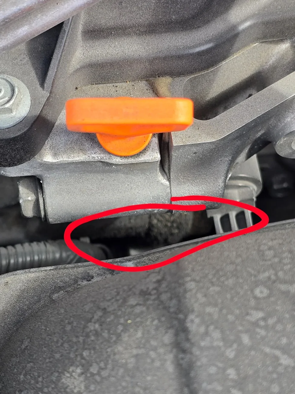

Does anyone know what is this part called that is leaking? It is right under the oil stick. I just noticed it today while changing out my fluids and filters. Got me worried now :confused:.

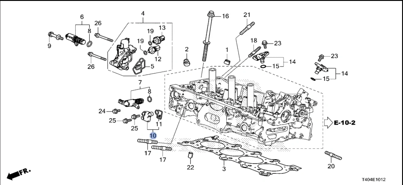

11th Gen Honda Civic Oil leak - Trying to Identify the Part 1764334721702-72
VTC gasket? #11

Took it to my mechanic today and it ended up being Timing Chain Tensioner Cover. He cleaned and resealed it.
