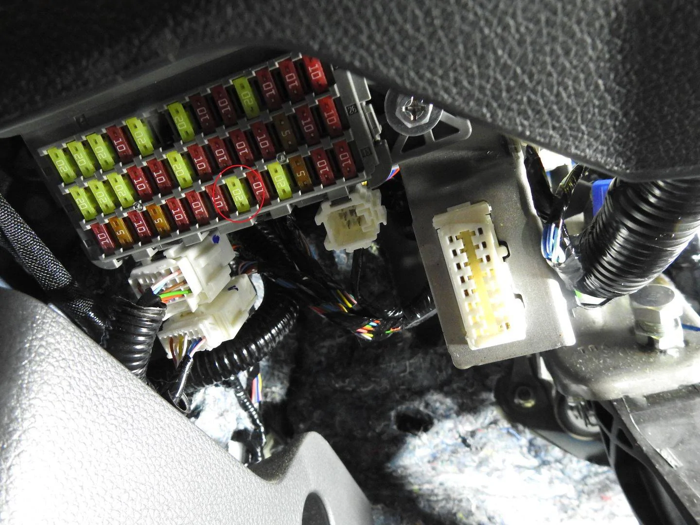

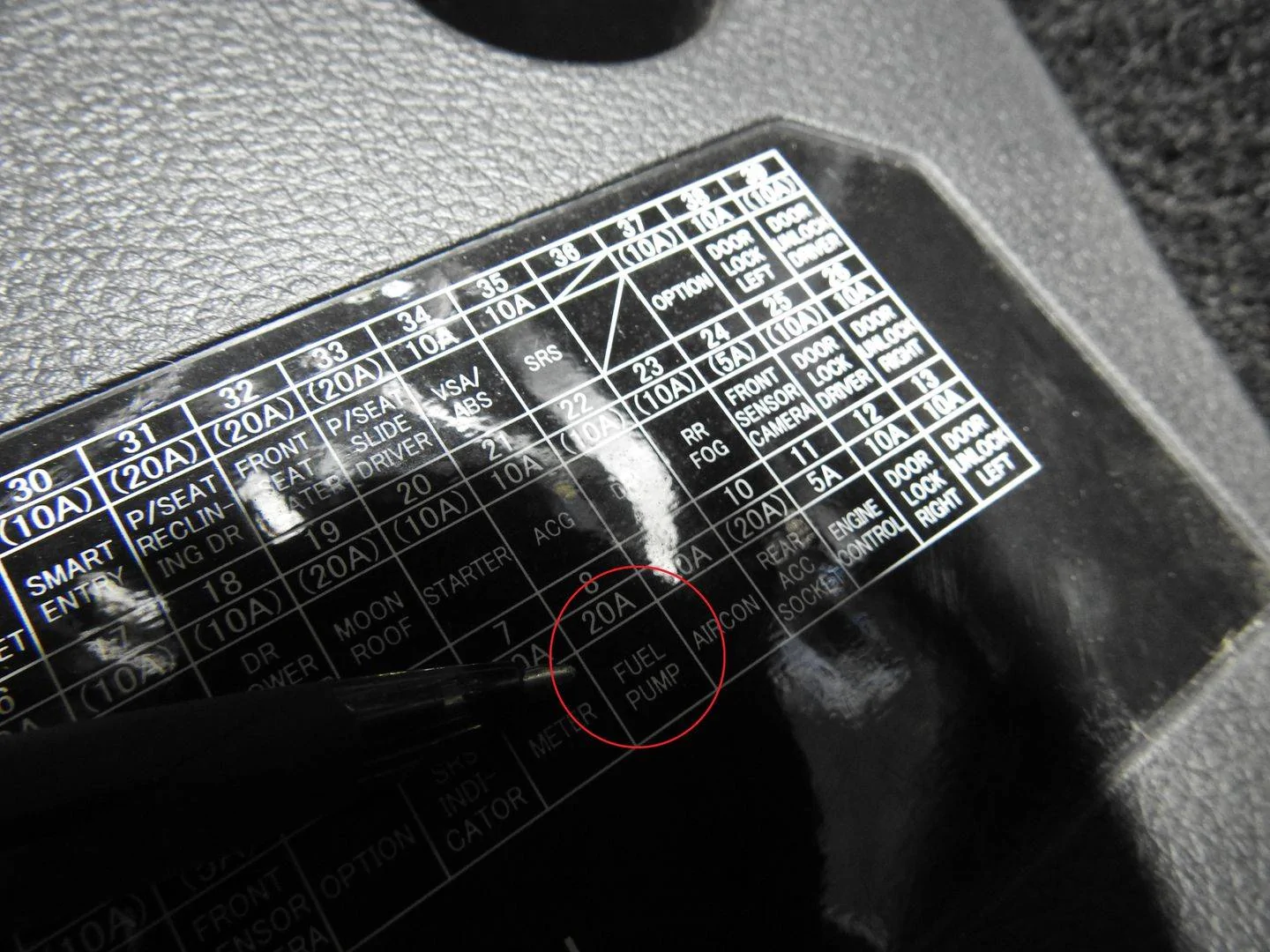

1. Discharge the fuel pressure in the factory feed line.
  • Inside the driver’s compartment, located above the hood release in the interior fuse box. Using the factory tool remove the 20amp fuse in location 8.
  • Start the car (In some cases you may need to start the car with the fuel pump fuse installed if your car has been sitting for a period of time.)
  • Let the car idle until fuel pressure has dropped enough that the car stalls. (This may take a few minutes)
  • Place fuse in a safe spot until you are done with the installation

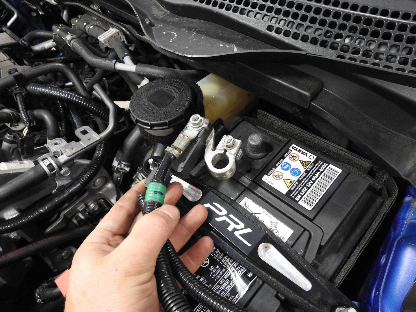

2. Using a 10mm socket, loosen the negative terminal and remove. Tuck into engine bay out of the way.

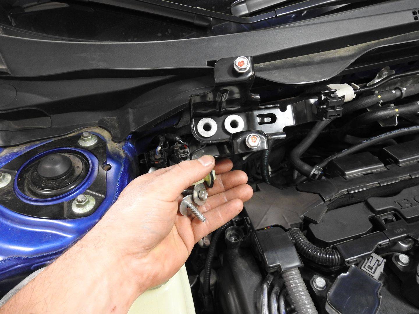

3. Remove the (2) 10mm headed bolts on the factory fuel line bracket cover.
11th Gen Honda Civic PRL Motorsports 2017+ Honda Civic Type-R FK8 Plug ‘N Play Flex Fuel Kit Install Guide DSCN7646_zpsse13ztzk

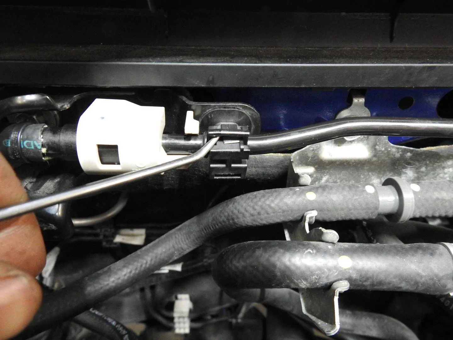

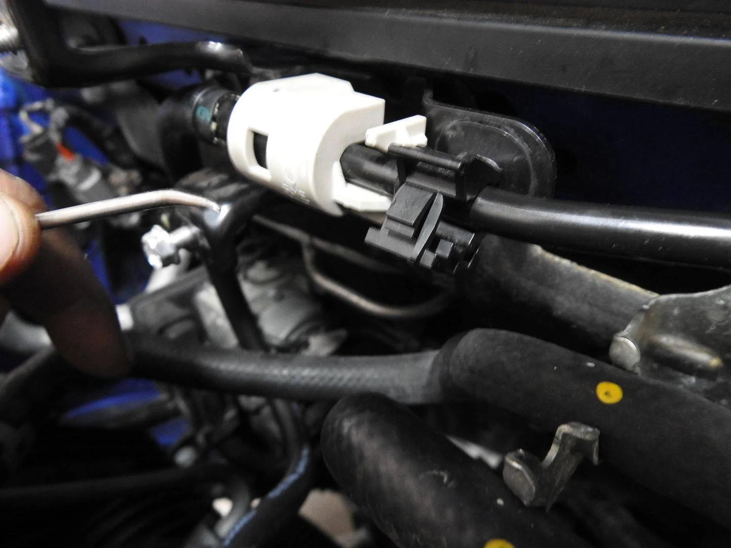

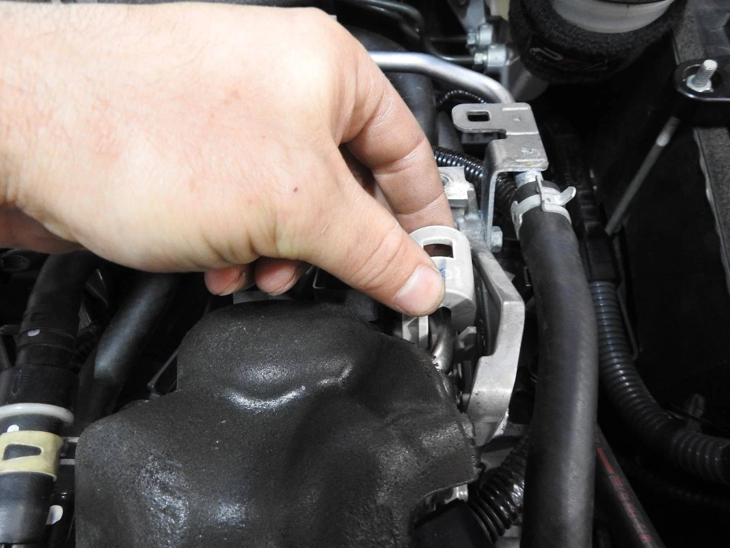

4. Depress tab and release the (3) fuel line holders using a pick or pocket screwdriver
11th Gen Honda Civic PRL Motorsports 2017+ Honda Civic Type-R FK8 Plug ‘N Play Flex Fuel Kit Install Guide DSCN7647_zpsbaqzd6oh
11th Gen Honda Civic PRL Motorsports 2017+ Honda Civic Type-R FK8 Plug ‘N Play Flex Fuel Kit Install Guide DSCN7648_zpsutyx4ioi
11th Gen Honda Civic PRL Motorsports 2017+ Honda Civic Type-R FK8 Plug ‘N Play Flex Fuel Kit Install Guide DSCN7649_zpsgzekmmn

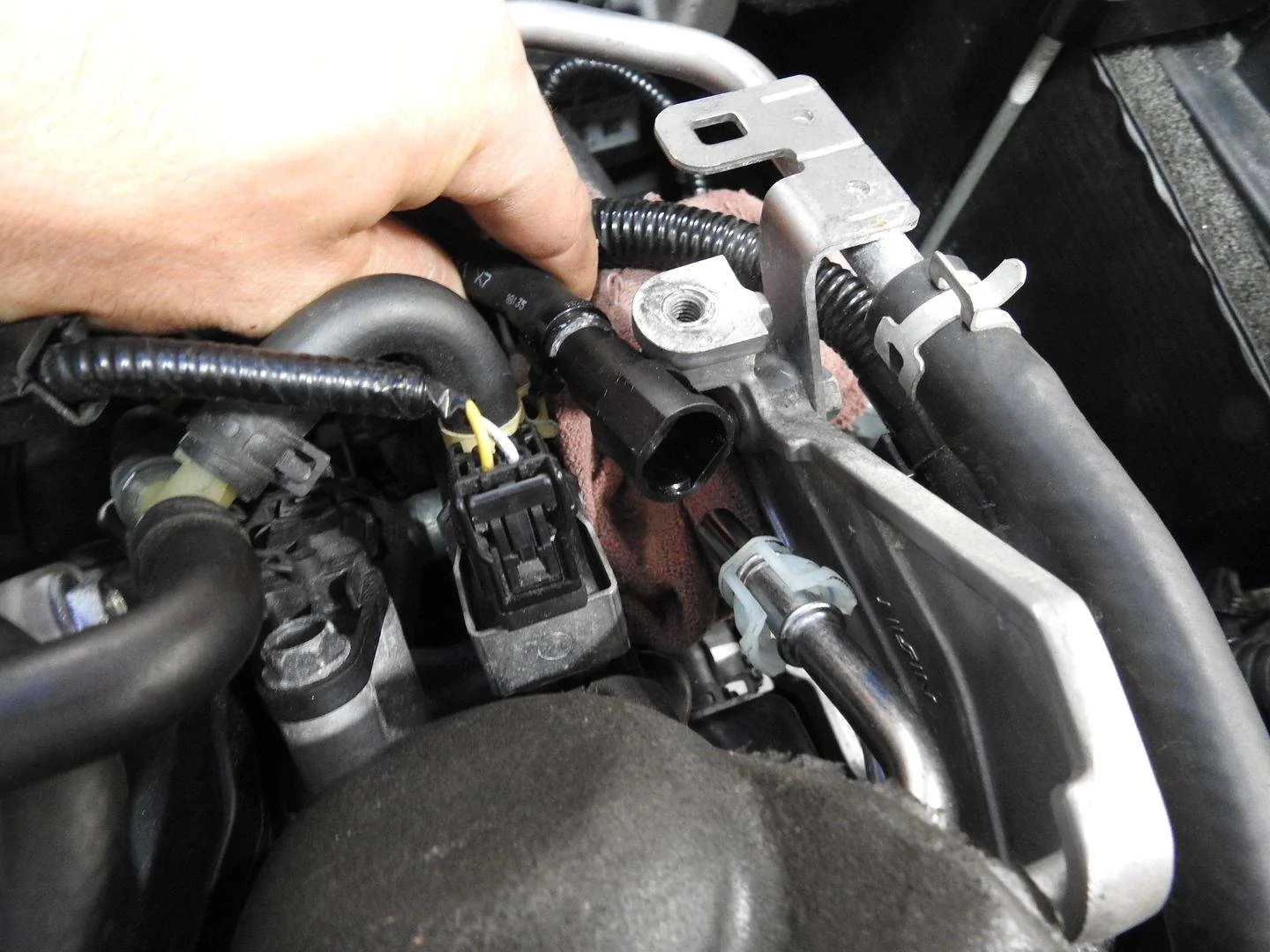

5. Remove the fuel line out of the clamp to gain access to the bolts behind it.
11th Gen Honda Civic PRL Motorsports 2017+ Honda Civic Type-R FK8 Plug ‘N Play Flex Fuel Kit Install Guide DSCN7651_zpsftesedpk

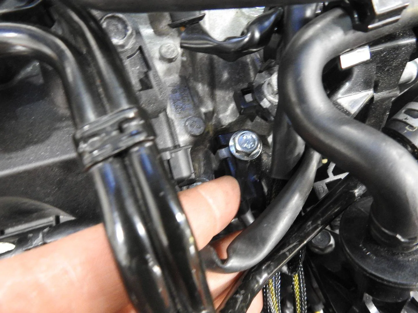

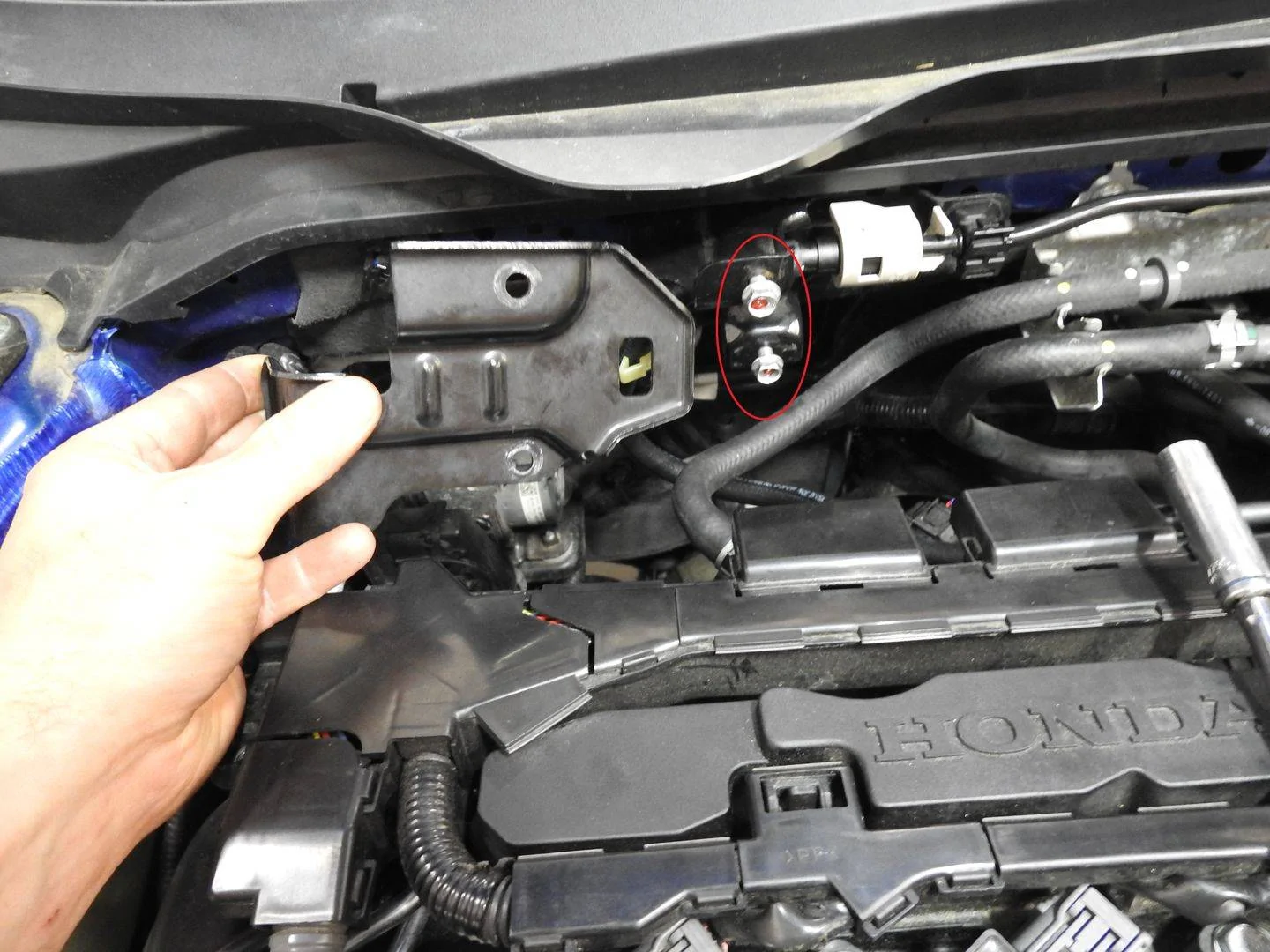

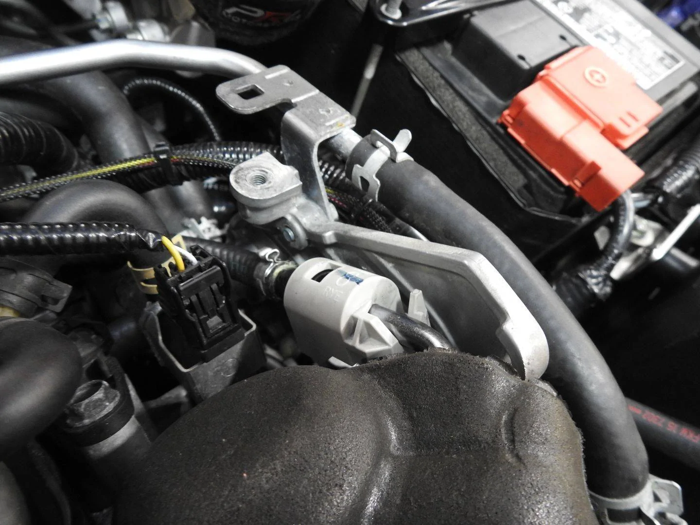

6. Use a 10mm socket to remove the (2) bolts holding the fuel line bracket to the firewall.
11th Gen Honda Civic PRL Motorsports 2017+ Honda Civic Type-R FK8 Plug ‘N Play Flex Fuel Kit Install Guide DSCN7652_zpsxmftatt

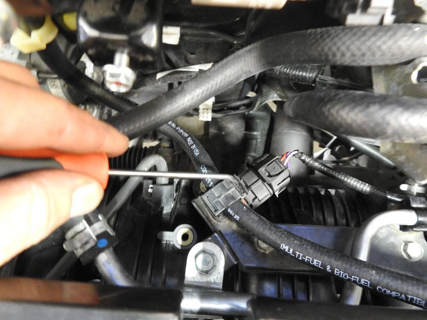

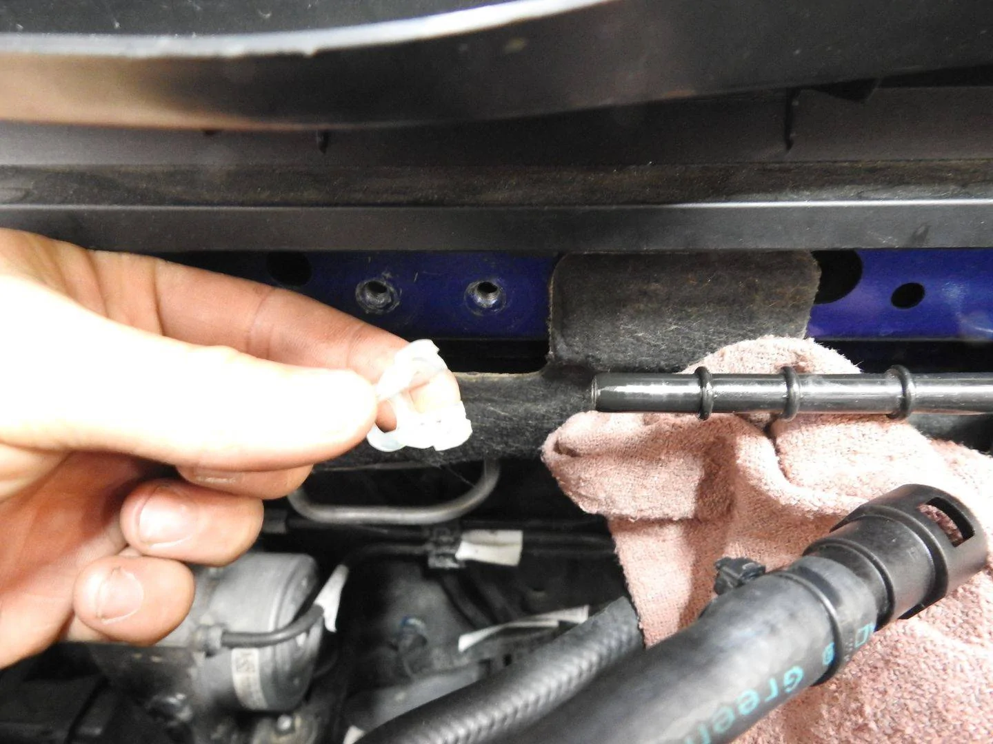

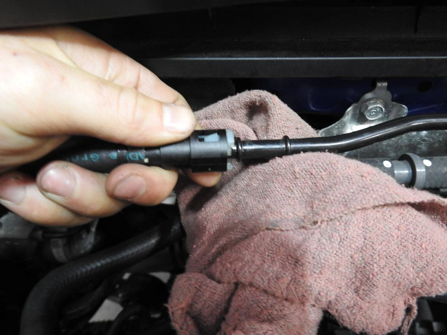

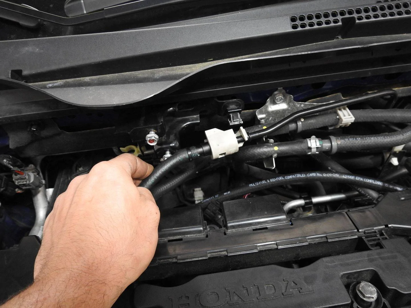

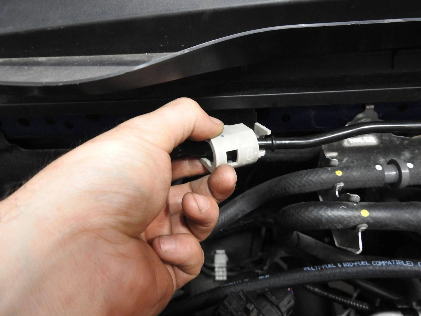

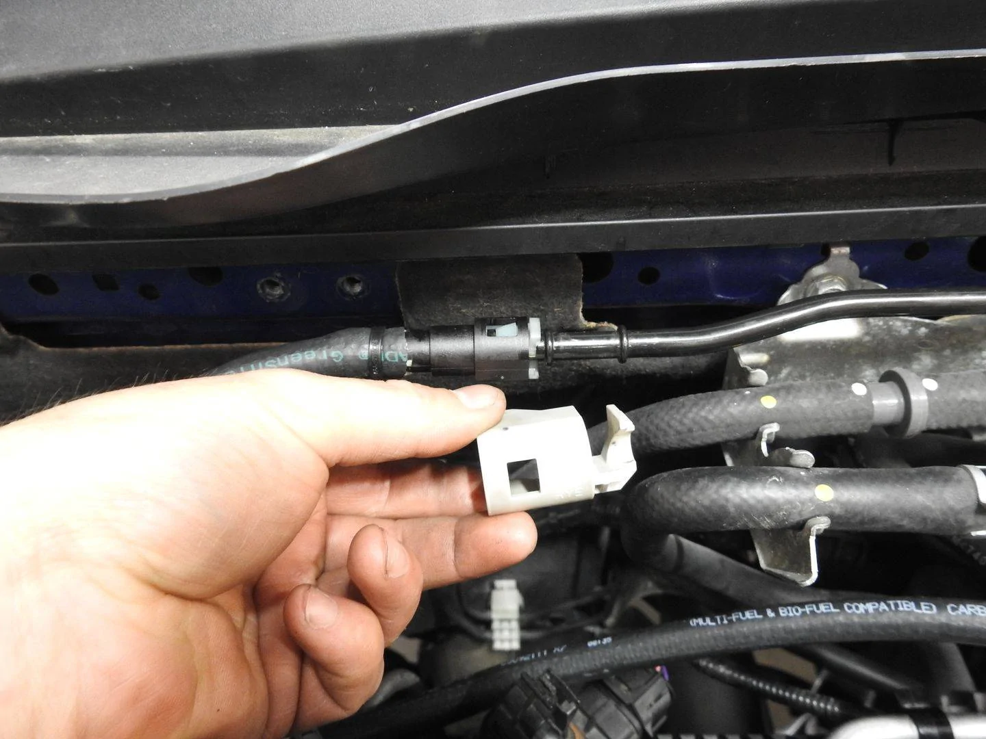

7. Remove the (2) safety clips from the factory fuel line connectors. Pull out and rotate 90 degrees to the line, then slip them out of the existing slot.
11th Gen Honda Civic PRL Motorsports 2017+ Honda Civic Type-R FK8 Plug ‘N Play Flex Fuel Kit Install Guide DSCN7653_zpsuyfymch
11th Gen Honda Civic PRL Motorsports 2017+ Honda Civic Type-R FK8 Plug ‘N Play Flex Fuel Kit Install Guide DSCN7693_zpsetbcvs72
11th Gen Honda Civic PRL Motorsports 2017+ Honda Civic Type-R FK8 Plug ‘N Play Flex Fuel Kit Install Guide DSCN7655_zpsh5urpwzz
11th Gen Honda Civic PRL Motorsports 2017+ Honda Civic Type-R FK8 Plug ‘N Play Flex Fuel Kit Install Guide DSCN7656_zpszkd04hmj

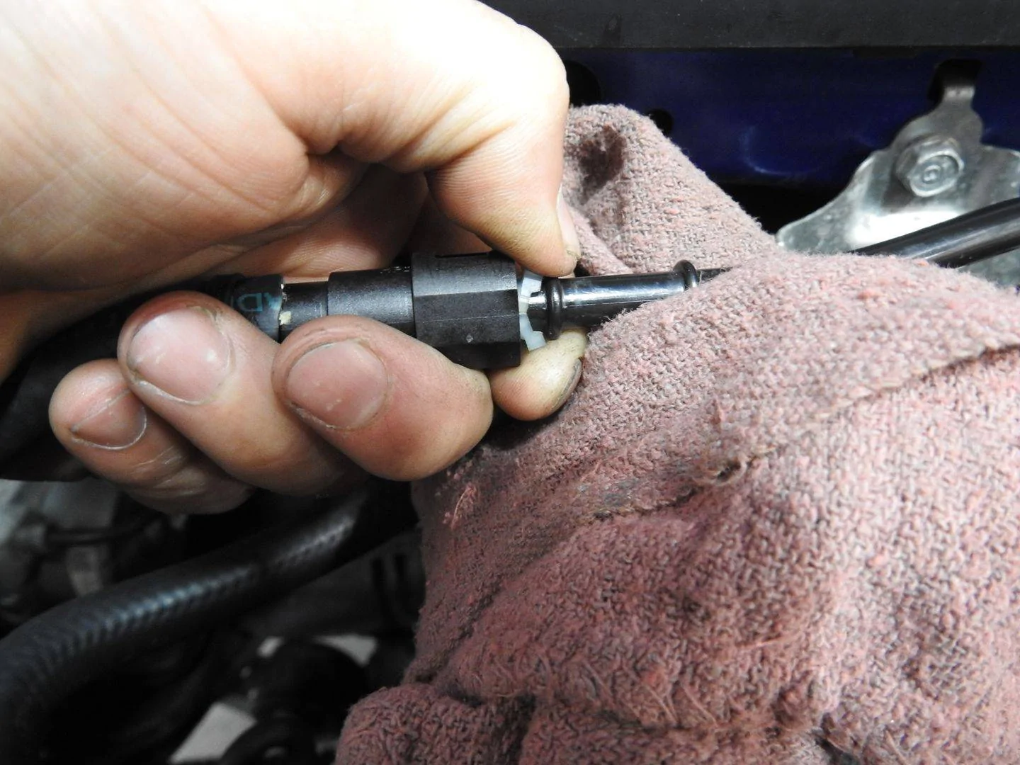

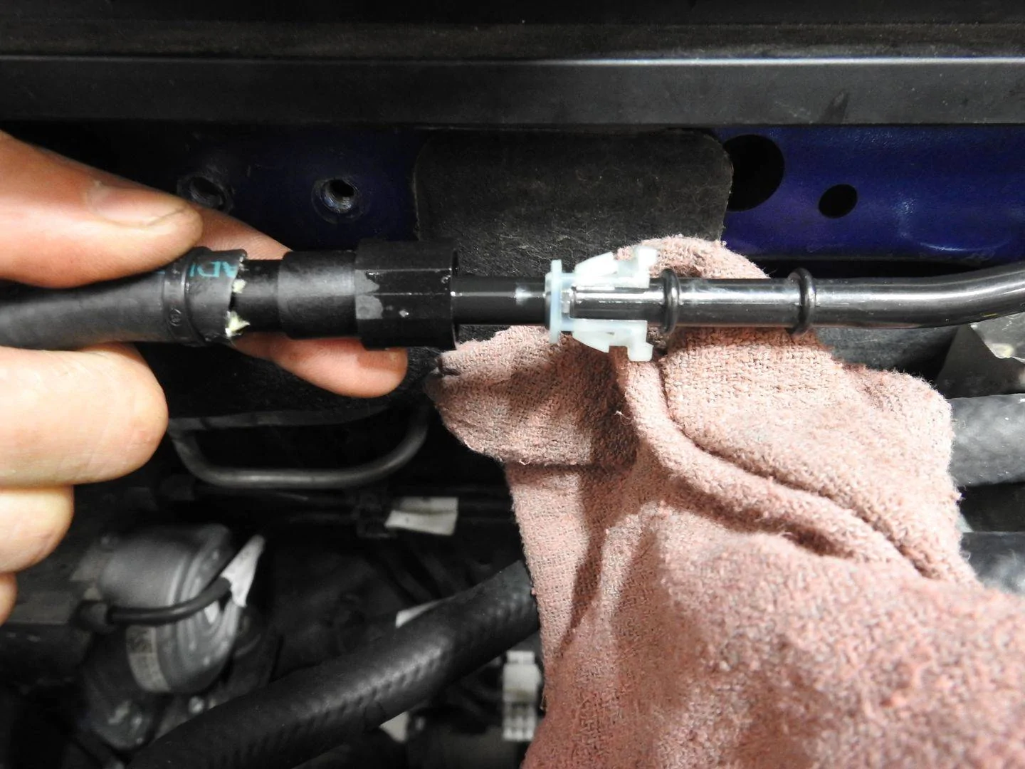

8. Wearing safety glasses, position shop towels to help catch excess fuel. Place your index finger and thumb on the retaining clips, push together the fuel line connection then squeeze clips inward. In a gentle twisting motion pull the connection apart. Remember to be ready for any residual pressure in the line to spray out. After the removal of the line, pry the remaining insert off the hard lines. Reinstall into the OEM fuel line for safekeeping.

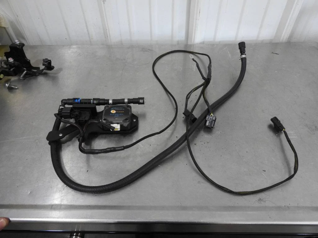

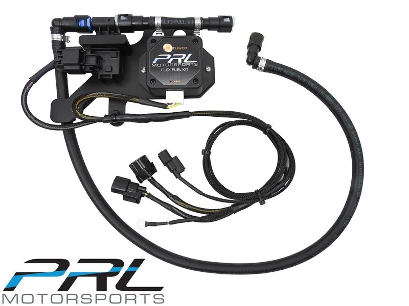

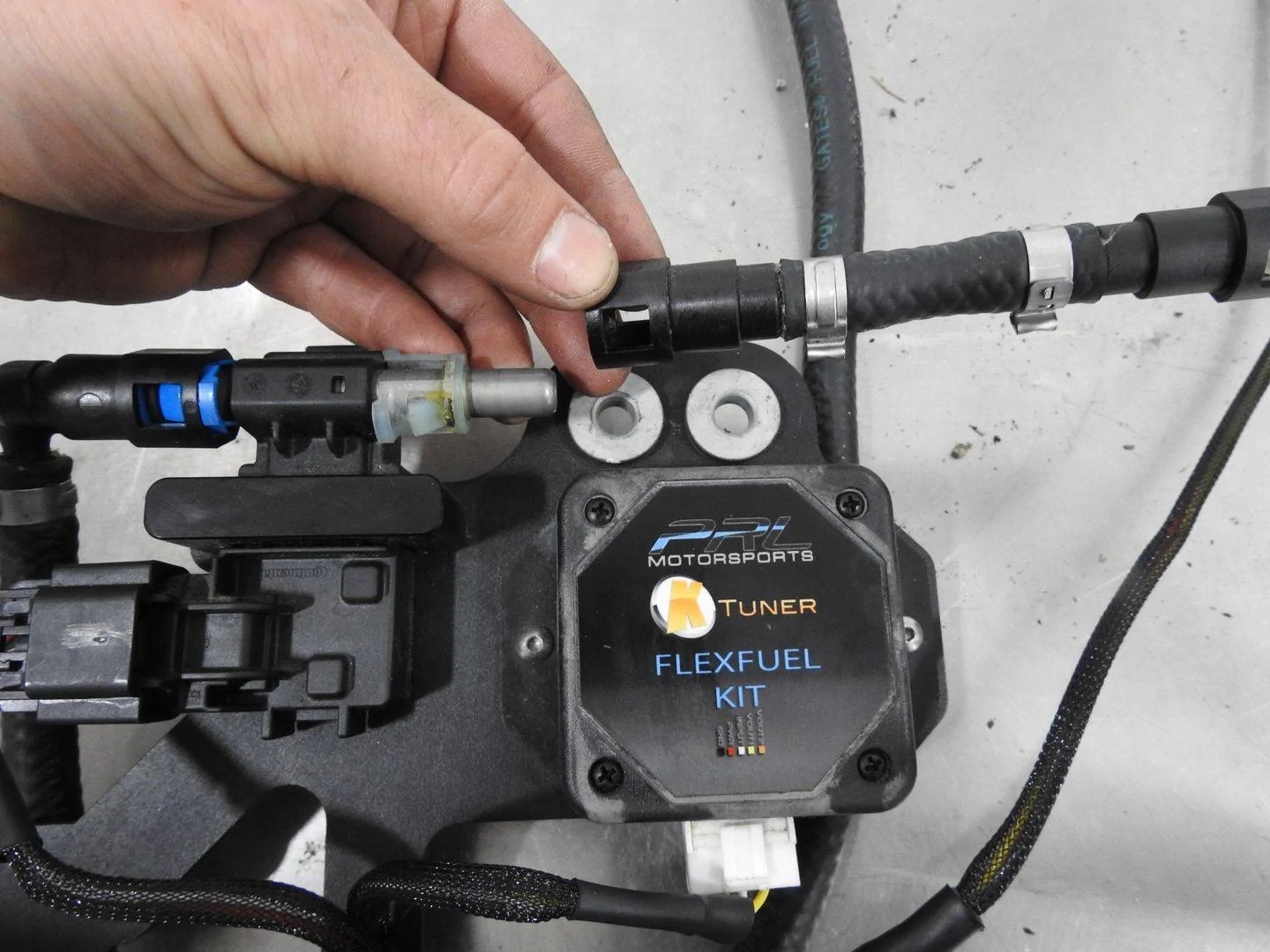

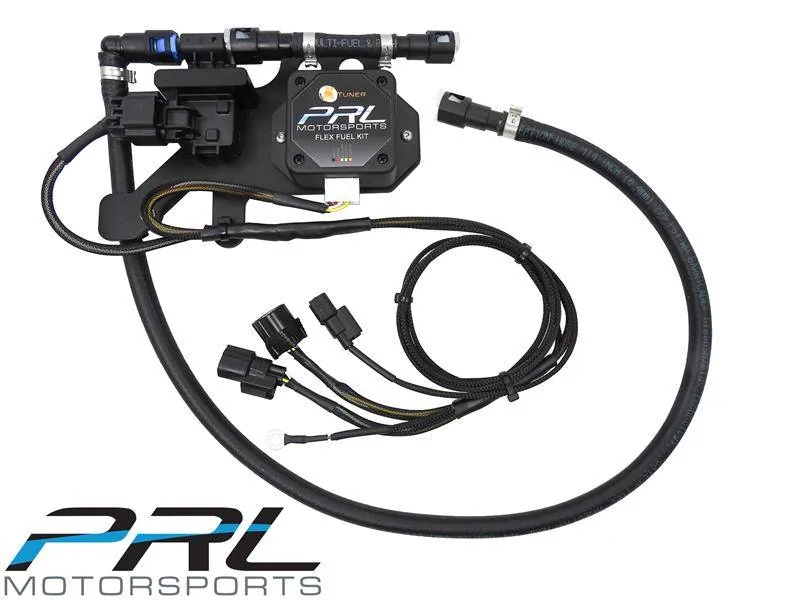

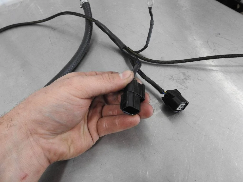

9. Lay the PRL flex fuel kit out on a clean work surface and familiarize yourself with the connectors.
11th Gen Honda Civic PRL Motorsports 2017+ Honda Civic Type-R FK8 Plug ‘N Play Flex Fuel Kit Install Guide DSCN7664-1024x768
This is the assembled kit.
11th Gen Honda Civic PRL Motorsports 2017+ Honda Civic Type-R FK8 Plug ‘N Play Flex Fuel Kit Install Guide DSCN7665-1024x768
11th Gen Honda Civic PRL Motorsports 2017+ Honda Civic Type-R FK8 Plug ‘N Play Flex Fuel Kit Install Guide DSCN7666-1024x768

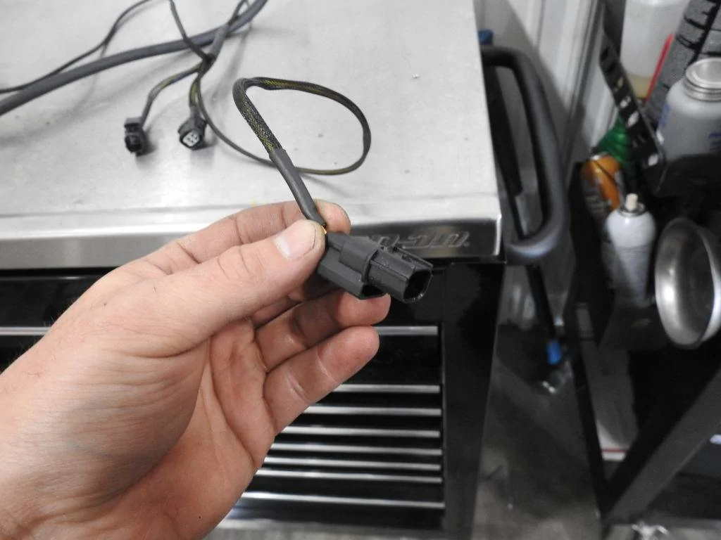

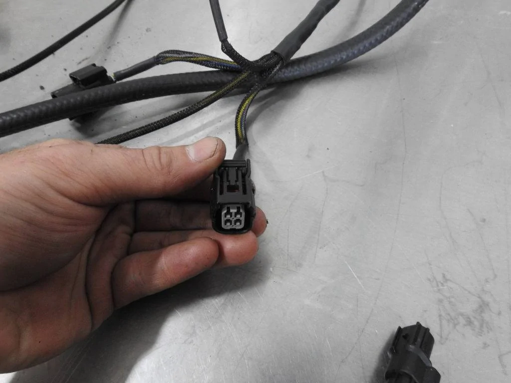

This is the male secondary o2 plug.
11th Gen Honda Civic PRL Motorsports 2017+ Honda Civic Type-R FK8 Plug ‘N Play Flex Fuel Kit Install Guide DSCN7667-1024x768

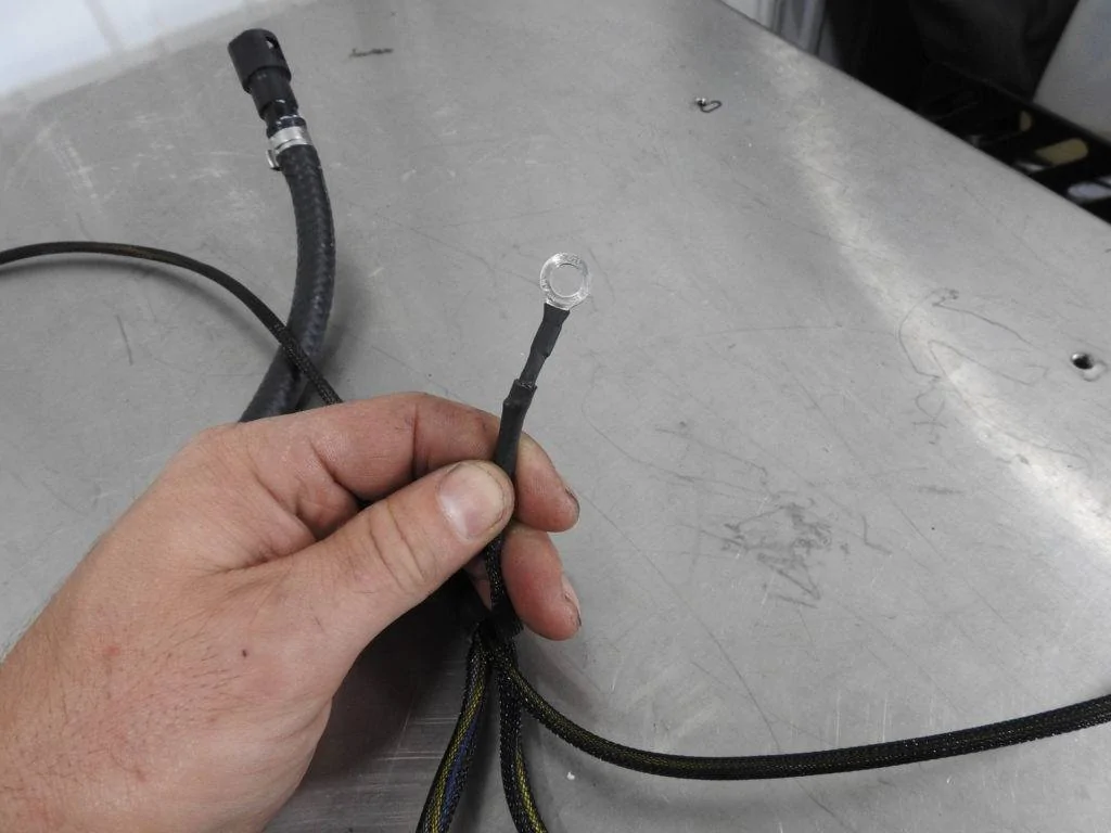

This is the ground eyelet.
11th Gen Honda Civic PRL Motorsports 2017+ Honda Civic Type-R FK8 Plug ‘N Play Flex Fuel Kit Install Guide DSCN7668-1024x768
This is the male ECT2 Plug

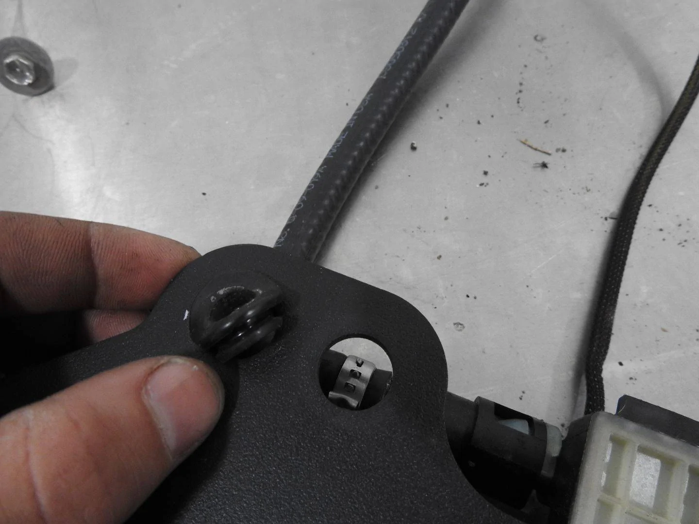

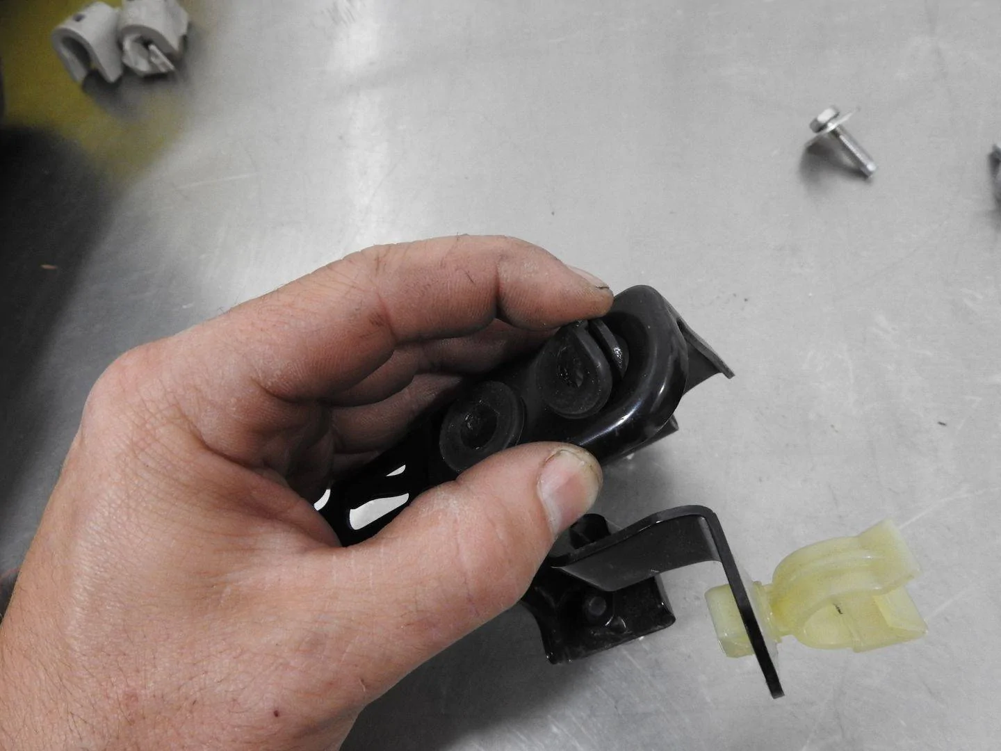

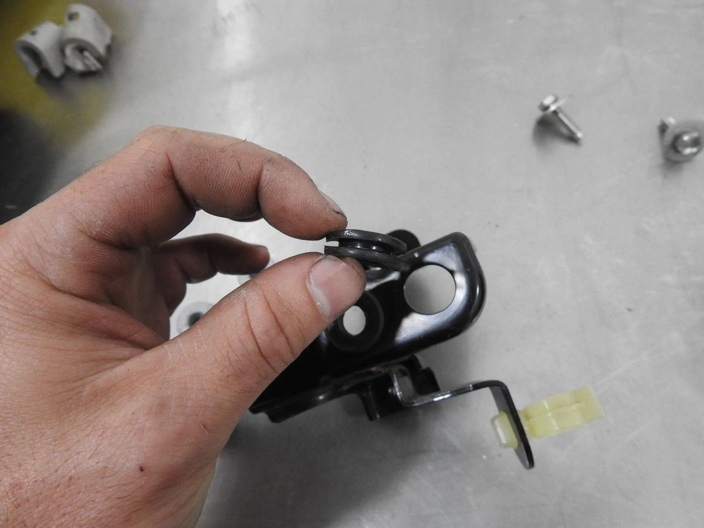

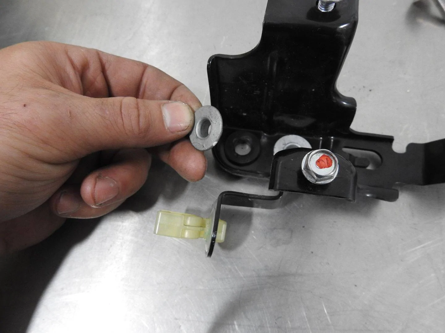

10. Locate the OEM fuel line bracket removed in step 6.
  • Pull the steel spacers out of the rubber isolators.
  • Peel the rubber isolators out of the OEM bracket
  • Press isolators into the PRL Flex Fuel bracket.
  • Install the steel spacers into the rubber isolators with the washer face facing forward.

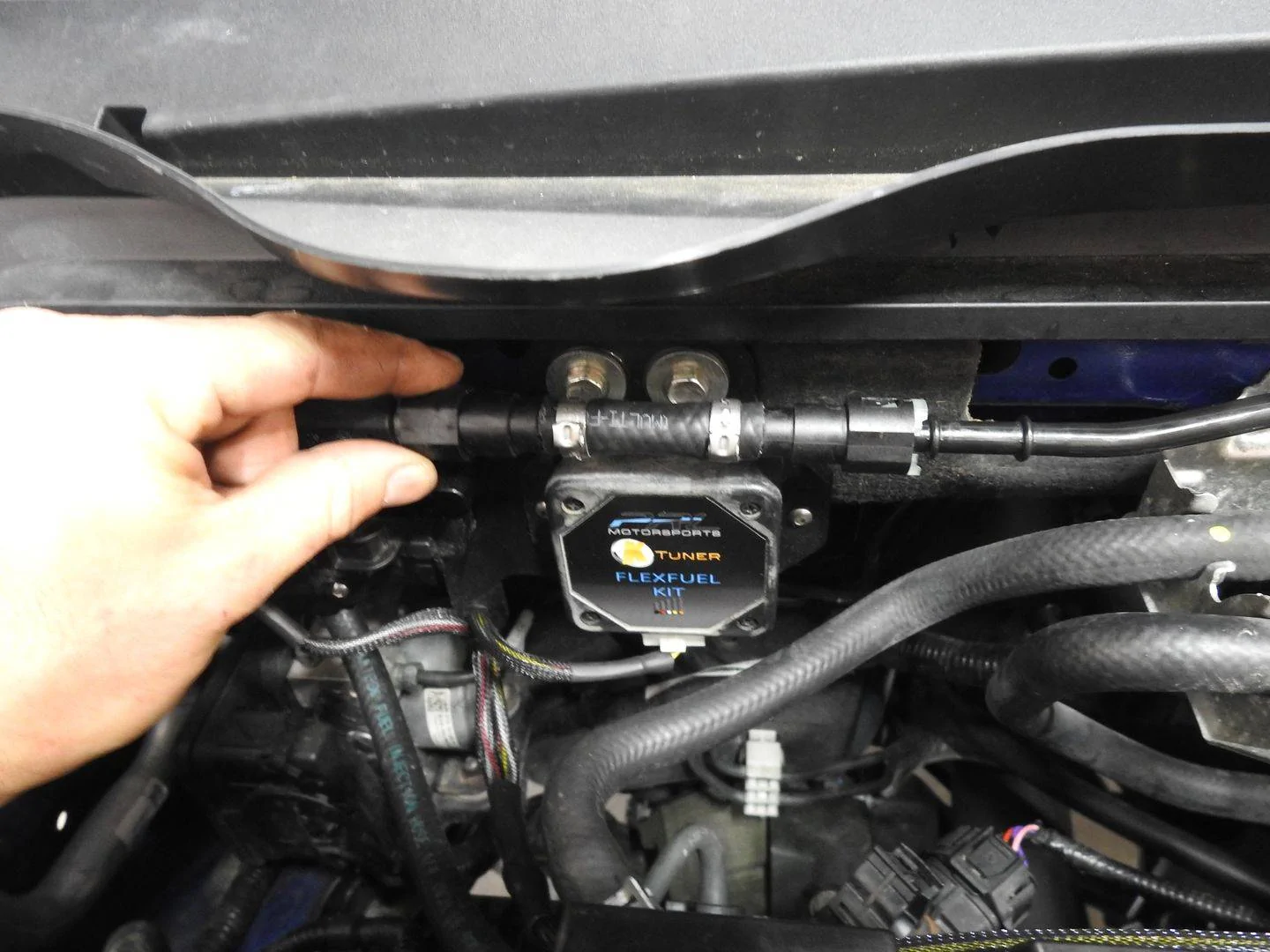

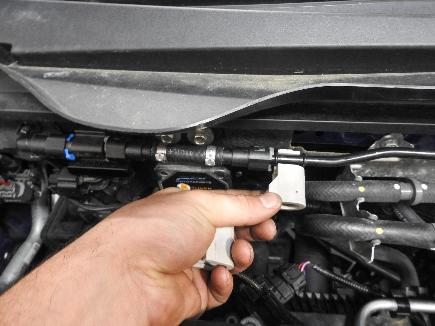

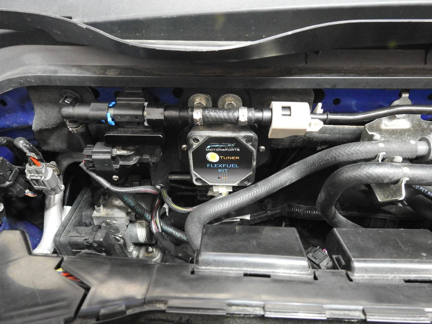

12. Install assembly into the factory fuel line bracket mounting location using the OEM hardware.
11th Gen Honda Civic PRL Motorsports 2017+ Honda Civic Type-R FK8 Plug ‘N Play Flex Fuel Kit Install Guide DSCN7674_zpstv2kkgwc

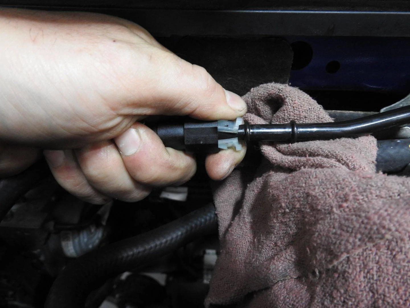

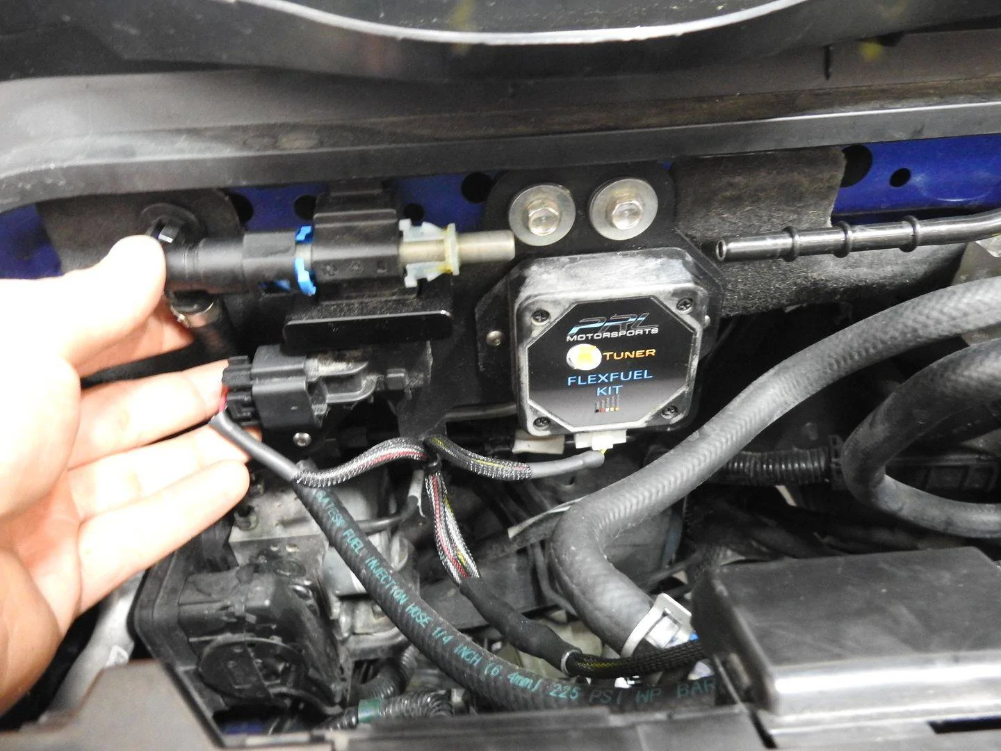

13. Install the fuel inlet hose that you uninstalled in step 11 onto the OEM feed line and ethanol content sensor.
11th Gen Honda Civic PRL Motorsports 2017+ Honda Civic Type-R FK8 Plug ‘N Play Flex Fuel Kit Install Guide DSCN7676_zpshe1vbskg

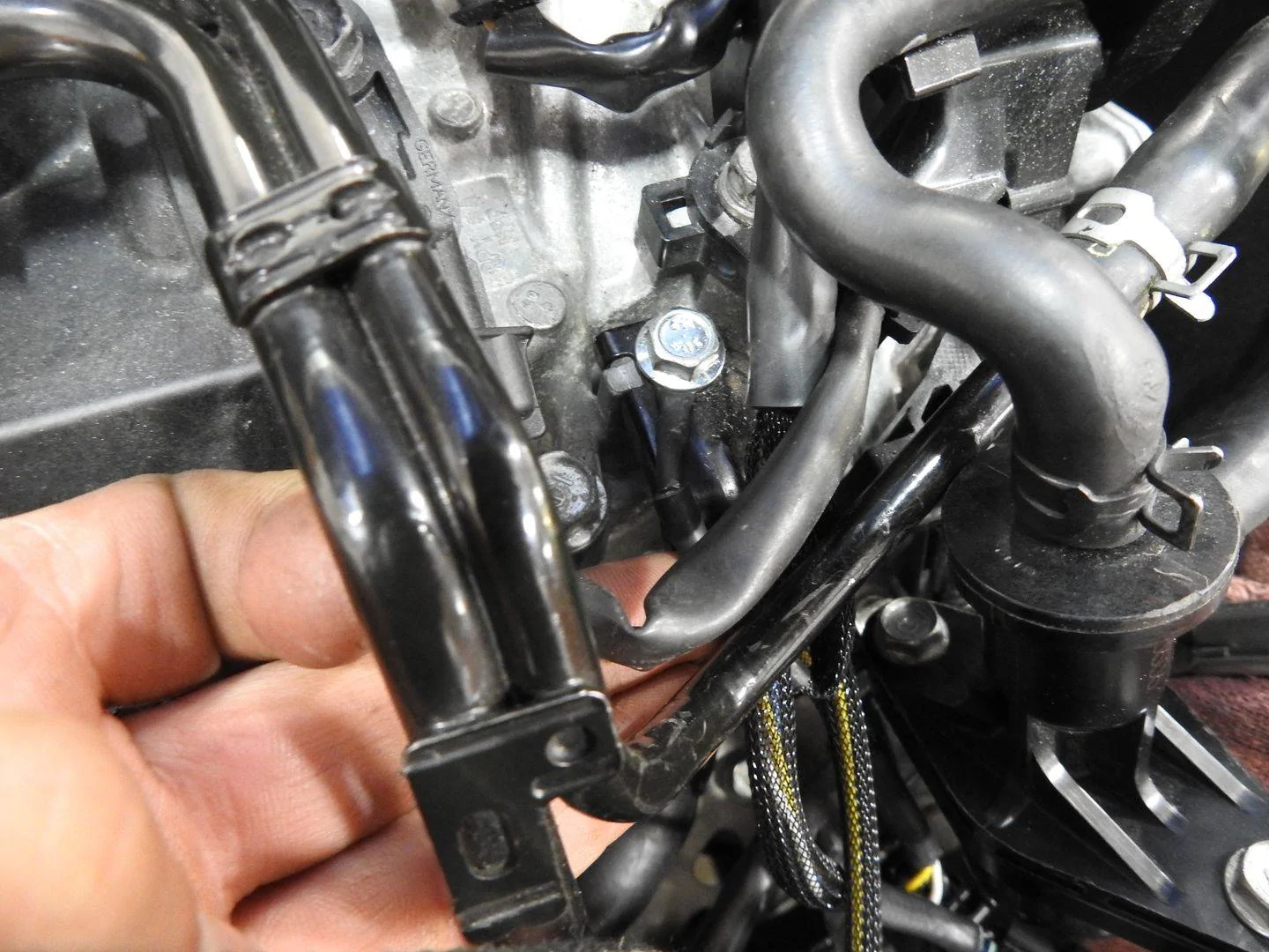

14. Route the fuel line through the factory clips you unhooked in step 4, clip the line onto the inlet of the high pressure fuel pump.

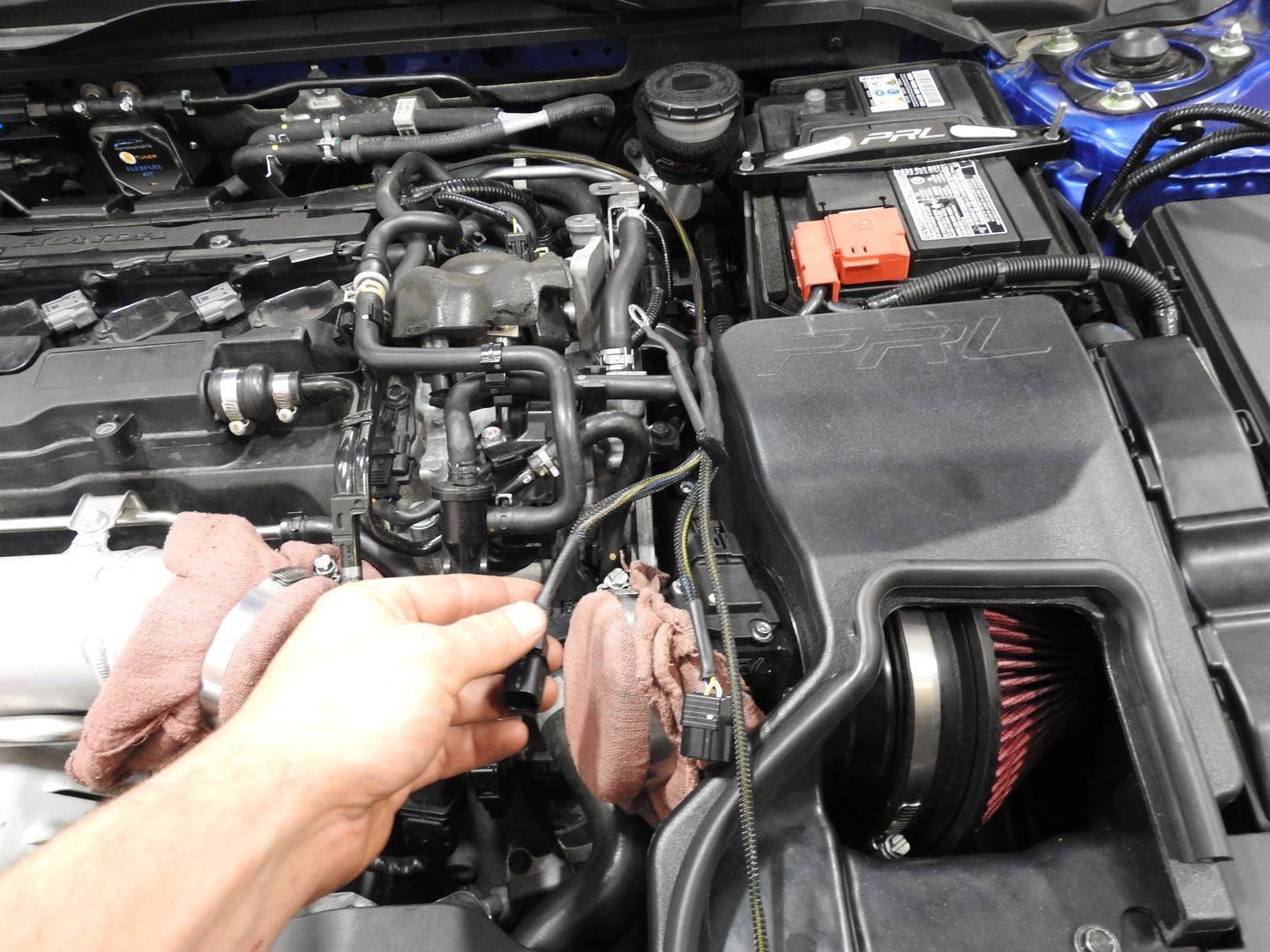

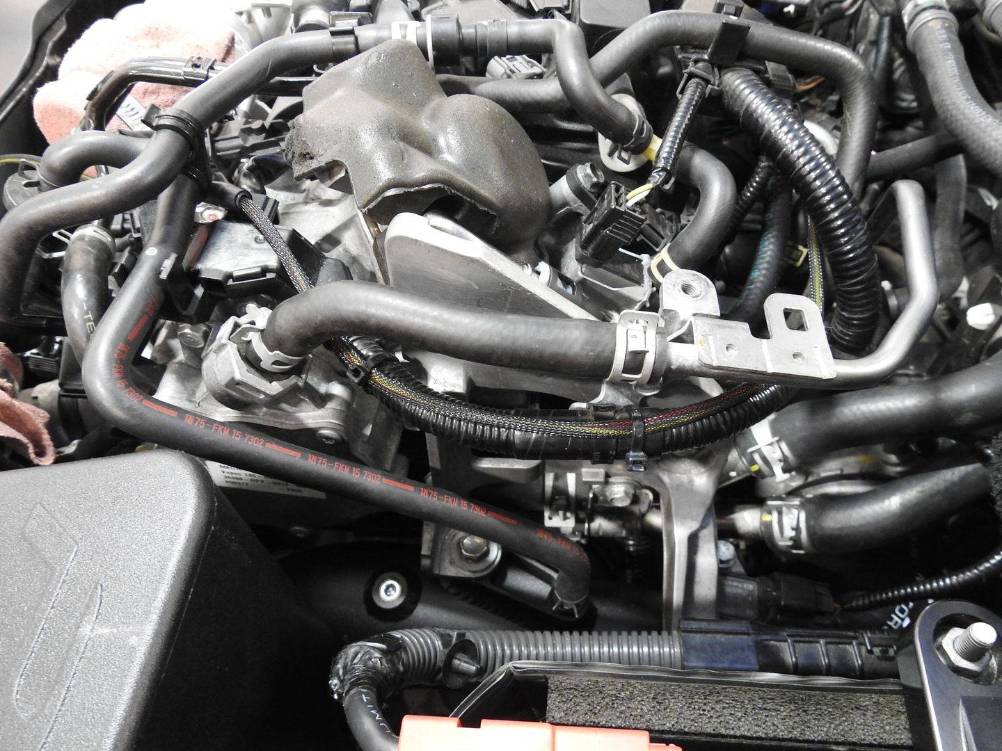

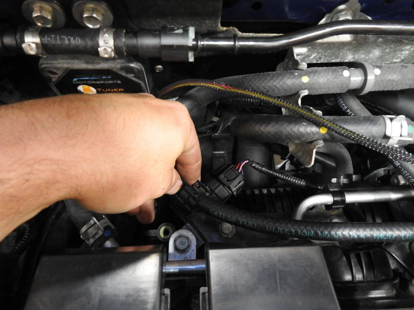

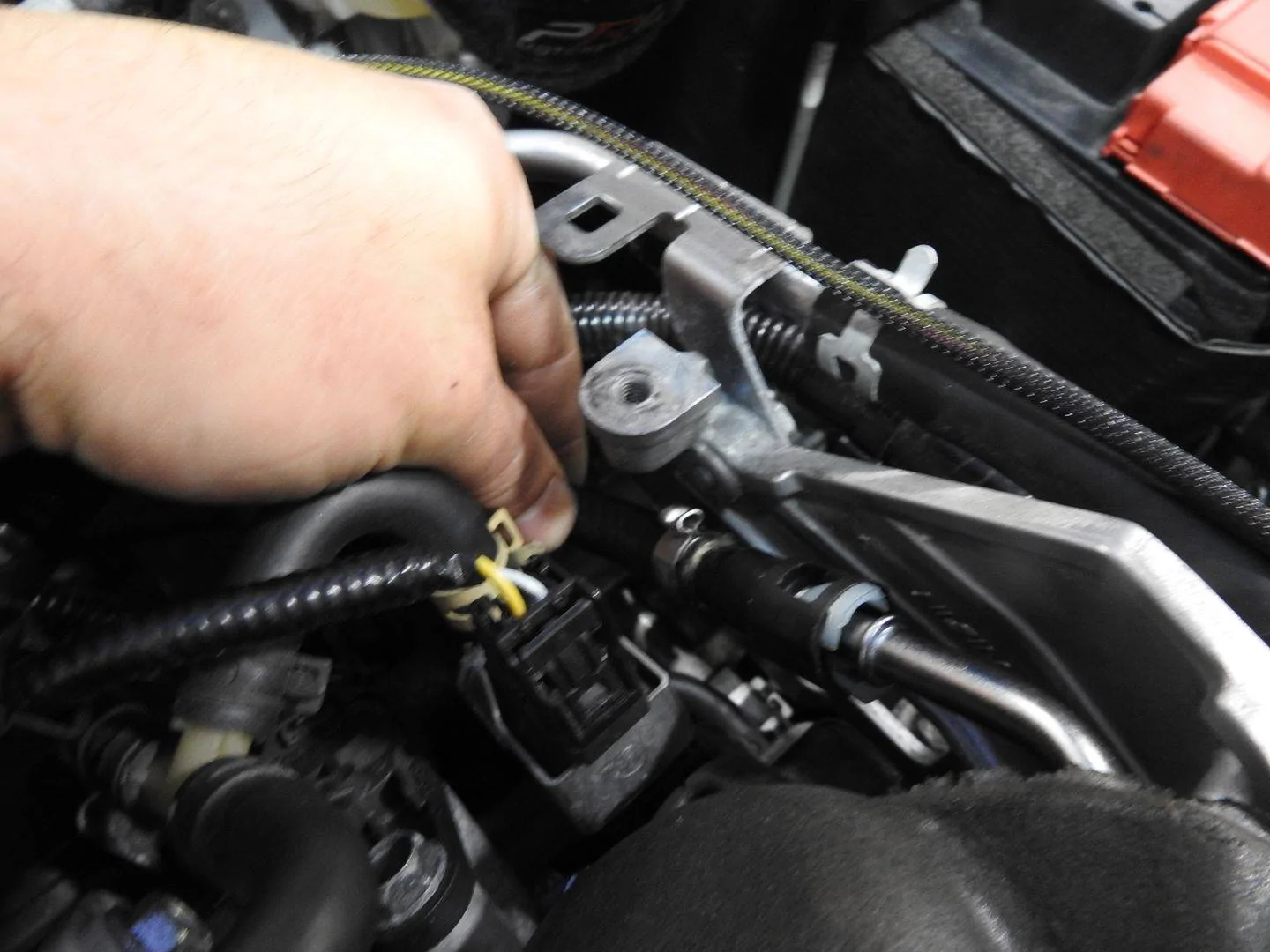

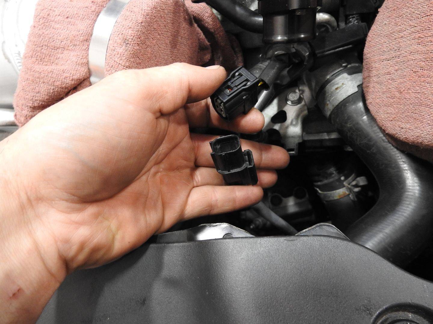

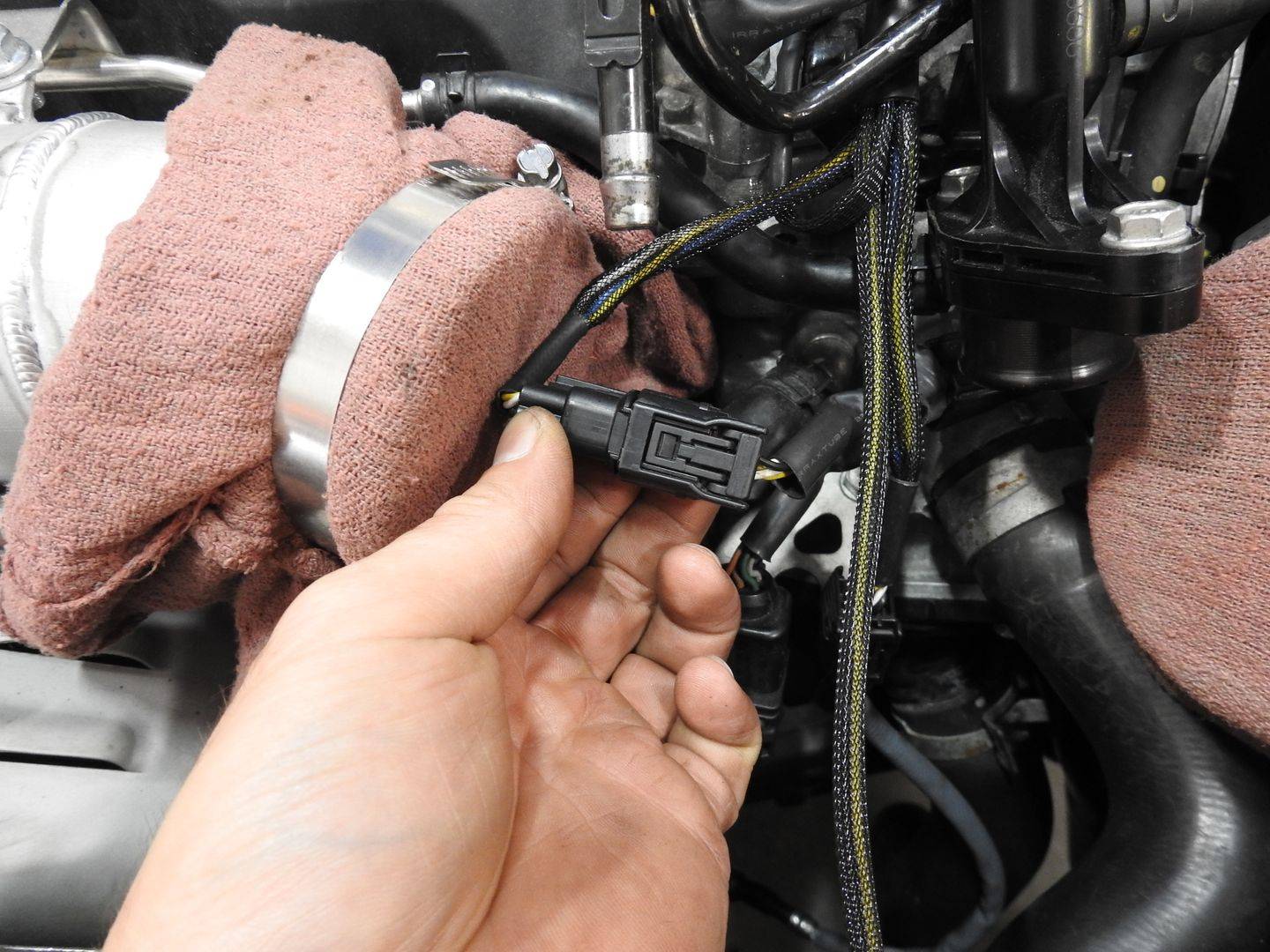

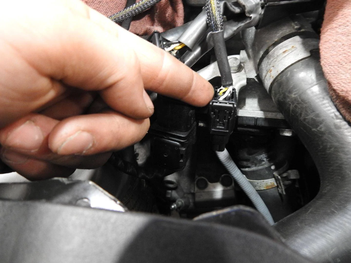

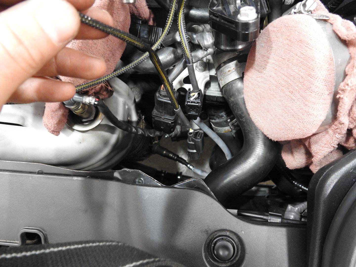

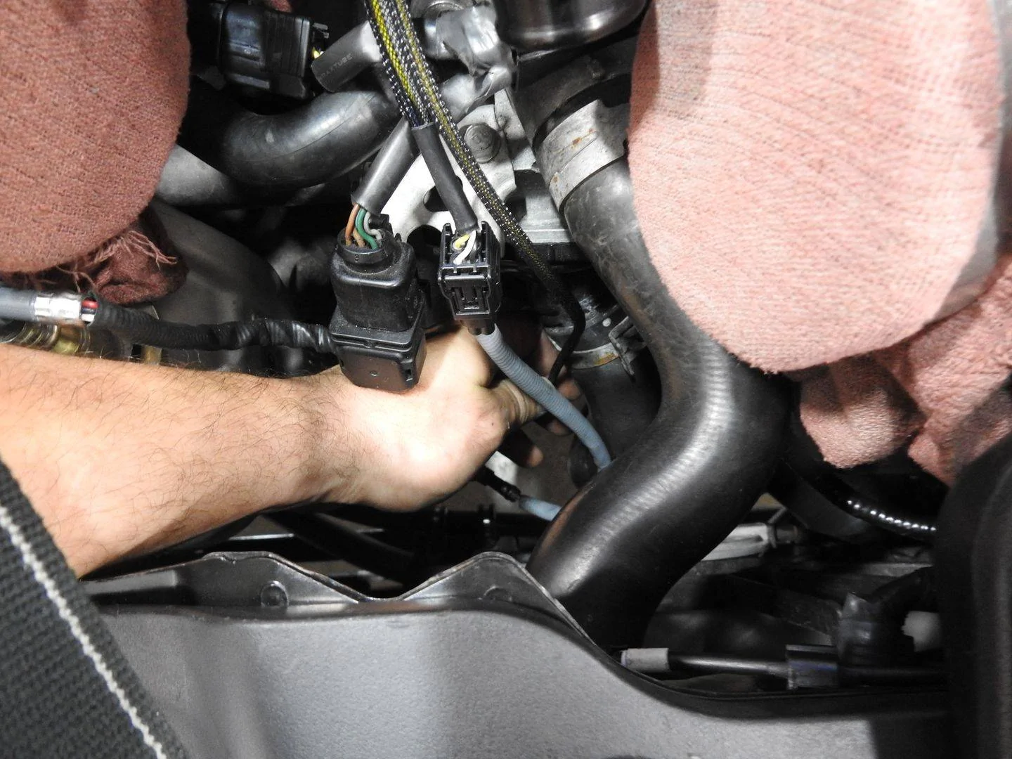

15. Remove the inlet hose to gain access to the secondary o2 connectors. Please refer to our other installations for this step. Our car has the PRL High Volume Intake System installed, so it was as simple as using a flat-blade screwdriver to loosen (4) hose clamps and pull the silicone up and out of the car.
16. Route the PRL harness along the intake manifold, following the fuel line, at the area of the high pressure fuel pump, route the harness along the factory wiring harness shown in the pictures, having the o2 plugs terminate near the OEM ones. Place zip-ties around the harness at your discretion, leaving them loose until the rest of the harness is installed.
11th Gen Honda Civic PRL Motorsports 2017+ Honda Civic Type-R FK8 Plug ‘N Play Flex Fuel Kit Install Guide DSCN7681_zpsmwiu3sst
11th Gen Honda Civic PRL Motorsports 2017+ Honda Civic Type-R FK8 Plug ‘N Play Flex Fuel Kit Install Guide DSCN7685_zps6xmglnv
11th Gen Honda Civic PRL Motorsports 2017+ Honda Civic Type-R FK8 Plug ‘N Play Flex Fuel Kit Install Guide DSCN7677_zpstuc3kxjl

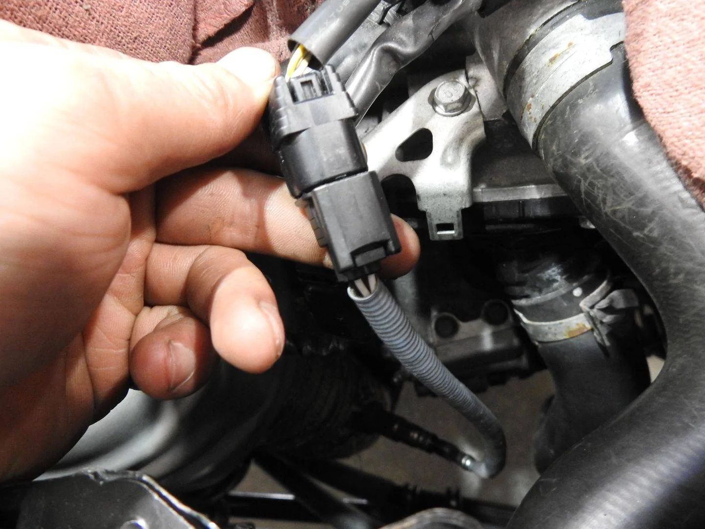

17. Unhook the rear o2 from the factory bracket. Reaching behind it you have to depress the tab at the bottom of connector and slide it down off of the bracket. Disconnect the OEM rear o2 from the chassis harness.
11th Gen Honda Civic PRL Motorsports 2017+ Honda Civic Type-R FK8 Plug ‘N Play Flex Fuel Kit Install Guide DSCN7689_zps3cwxvx4f
11th Gen Honda Civic PRL Motorsports 2017+ Honda Civic Type-R FK8 Plug ‘N Play Flex Fuel Kit Install Guide DSCN7683_zpsxkuztjjr
11th Gen Honda Civic PRL Motorsports 2017+ Honda Civic Type-R FK8 Plug ‘N Play Flex Fuel Kit Install Guide DSCN7684_zpspeylxf1q

19. Plug in the female side of the PRL harness into the factory rear o2 plug. Clip this portion back into the factory steel bracket.
20. Plug in the male side of the PRL harness into the female chassis harness o2 connector.
11th Gen Honda Civic PRL Motorsports 2017+ Honda Civic Type-R FK8 Plug ‘N Play Flex Fuel Kit Install Guide DSCN7690_zpsjopdtf7f

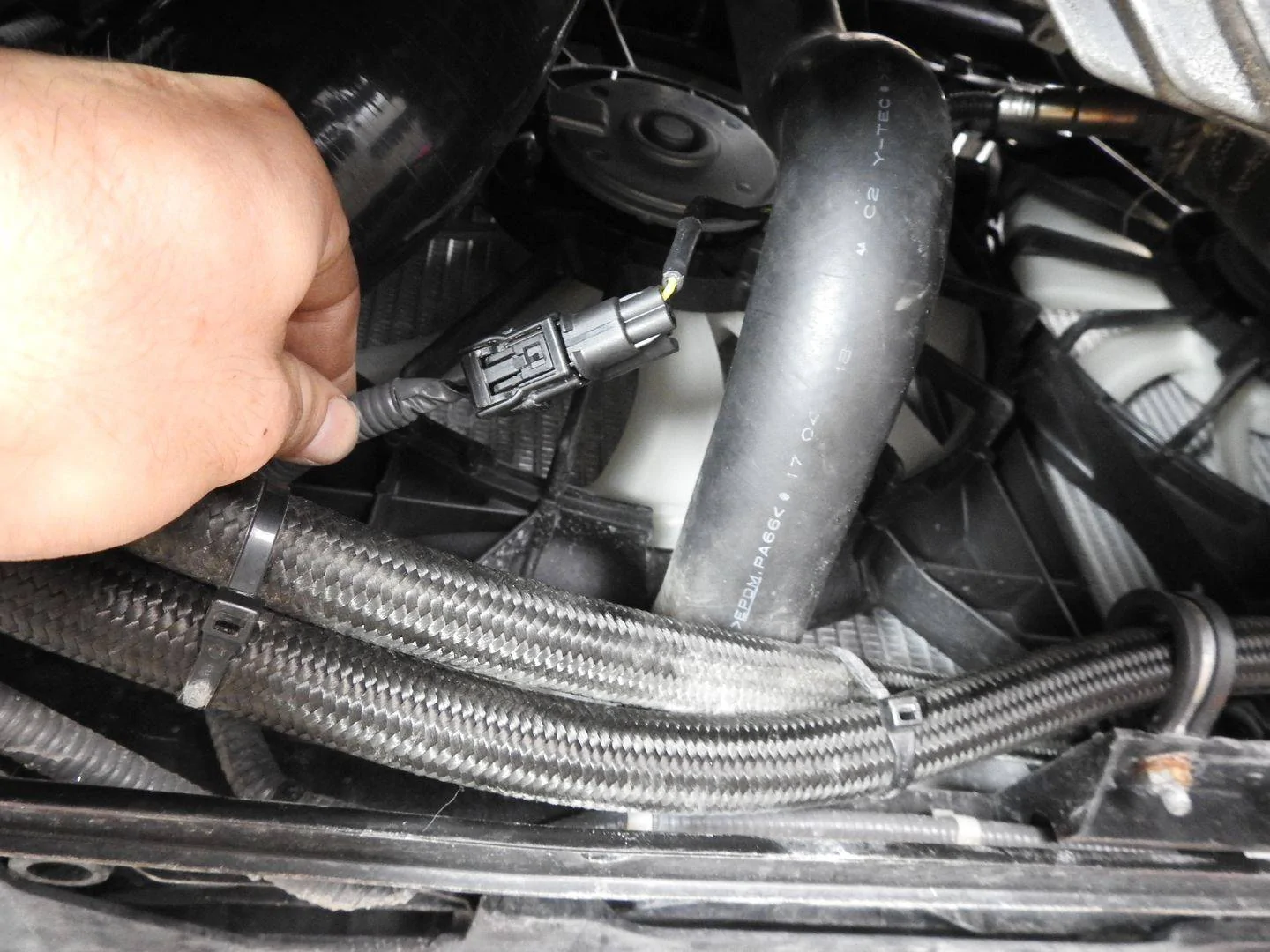

21. Route the ECT2 plug down along the rear o2 harness and radiator hose.
11th Gen Honda Civic PRL Motorsports 2017+ Honda Civic Type-R FK8 Plug ‘N Play Flex Fuel Kit Install Guide DSCN7691_zpsxzzcduzm
11th Gen Honda Civic PRL Motorsports 2017+ Honda Civic Type-R FK8 Plug ‘N Play Flex Fuel Kit Install Guide DSCN7692_zps4re37axs

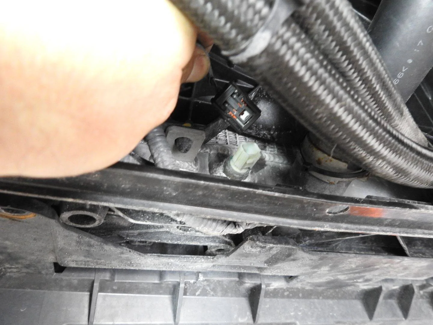

22. Locate and remove the ECT plug at the bottom of radiator on the driver’s side. Usually it is possible to do this from above, reaching down along the radiator. If you find this method troublesome, you will have to jack the car up and remove the under tray to gain access to this plug. Please use safe operating procedures and place jack stands appropriately before climbing under the car.
11th Gen Honda Civic PRL Motorsports 2017+ Honda Civic Type-R FK8 Plug ‘N Play Flex Fuel Kit Install Guide DSCN7696_zpskjz0usza
11th Gen Honda Civic PRL Motorsports 2017+ Honda Civic Type-R FK8 Plug ‘N Play Flex Fuel Kit Install Guide DSCN7697_zpsj0ofnfwk
23.Using the remaining zip-ties please fasten the harness down to remain clear of the radiator fan and any other hazards in the engine bay.
24. Reinstall the safety clips at this time and check all connections.
