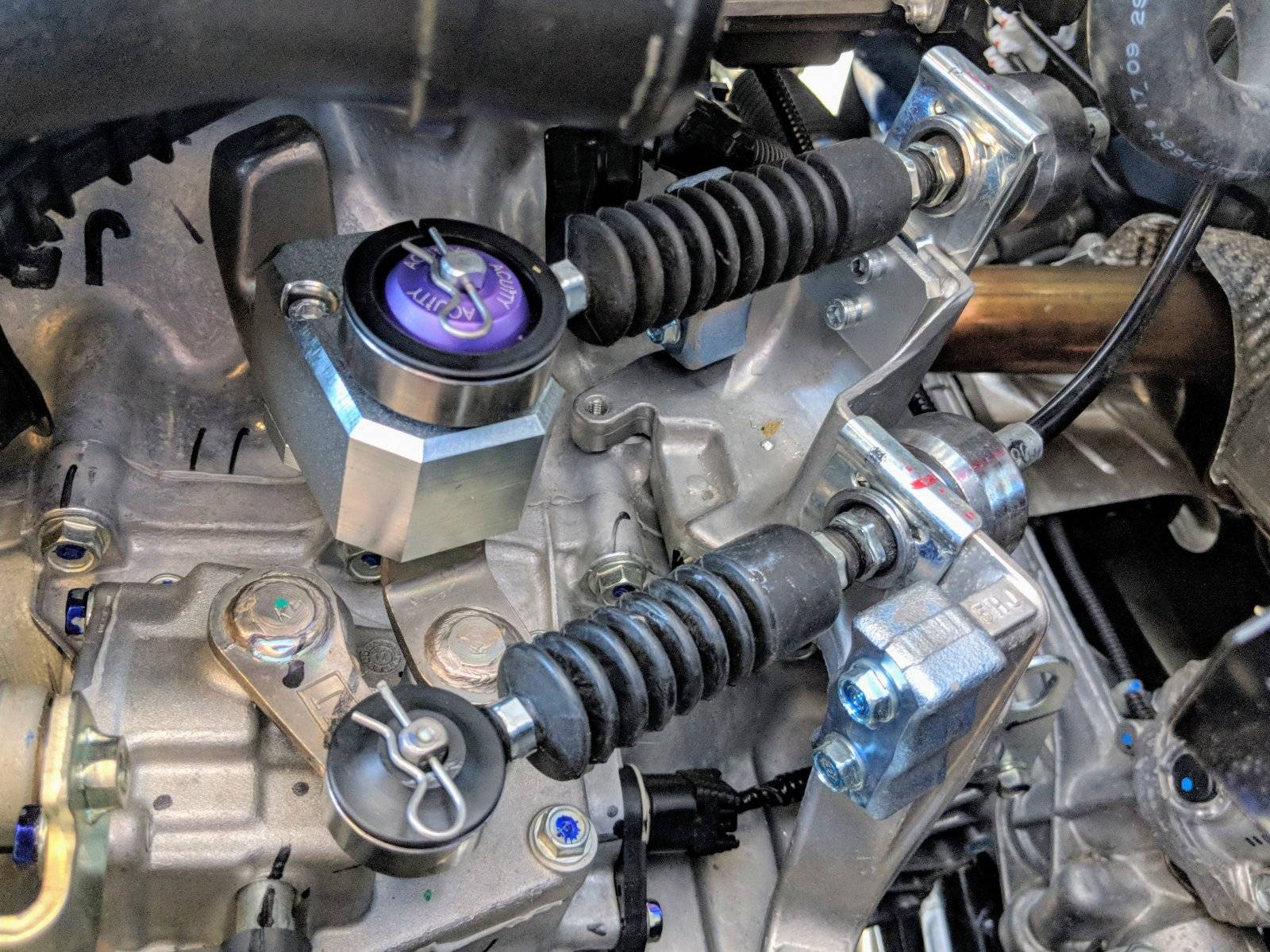

This is more of a general mechanic question but still important to me before I decide to mod anything on the transmission side, I did some research on how the shifter uses shifter cables to move the shaft to change gears, how does one adapter complete this mod? From what I can see there are 2 shifter cables running between the shifter and the transmission connecting to 2 shifter arms. The installation video shows installation on only one of the shifter arms.... Is the one not touched the arm for the reverse gear?

This is for the up n down movements.
The left n right movement is controlled by the rocker arm. That determines the spacing between the rows. You can tighten that up a little by getting a Type R rocker, it even more with the Acuity rocker.

Just finally got this installed. I noticed that the shifting from left to right is a bit harder to move such as if i push it all the way to the right it almost stays there. Is this part intended?

you not reinstall your centering spring correctly?

Centering spring? I didnt take apart the interior part. This is for the trans adapter. Everything was installed like in the pictures.

Oh duh, thought this was about the lever replacement.
This relocates where the lever winds up being. Are you just not used to the new location of the lever, or you think something is binding?

I dont know. I just know in the neutral position, wiggling it left or right the trans sticks to the let hand side.
