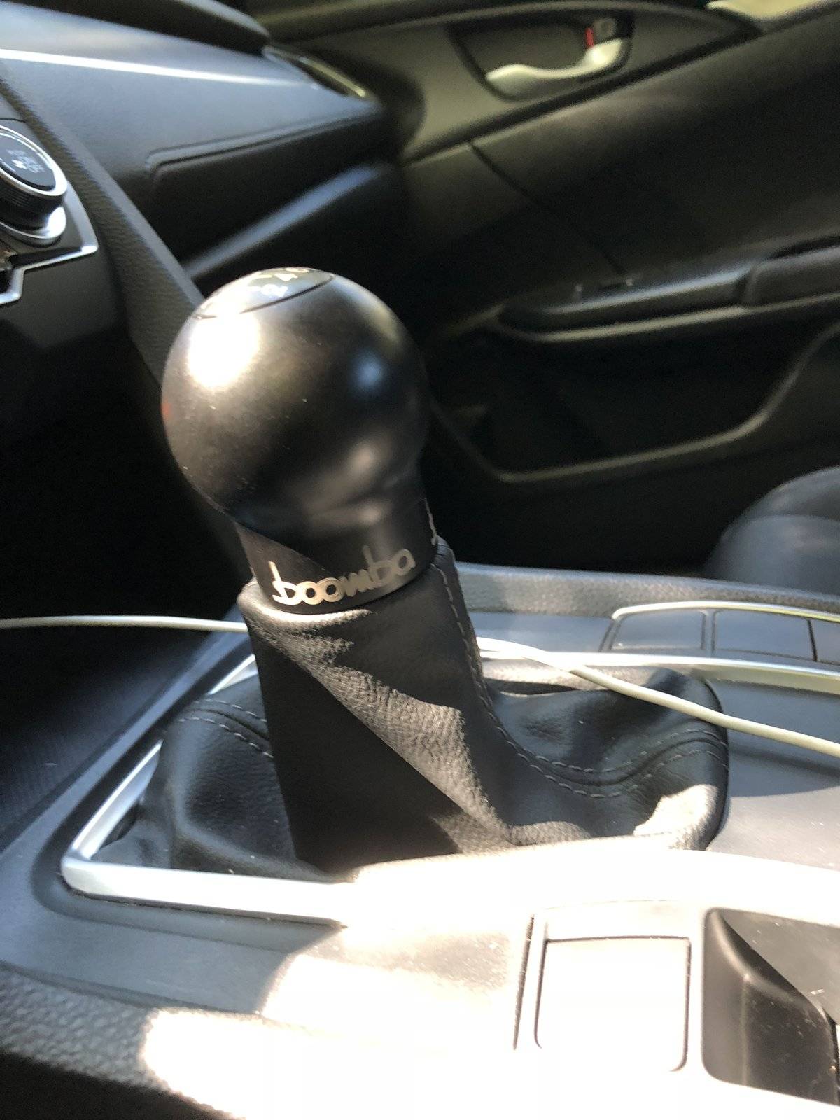

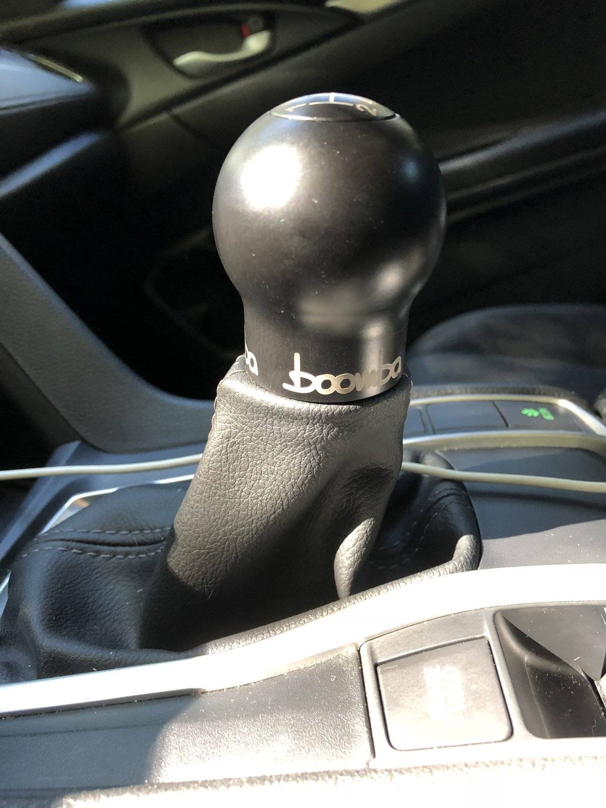

I’d say it’s at least 50% shorter throws, maybe a bit more.

Just wanted to add, this is what the the throws to the front look like:

And throws to the back:
