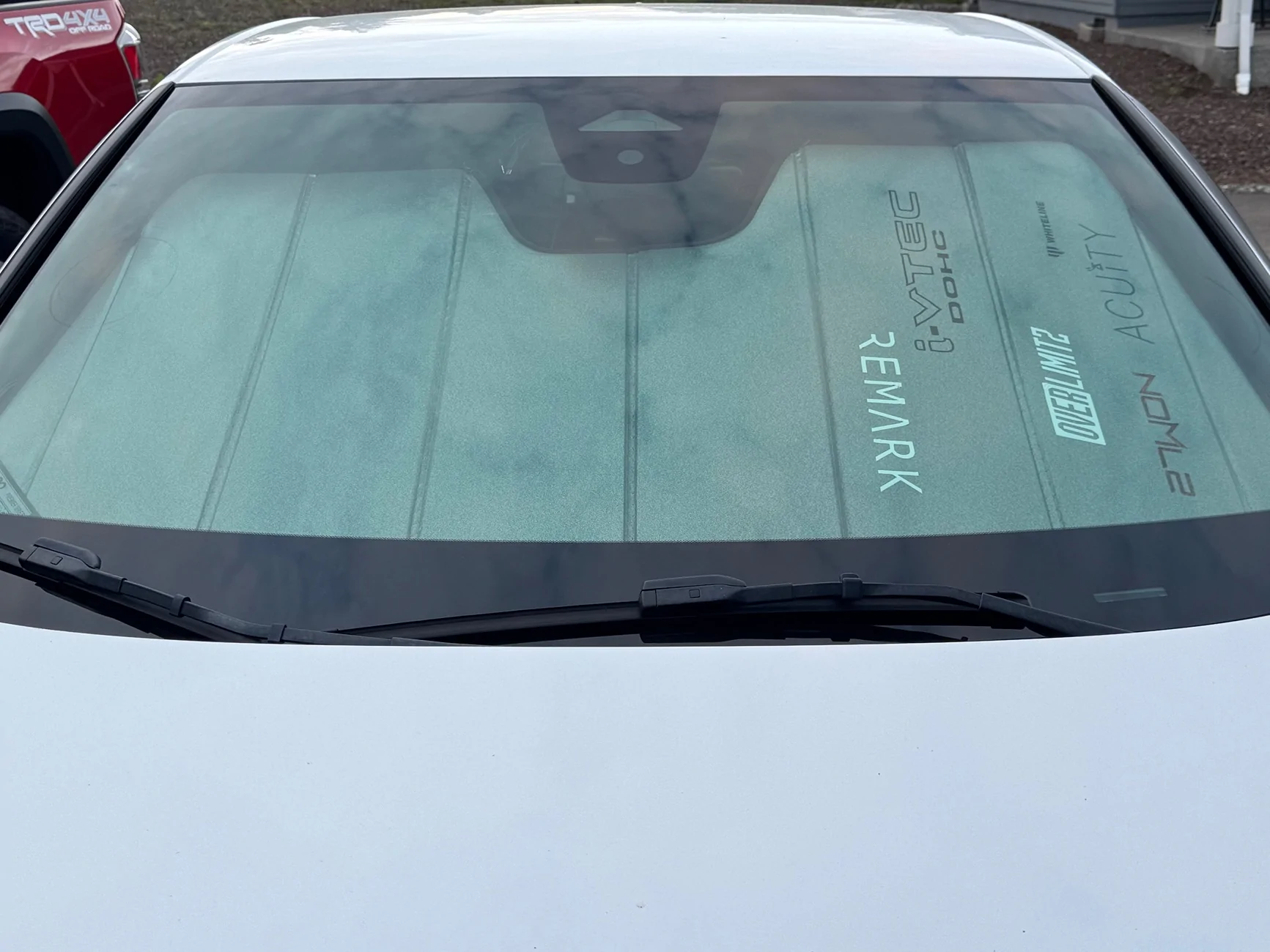

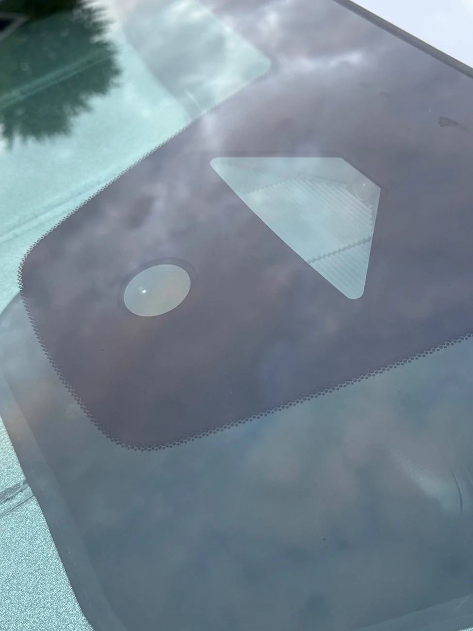

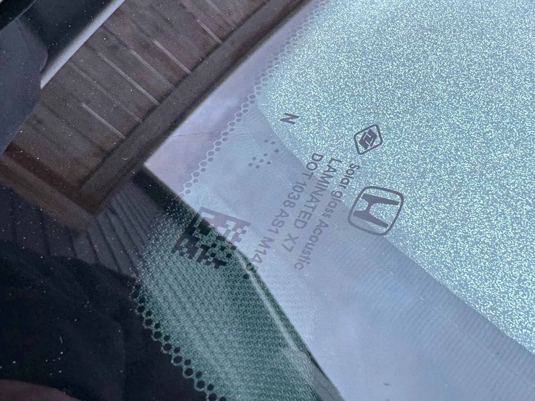

Confirmed: 2023 Sport Touring Windshield (73111-T47-A11) will fit 2023 Sport!
There is a circle where the rain sensor would be (but the Sport does not have this tech).
I am noticing an improvement in cabin noise!
FYI replacement was professionally installed. Recalibration done by Honda Techs.
total cost (parts, labor, recalibration) approx $1700
