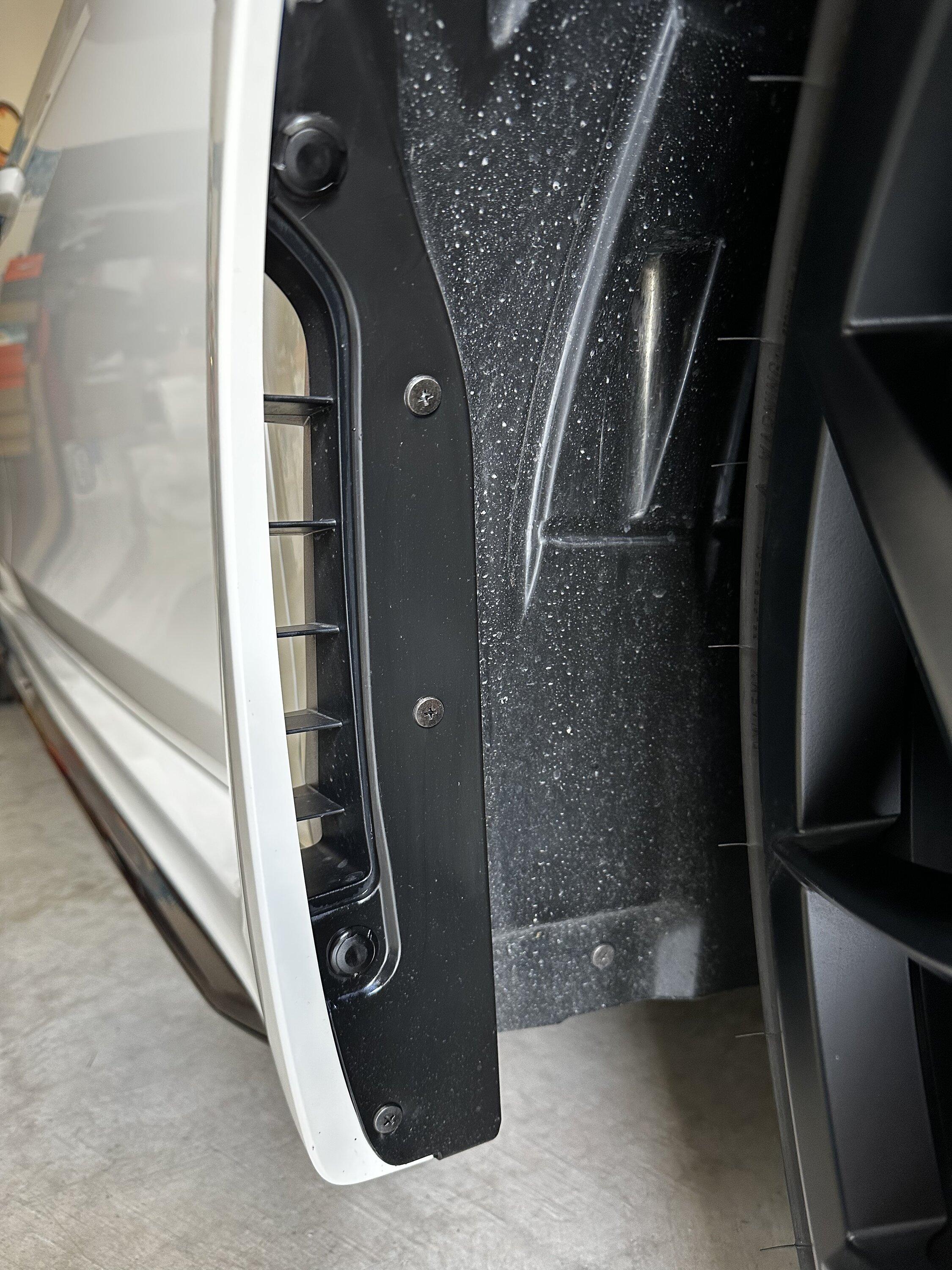

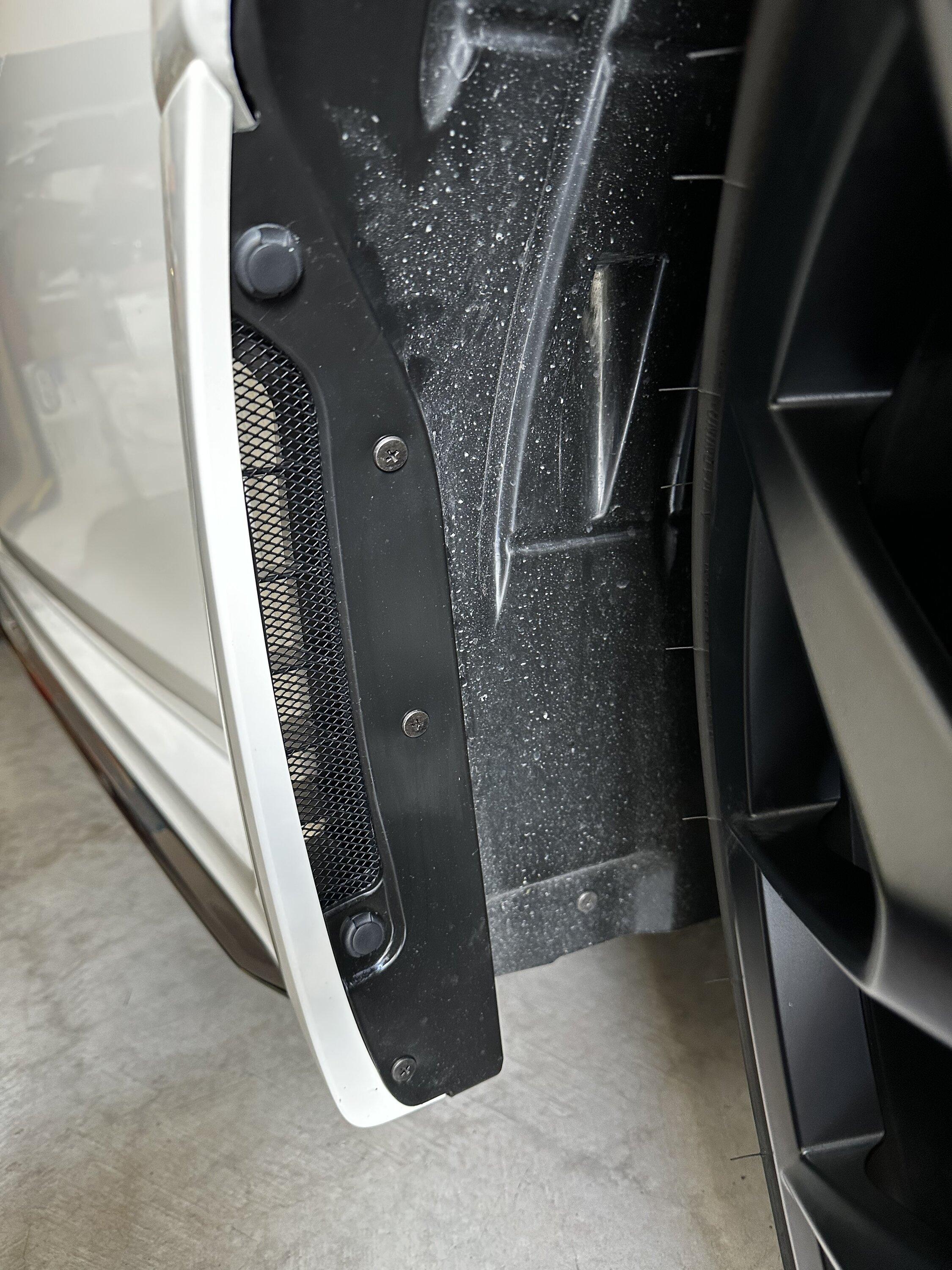

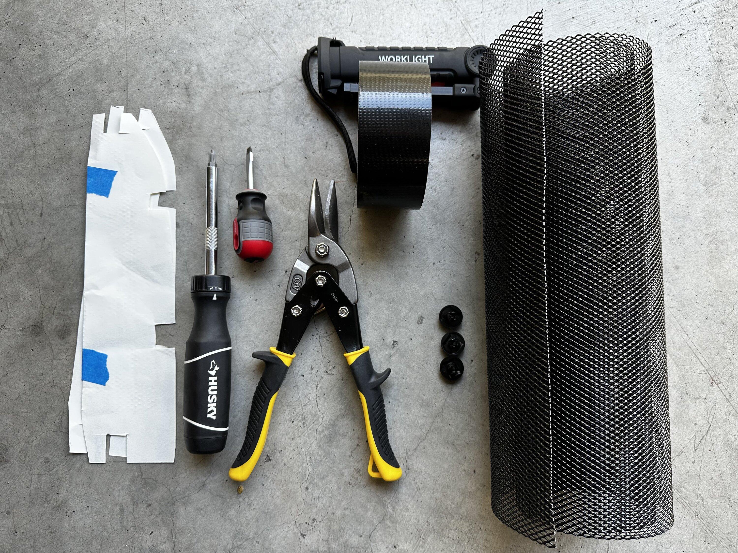

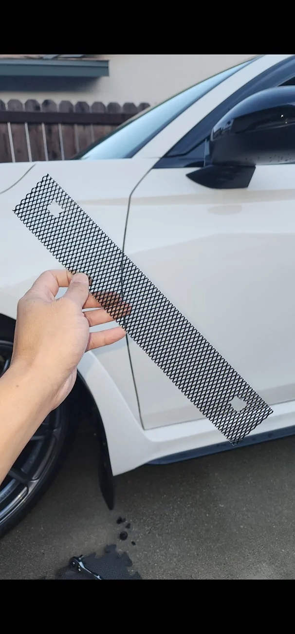

AggAuto Universal 40"x13" Car Grill Mesh 3x6mm Rhombic Holes
Black Gorilla Tape

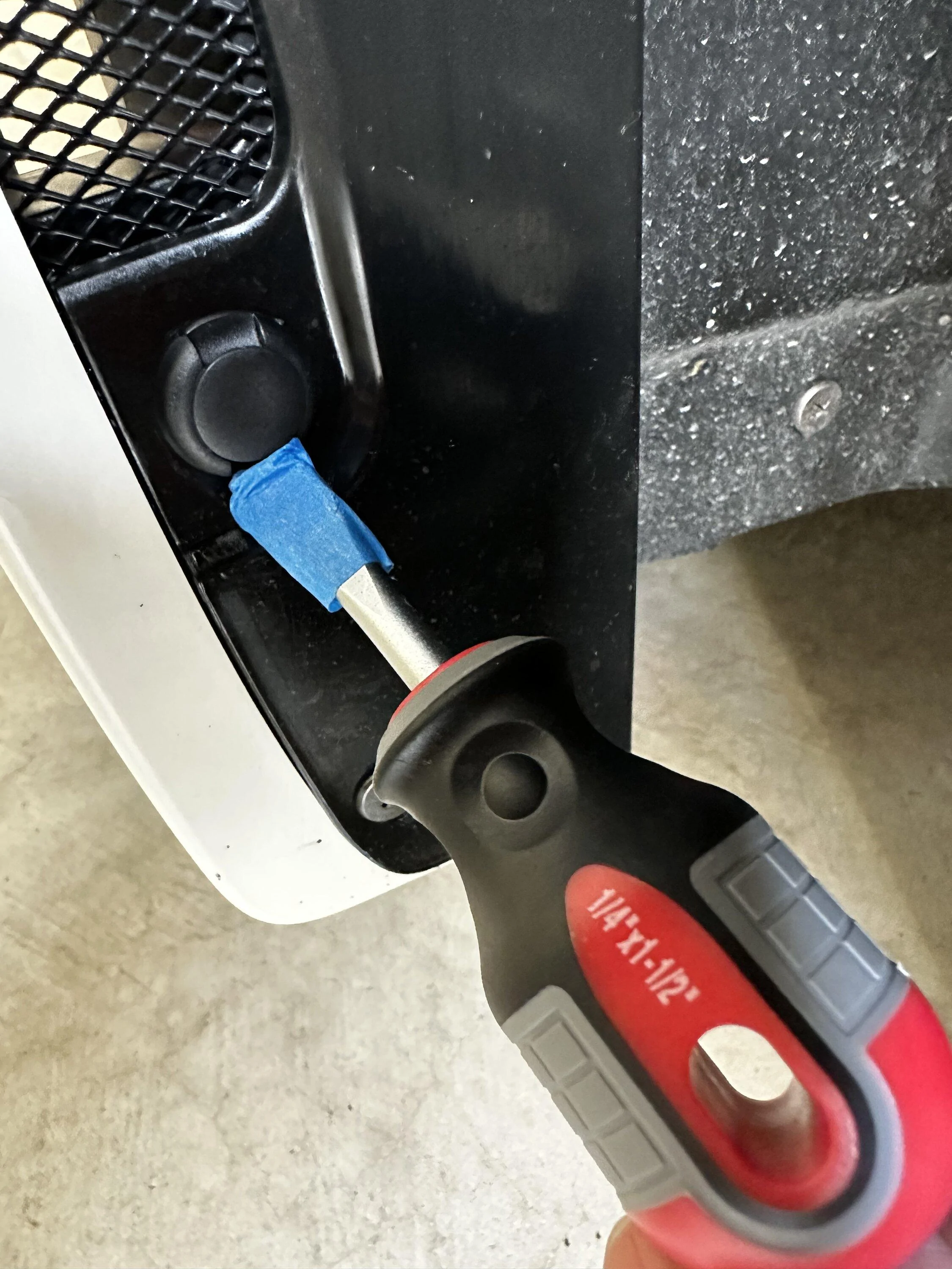

Short flat head for the clips
The trick is to slide in the tab and wiggle gently.
Tried using two screw drivers and freaking broke the first clip
Dealer wanted 4.17 each! So I bought 4 then I figured it out how not to break it!Generic one works but I wanted OEM and right away so no choice…

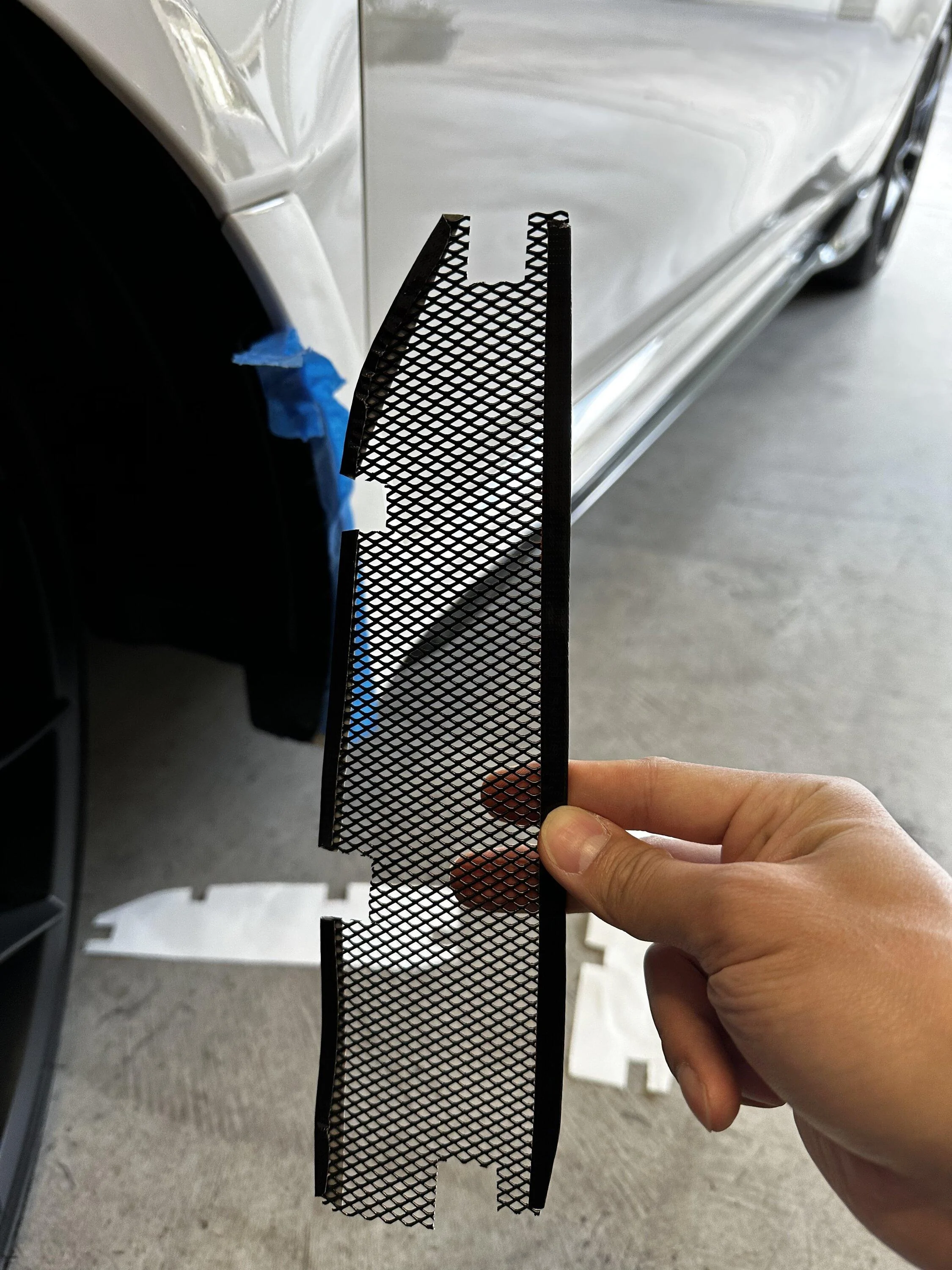

if anyone interested in the mask I can scan and make it printable.
The one I got online is actually off had to make my own.
It looks ghetto but will turn out factory like.

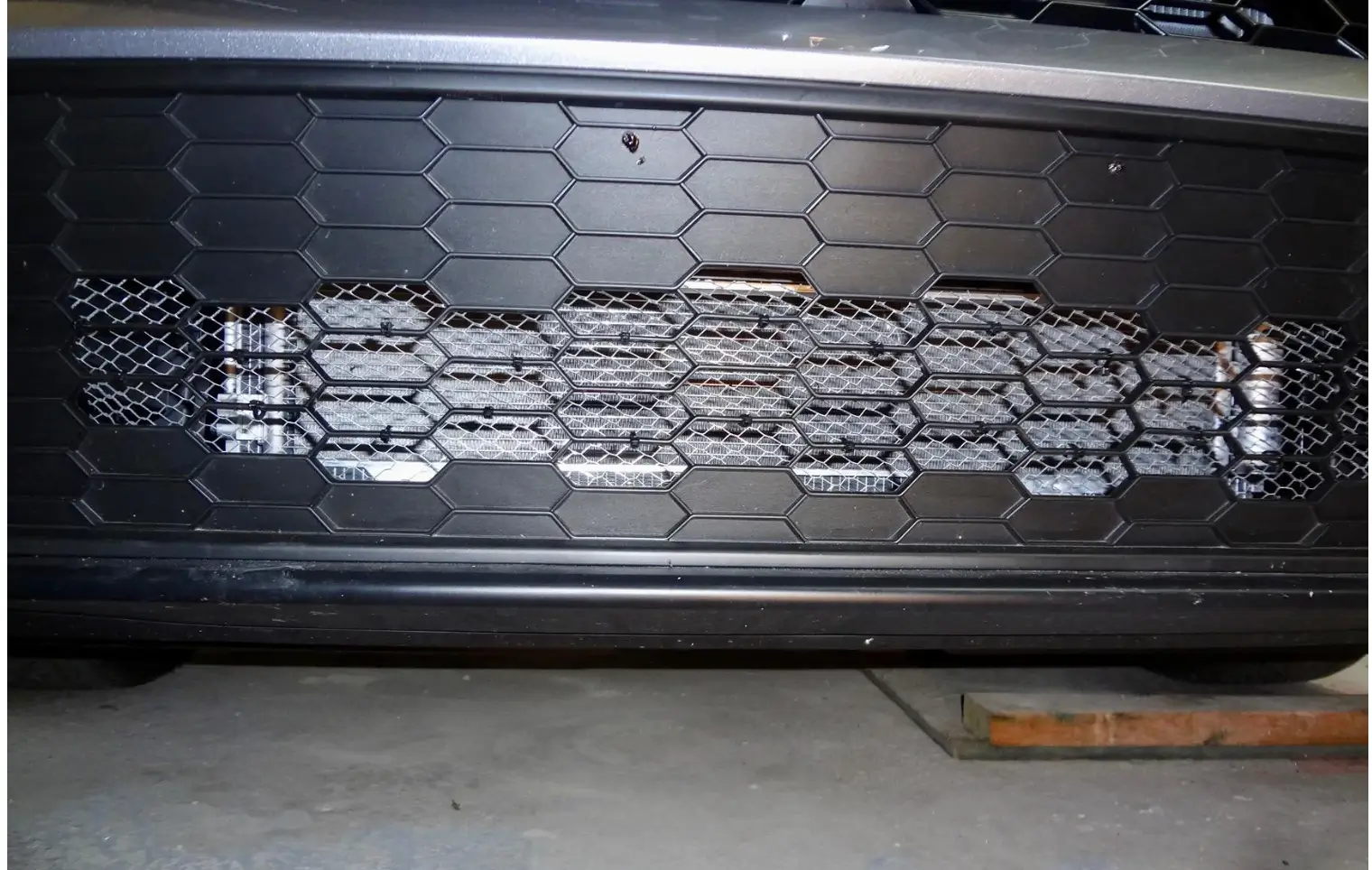

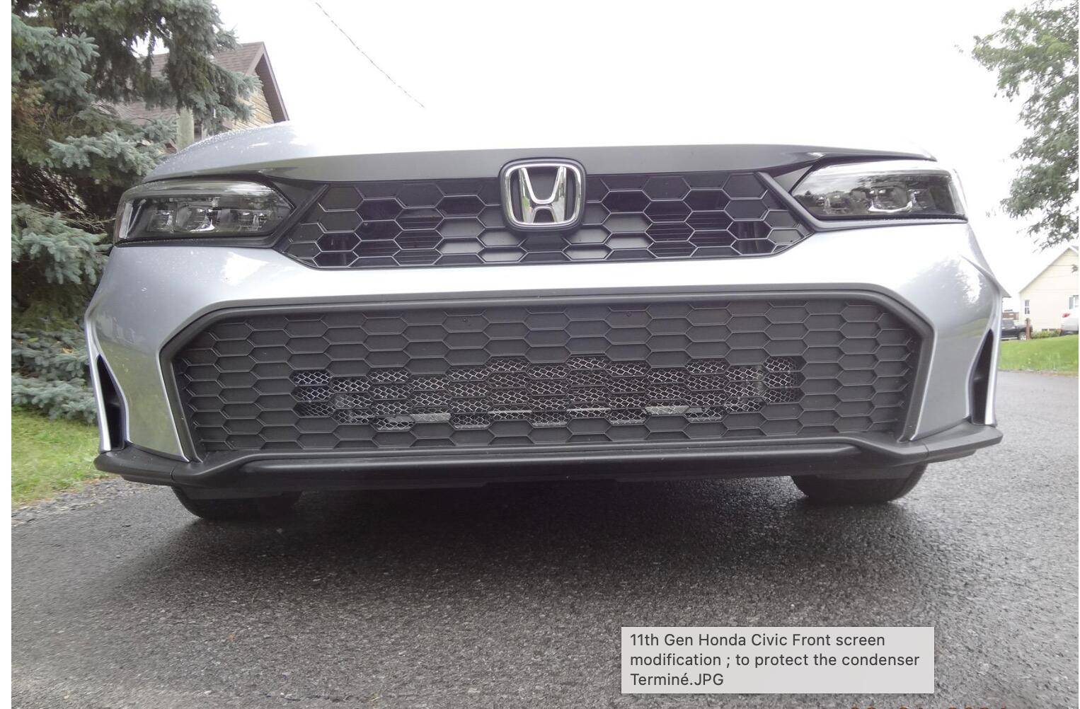

I thought about this as well. My concern is that it cuts down on airflow to the condenser

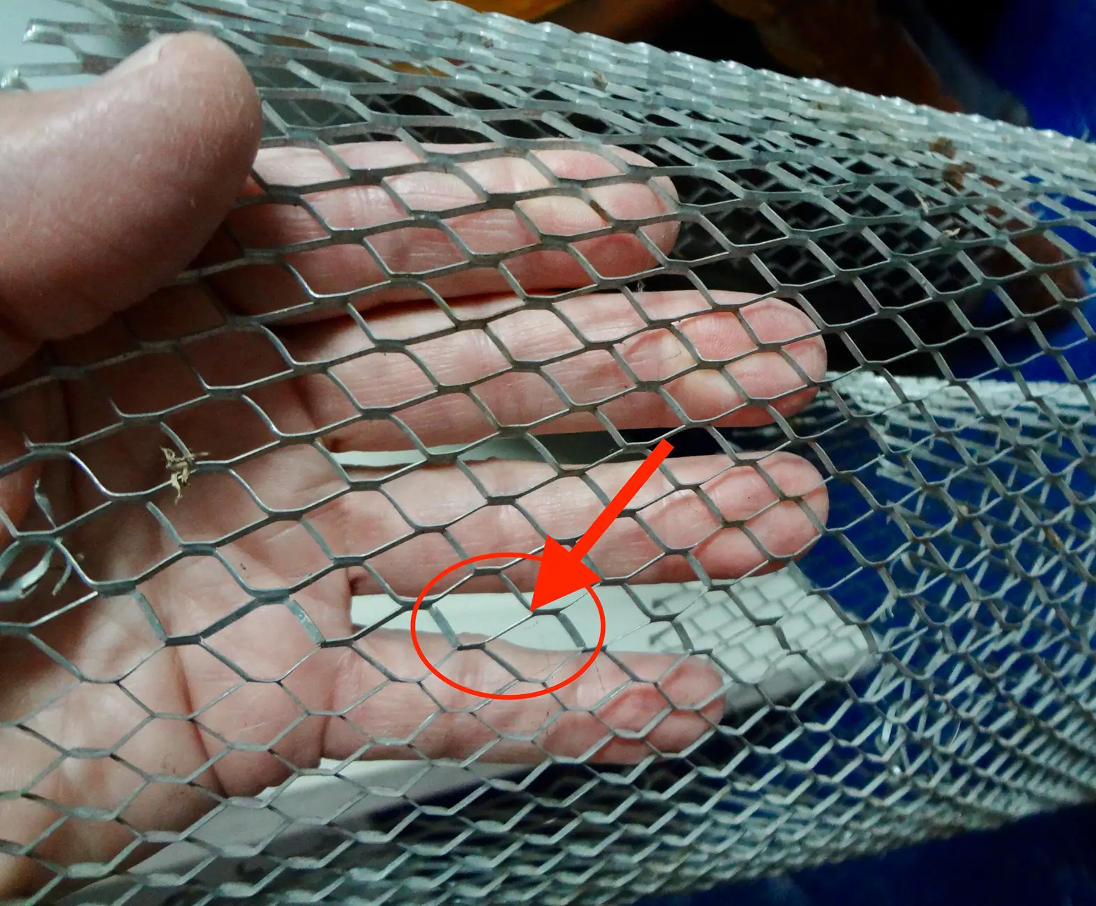

The photo of the car does not show that this cannot be the case. The condenser remains very well supplied with air.
I would not have installed the mesh in this location, which is the subject of #1.
Look how thin the links between the cells are. Arrow

They are pretty thin, so probably an insignificant amount of reduction.

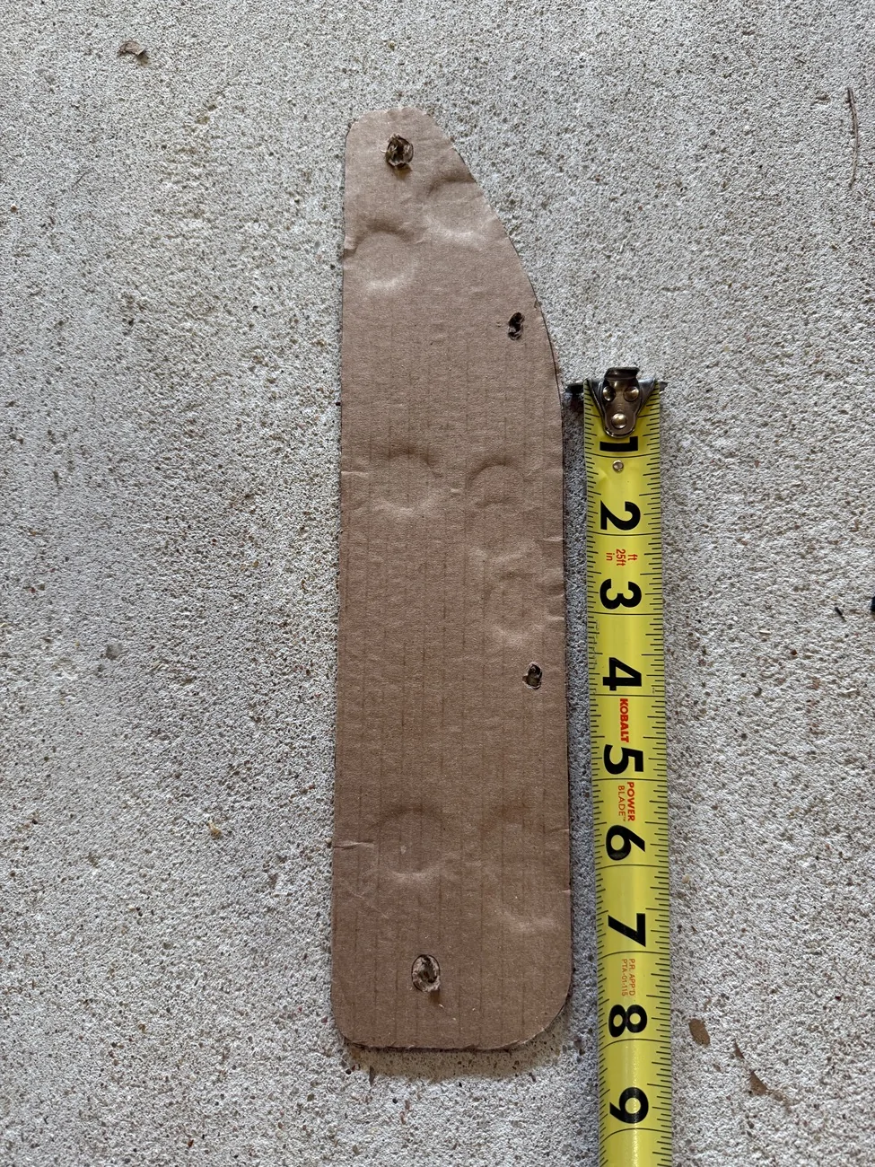

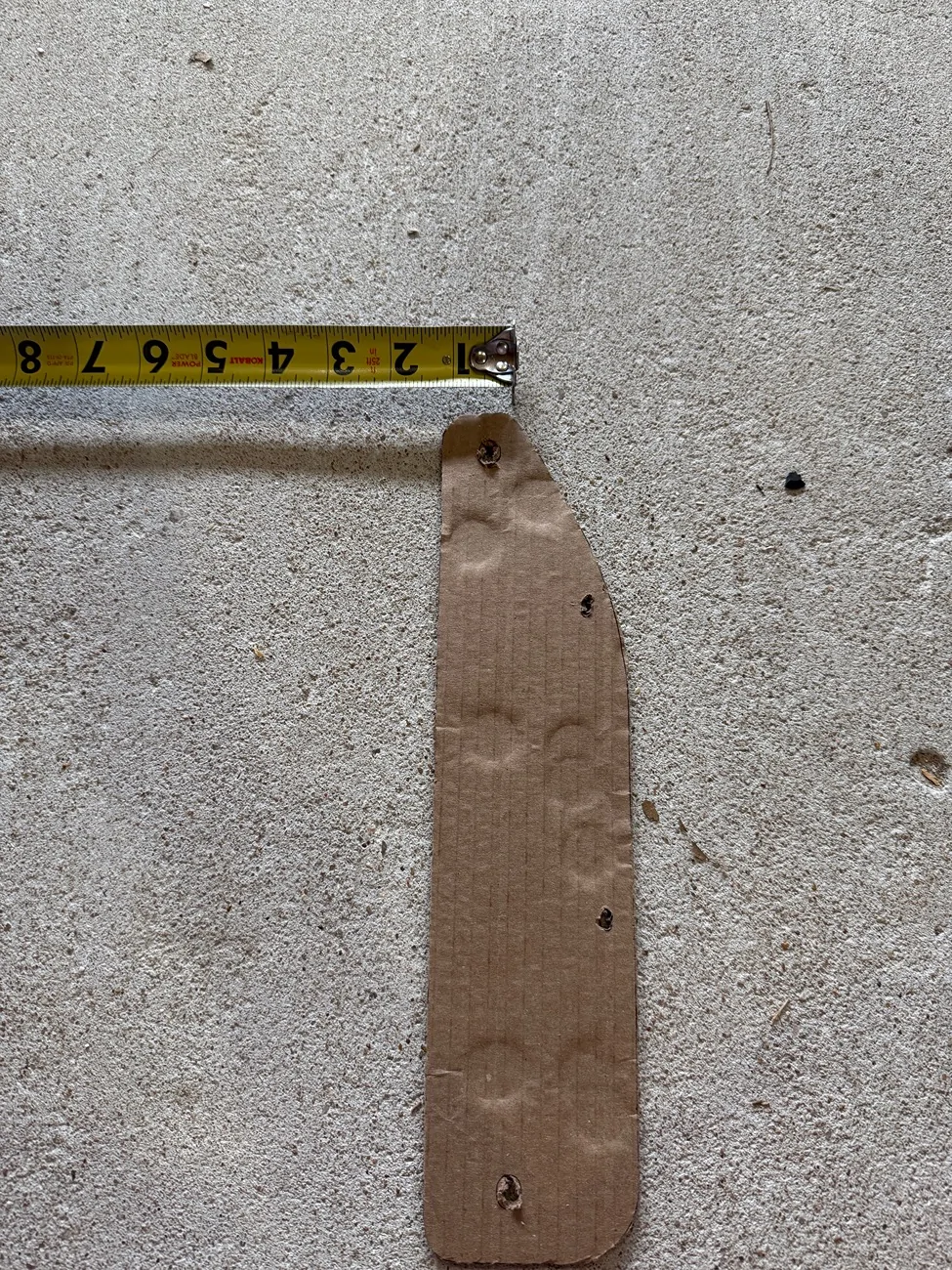

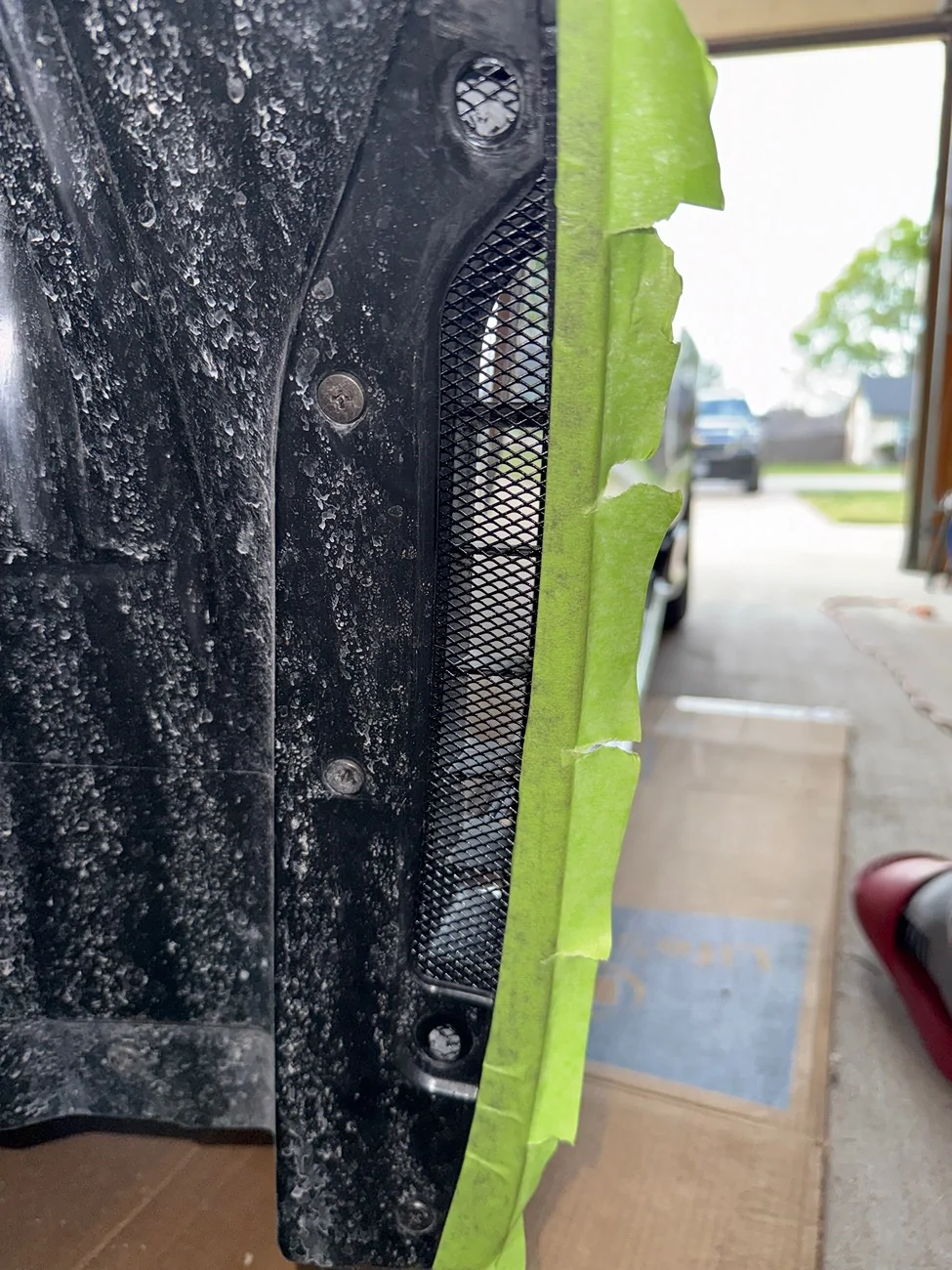

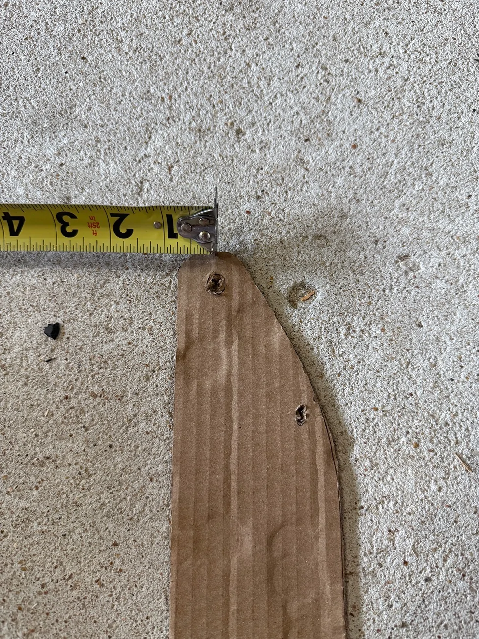

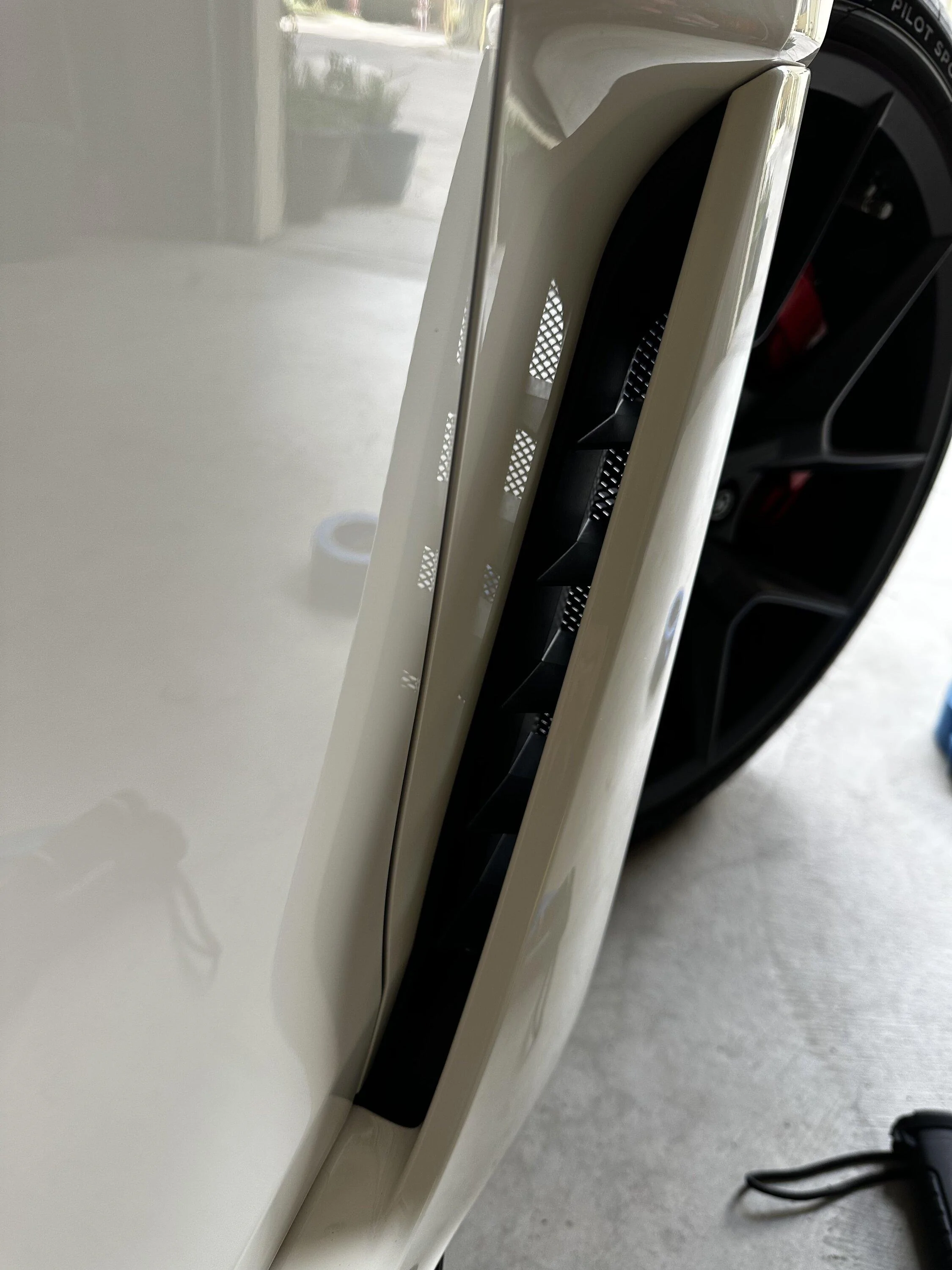

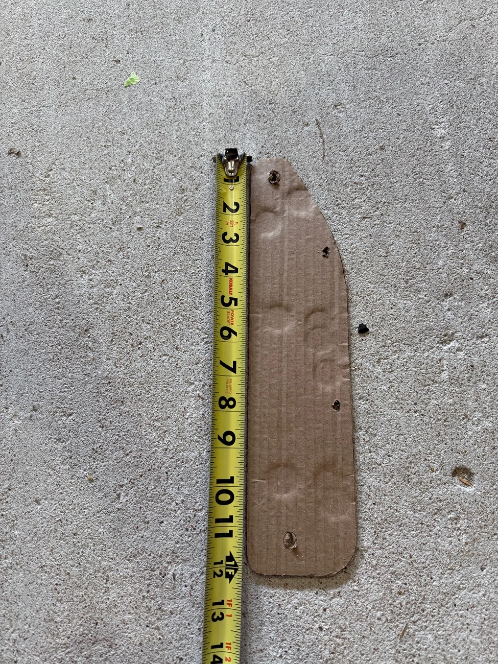

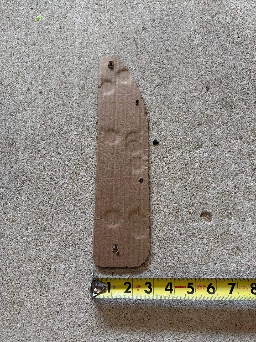

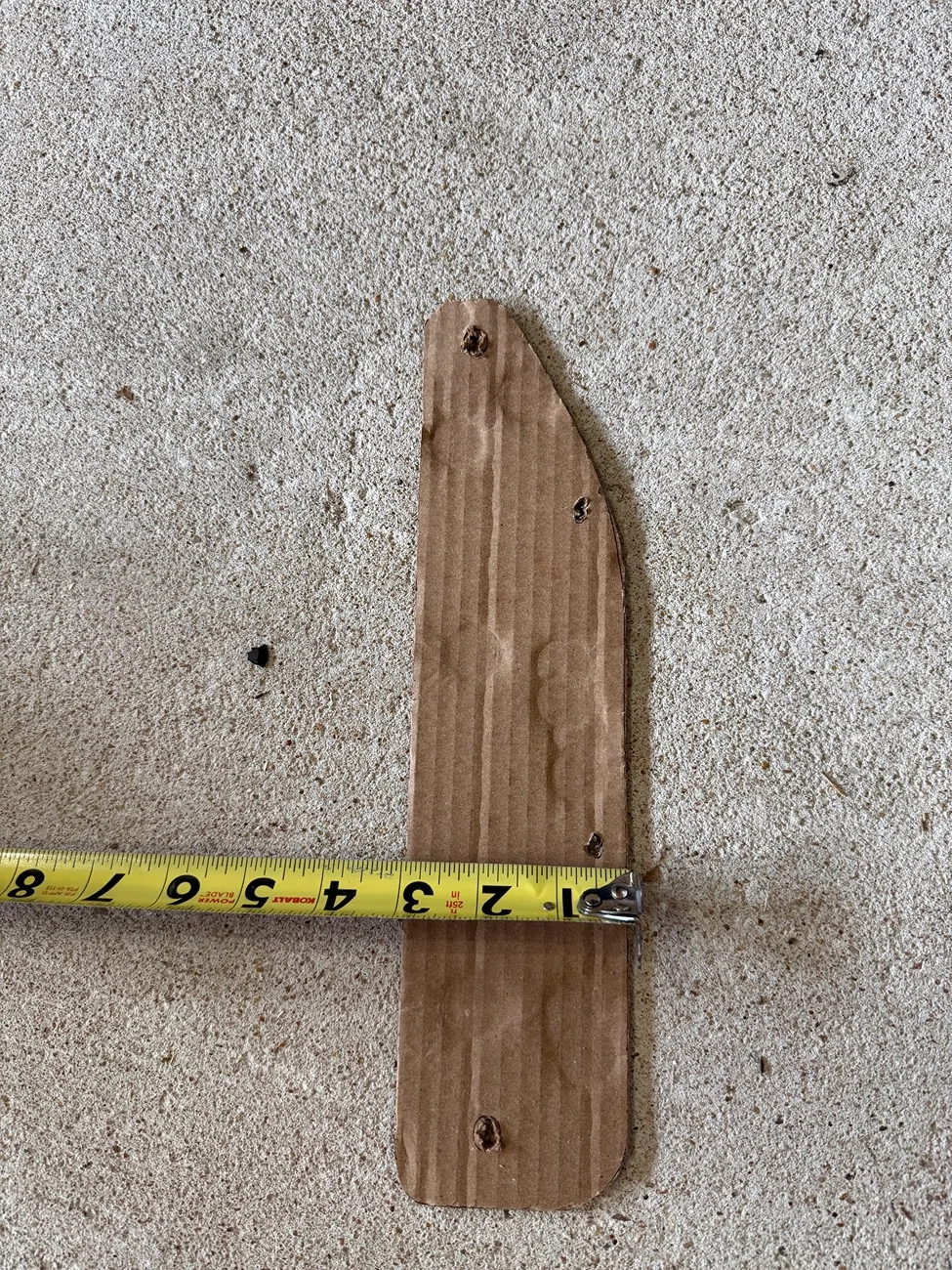

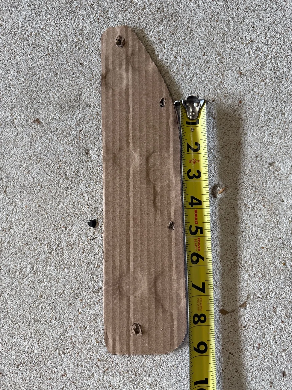

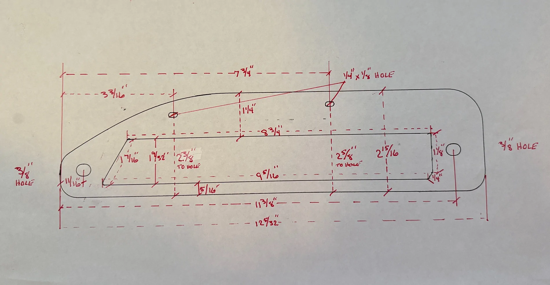

Here are some measurements, I’ll try to post a better template when I can.
For the clip holes, I just made them much larger as they didn’t quite line up at first, as you can see in the installed picture.

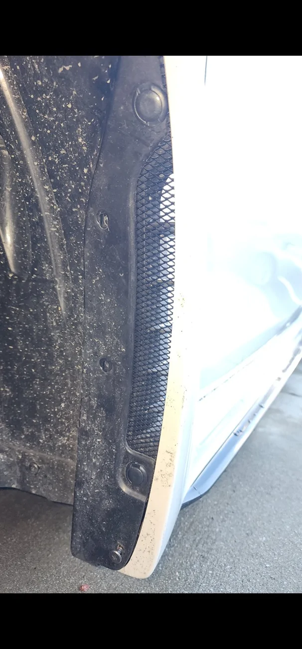

A simpler design. Just the top and bottom clips are enough to hold it in place. Don't bother saving the plastic clips. They will break no matter how careful you are, even on a brand new car. I just bought a box of different sized clips on Amazon.
