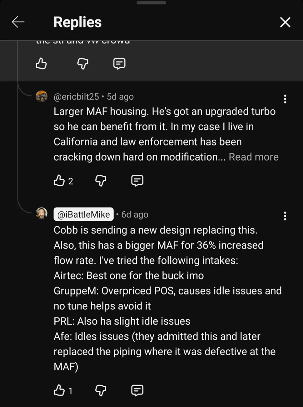

Supposed idle issues with aftermarket intake airbox?

I thought the same. I tried a new gasket and still had a off idle. Didn't make sense. It's not like PRL is super complicated either. It's a good intake. My car just didn't like it lol
Did you use the OEM Phillips MAF screws or the provided 3mm hex screws when you had the PRL HVI?

I used everything PRL provided
Ahh okay. I had the same idle issue using the OEM screws. Switched to shorter screws and the idle issue went away. I thought it might have been a small leak at the MAF since the longer screws were too long to screw in all the way
