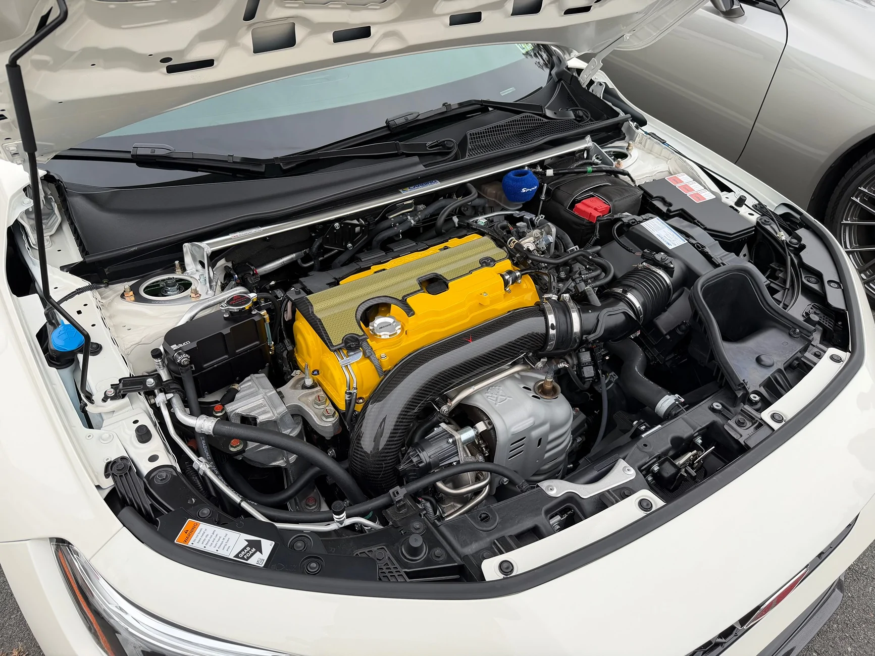

The Eventuri turbo inlet pipe also works with the stock air box. Here is a link with PICs. I decided to go with it because it is a one piece unit, has the largest internal ID, and allows for the use of other aftermarket intakes.
IMHO, the OEM inlet pipe is an aesthetically eye pleasing 5+ pound heat sink.
Infinity Design also sells a one piece turbo inlet and intake kit that looks good. Here is a link to that thread.

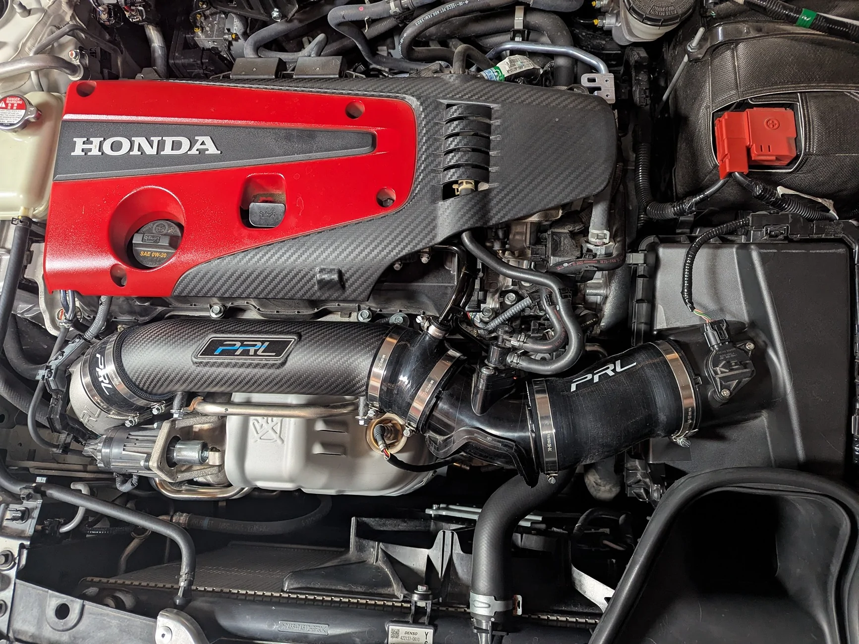

Commenting to confirm fitment with the PRL carbon inlet. This inlet was bought brand new from TSP and came with the hoses for the HVI. So the newer inlets that are only compatible with the HVI work with the OEM air box and accordion hose.

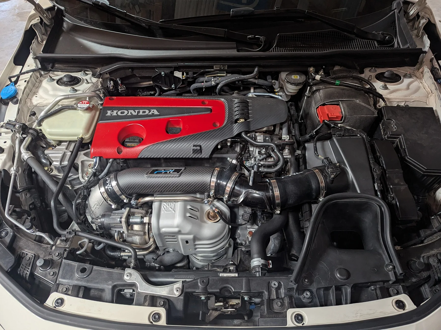

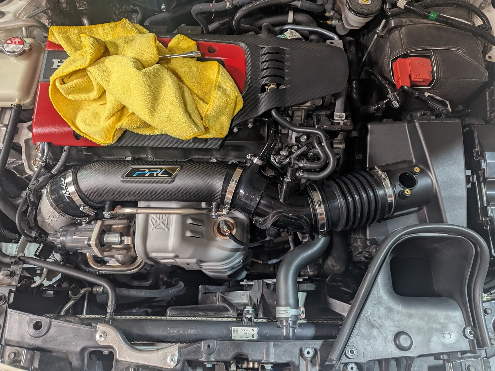

Adding that you can use the tube from the stage 1 intake as well. I prefer this setup as it looks cleaner and you don't have to "stretch" the accordion hose as much. It's a bit finicky to get all the hoses right, but fits nicely once you do. Not rubbing or gaps. The turbo noises are a bit louder compared to OEM, so that's a nice bonus!
