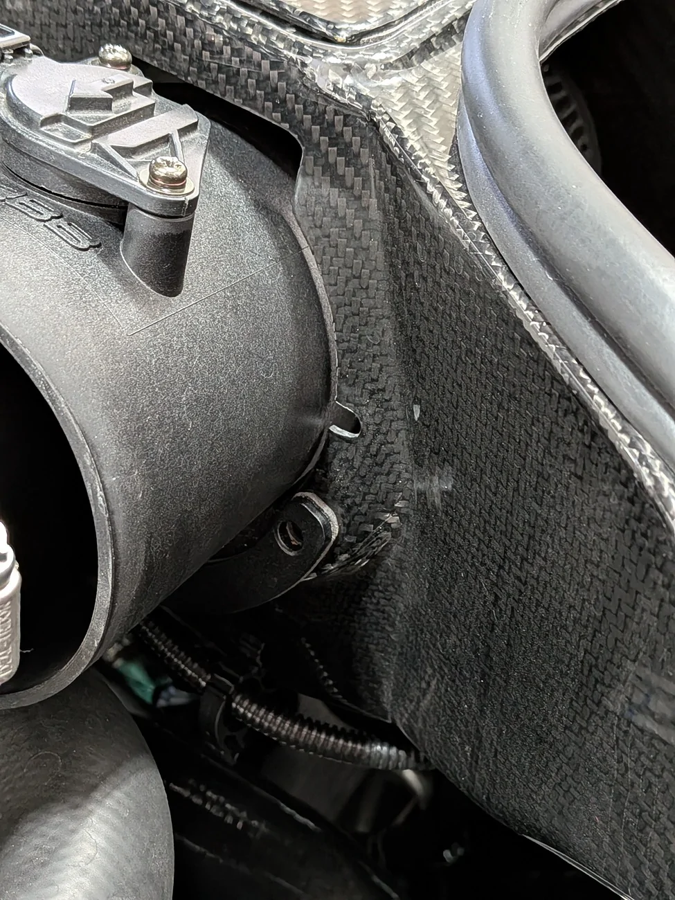

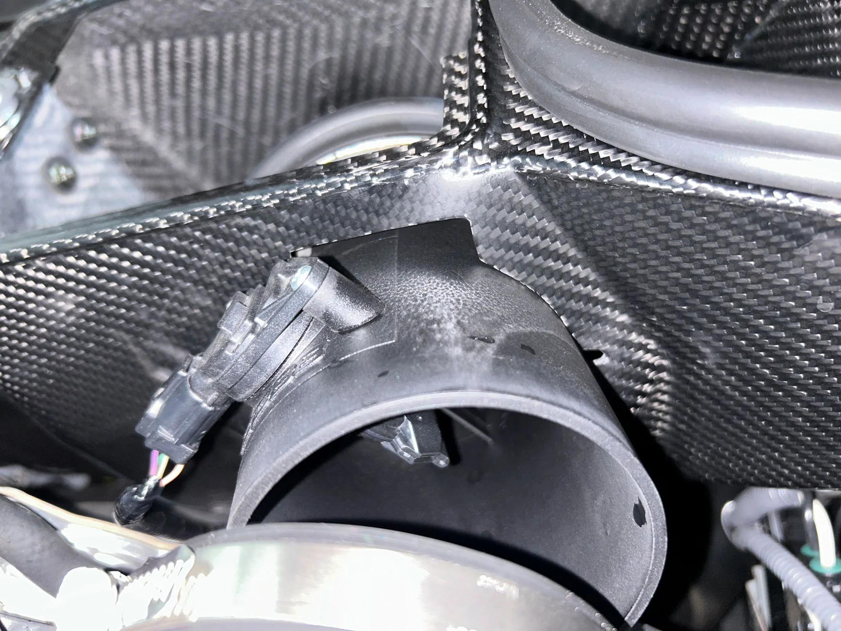

Well I was driving with my kid in the car and heard a popping sound in my engine bay and suddenly lost all power and the car started to stall out. Luckily I was half a mile away from home. The MAF housing came apart, bolts, and bracket got lost some where in the engine bay. It's very disappointing because it left some deep scuffs and scratches on the side of the intake during the process. Anyone that wants to run this intake or has this intake, please check the MAF bolts or put a drop of loctite. I contacted Cobb support and supposedly they were going to send me a new intake as I requested for one, then they said there is nothing wrong with the intake, then went ghost on me when I sent a follow up email. I was going to send them back this current intake because I didn't pay $1000 to have a nice carbon fiber intake scuffed up or scratched up due to an error on their end because my OCD won't accept such a thing. I was custom tuning with JST and getting ready to log V3 over the weekend, but that went to scrap. I put the stock intake back on and went back to the stock tune. Totally turned off by Cobb. Total waste of money. I hope everyone else has better experience with them and this is my honest opinion and review.

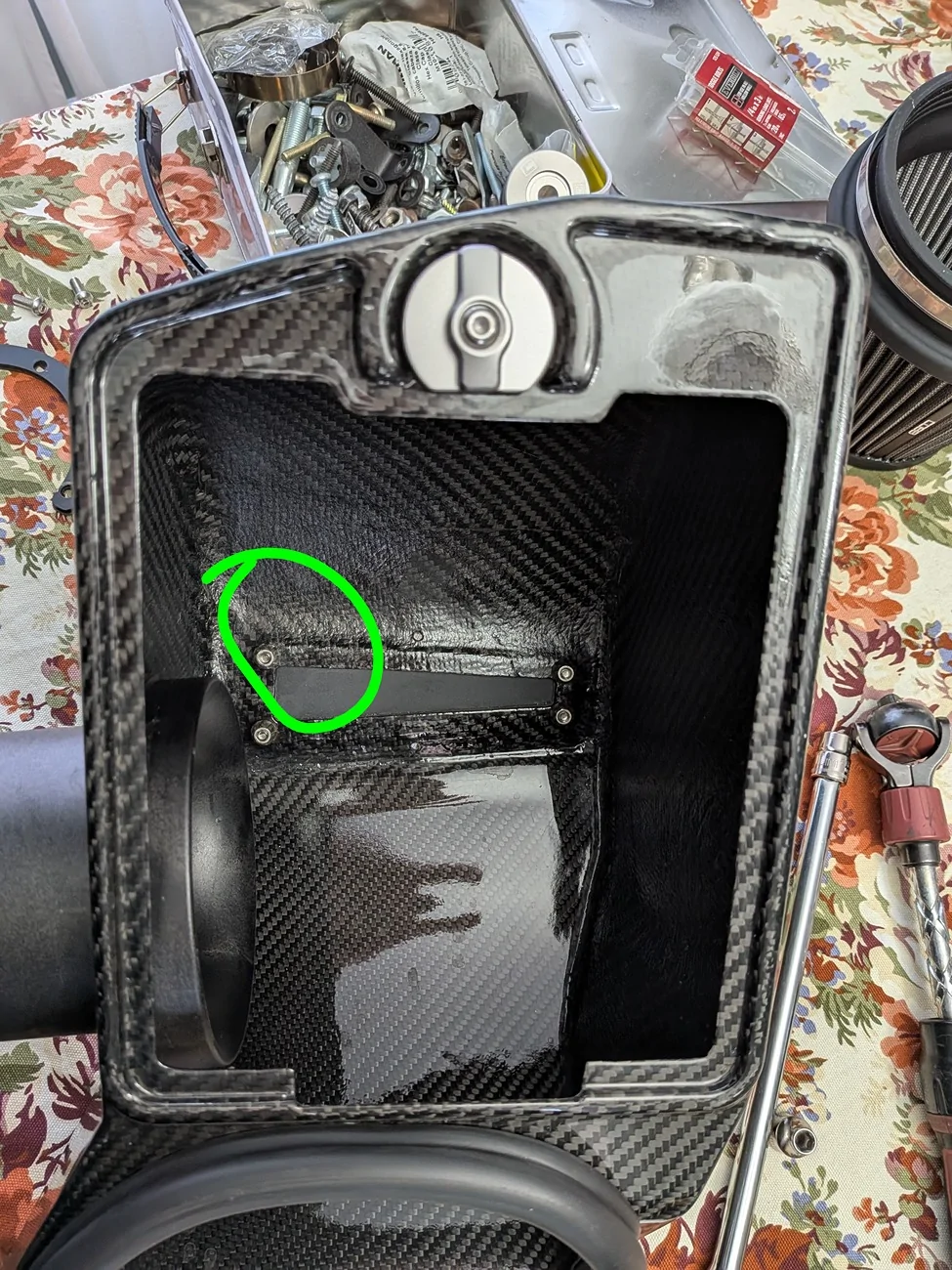

Man I can't remember if you said you bought already in another post. I'd say get your money back if you can. I'm so done buying expensive intake. Totally done. Same crap just happened to me. I also noticed one weird nut came loose inside that holds a metal plate below the box. They can't say it's me...as the part that came loose was bolted on from when I received it.

Dang that sucks man, I'm sorry to hear that you went through the same situation as me. I haven't checked the nuts inside the actual air-box, but I will later on today because now you got me curious. At least your bracket and seal stay in-tact. Mine got lost some where in the engine bay. I took the bottom belly cover off and I still couldn't find anything.

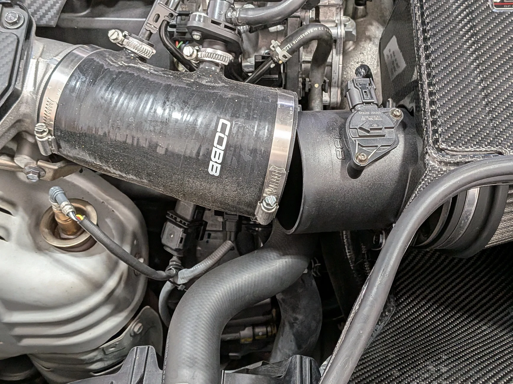

My tuner, who's installed them before said I need to push that pipe in further to the coupler. So I did, definitely more inside that coupler now.
I had to loosen the bolts holding the box, loosened the clamp on the coupler to the plastic pipe and shoved it in lol.
Definitely further on. I'm okay admitting user error, but dang...

Sorry to see this happen to another member. What exactly happened? Was it similar or different to @B16B ? And when you say a nut came loose, did it fall out or was it just visibly loose? And yes, I did buy this intake. Still sitting in the box, still in original packaging.
I wouldn't say that's user error. That still shouldn't cause the bolts to get loose and fall apart. I think they were hardly hand-tight installed by Cobb since it's carbon fiber and they came loose from vibration and overtime engine movement. It's probably be a good idea to put a drop of blue loctite on the bolts holding in the MAF housing.

Here's a vid, easier to explain that way lol.
Halfway through my vid you'll see how much the coupler was on that plastic part...I fixed that and tightened the crap out of the other bolts. Hope this stays good
