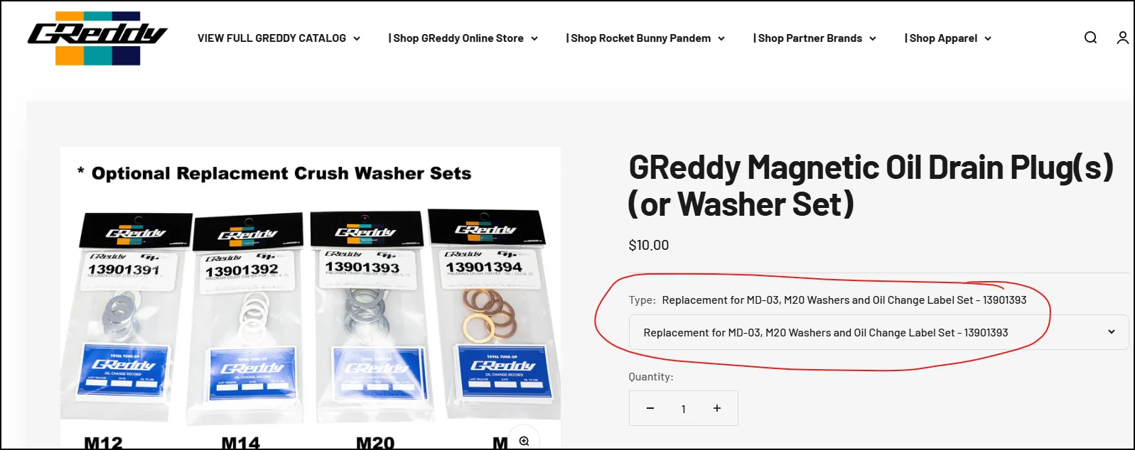

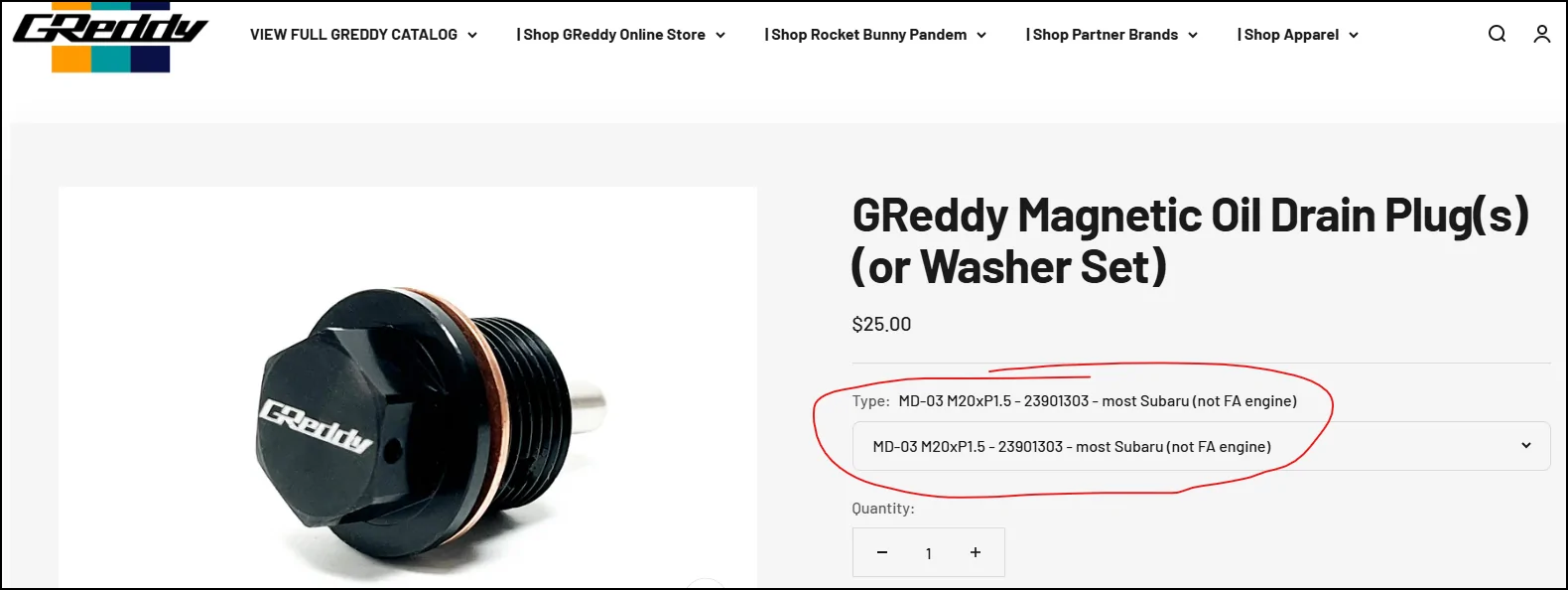

Thanks. These right?
11th Gen Honda Civic Transmission Magnetic Drain Bolt - What options? 1760111631465-qf
11th Gen Honda Civic Transmission Magnetic Drain Bolt - What options? 1760111641698-k
Also, do you know if OEM crush washers will still work or do we need these GReddy specific washers going forward?
AspecR
Stefan
Aug 23, 2022
2,380
3,764
Yup those are right, OEM will work I only bought the extra washers for the maintenance stickers lol
