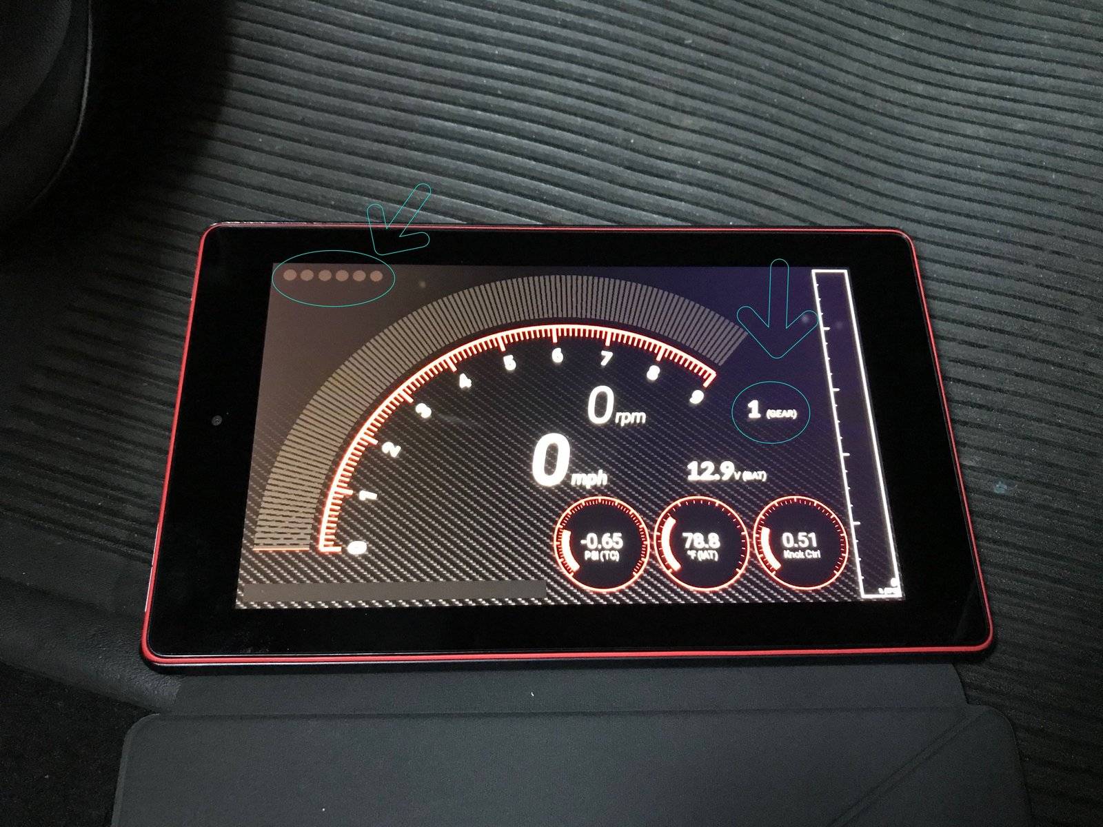

So it’s been a few weeks now using the TunerView X KTuner and it’s been great. I like using this layout on my CVT but notice that the top/left gauges do not light up. Although the gear does change going up to “5” and reverse shows “6” but nothing shows up at the top left. I know this is a CVT but are these little circles meant to light up as gears? If so, is there a setup/update needed for the change?
Any feedback is appreciated. Thanks!
Did you set up the shiftlight rpm in the setup menu? It’s at 8000 by default.
