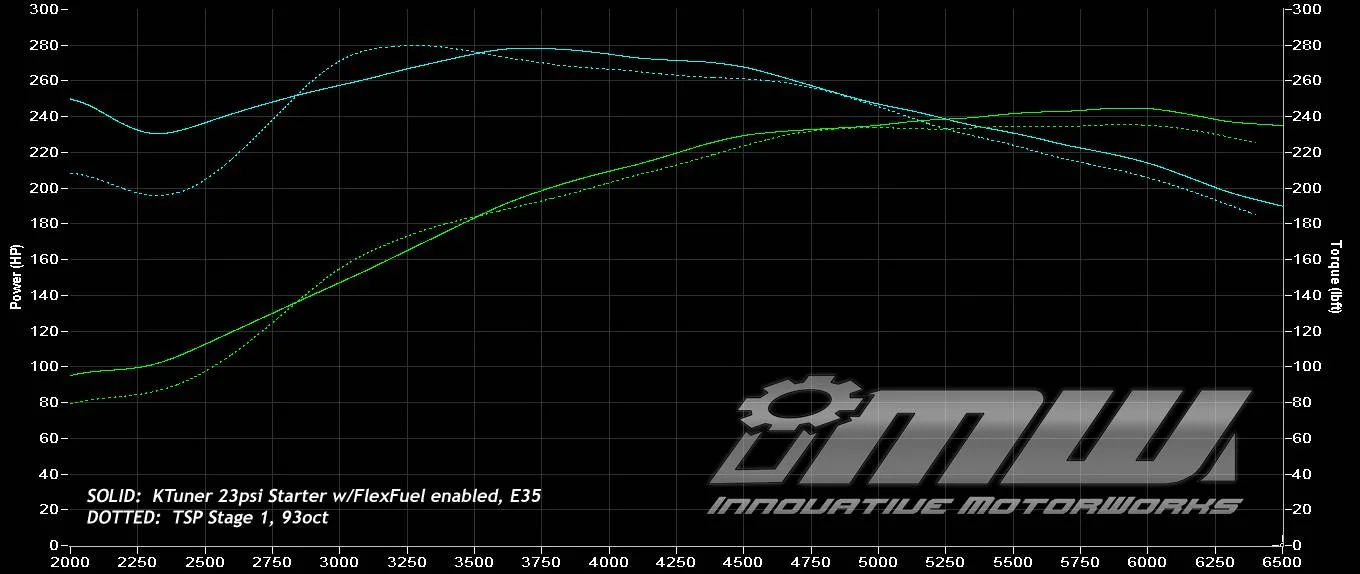

I messed with the 23# basemap a lot. I've thought of getting the kit TSP has that I thought came with the stage 2.. but then just going to the ethanol enable version of the 23# basemap, dialing down boost under 4000 RPM to flatten the torque spike then removing the 23 to 21# taper up top. Sad thing is, the TSP Stage 1 is so good, it's matching the 23# basemap+ethanol enable pretty well.
11th Gen Honda Civic Turbo Spool rate question TSP1vs23psiFlex
I bet between a couple pounds of boost and some more timing (ethanol enable maps give +5 max if youre running enough ethanol) you can wake the top end a bit more to set it apart from TSP Stage 1. I'd like a little more up top if it's there. I don't really want anymore midrange. Really... another turbo is inevitable if I keep the car long enough but that's still a ways off. It'd make power how and where I'd want.
