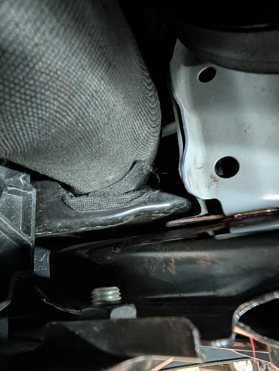

Mine is doing great so far. I did have to put something between the space that is under the air channel to prevent vibration noise. I installed a PRL motor mount and sometimes I'd hear that piece that channels air into the intercooler vibrating.
I didn't have time to do a better fix, so I took some rubber pieces I had and put them under that channel piece wagner comes with. It sits under that against the bottom part of the bumper (inside where you can't visibly see).
hard to explain lol, but it's working to stop the vibration.
But in case anyone hears something vibrating, may be that.
