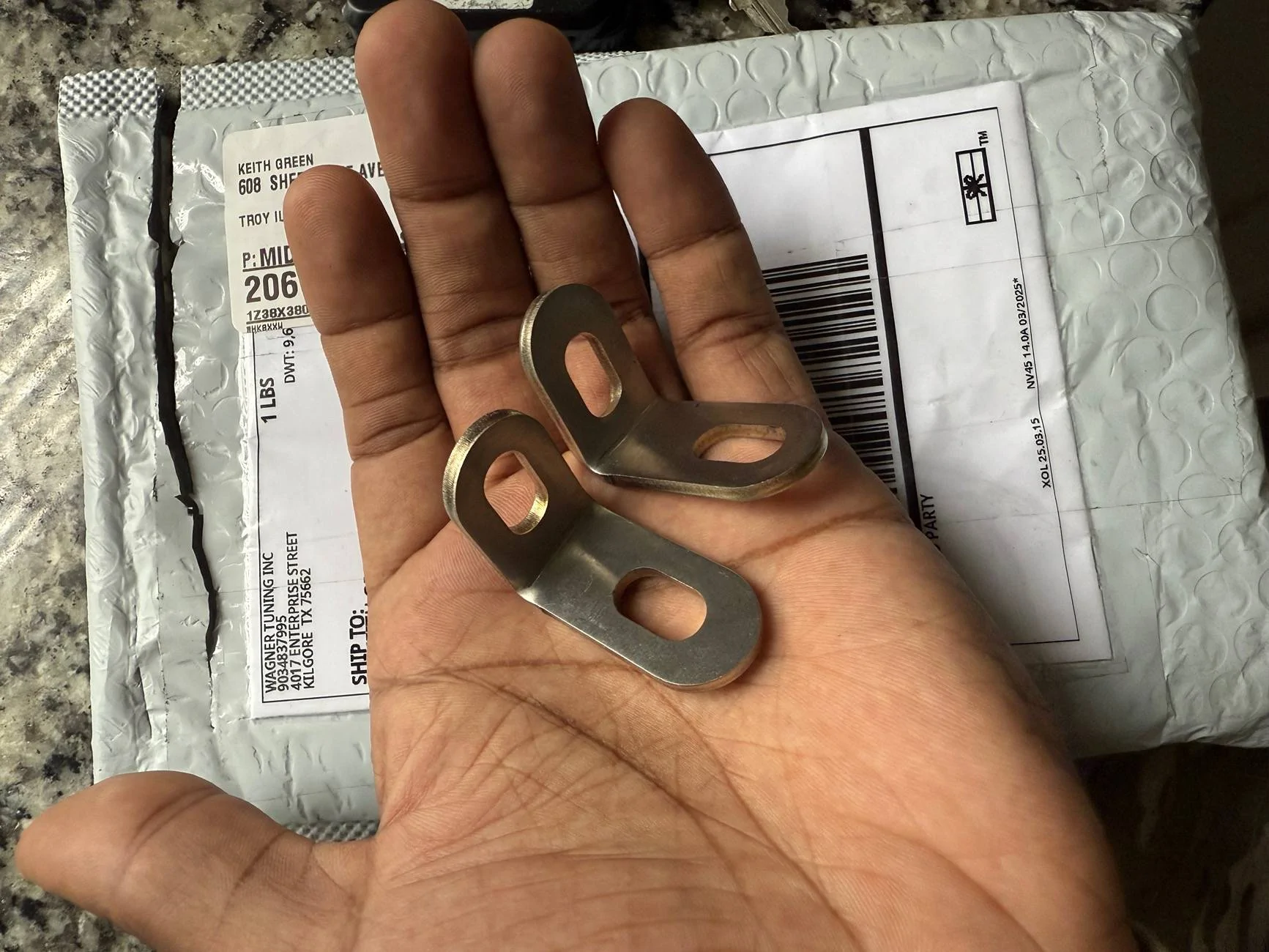

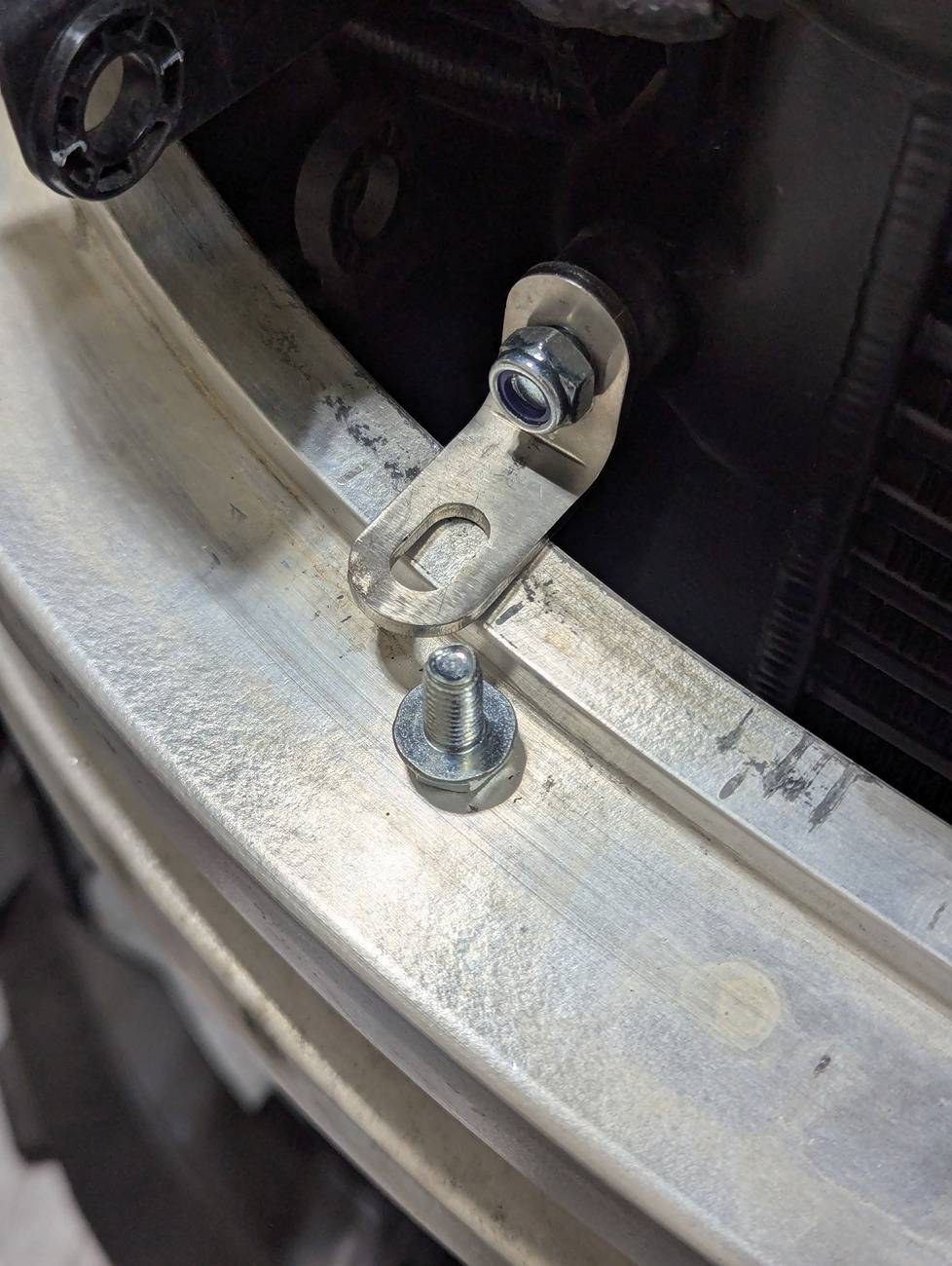

I read through this and so confused how these brackets bolt to the car...unless I'm supposed to drill with these supposed self tapping screws lol. My brackets are not like the picture of course

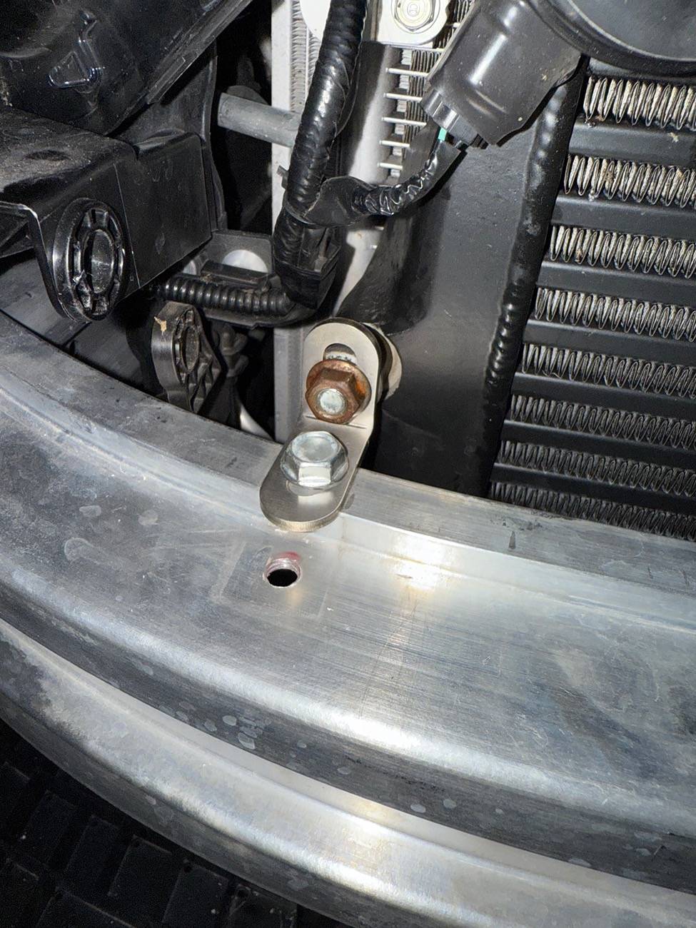

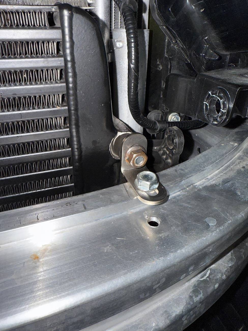

Those are the brackets I designed for the us market. They are different from what's pictured in the instructions. Just prop the intercooler away from the ac condenser so it doesn't rub. Mark where the bolt should be with a marker. Use a punch if you have one and drill about a 7mm hole with I believe a 9/16" drill bit. And the bolts should thread in by themselves. Just make sure to keep them perpendicular or 90*.

I used a rivet gun. Drilled into the cross member, added rivet and then screwed it in.
Probably can use something self tapping or drill through x-member and put a nut behind.

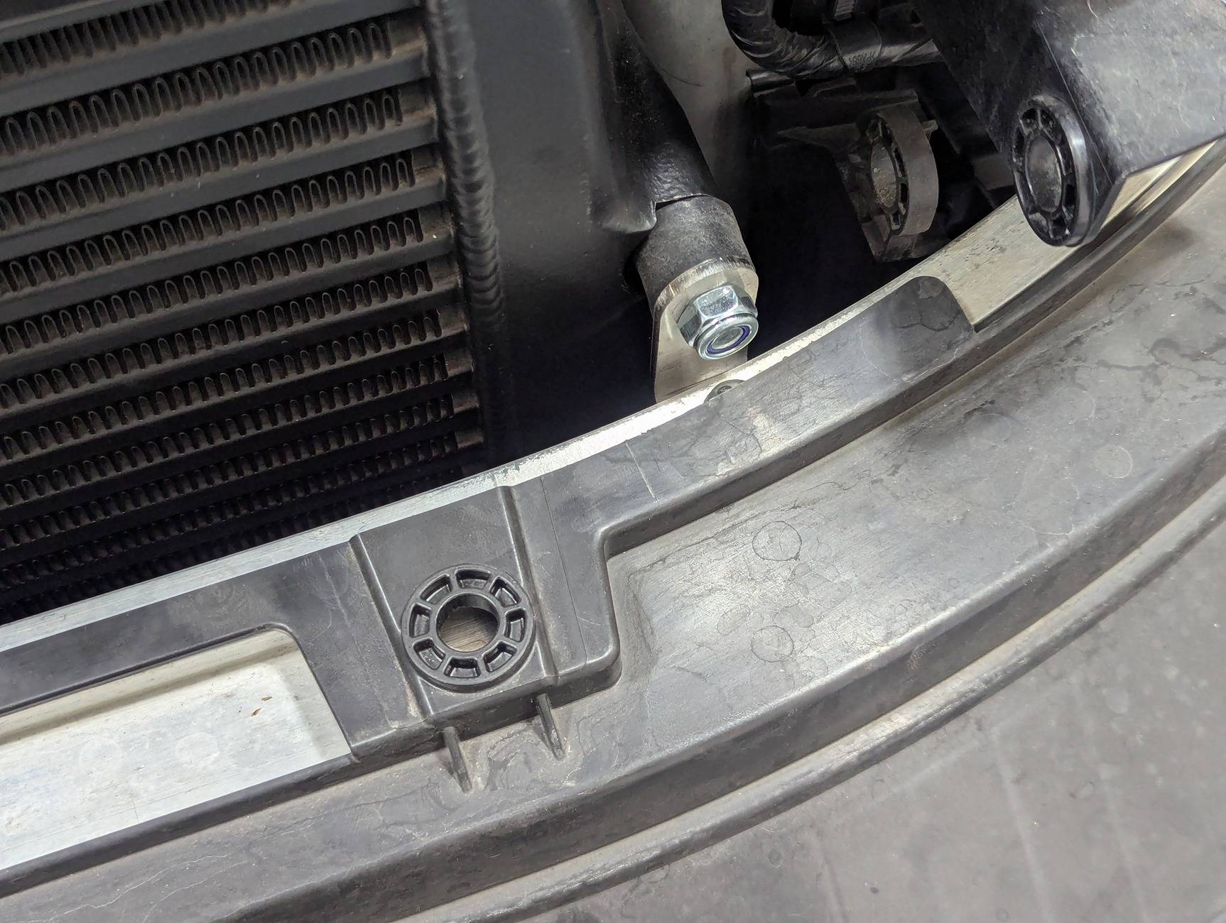

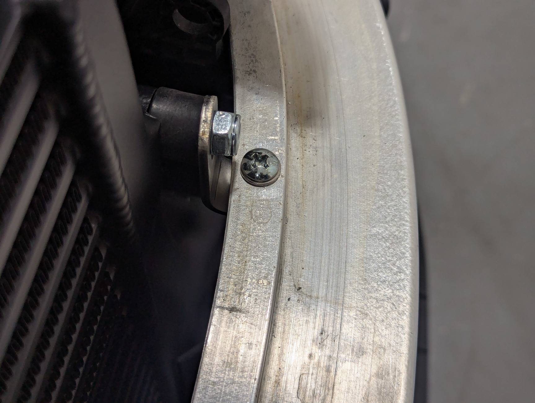

I ended up doing mine like this. I didn't like the bracket tab extending out into that plastic cover that goes on.
On another note...people tend to get worked up when they see people drill into an impact bar...saying it ruins the integrity of the bar...not sure what to think lol
