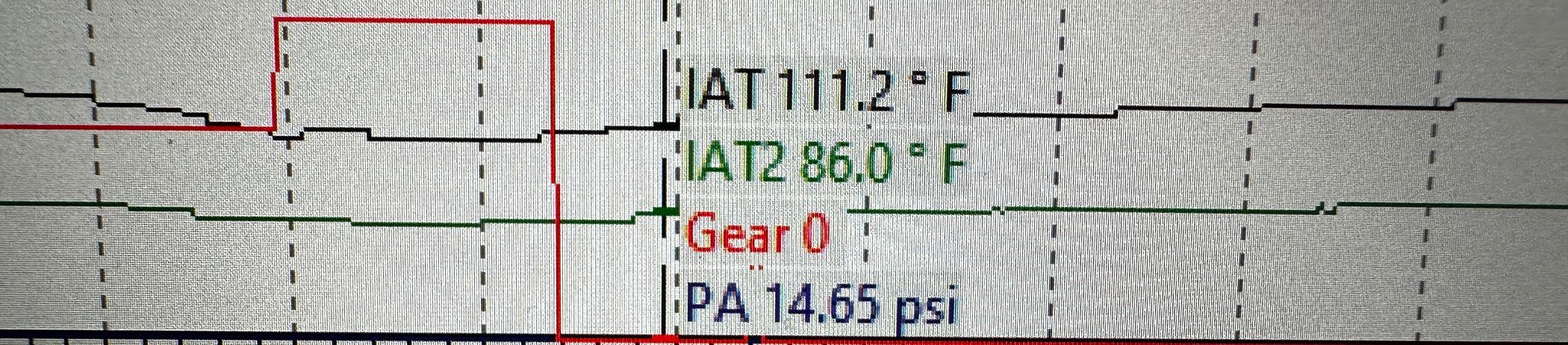

Ok here is some preliminary data, we will still need more testing to compare apples to apples.
Take results with a grain of salt since the two intercoolers are being compared at different states with different ambient temperatures. Ambients can be colder in one compared to the other but the IAT 1 might look similar since engine heat will warm up the air but the intercooler might be exposed to slightly different temps.
Also the speed at which the car is traveling will affect these numbers too. So like I said a grain of salt.
@MSUGeoman was kind enough to send me over some data. I tried my best to align the dsta points to the same IAT to the decimal point.
Wagner intercooler:
11th Gen Honda Civic Wagner Intercooler IMG_3778

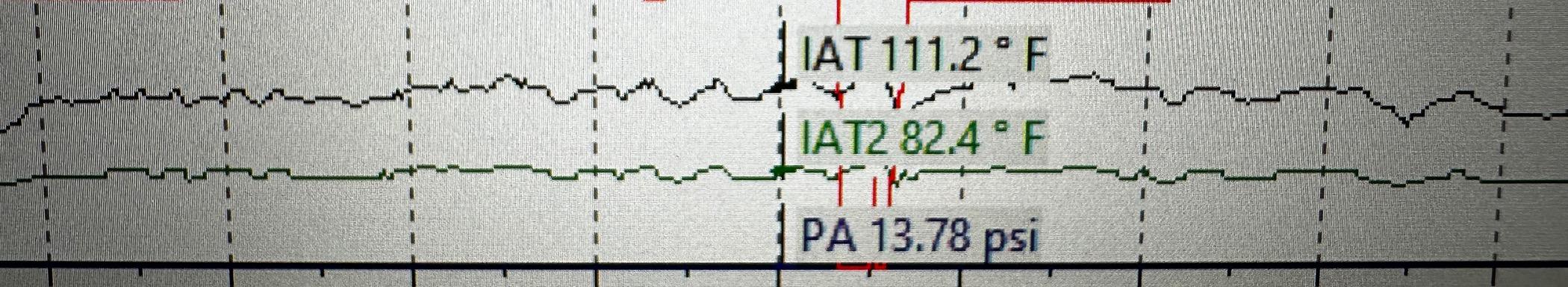

PRL Intercooler in Florida:
11th Gen Honda Civic Wagner Intercooler IMG_3779

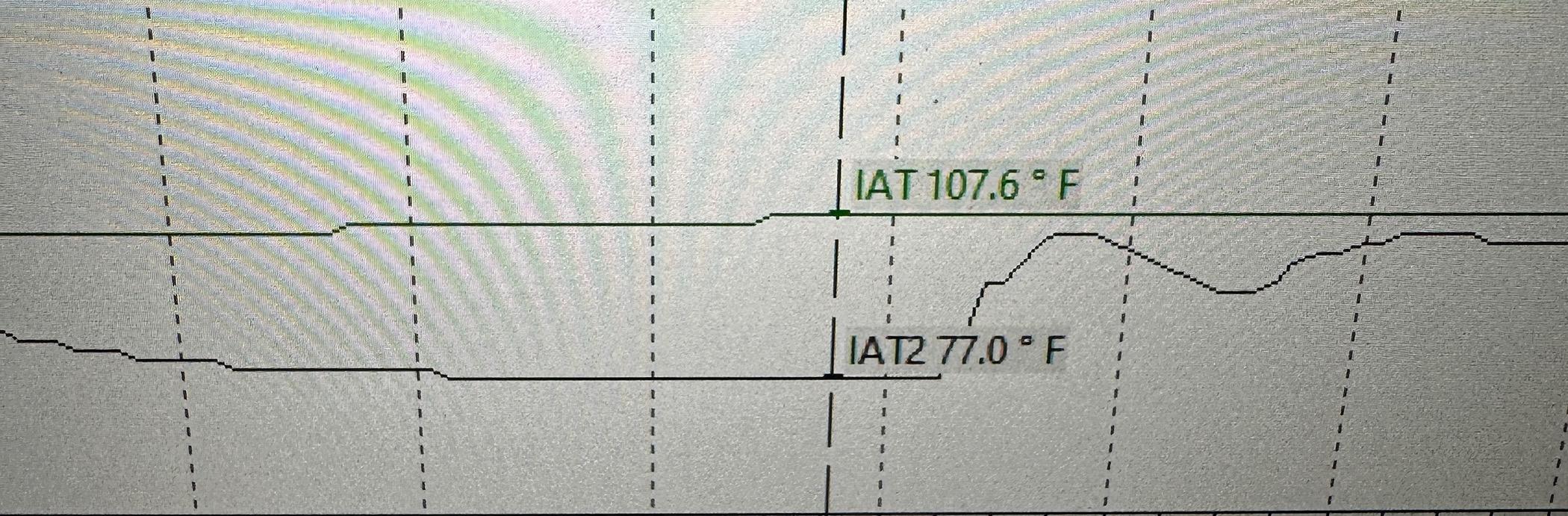

This one is just for painting a picture how volatile the speed can be on IAT 2 temps at the intercooler.
11th Gen Honda Civic Wagner Intercooler IMG_3780

Sure!
Testing initially indicates that both intercoolers perform similarly and are within 3-4 degrees of each other which to me it is not significant at this time.
Further testing is needed to get more data to be able to provide a clear picture plus a set of rules to get the most accurate data. Like going 60mph on both cars with similar ambient temps ideally tested in the same state.

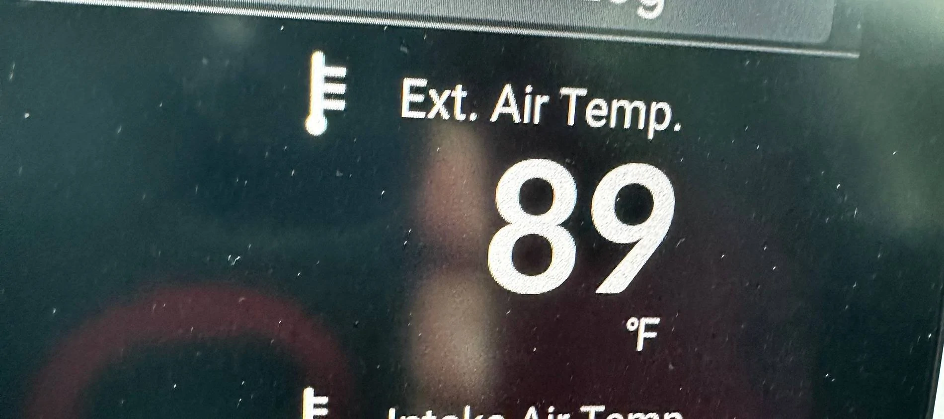

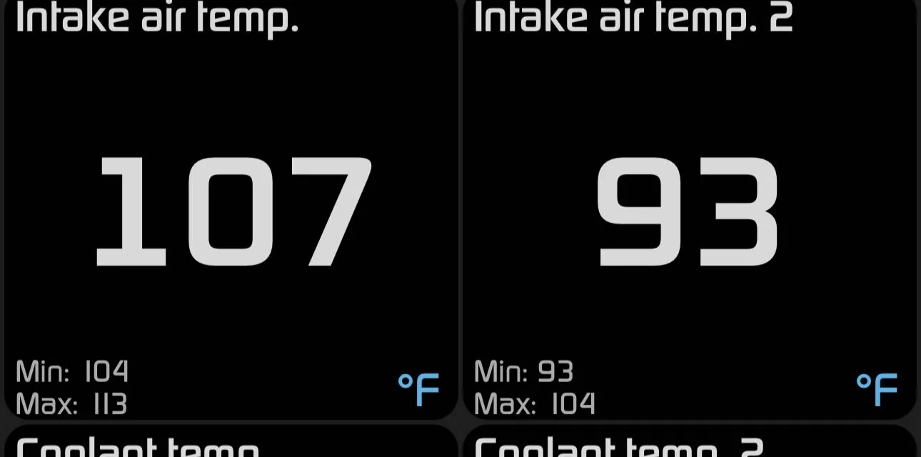

Waking this thread up, how were the hot summer months for you guys running this IC? Thank you @Jester04 for sharing early testing data!
My PRL intercooler is working good! If anybody with a Wagner wants to update data it would be helpful.
Ambient at 89F
IAT 2 MAF 93F
IAT 1 at intake manifold 107F
The intercooler cools more than what it is represented at the manifold. But the radiating heat from the engine really warms up the cold side pipe and the intake manifold.

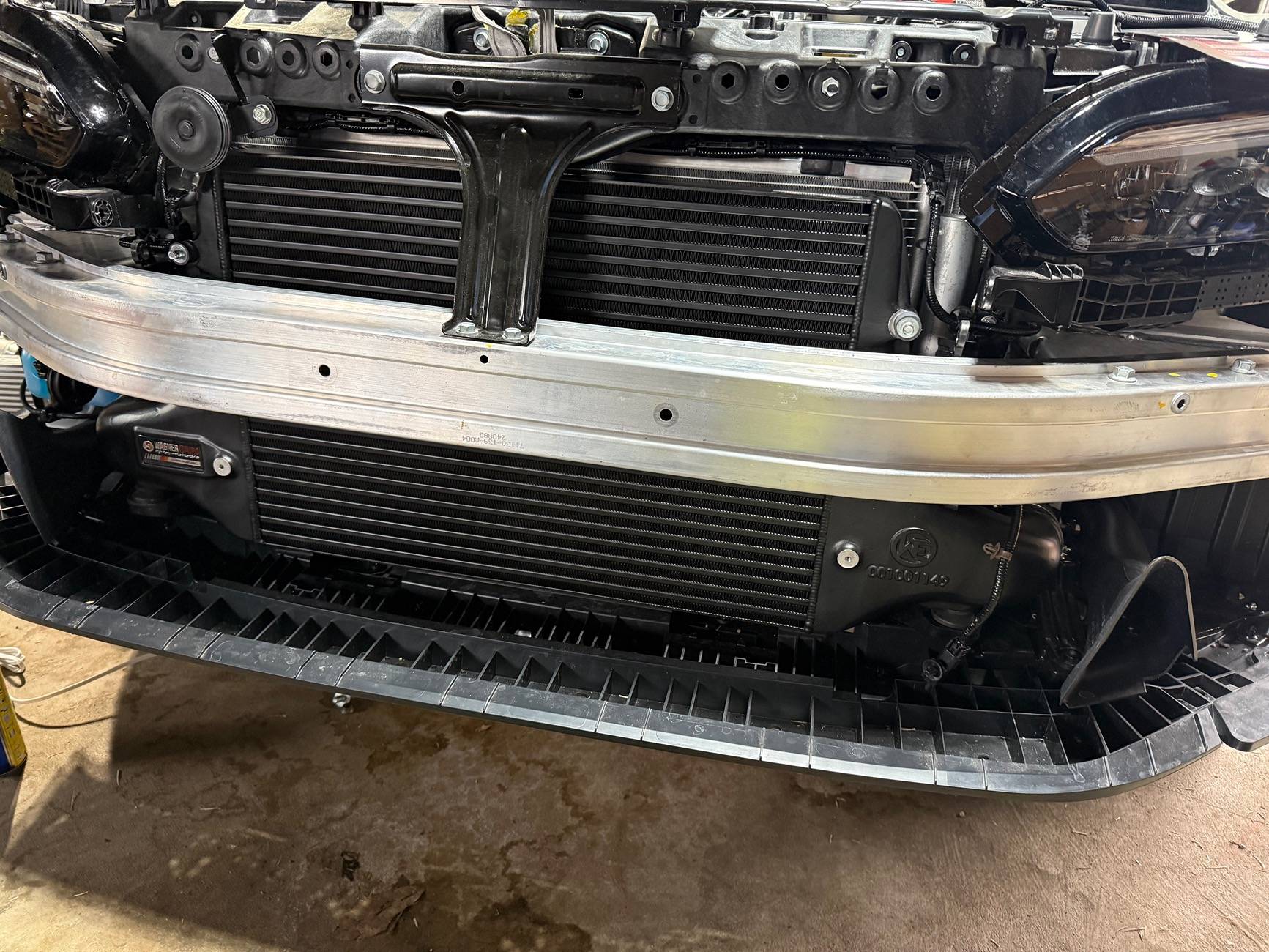

One thing I can say is if you want one wait on it bc they still haven't updated the brackets for the US crash bar. Unless you want to fab up your own brackets.
