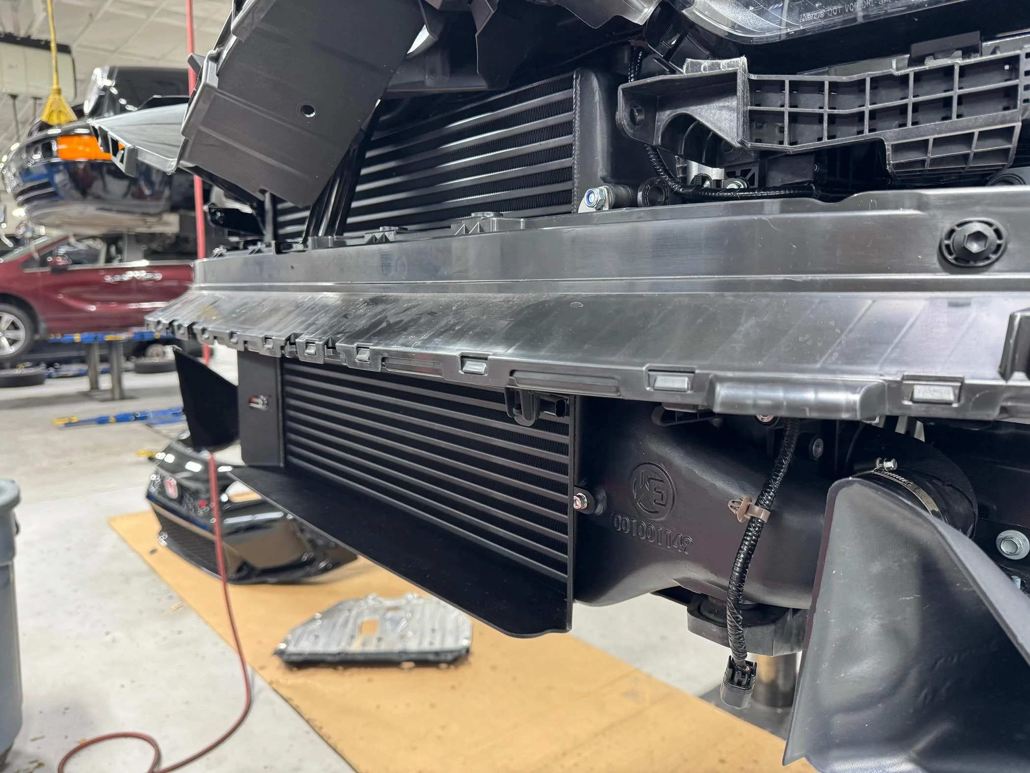

So the first kits were missing some brackets? Did they say when they would ship those out? Still don’t see how the provided brackets attach to the crash bar, can you take pics showing how they are both mounted on there?
Tickle
Jul 23, 2022
1,586
1,803
They isolate the intercooler between the condenser and crash bar. They make sure it stay stable and doesn’t wiggle. You’ll see the L bracket and rubber isolator right above the crash in thics below

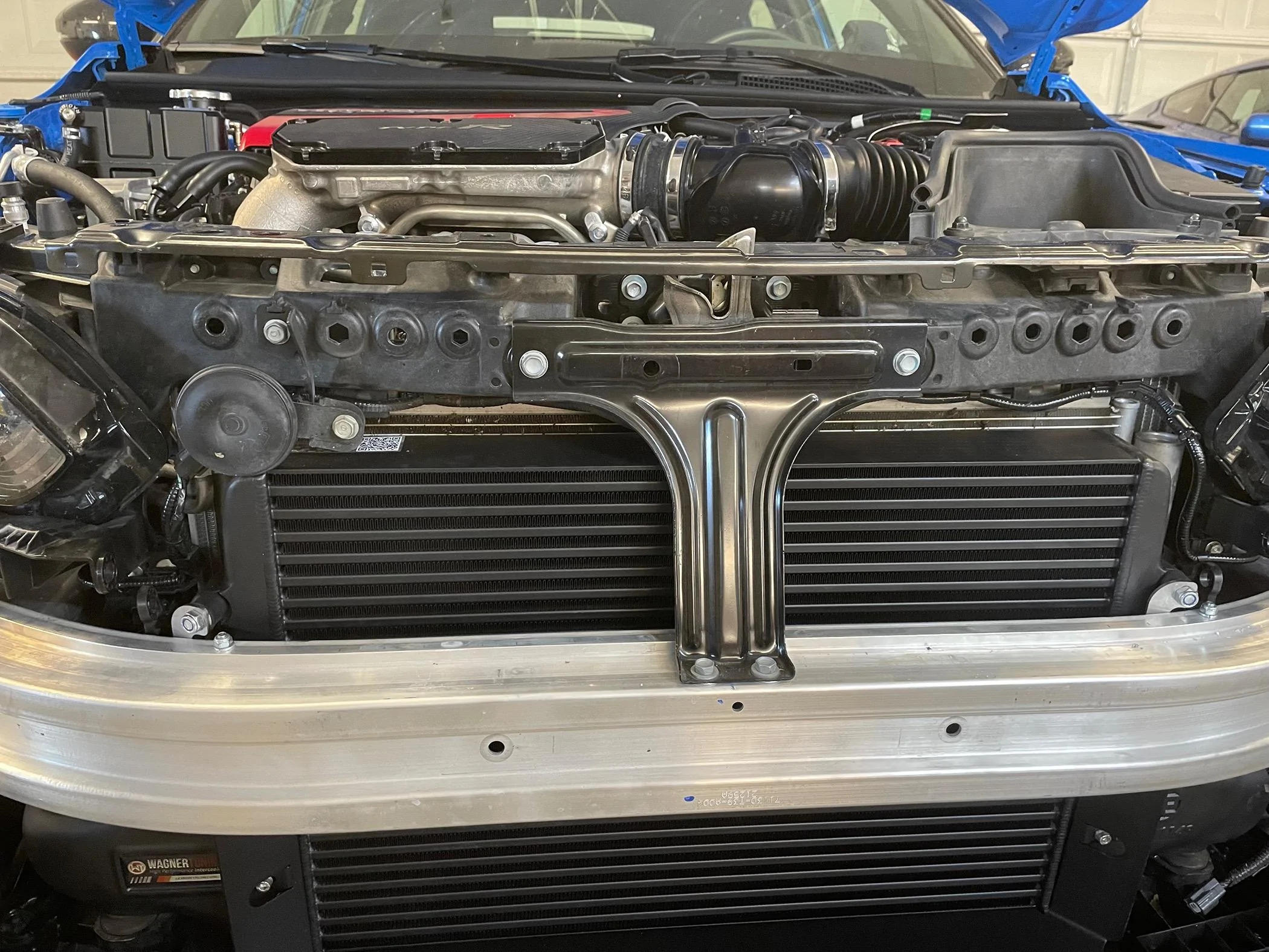

So I figured I would try the install as well. Debating drilling holes into the crash bar and fastening it there

11th Gen Honda Civic Wagner Intercooler IMG_5262
Got creative with an old handle from a light. Feels sturdy, will be fine until actual brackets get sent

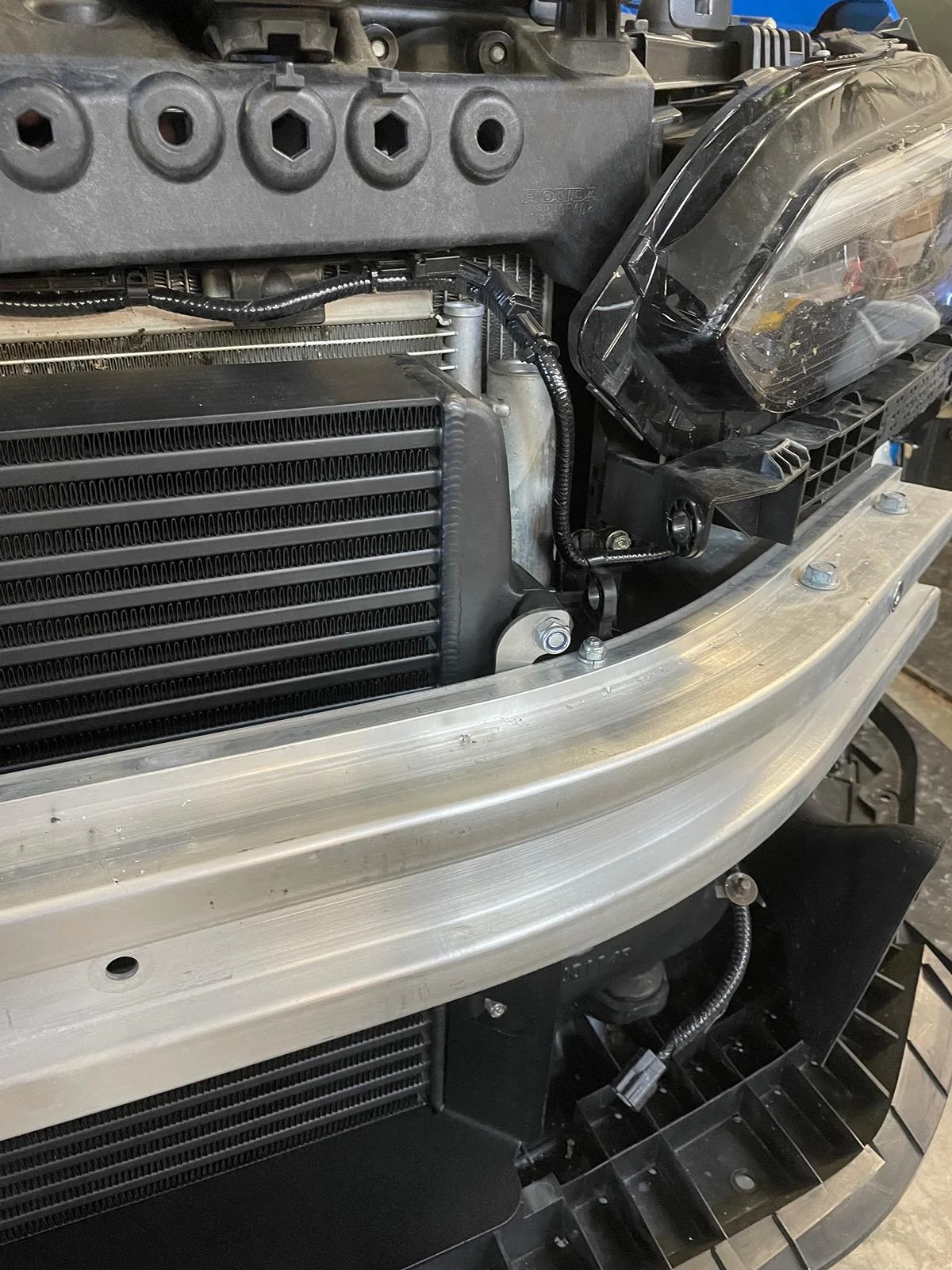

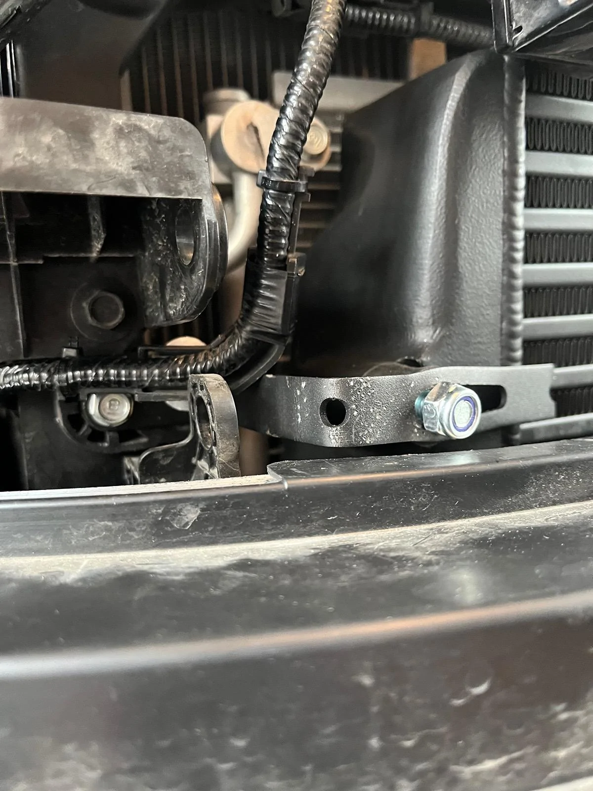

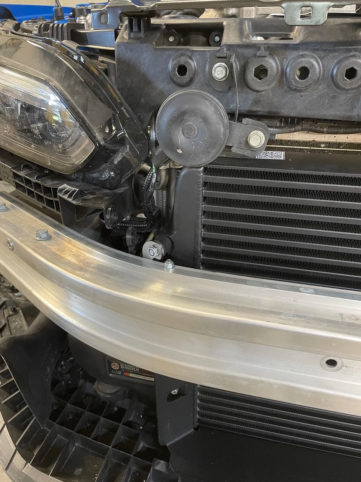

This is how I ended up doing mine. Mounted the isolators and brackets on the intercooler with the lip tucked under the rim of the crash bar, marked a dot for each bracket location, drilled two holes through the crash bar lip, and secured the brackets with two stainless bolts with lock washers and nuts. Somewhat of a pain in the ass to get the bolts in the bottom of the holes but I used a short magnet on a stick to guide the bolts up from underneath and then dropped the lock washer on and threaded the locking nut. Overall pretty clean install and it’s very secure now. Sure wish this was a bit clearer with some instructions, the rest is pretty straightforward. I’ll run my Hondata and collect some logs on my drives for the rest of the week and send them over for comparison.

I highly recommend you(and anyone/everyone else) upgrade your horns while you’ve got access to them, you‘ll be happy you did!
