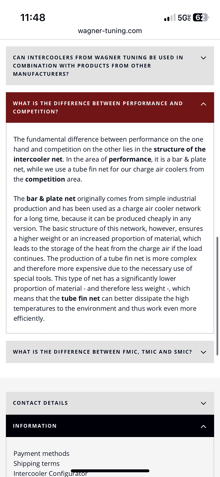

I was told it was tube / fin. (Pics appear to show otherwise.)
Can anyone confirm?
Can anyone confirm?

2023 Civic Type R #2486
