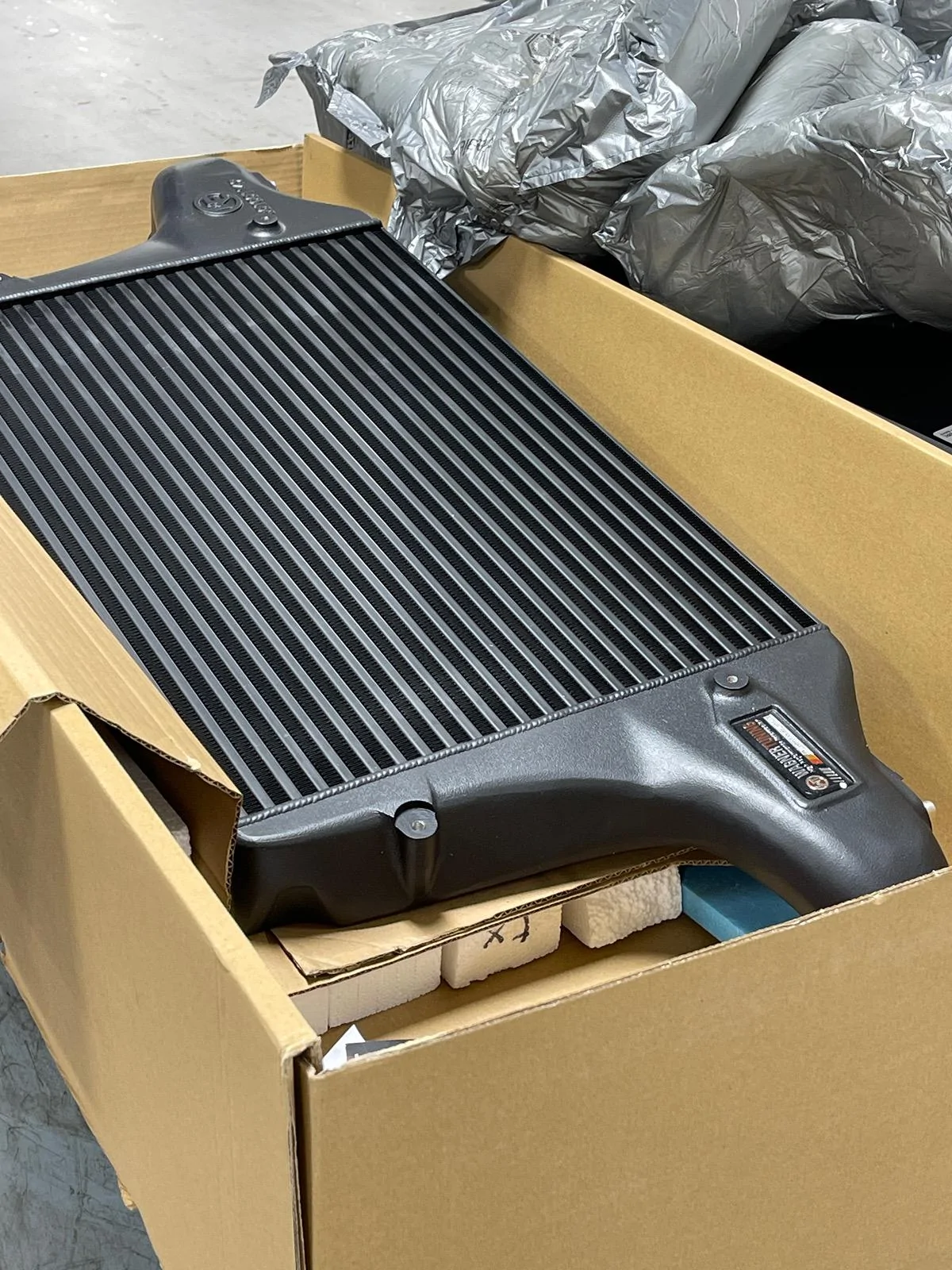

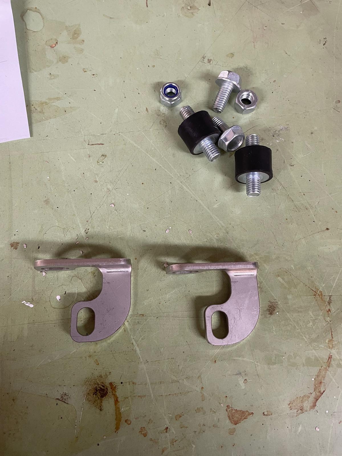

What brackets though? I figured it would be a simple swap. Could you take a pic? I’ll be attempting this Tuesday so just wanna know what to expect
There’s two identical brackets, two bolts, two nuts, and two isolators that would appear to go to the top of the intercooler where the two threaded holes are at but I cannot for the life of me figure out how they go in there and attach to anything.

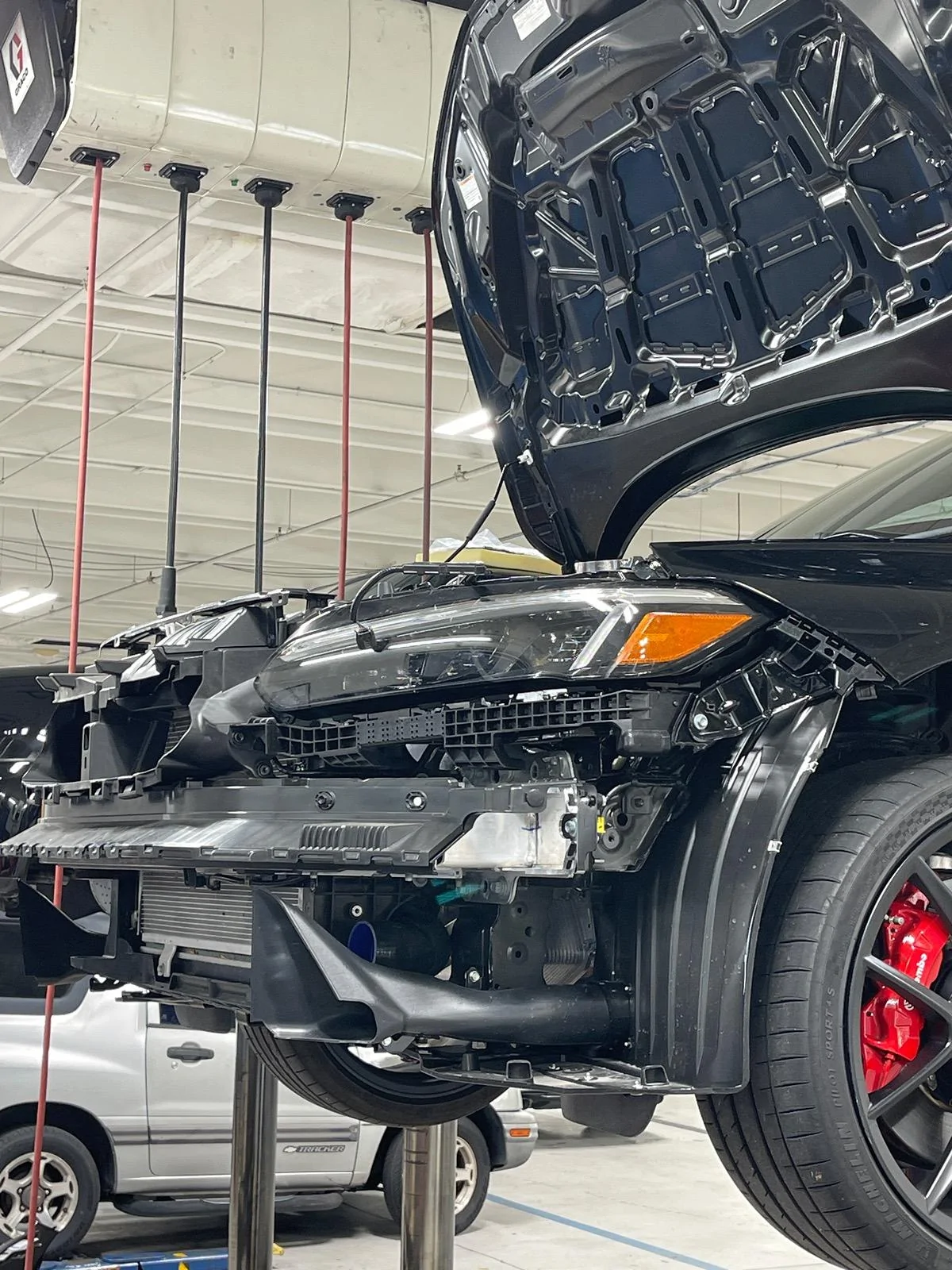

I have 2 of my guys working on a car right now. I think they’ve got the brackets figured out.

How is the charge pipe installation? Will it require intake and battery removal?
I ended up removing the entire intake box to access the cold side piping. I also removed the crash bar since I don’t have a lift to allow sliding the Wagner up from underneath. That would also require moving the under tray which I did not want to do so off came the crash bar.
This is the way my guys did it, remove the intake box and crash bar. The intercooler doesn’t wanna go up all the way otherwise.
So my guys have hit the same impasse as everyone else, they believe it’s short on hardware. The little brackets and rubber isolators, need additional hardware to connect to the crash bar, so the heat exchanger doesn’t wiggle in place.
