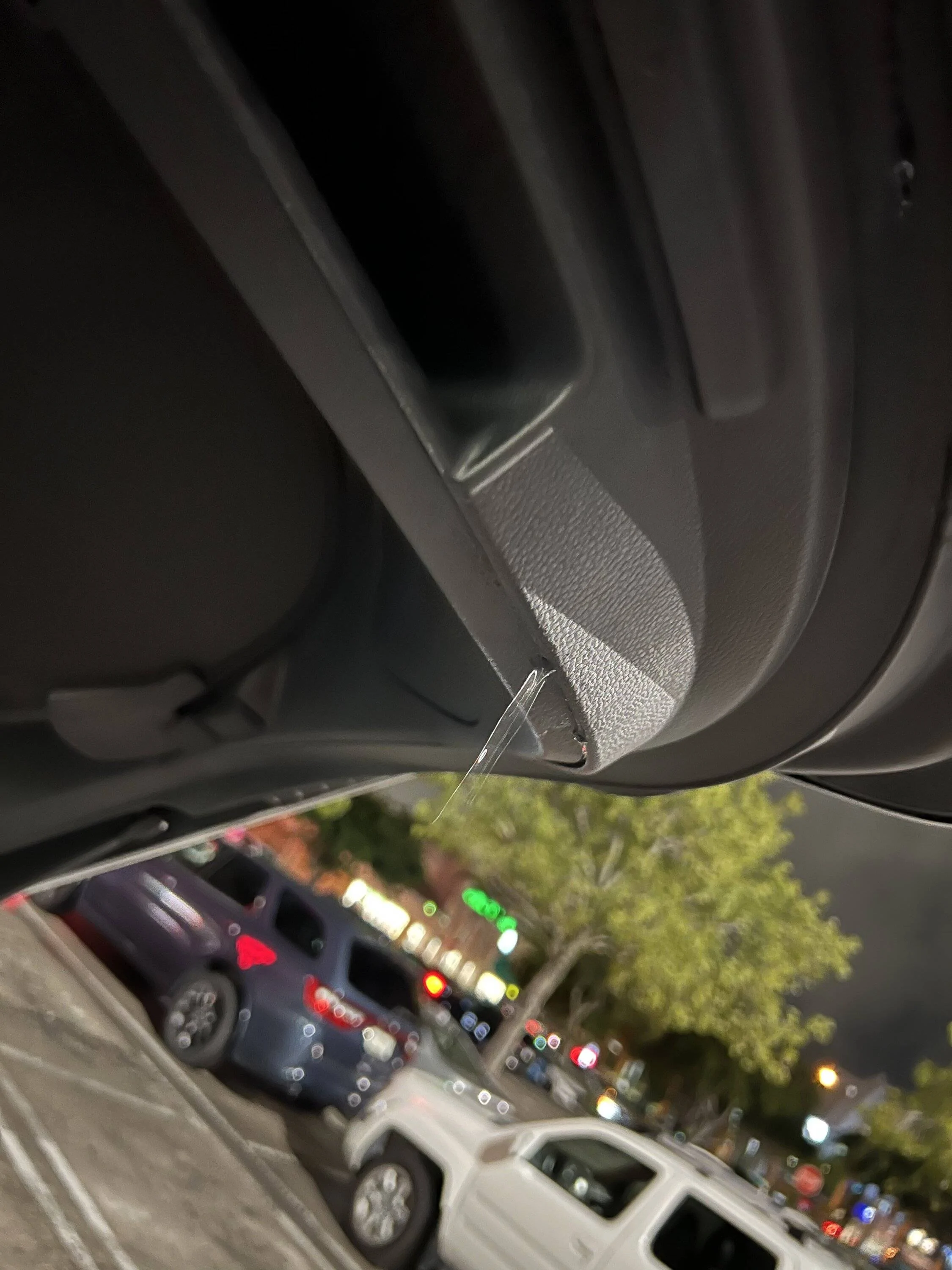

I just bought a brand new '24 HB a week ago. It was just delivered that to the dealer that day so a brand new build. I thought it was leaking yesterday from the hatch because the window tint guys maybe washed it, but nope. They didn't wash it. It was simply from the heavy dew both yesterday and today. The hatch lid has a bunch of water inside it that drips out of the little seam onto your head when you open it. Doesn't seem like Honda has fixed this yet.

I drilled 4 tiny holes where the dimples are in the plastic using a #40 drill bit. You can barely tell the holes are there, but at least now it properly drains any water onto the bumper. I figured I'd go this route instead of having the dealer much about not knowing how to fix it. I also wanted to drill them myself to make sure I did it cleanly. Works great.
