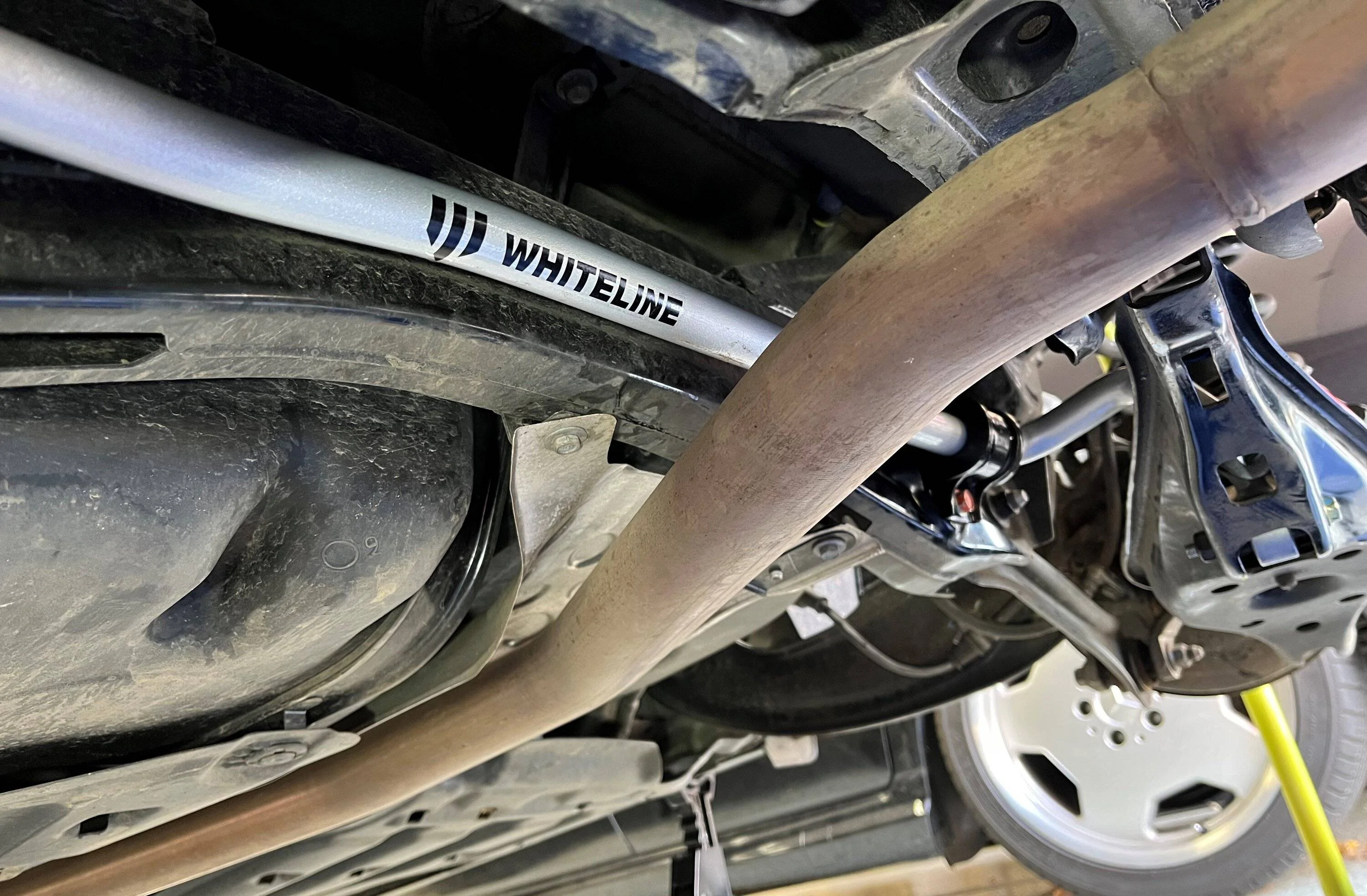

Whiteline 22mm rear sway bar and FK8 CTR front springs installed.

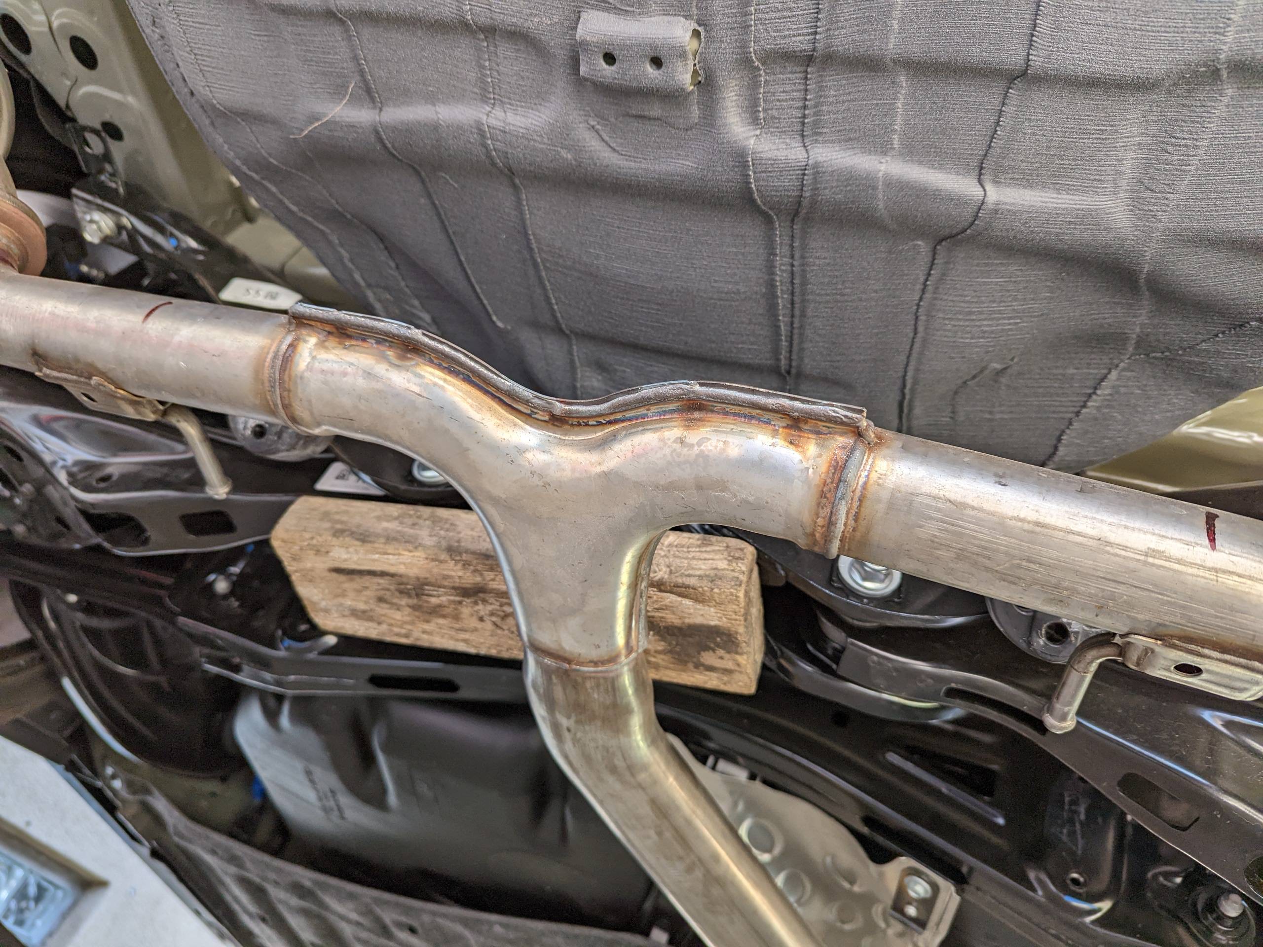

Can you install the swaybar with out lowering the exhaust?

Thanks for the write up. Got mine installed this weekend. Easy job, maybe two or three hours tops. I was able to get away with just undoing the two exhaust hangers nearest the sway bar.
Which hanger are you taking about? doesnt seems to appear in picture here

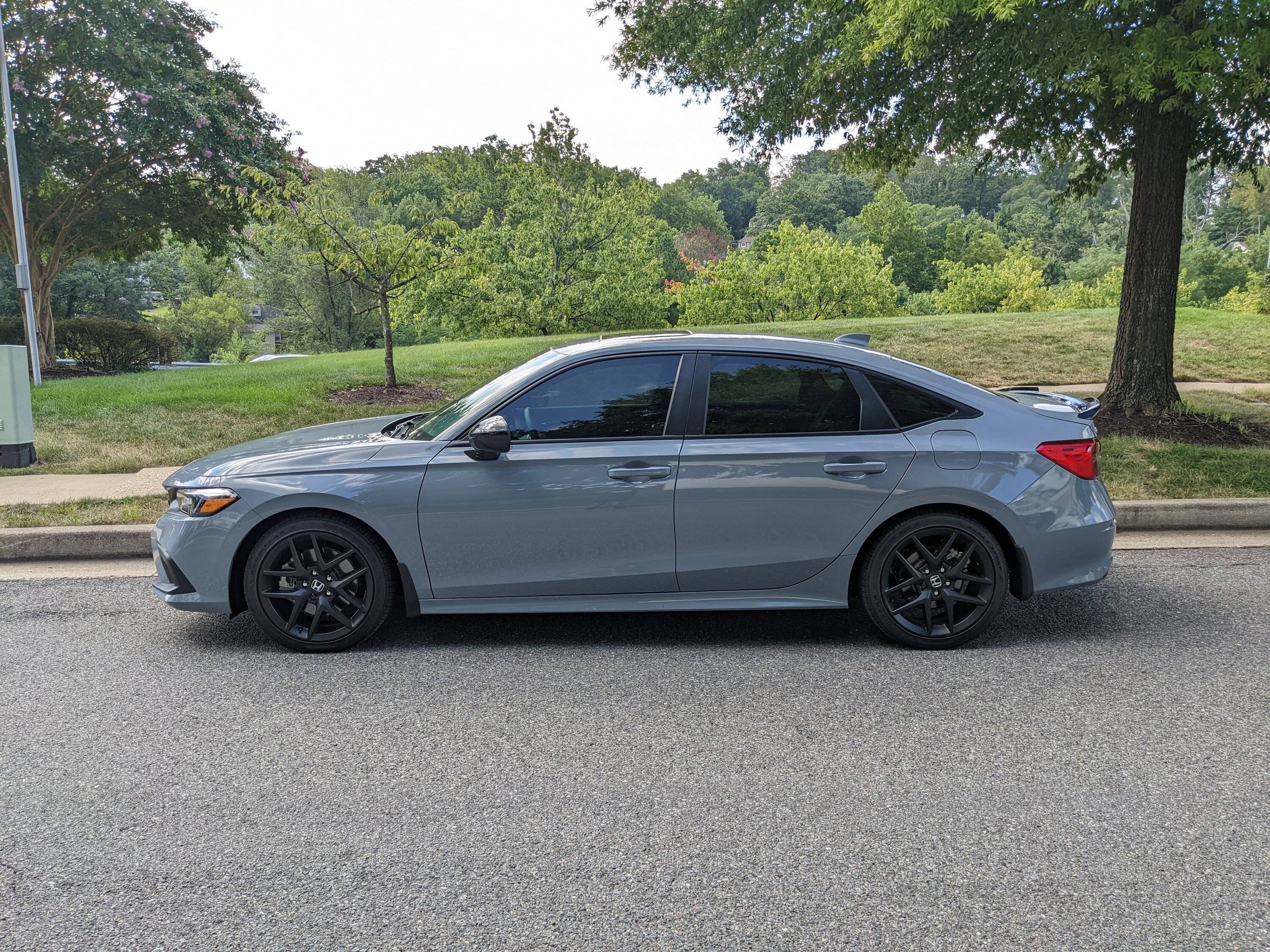

Going to end up doing FK8 front springs. I have the 11th gen si specific swift springs but the drop seems like it’s more than 1”. I’m getting too old to be driving sideways to avoid scraping my front bumper :( the roads here suck.
