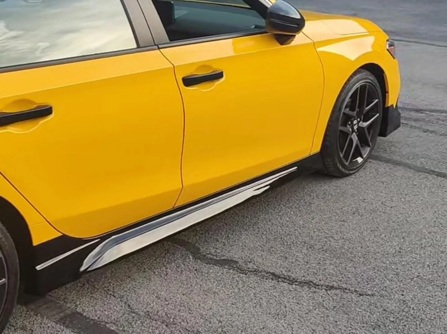

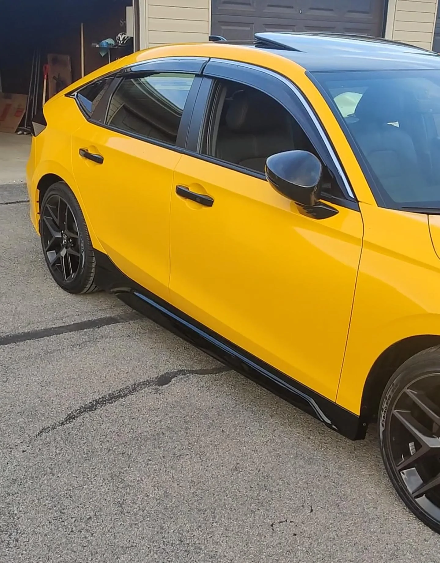

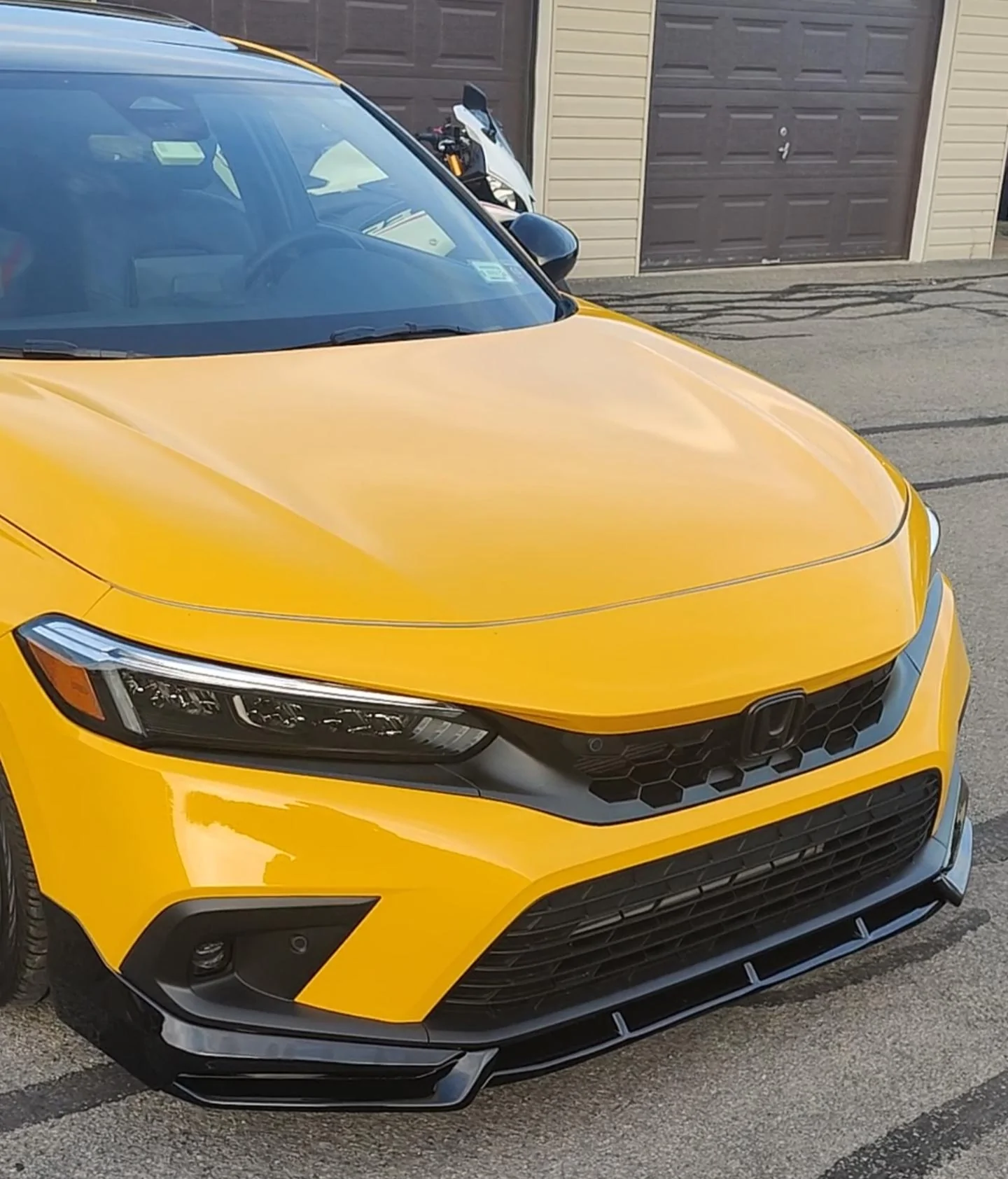

Yofer front lip and side skirts for Lulu! What do you think? Insta: @proto_lulu

did you have to drill holes in the car?
Yep. The front lip definitely needs several underneath.
The side skirts have 4 hole points:
1x rear
1 front
2x underneath.
I used the existing hole drilled by Honda for the front. Drilled the bottom 2 and skipped the rears (as it would bend the skirt).
You may be able to get away with not drilling, if you simply plan on having a showroom car. The 3M tape holds really well. But if you're driving it I recommend drilling it down.

okay thanks i just saw this, been wanting to throw the yofer body kit on my 23 si but wanted to avoid drilling holes if possible because of us leasing the car right now even though i do intend on buying it out at the end of the lease.
