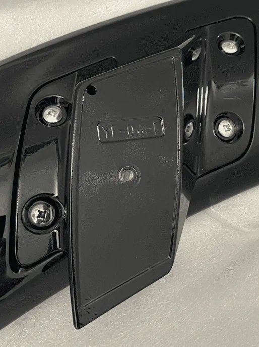

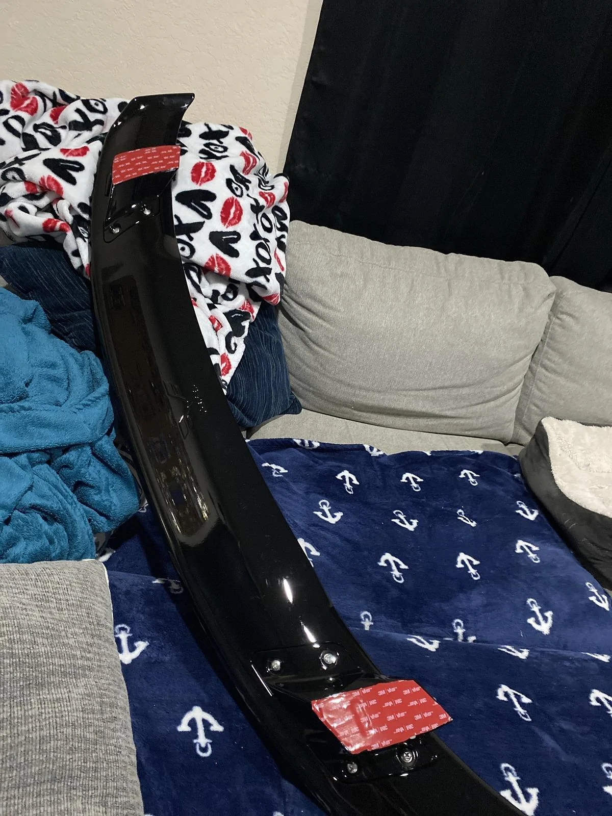

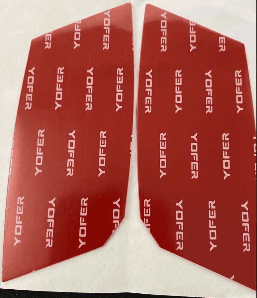

It can be bolt mounted or you can use the doubled sided adhesive tape that it comes with. I have already decided not to bolt mount for a few reasons. With that aside I was hoping someone could help with the adhesive side of the things.
Do I use the provided adhesive or do I use a 3M aftermarket tape? Here are pictures of the base of the mount and the provided adhesive pads. Or should I use something like the 3M tape linked below which I have and already used on my front lip and window visors.

I would go with the 3M that you provided the Amazon link for. I deal with adhesives every day. Our applications are sticking bare metal to bare metal (so no painted surfaces). The Amazon link does not give a 3M part number that I could find but that item is part of their VHB line (very high bond) and should be good for this application. It is amazing how strong of a bond you can get from 3M VHB. The adhesive supplied with the wing is too much of a wildcard.
Surface prep is just as important as adhesive selection. I would use a clay bar and then isopropyl alcohol wipes. If you just have the alcohol wipes I would do multiple wipes - like 5 or 6. Sometimes just a wipe or 2 will not remove a thick layer of wax and contaminates.
